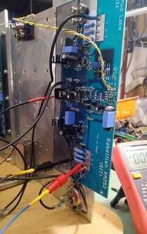

  1. ima bolje i od najboljeg [emoji846] baš mi se sviđa ova iteracija sa Tokin SITom napisah za prethodnu verzija sa mosfetima da je objektivno najbolji uradak iz Zenove kujne - SIT varijanta je sve to isto, ali subjektivno [emoji3] prošli smo isti materijal kao prošlog puta, ali noga je nešto više cupkala razlika je u prezentaciji koja kupuje iz prve - potsetilo me na prvo slušanje Defisita: isti karakter uz višestruko veću snagu minimalno 30W snage po kanalu bi trebalo da bude dovoljno za bilo koje zvučnike.. za ove moje nismo prelazili četvrtinu čestitam [emoji846]

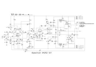

  2. Babelfish XA252 gives you all details .........so you can form your own Opinion Babelfish XA252 SIT gives you ready Opinion, with all details, and it doesn't care what you think go figure

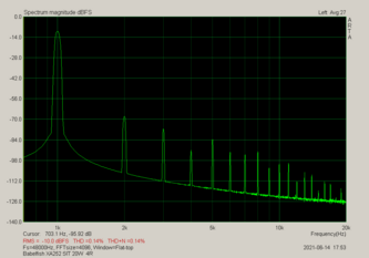

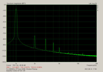

  5. Babelfish XA252 SIT - graphs , 4R load, BFR=510R Load changed to 4 Ohms
    2 poena

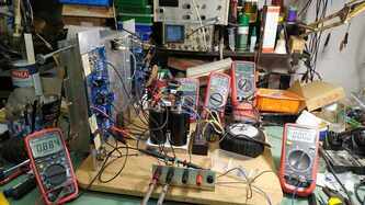

  7. ...... and I figured few tiny details, how to make Schade iteration now, just need few logic level TO220 mosfets , to put N pucks back ....... an will inform ya few days

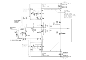

  9. current mirror is having programmed current at one side, while other side of current mirror is increasing or decreasing own current, so that voltage sags stays constant current of "working" side of CM is changed simply by effect of changing voltage between rail and base, while emiter resistor is not changing ........ so effect must be change of current though part contrary to that, reference halves of CM are having everything constant - both current through them, same as constant voltage between bases and rails
