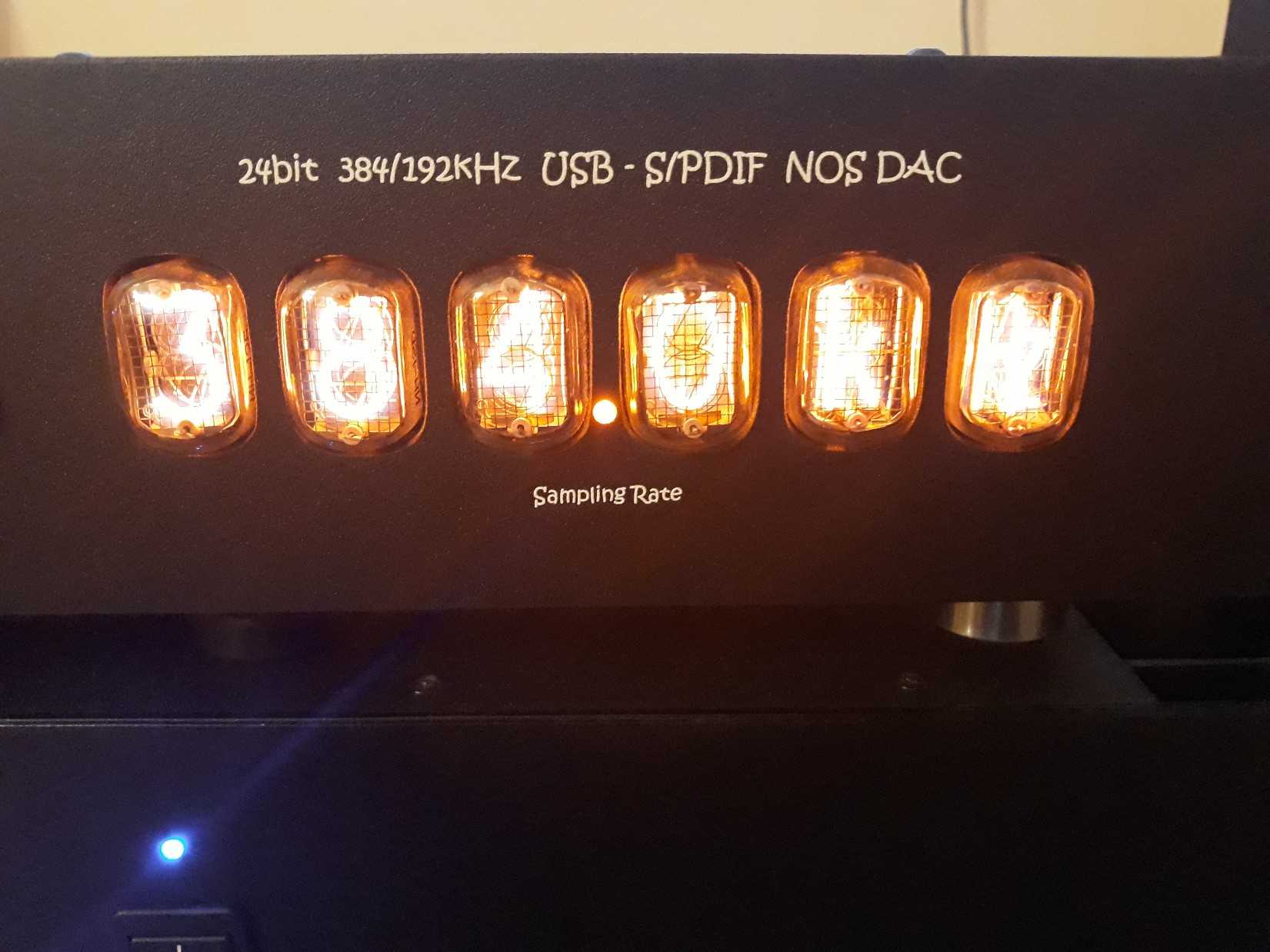

cat /proc/asound/J20/stream0
JLsounds JLsounds Hi-Rez Audio 2.0 at usb-0000:00:14.0-9, high speed : USB Audio
Playback:
  Status: Stop
  Interface 1
    Altset 1
    Format: S32_LE
    Channels: 2
    Endpoint: 0x01 (1 OUT) (ASYNC)
    Rates: 44100, 48000, 88200, 96000, 176400, 192000, 352800, 384000, 705600, 768000
    Data packet interval: 125 us
    Bits: 32
    Channel map: FL FR
    Sync Endpoint: 0x81 (1 IN)
    Sync EP Interface: 1
    Sync EP Altset: 1
    Implicit Feedback Mode: No
  Interface 1
    Altset 2
    Format: S16_LE
    Channels: 2
    Bits: 16
    Channel map: FL FR
    Sync EP Altset: 2
  Interface 1
    Altset 3
    Format: SPECIAL DSD_U32_BE
    Channels: 2
    Bits: 32
    DSD raw: DOP=0, bitrev=0
    Channel map: FL FR
    Sync EP Altset: 3
Ovo cepa full DSD sad
Samo što PCM63P  neče da može:D

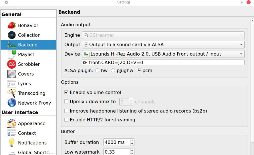

prebacio sam ovde jer je ovo to u plejeru
Puštaće sve ove iznad formate na HW
Samo do 192khz radi normalno preko šušti PCM63P - mora PCM
Ako je AKM čip ili Sabre  ide na HW
