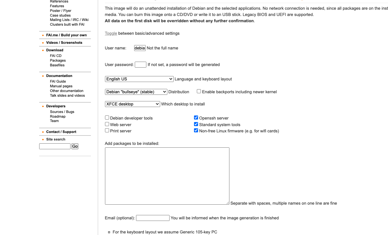

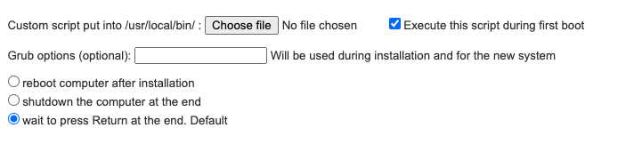

Mikorist Napisano Februar 9, 2023 #1526 Napisano Februar 9, 2023 Pre sat vremena, zika reče Rekoh i dušu spasih, bez ljutnje, iskustvo me je naučilo... Stoji mi u skripti sve ove komande sa -y (nema ljudske ruke da potvrdi) - samo sam copy/paste Ručno kad se radi bez "-y" radite. Pa potveđujte sa Yes pešaka. A što se tiče automatizovanih debian instalacija - koristim FAI FAI.me - build your own custom ISO FAI-PROJECT.ORG Pa se lepo u polje unesu paketi koje želite - recimo - moji za specifičnu mašinu linux-headers-5.10.0-20-rt-amd64 git build-essential cmake libcapstone-dev flex bison piper automake pkg-config libtool libffi-dev build-essential zlib1g-dev libbz2-dev liblzma-dev libssl-dev libcurl4-openssl-dev autoconf nvidia-cuda-toolkit nvidia-cuda-dev nvidia-detect nvidia-smi linux-image-amd64 default-jre default-jdk maven swig crunch libssl-dev nodejs npm tango-icon-theme thunar-archive-plugin rar unrar zip unzip filezilla sharutils uudeview mpack arj cabextract file-roller xvfb apt-transport-https pigz wkhtmltopdf libfontenc1 xfonts-75dpi xfonts-base xfonts-encodings xfonts-utils python3 python3-dev python3-pip libfuse-dev fuse pkg-config libssl-dev openssl libacl1-dev libacl1 build-essential cutycapt python3-pyopencl libbz2-dev nvidia-settings hashcat base58 libsecp256k1-0 electrum octave lshw inxi binfmt-support parallel qtbase5-dev yasm sysfsutils nvme-cli util-linux firmware-misc-nonfree xserver-xorg-core xserver-xorg-video-intel libegl1-mesa libgl1-mesa-glx libgl1-mesa-dri xserver-xorg xserver-xorg-core xfonts-base xinit x11-xserver-utils python3-pyqt5 nvidia-driver ffmpeg python3-tk gimp flameshot vlc qbittorrent genisoimage preload curl audacity pa onda resto u skripti ispod #!/bin/bash # Require that this runs as root. [ "$UID" -eq 0 ] || exec sudo "$0" "$@" sudo timedatectl set-timezone Europe/Belgrade sudo date -s "$(wget -qSO- --max-redirect=0 google.com 2>&1 | grep Date: | cut -d' ' -f5-8)Z" FILE=$"blacklist nouveau blacklist lbm-nouveau options nouveau modeset=0 alias nouveau off alias lbm-nouveau off" echo "$FILE" > /etc/modprobe.d/blacklist.conf FILE1=$" @audio - rtprio 90 # maximum realtime priority @audio - memlock unlimited # maximum locked-in-memory address space (KB)" echo "$FILE1" > /etc/security/limits.d/audio.conf sudo echo 'Package: * Pin: release a=mx Pin-Priority: 100' > /etc/apt/preferences.d/mxlinux sudo echo 'deb http://mxrepo.com/mx/repo/ bullseye main non-free deb http://mxrepo.com/mx/repo bullseye ahs' > /etc/apt/sources.list.d/mxlinux.list sudo apt-key adv --keyserver keyserver.ubuntu.com --recv-keys F942E0D4E1C726CD sudo apt-get -y update sudo apt-get -y upgrade sudo apt -y install mx-debian-firmware mx-iso-template mx-live-usb-maker mx-remaster mx-remastercc mx-snapshot mx-tweak mx-tweak-data mx-usb-unmounter echo 'Xft.antialias: 1 Xft.autohint: 0 Xft.dpi: 96 Xft.hinting: 0 Xft.hintstyle: hintnone Xft.lcdfilter: lcddefault Xft.rgba: rgb' > /home/miko/.Xresources sudo sed -i 's/resample-method = speex-float-1/resample-method = speex-float-10/' /etc/pulse/daemon.conf sudo sed -i 's/avoid-resampling = false/avoid-resampling = yes/' /etc/pulse/daemon.conf sudo sed -i 's/default-sample-format = s16le/default-sample-format = s24le/' /etc/pulse/daemon.conf sudo sed -i 's/default-sample-rate = 44100/default-sample-rate = 96000/' /etc/pulse/daemon.conf systemctl --user restart pulseaudio.service # download viber package curl -fSL "http://download.cdn.viber.com/cdn/desktop/Linux/viber.deb" -o viber.deb sudo dpkg -i viber.deb rm -f viber.deb # download Tidal package curl -fSL "https://github.com/Mastermindzh/tidal-hifi/releases/download/4.1.0/tidal-hifi_4.1.0_amd64.deb" -o tidal.deb sudo dpkg -i tidal.deb rm -f tidal.deb # download nomachine package curl -fSL "https://www.nomachine.com/free/linux/64/deb" -o nomachine.deb sudo dpkg -i nomachine.deb rm -f nomachine.deb # download atomicwallet package curl -fSL "https://get.atomicwallet.io/download/atomicwallet.deb" -o atomicwallet.deb sudo dpkg -i atomicwallet.deb rm -f atomicwallet.deb # download google chrome package curl -fSL "https://dl.google.com/linux/direct/google-chrome-stable_current_amd64.deb" -o google-chrome-stable_current_amd64.deb sudo dpkg -i google-chrome-stable_current_amd64.deb rm -f google-chrome-stable_current_amd64.deb sudo systemctl mask sleep.target suspend.target hibernate.target hybrid-sleep.target sudo apt-get -y remove xfce4-power-manager sudo apt-get -y update sudo apt-get -y upgrade sudo apt -y --fix-broken install sudo apt-get -y autoremove sudo hostnamectl set-hostname miko cd /home/miko/.config/qBittorrent/ curl -sS http://upd.emule-security.org/ipfilter.zip > ipfilter.zip unzip ipfilter.zip rm ipfilter.zip rm ipfilter.dat mv guarding.p2p ipfilter.dat sudo sed -i '1i 127.0.0.1 miko' /etc/hosts rm -f /usr/local/bin/fai.sh && reboot I onda lepo dobijem na gomili debian iso sa sve tidalom i aplikacijama koje mi trebaju Grub opcije iommu=soft zswap.enabled=1 intel_iommu=on,igfx_off mitigations=off nouveau.modeset=0 Neće debilijan bez iommu=soft da radi USB 3.0 na aorus vladd, Srecko and Lemić je reagovao/la na ovo 2 1

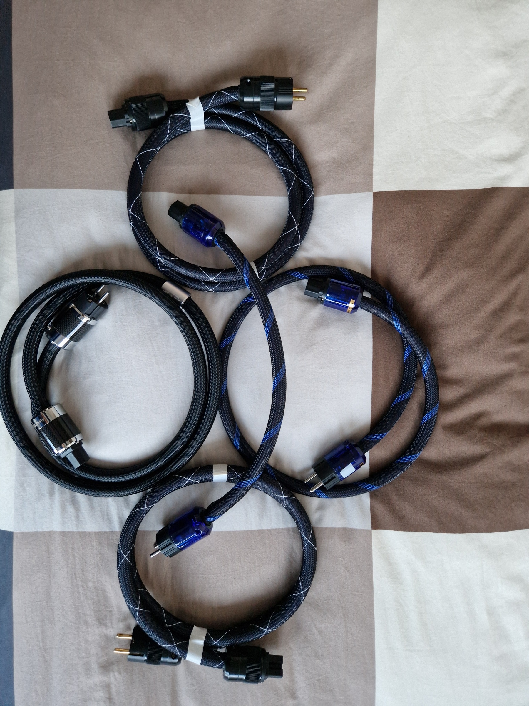

Srecko Napisano Februar 9, 2023 #1527 Napisano Februar 9, 2023 Samo za Mikine oči. Jeste da nije gvožđe ali je isto jako teško (bakar😁). Ne smem ni da racunam koliko sam love dao (ovaj levi u sredini je furutech) da mi stoje u ormanu i još i krive dasku police. Zato je NUC najbolji za izvor😁😁😁. I kad ga staviš u orman bar štetu ne pravi. Mikorist and Lemić je reagovao/la na ovo 2
