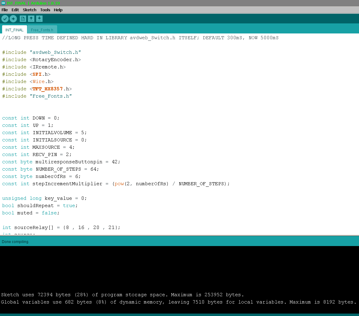

Zen Mod Napisano April 14, 2022 Autor #4123 Napisano April 14, 2022 On 4/12/2022 at 8:40 PM, vinko said: Joj, zovem te. Ma... Nisam zaboravio. Nego sam vise u Italiji nego ovde... neka, navik'o sam se ja na 'Talijane..... Quote Basically - same as Iron Pumpkin Logic Module - 3.5'' TFT, Encoder, fancy Aluminum billet Remote Arrangement - controlling 4 inputs, 64 step attenuator (2^6 matrix, resistors switched with relays), Stand-by (thus both Power On and Power Off), Mute and both separate and automatic un-Mute Power On sequence: -powering main PSU, screen backllight, Greetings -main screen,enabling both inputs and attenuator relays -un-muting Necessary change to TFT module - rerouting backlight LED neg to low-side switch controlled with code ( no such function in TFT module, as made) Remote having all mentioned commands (input change incremental with center key) Encoder controlling volume, short click incremental change of inputs, long press Power function Easy peasy, few nights needed for, basically, supplementing Iron Pumpkin Code, but changes are substantial As always 95% of work made by Mighty ZM, while crucial 5% is tnx to my Buddy Denis Balog (Vinko @ Baby DiyA) ziki, LightMatic, Leonardo and 2 ostalih je reagovao/la na ovo 1 4
Leonardo Napisano April 14, 2022 #4125 Napisano April 14, 2022 (izmenjeno) ^^ Lepo, lepo. Koliko je teško programirati tekst, font itd. u ovakvim konstrukcijama? PS - Nemoj da bi se neko smejao na ovo pitanje, jerbo ću se ja smejati kada budete lomili ureznice i burgije pri nekom vašem švajsovanju Izmenjeno April 14, 2022 od Leonardo Mikorist, vladd and LightMatic je reagovao/la na ovo 3
Zen Mod Napisano April 14, 2022 Autor #4126 Napisano April 14, 2022 nema smejanja, naravski ene, ceo posao programiranja je verovatno nekome i trivijalan (Vinku, na primer) ali meni nikako nije bio mada , u celoj prici - ovi fontovi koje sam upotrebio su jos i polaksi deo posla ispali Greetings je Tesla rukopis - font koji sam negde nasao na netu font na funkcionalnom ekranu je Gradl regular oba fonta sam morao konvertovati za Arduino, resiti sve probleme po pitanju rezolucije te ogranicenja velicine fajla** ...... kao i u svemu, gomila kompromisa kao i u svemu ostalom - uzmes pa uradis ....... , a ti vrlo dobro znas od cga se to sve sastoji ene, od tog zanata meni ovo i taman i previse ........ bas i ne zudim za nekim napretkom na tom polju **primer - velike cifre - programski ogranicen max. velicinom fajla za font (poseban fajl pravis za svaku velicinu istog fonta) , velike cifre nisam mogao da napravim direktan fajl ( prevelik) nego sam koristio adekvatan manji, pa multiplicirao velicinu x2 time se gubi na rezoluciji (ivice ruznije definisane), ali ne moze drugacije ...... sto bi rekli kadsmobilimali i igrali stoni fudbal - ne ide kroz plastiku LightMatic and Leonardo je reagovao/la na ovo 1 1

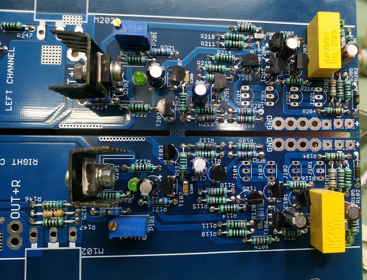

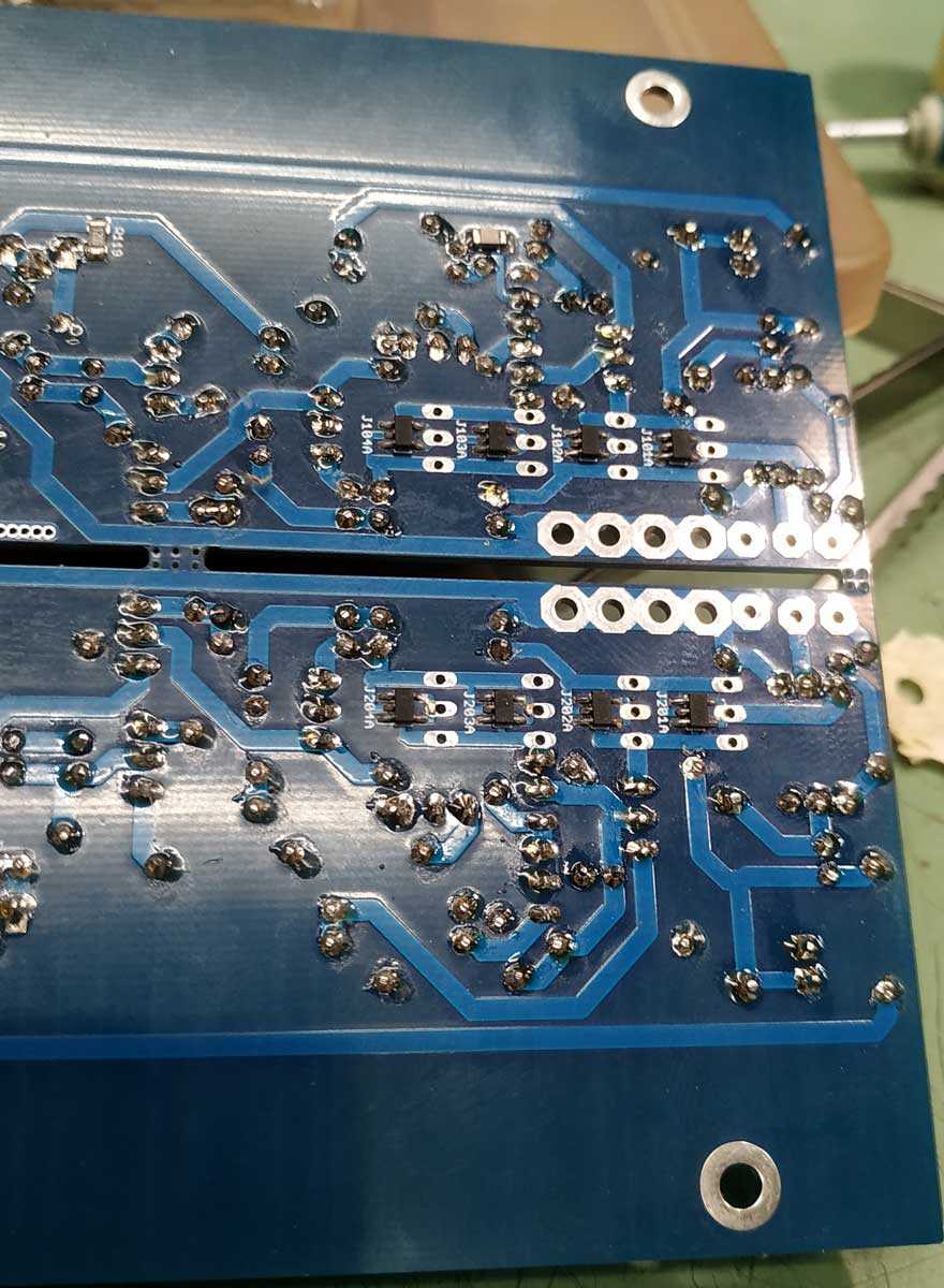

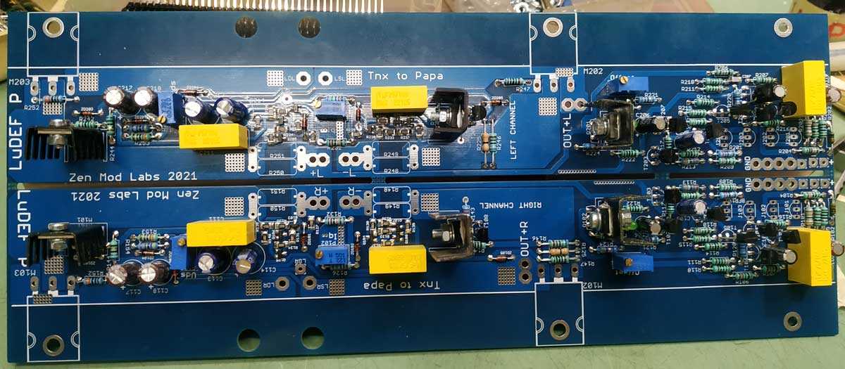

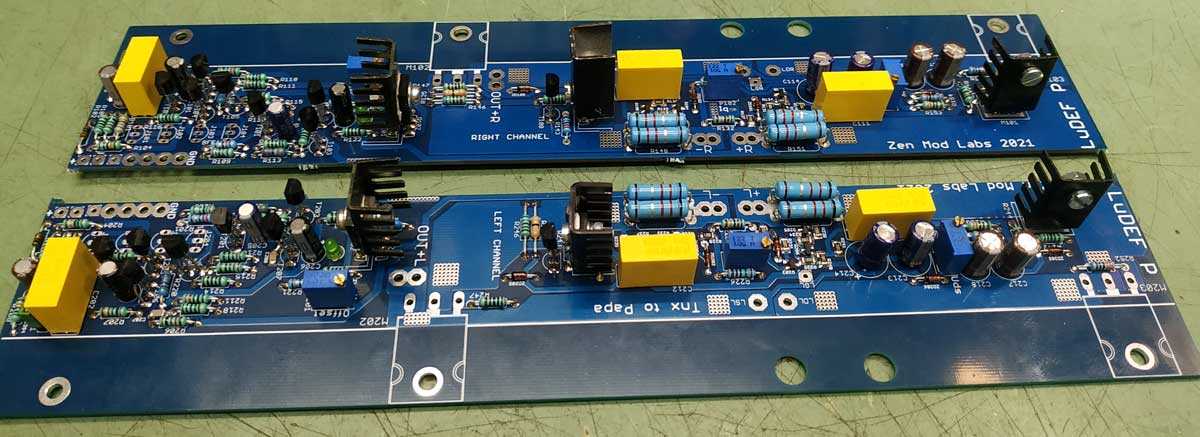

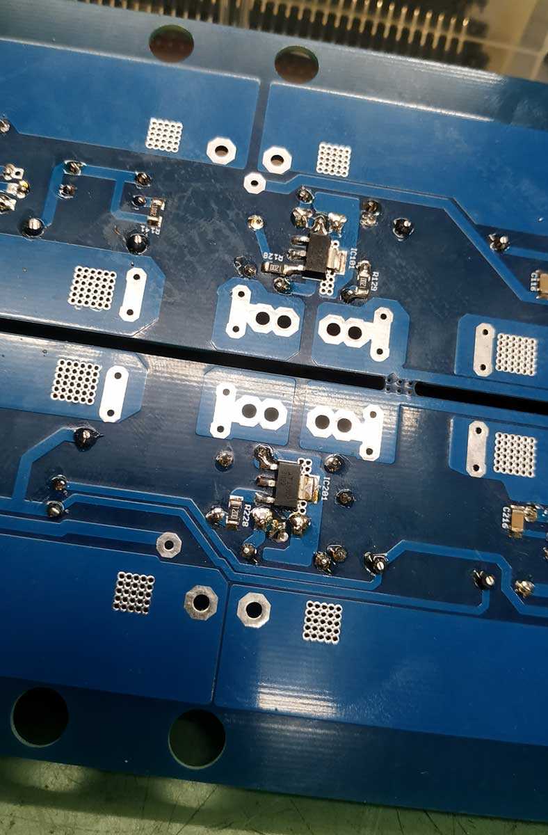

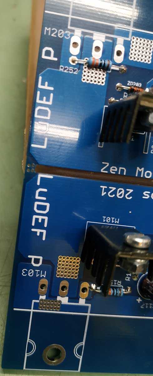

Zen Mod Napisano Maj 15, 2022 Autor #4131 Napisano Maj 15, 2022 shonne, zerowaf, LightMatic and 2 ostalih je reagovao/la na ovo 1 2 2
shonne Napisano Maj 15, 2022 #4132 Napisano Maj 15, 2022 To neki virus, pa samo izbacujete slike bez txt 😁 LightMatic je reagovao/la na ovo 1
LightMatic Napisano Maj 15, 2022 #4133 Napisano Maj 15, 2022 pre 28 minuta, Zen Mod reče Svaki put kad vidim ima Ludef, imam osjećaj da će MZM napisati da je za mene... puuusti snovi...
LightMatic Napisano Maj 15, 2022 #4134 Napisano Maj 15, 2022 Evo i dokaz, ne pazim ni šta pišem... umjesto ima je trebalo ime
Zen Mod Napisano Maj 15, 2022 Autor #4135 Napisano Maj 15, 2022 9 minutes ago, shonne said: To neki virus, pa samo izbacujete slike bez txt 😁
shonne Napisano Maj 15, 2022 #4136 Napisano Maj 15, 2022 Znam da je Ludef, za koga se radi...se pise malo.
