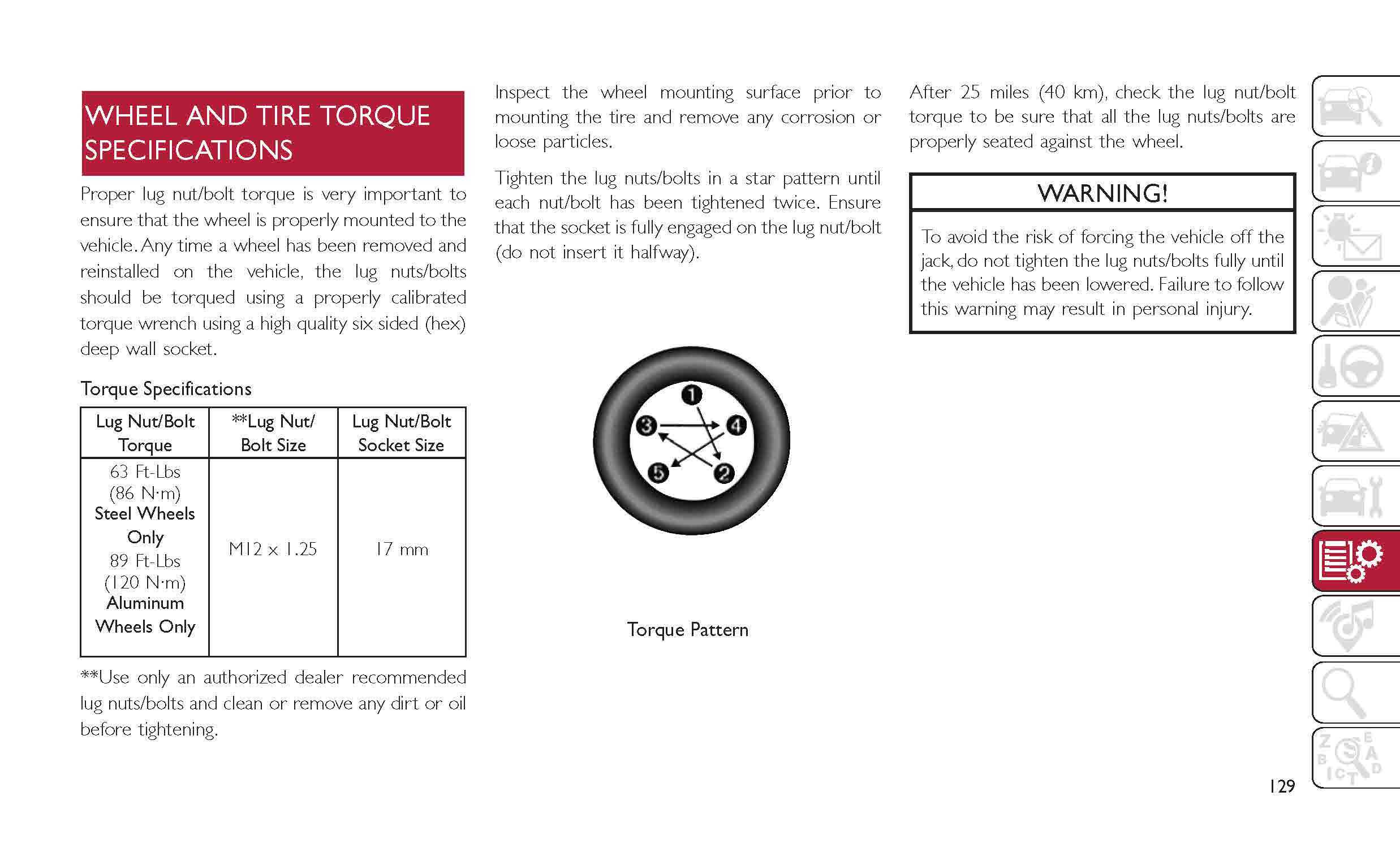

NIXIE Napisano Avgust 1, 2023 #55 Napisano Avgust 1, 2023 Fiat Wheel Bolt Torque Chart WWW.SPARKYEXPRESS.CA Fiat wheel bolt torque specs: find out how much you should tighten the wheel bolts when installing wheels on your Fiat model. Clean wheel bolts or nuts and check threads for damage, renew if necessary. Renew corroded wheel bolts. Attention! Do not apply oil or grease to wheel studs or bolts.
NIXIE Napisano Avgust 1, 2023 #57 Napisano Avgust 1, 2023 (izmenjeno) Piše i u uputstvu za moju makinu, 500L, pre stezanja očistiti od prljavštine i ulja. Dat je i moment pritezanja na suvo, za čelične i Alu točkove. Samo nemam moment ključ, ali ima moj majstor i vulkanizer. Izmenjeno Avgust 1, 2023 od NIXIE
