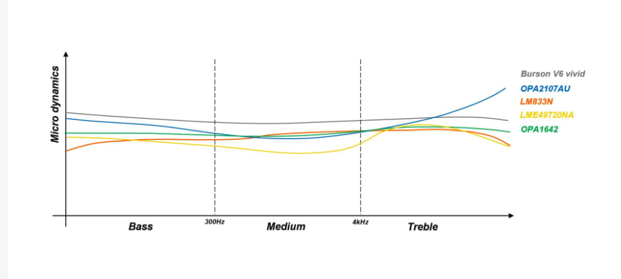

NIXIE Napisano Februar 10, 2023 Autor Share #4700 Napisano Februar 10, 2023 Sa bigdaja, Miro AD1862 dak i igranje sa OPA: Burson V6 Vivid We were split on the Bursons. I rated the Bursons #1 by a mile, and my friends rated it dead last. The Burson sounded extremely different from the ADA 4627. As soon as we powered on and started with the Bursons, I thought "Ah there it is. That's what I'm looking for", and my friends immediately thought "The ADA's sounded 10x better than this". Na kraju im se puno svideo još i TL071. Vix je reagovao/la na ovo 1 Link to comment Podeli na ovim sajtovima More sharing options...

Mikorist Napisano Februar 10, 2023 Share #4704 Napisano Februar 10, 2023 @NIXIE si videoo njegov prvi post i kako se meri Burson sa 1642 (koji nije ni probao) [Objective Benchmark Part 1] Op Amps comparison in voltage gain stage. MARTIGANE.BLOGSPOT.COM The different Op Amps were measured after sufficient stabilization / burn-in time, using identical conditions. Those measurements are my fir... [Subjective Benchmark Part 1] Op Amps comparison in voltage gain stage MARTIGANE.BLOGSPOT.COM Disclaimer: This article represents my impressions on the different operational amplifiers tested, for a given topology. The operational... Link to comment Podeli na ovim sajtovima More sharing options...

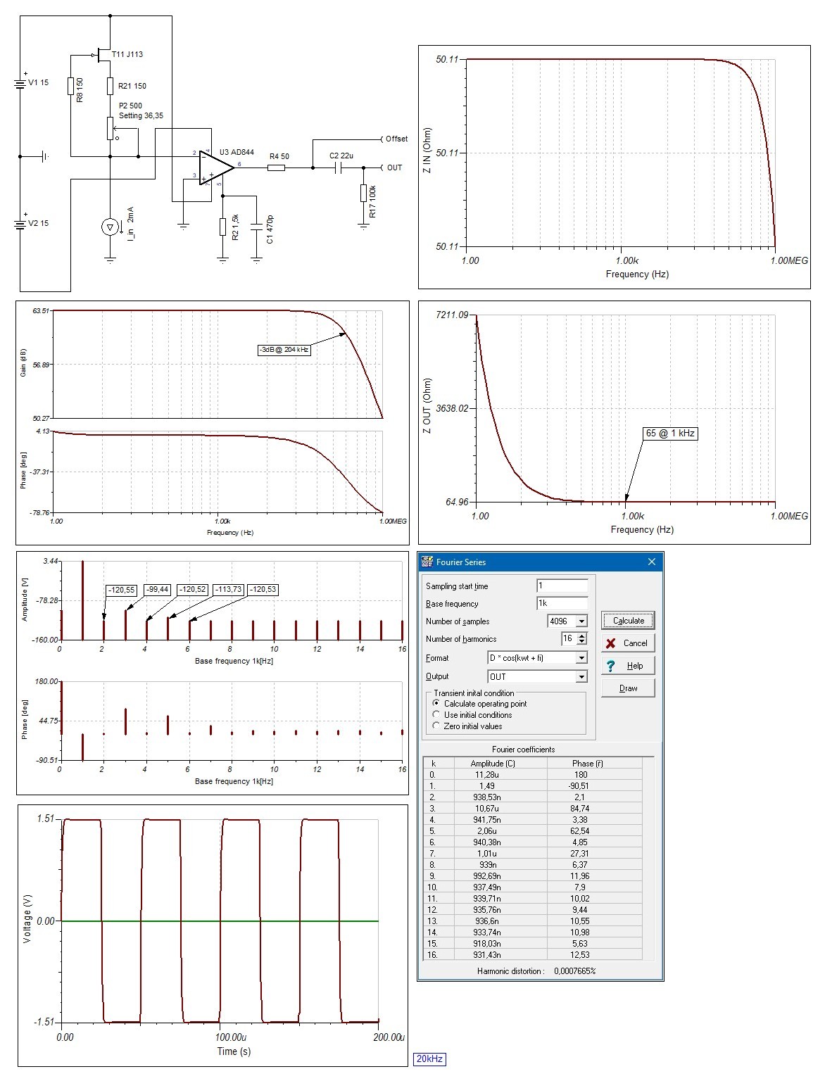

BANAT Napisano Februar 10, 2023 Share #4708 Napisano Februar 10, 2023 Line pojacalo sa brzim AD844 + J113 , struja I/V konverzije iz TDA1541 podesena na 2mA , 20Khz cetvtrka takoreci perfektna , THD=0,0007665% ! , ulazno/izlazna impedansa relativno linearna ,... jos samo napraviti dobro bipolarno 15VDC napajanje i to je to ... , ma kakvi tamo neki Benchmark , Bursoni - baloni ... LightMatic je reagovao/la na ovo 1 Link to comment Podeli na ovim sajtovima More sharing options...
