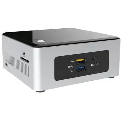

vladd Napisano Decembar 15, 2022 #989 Napisano Decembar 15, 2022 Od NYC ima kod uspona par. Ovaj stariji Mini računar Intel NUC BOX Intel Pentiuml N3700/DDR3/ m.2+2.5/HDMI//VGA/WiFi/BT NUC5PPYH - USPON DOO WWW.USPON.RS Mini računar Intel NUC BOX Intel Pentiuml N3700/DDR3/ m.2+2.5/HDMI//VGA/WiFi/BT NUC5PPYH I mladji Mini PC Zeus GK3 Celeron QC J4125 2.70 GHz/DDR4 8GB/m.2 128GB/LAN/Dual WiFi/BT/2xHDMI/VGA - USPON DOO WWW.USPON.RS Mini PC Zeus GK3 Celeron QC J4125 2.70 GHz/DDR4 8GB/m.2 128GB/LAN/Dual WiFi/BT/2xHDMI/VGA Ne bih preporucio polovnog, osim ako se bas neki od frendova koji kapiraju tu tehniku ne potrudi i pronadje nesto.
