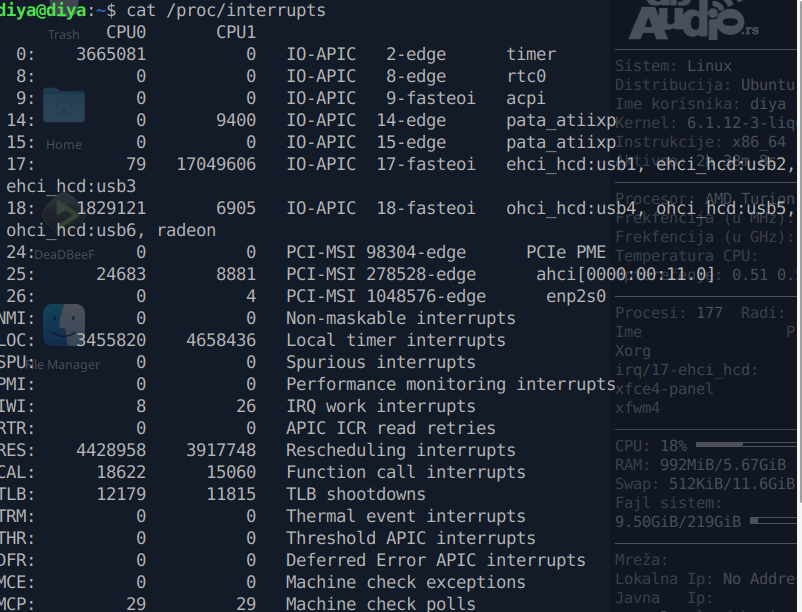

RTIRQ_NAME_LIST="usb snd enp2s0 enp3s0 amdgpu radeon i915 i801_smbus i8042"
Feb 25 06:05:26 diya systemd[1]: Starting LSB: Realtime IRQ thread tunning....
Feb 25 06:05:27 diya rtirq[706]: Setting IRQ priorities: start [xhci_hcd] irq=30 pid=221 prio=90: OK.
Feb 25 06:05:27 diya rtirq[706]: Setting IRQ priorities: start [xhci_hcd] irq=32 pid=232 prio=89: OK.
Feb 25 06:05:27 diya rtirq[976]: Setting IRQ priorities: start [HDA-Intel] irq=33 pid=573 prio=85: OK.
Feb 25 06:05:27 diya rtirq[1074]: Setting IRQ priorities: start [HDA-Intel] irq=34 pid=570 prio=85: OK.
Feb 25 06:05:27 diya rtirq[706]: Setting IRQ priorities: start [amdgpu] irq=35 pid=627 prio=70: OK.
Feb 25 06:05:27 diya rtirq[706]: Setting IRQ priorities: start [i801_smbus] irq=18 pid=230 prio=55: OK.
Feb 25 06:05:27 diya systemd[1]: Started LSB: Realtime IRQ thread tunning..
