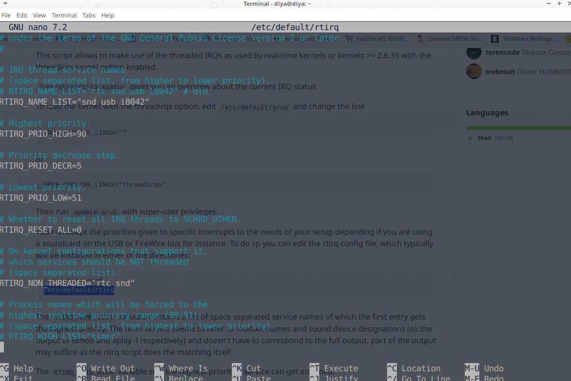

RTiRQ
wget http://ports.ubuntu.com/pool/universe/r/rtirq/rtirq-init_20150216-2.1_all.deb
sudo dpkg -i rtirq-init_20150216-2.1_all.deb
rtirq.conf
RTIRQ_NAME_LIST="snd usb i8042"
# Highest priority.
RTIRQ_PRIO_HIGH=90
# Priority decrease step.
RTIRQ_PRIO_DECR=5
# Lowest priority.
RTIRQ_PRIO_LOW=51
# Whether to reset all IRQ threads to SCHED_OTHER.
RTIRQ_RESET_ALL=0
# On kernel configurations that support it,
# which services should be NOT threaded
# (space separated list).
RTIRQ_NON_THREADED="rtc snd"
sudo systemctl enable rtirq.service

Menjali, prigodno, saglasno podešavkama koje se tiču RT:
/etc/default/rtirq tj. /etc/rtirq.conf, ne znam koji je kod Vas active... ?
Kada se dobro podesi i pusti rt kernel, tek tada... :)
Izmenjeno od zika
pre 3 minuta, zika reče
Pa tek sam pre 45 minuta pustio - zaboravio da enablujem service na ISO....Posle restarta je bio deaktiviran. :P
● rtirq.service - LSB: Realtime IRQ thread tunning.
     Loaded: loaded (/etc/init.d/rtirq; generated)
     Active: active (exited) since Fri 2023-02-24 18:25:05 CET; 1h 13min ago
       Docs: man:systemd-sysv-generator(8)
    Process: 681 ExecStart=/etc/init.d/rtirq start (code=exited, status=0/SUCCESS)
        CPU: 79ms
Feb 24 18:25:04 diya systemd[1]: Starting LSB: Realtime IRQ thread tunning....
Feb 24 18:25:05 diya rtirq[942]: Setting IRQ priorities: start [HDA-Intel] irq=33 pid=544 prio=90: OK.
Feb 24 18:25:05 diya rtirq[971]: Setting IRQ priorities: start [HDA-Intel] irq=34 pid=542 prio=90: OK.
Feb 24 18:25:05 diya rtirq[681]: Setting IRQ priorities: start [xhci_hcd] irq=30 pid=231 prio=85: OK.
Feb 24 18:25:05 diya rtirq[681]: Setting IRQ priorities: start [xhci_hcd] irq=32 pid=240 prio=84: OK.
Feb 24 18:25:05 diya systemd[1]: Started LSB: Realtime IRQ thread tunning..
Da...Tek sad čujem to što pričate :deda:
Ne zaboravite da pogledate ponuđene file-ove... Obućar često ide sa rupom na đonu, tako sam i ja, pišući za ovaj thread, našao nekoliko rupa na svojim đonovima, koje ostadoše kod lutanja po livadi zbog nekih drugih services i kernel-a.... Sada sam stavio nova pendžeta... :) Ako nađem neku rupu, javljam...
Izmenjeno od zika
Dogovoreno. Ma u brzini se svašta dešava. Još se ja prebacujem sa sistema na sistem da čujem razlike.
Mogu se, slobodno, makar kod mene, podići nivoi za RT i u spisak, pravim redom, staviti snd, usb, ako je DAC na usb, eth0 i tako dalje, malo pregledati koja su im, kod Vas imena i tako dalje. No, ima smisla i ako jezgro podržava...
