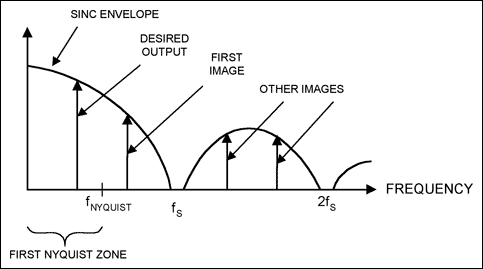

vladd Napisano Novembar 13, 2022 #1904 Napisano Novembar 13, 2022 (izmenjeno) Po Nikvistu je digitalizovan analogni materijal i tako digitalizovan gurnut na ulaz u DAC. Iza daca je "željeni" signal u prvoj Nikvistovoj zoni, a "duhovi" u drugoj i trećoj, i nastaje čuvena sinx/x distorzija, ako se ostavi klot i ne modeluje. Figure 3. This representation of a DAC output in the frequency domain shows that the desired signal is generally within the first Nyquist zone, but many image signals are present at higher frequencies. The sin(x)/x (sinc) function is well known in digital signal processing. For DACs, the input is an impulse and the output is a constant-voltage pulse with update period of 1/fS (the impulse response), whose amplitude changes abruptly in response to the next impulse at the input. Izmenjeno Novembar 13, 2022 od vladd zika je reagovao/la na ovo 1
