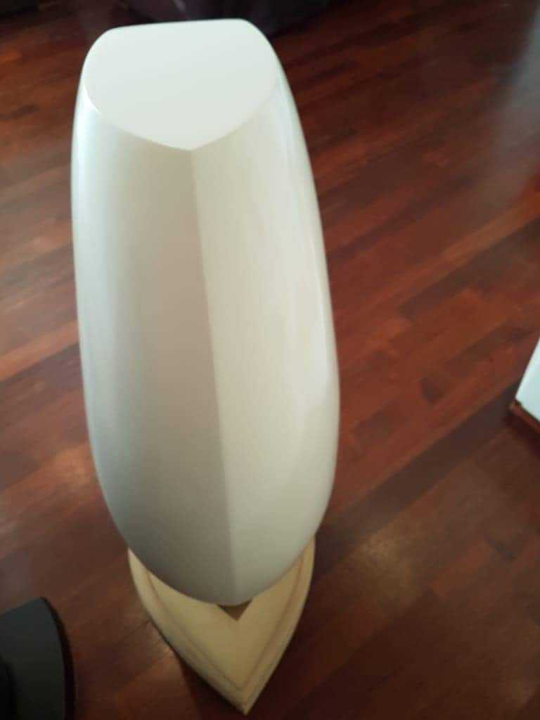

jororaitchev Napisano Oktobar 9, 2017 Autor #99 Napisano Oktobar 9, 2017 Clarification, this is a polyurethane primer, I will be make veneer on the on cabinet's with "Birds of Maple".The first home tests are good.My current surround speakers of " Technics" CA-10 with a good sound from 1997, they are sadly retreated himself ... After the measurements, this is are Technical data:Frequence Range; 33-25000 HzLong term Max Power; 200 WCrossover Frequency; 2800 HzImpedance; 4 OhmsSensitivity; 90 db SPLCabinet Volume; 31 LGross weight / without stand /; 27kg.Joro RaitchevSofia- Bulgaria Beli_Ninja, ab, Aleks and 2 ostalih je reagovao/la na ovo 3 2

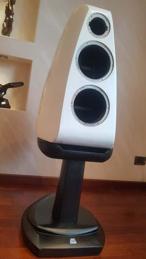

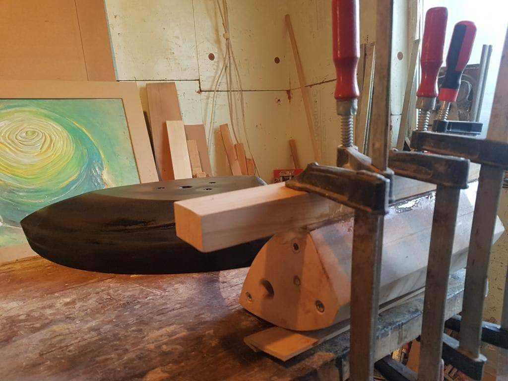

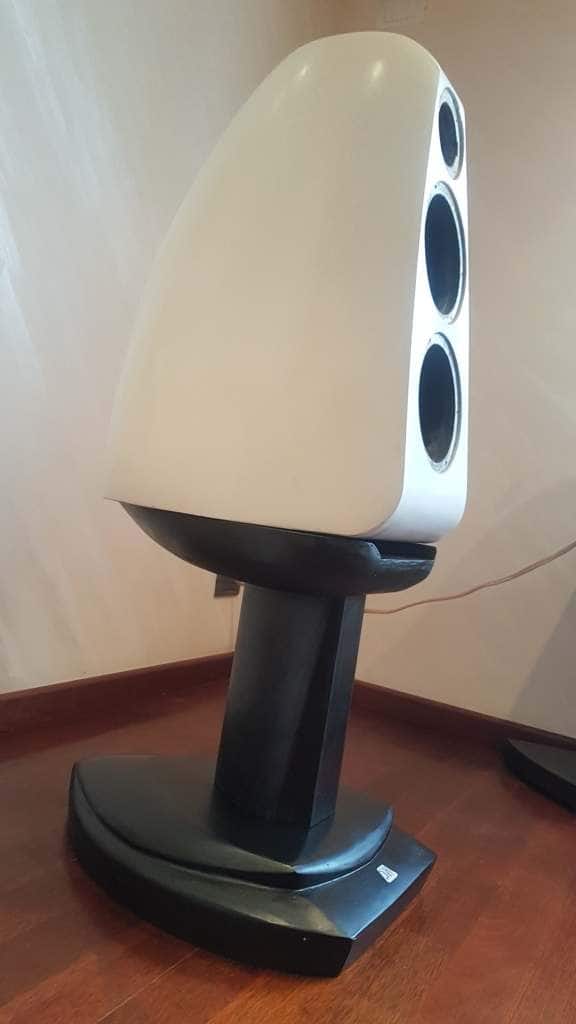

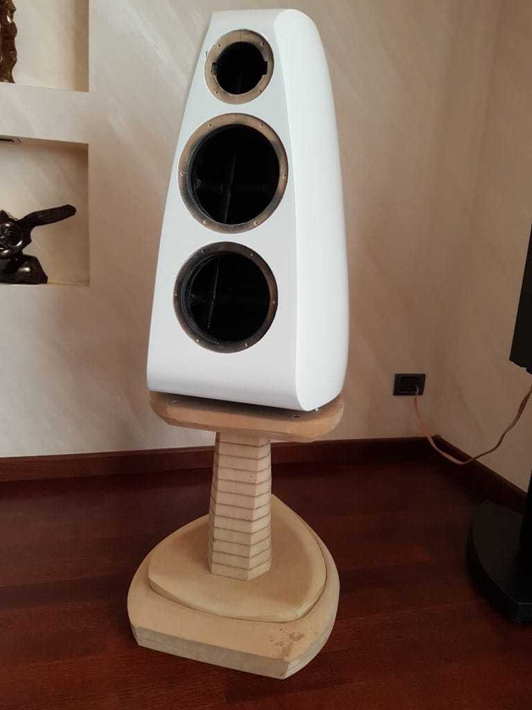

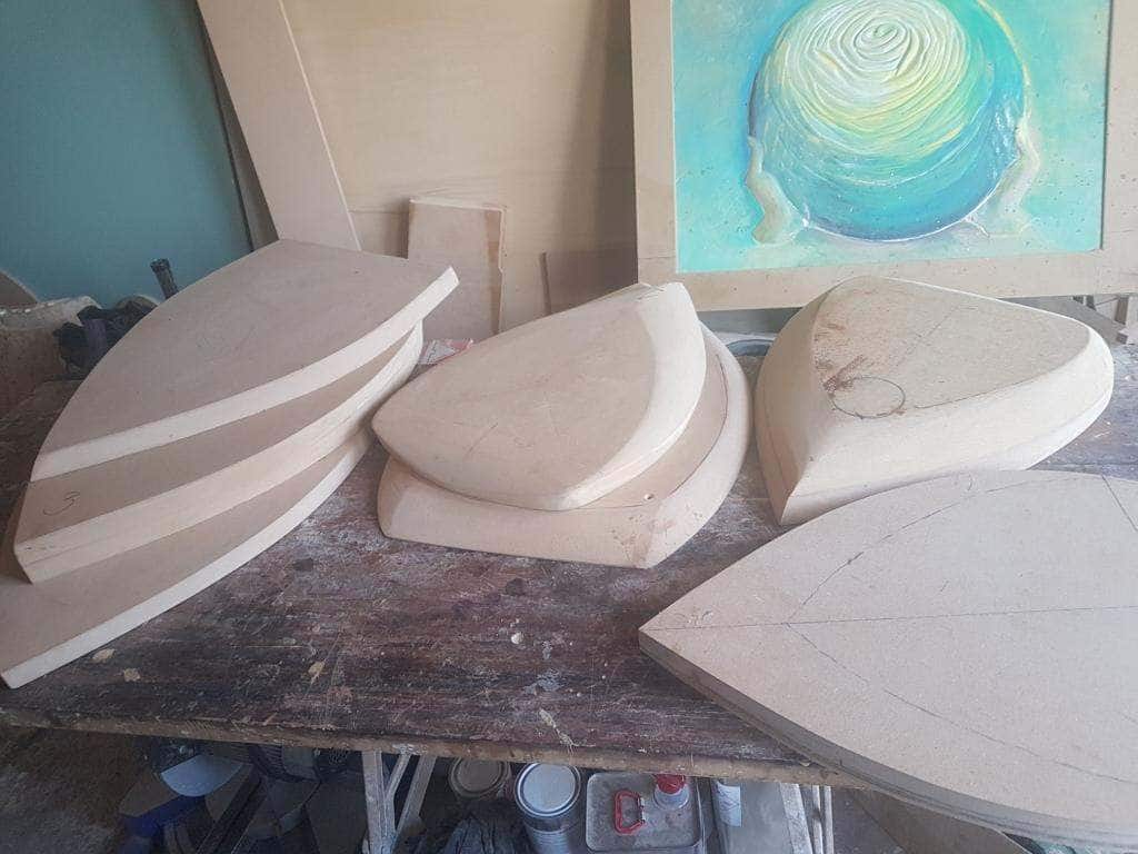

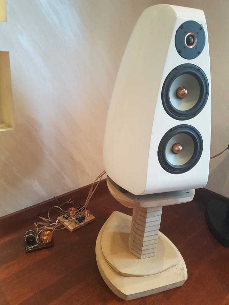

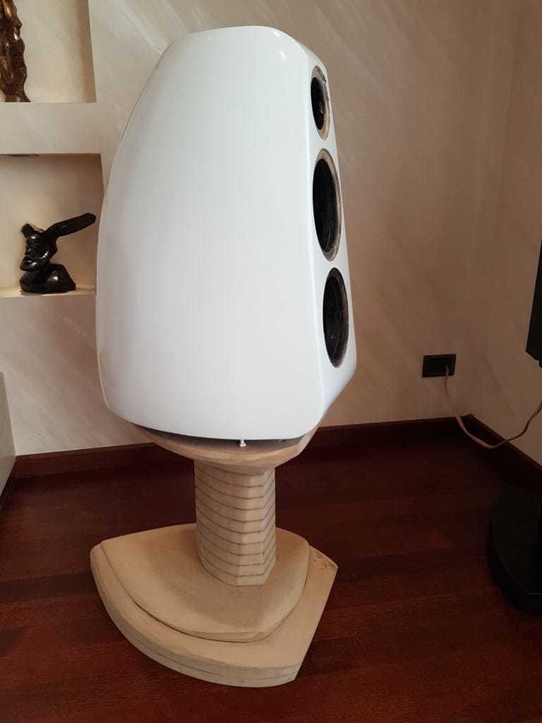

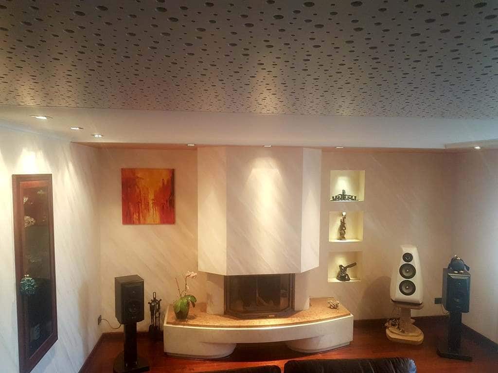

jororaitchev Napisano Oktobar 26, 2018 Autor #105 Napisano Oktobar 26, 2018 I have finished several heavy projects, today is Dimitri's day / Happy celebration of all with this name /, i.e. winter is coming in and I start working on stands of the rear loudspeakers, a few picture: Završil sam nekoliko teških projekata, danas je Dimitrov dan / Sretna svečanost slavlje svih koji su s tim imenom/, tj. dolazi zima i ja cu počinjem raditi na stalcima stražnjih zvučnika, nekoliko slika: Cheers! Živjeli! zerowaf, NIXIE and 2a3 je reagovao/la na ovo 3

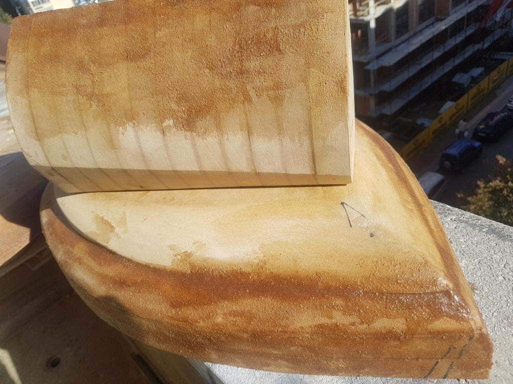

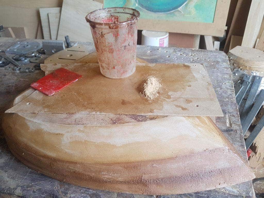

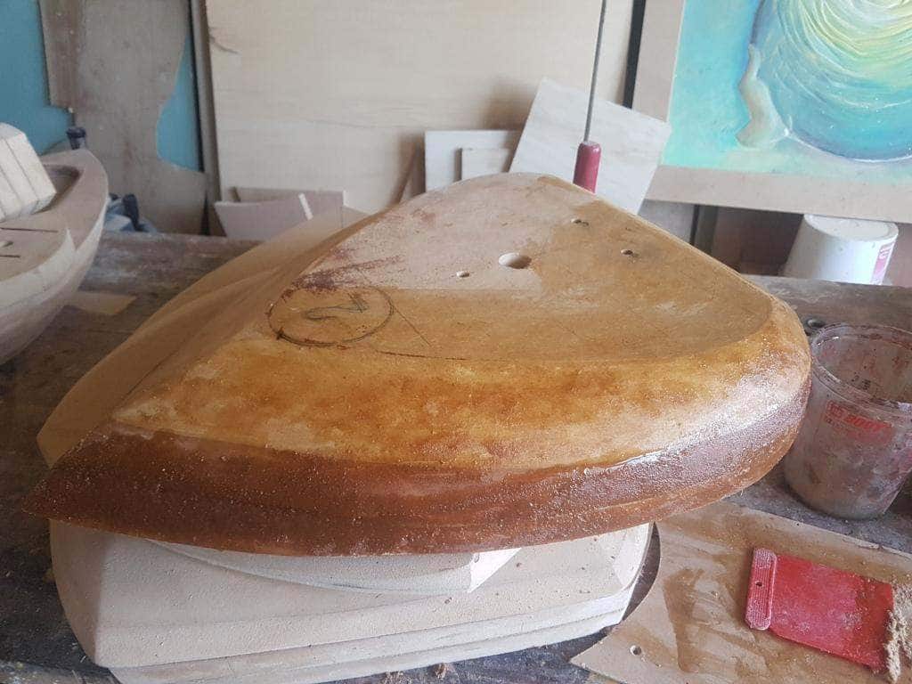

jororaitchev Napisano Oktobar 27, 2018 Autor #106 Napisano Oktobar 27, 2018 I will open an interesting (for me) topic, the seasonal movement of the MDF material. You assemble aLL of details in konstrukcion, everything is fine, but after two or three seasons, you can see all assemblies and details similar to this item: I'll show you what is my solution to this problem, for more than 10 years, everything looks like it was at the beginning. After assembling, I make a whale, with MDF waste material and a polyurethane primer to coat the workpiece; to be continued.. zerowaf, NIXIE, Aleks and 1 član je reagovao/la na ovo 4
Aleks Napisano Oktobar 27, 2018 #107 Napisano Oktobar 27, 2018 A friend of mine, a good carpenter, told me about this problem when i mentioned layered MDF speaker box. Good approach!

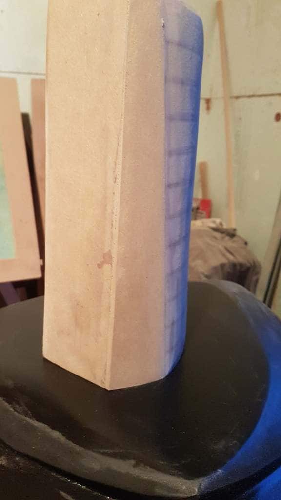

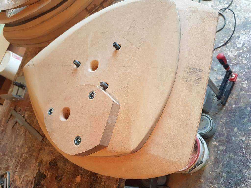

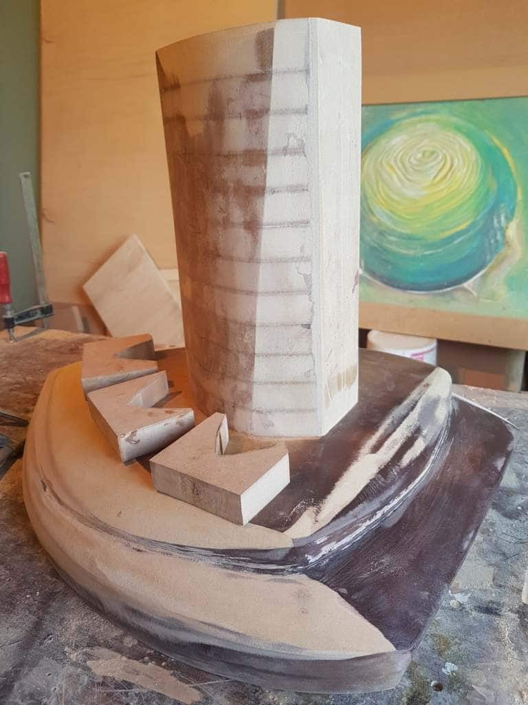

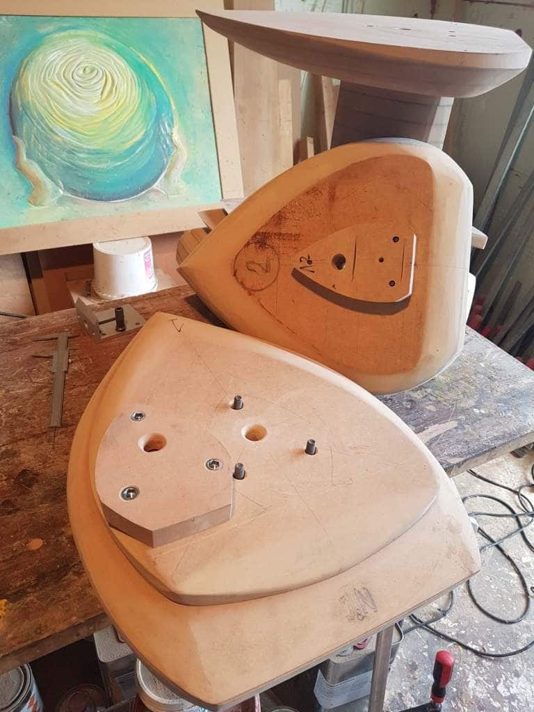

jororaitchev Napisano Novembar 23, 2018 Autor #110 Napisano Novembar 23, 2018 The front of the stand is treated with 3 mm MDF;
