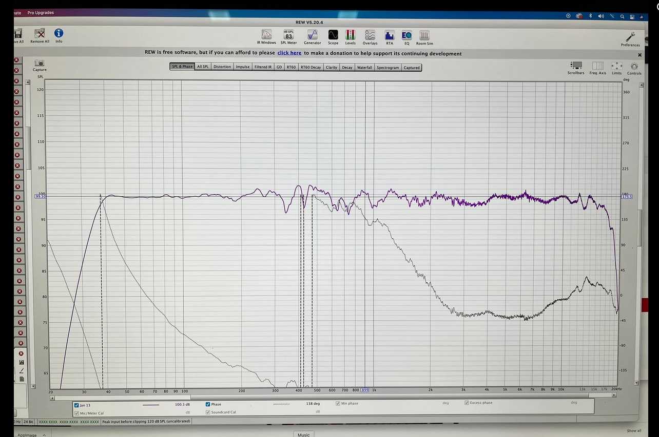

shonne Napisano Decembar 23, 2021 Autor #957 Napisano Decembar 23, 2021 Pustio Venom da pogledam...uspavao se ko dete na pola filma. Bozeee ljudi sta ovaj Marvel vise pravi... Imao sam u tweeter sekciji Ampohm od 4,7uf i jedan deo Rifa kondove one iz starih centrala. Pokupio ove Clarity, vrednosti 4x1,5uf i 2x4.7uf da probam da vidim sta se desava, pre svih merenja koje budem radio (vreme je da sednem da merim, dosta sam vise lencario). Definitivno, zamena samo Rifa kondova je umirila tviter, nema vise one agresivnosti...vise detalja. Da se malo razboravim, muzika i videcu da li jos nesto primecujem.
shonne Napisano Decembar 23, 2021 Autor #958 Napisano Decembar 23, 2021 cak i ova atenuacija na tviter koja je trenutno cini mi se sad da je previse...sto znaci da je Rifa bas bila piskava. Sad je sve izbalansirano. Sto se tice sveobuhvatnog balansa, to ce kad se rade merenja i usaglase faze kako treba,... za sad je ovo dovoljno

shonne Napisano Decembar 23, 2021 Autor #960 Napisano Decembar 23, 2021 evo malo merenja tih drajvera Purifi PTT6.5W08-01B (PTT6.5X08-NFA-01) HIFICOMPASS.COM The THD measurements at distance 315 mm and voltage levels 2.83 - 16 Volt were carried out with High Pass Filter "on" (2nd order Butterworth type, 50 Hz cutoff, HPF2-50) Before taking the Purifi PTT6.5W04-01A HIFICOMPASS.COM The THD measurements at distance of 315 mm and voltage levels from 2.83 Volt to 11.2 Volt were carried out with High Pass Filter "on" (2nd order Butterworth type, 50 Hz cutoff, HPF2-50). Before the
shonne Napisano Decembar 23, 2021 Autor #961 Napisano Decembar 23, 2021 evo vam jedan projekat sa WG da gledate i ovim drajverima Puri Bliss - BeWg HIFICOMPASS.COM The design concept and speaker selection The idea of PuriBliss-BeWg project was born in October 2019 right away after testing of newest midwoofers PTT6.5W04-01A from Danish company Purifi and gluv_i_udaren je reagovao/la na ovo 1
