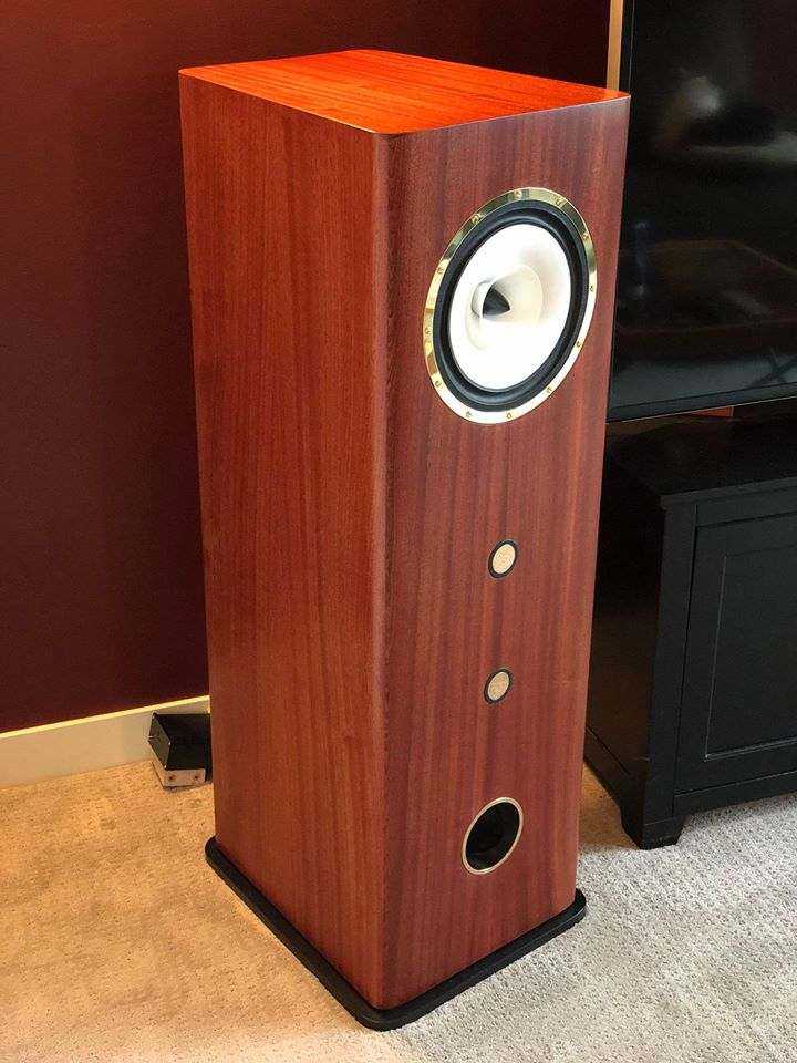

Aleks Napisano Maj 5, 2020 #1 Napisano Maj 5, 2020 Lepče ti poljubim https://songeraudio.com/products/driver/ Ikaro je reagovao/la na ovo 1

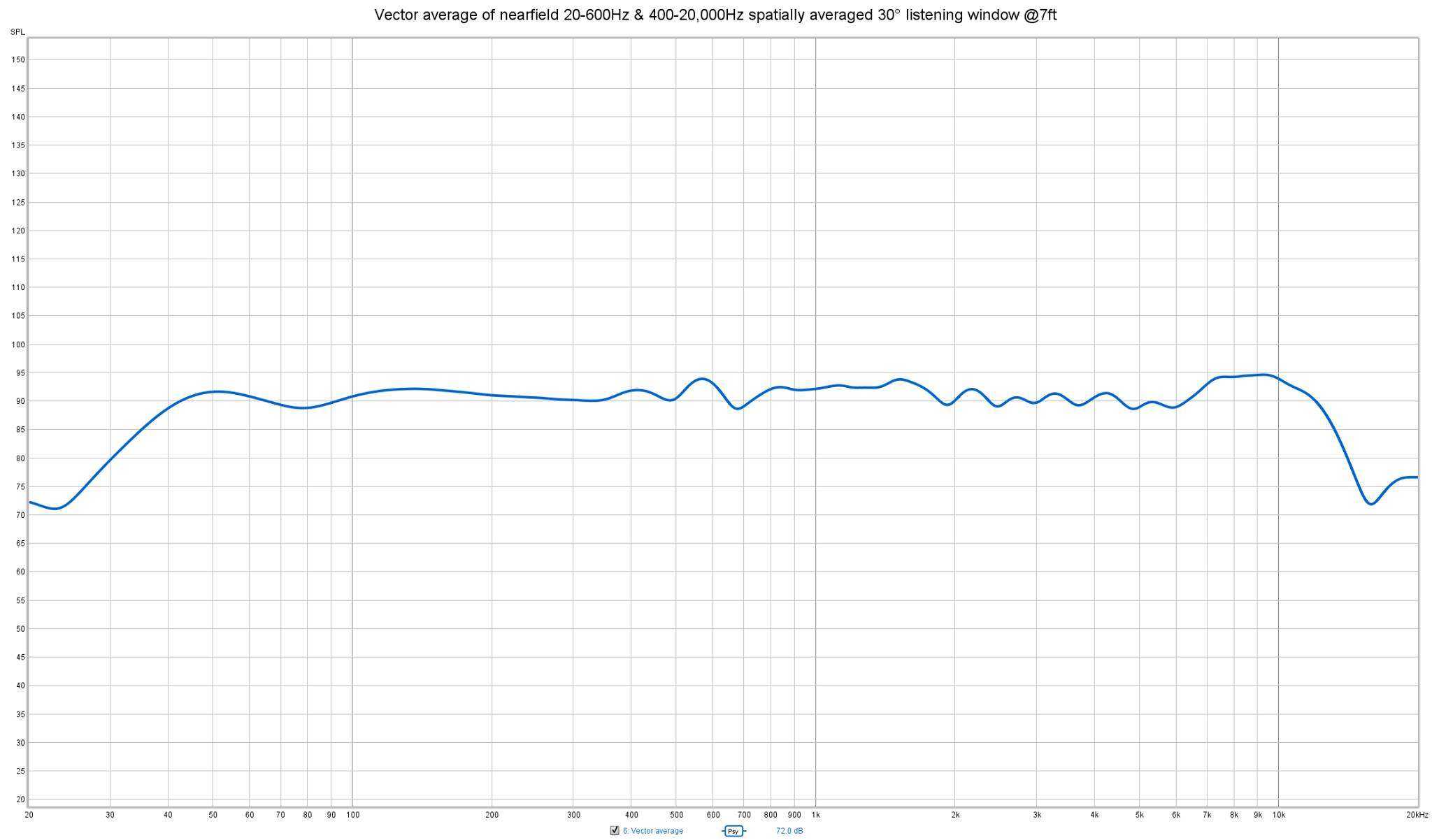

Koja Napisano Maj 5, 2020 #6 Napisano Maj 5, 2020 Blah, ko i svaka trubica Na grafikonu veliki smoothing i sigurno pola sata biran ugao iz koga snima Da vidimo off-axis grafikone Zbog izgleda i skupog oklopa pozadi, dobro kao srednjetonac za neki open baffle od pleksiglasa vladd and NIXIE je reagovao/la na ovo 1 1
Zen Mod Napisano Maj 5, 2020 #7 Napisano Maj 5, 2020 tesko da ce bude ovo je bre inzenjering do bola...... nirvana, pod uslovom da nisi alergican na FR ako jesi, dzaba

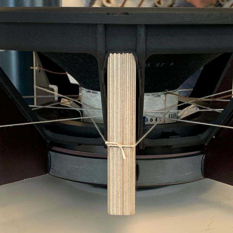

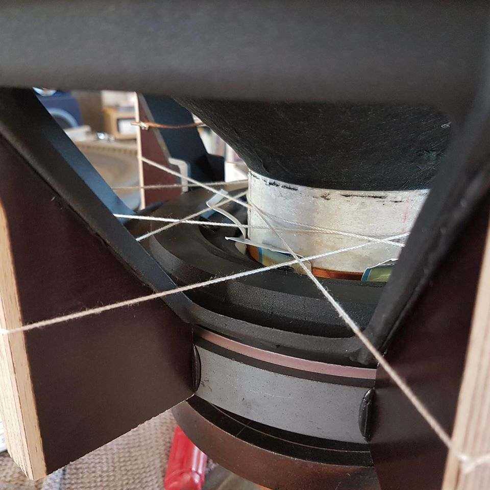

Aleks Napisano Maj 5, 2020 Autor #12 Napisano Maj 5, 2020 pre 3 minuta, predragm reče Sajder mu je fenomenalan! Genijalan. Spajder je patentirao, kolko sam razumeo. Citat The spider is unique, really - an important part of why the driver is special. I was advised by an industry CEO at a small event last year to patent it, and that was granted to me just a few months ago. It's a thermal polyurethane carbon fiber composite assembly held in a very specific, light tension - very durable, highly compliant, and likewise highly effective at centering the former. I've experimented at length with factory spiders, and nothing I've tried comes close to what it does for sound.

zoranzu Napisano Maj 6, 2020 #14 Napisano Maj 6, 2020 9 hours ago, predragm said: Sajder mu je fenomenalan! Genijalan. Vec vidjeno kod Duelunda,long time ago NIXIE je reagovao/la na ovo 1
NIXIE Napisano Maj 6, 2020 #15 Napisano Maj 6, 2020 Za te pare može mnogo (ali mnogo bolji) zvučnik da se napravi. FR kriva je previše zaobljena, ko zna kako stvarno izgleda, a visokih nema, treba mu super tweeter.

Leonardo Napisano Maj 6, 2020 #17 Napisano Maj 6, 2020 Duelund se igrao na ovu temu koristeći šustersku špagu. Tako može bilo koji samovac, samo da nabavi dasku bosanku i izračuna zategnutost špage. zika and 2a3 je reagovao/la na ovo 1 1
NIXIE Napisano Maj 6, 2020 #18 Napisano Maj 6, 2020 Meni to ne deluje kao nešto trajno. Viđao sam i DIY varijante toga sa strunom za pecanje, ma sve to je sporno na duže staze.
Leonardo Napisano Maj 6, 2020 #19 Napisano Maj 6, 2020 Bogami, ako je špaga od aramidnih vlakana, nadživeće i korpu drajvera. predragm je reagovao/la na ovo 1
neskor Napisano Maj 6, 2020 #20 Napisano Maj 6, 2020 Meni svi ti FR kao vojnicko cebe, kratko gore/ kratko dole NIXIE and Koja je reagovao/la na ovo 2
