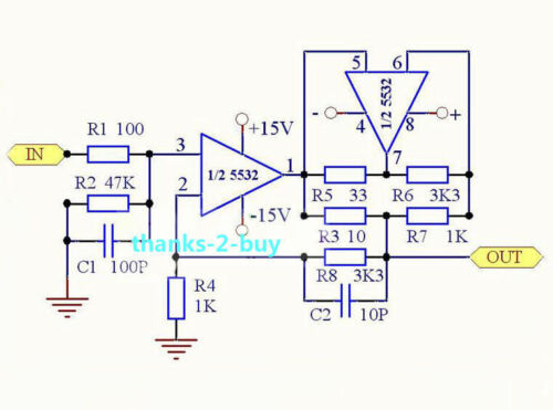

Zanimljiva šema, poručio dve PCB možda probam nekad. :smesna:
WWW.EBAY.COM
Note: item is Bare PCB , not contain other parts . The circuit board is used between the CD player and the amplifier stage, for headphone amplifier also has a very good sound effect. After the circuit board connected to the passive tone attenuation line has the ideal matching effect, performance is better than the ordinary amplification circuit.
WWW.EBAY.COM
1x Class AA OP Amp Preamp / Headphone Amplifier Bare PCB. Note: This item is a Bare PCB, not contain other parts. If you need assembled board. AA class amplifier wide range, High Definition force, rich in detail, driving strong, sound balance.
Evo šta kažu:
Panasonic AA class line is a voltage controlled amplifier and current drive amplifier constitute a bridge (see below), the voltage controlled amplifier in the equivalent to no-load status (ie the output current is zero), even if connected to a heavy load,even if it is not the same as the voltage and current waveforms of complex dynamic impedance, the voltage controlled amplifier can still work in Class A state, because of itsexcellent performance and near-perfect sound performance and loved by the people.

On 9/28/2022 at 11:44 AM, NIXIE said:
Zamolio bih nekog stručnijeg za prevod, kako to radi i šta radi? :bad_boys_20:
Aplicirana tzv "new class A", nestao nalik sto je radio najvecii audio konstruktor ikada, papa Nelson 70 i neke, gde glavni signal(I glavnu energiju nosi) radi bilo kakav amp(B ili tanki AB), a povratnu spregu popravke signala mu odradjuje amp u savrsenoj A klasi.
Papa je to odradio dok je radio u Tresholdu.

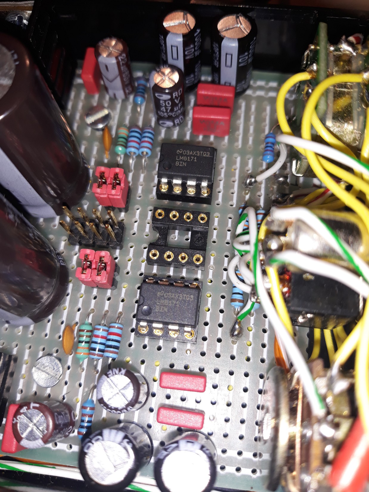

U međuvremenu sam pustio LM6171 da radi jedno 2 sata. Zvuči dobro, ali to je u rangu sa OPA1611/1612/1622. Burson V6C ima bogatiji zvuk, čak i OPA1611 mi malo zanimljivije zvuči. Ostali mi nisu tu pri ruci, ali nije ni bitno.
Doduše skroz su novi čipovi, nek rade par dana pa ću ponoviti test.
Koliko vidim po netu, LM6171 je najjeftiniji, OPA1611 je malo skuplji, dok je Burson V6C bas skuplji.
A zadnje pretpojacalo sa opampima sam pravio mislim pre 20 godina, sa TL 082 ako ne gresim. Sviralo jeste, korektno da, muzikalno ne...
Al eto, nikad se ne zna kad, zasto, kako se moze ukazati potreba za chip preampom...
