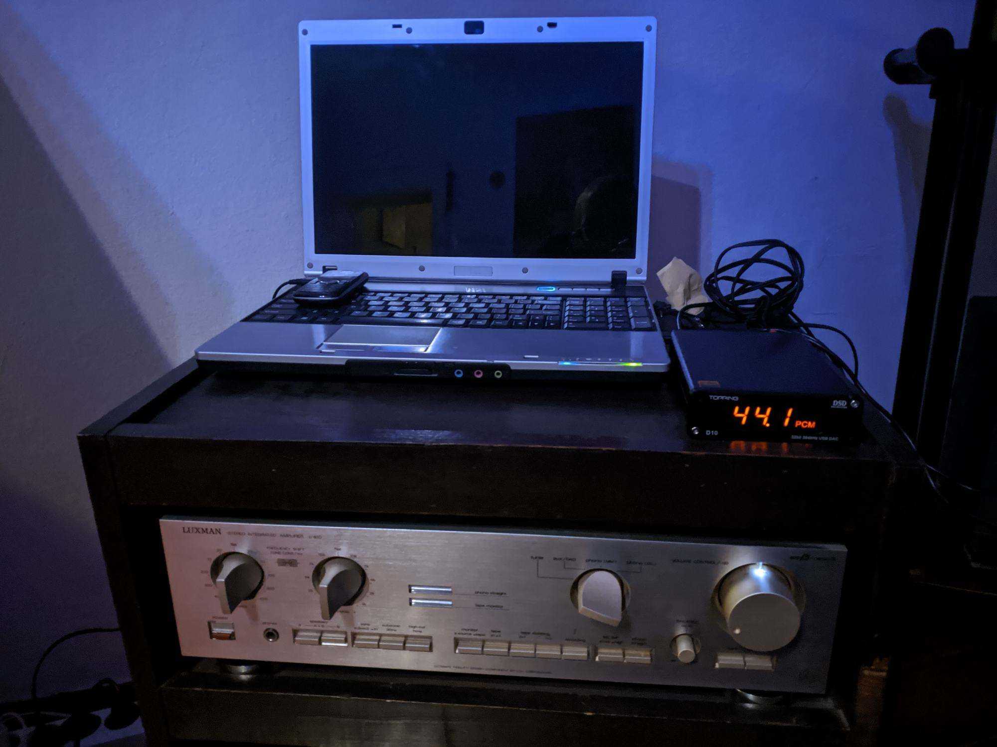

Mentok Napisano Jun 1, 2020 #707 Napisano Jun 1, 2020 whoa, Daphile mnogo lakši za instalaciju nego što sam mislio i još radi na raspad laptopu iz špajza od pre 15 godina Prepoznao bez problema i Toppinga sa svim podržanim modovima i Wi-Fi karticu na laptopu. Sad još malo komplikovano dok ne prokljuvim šerovanje fajlova kroz mrežu, a wifi upload je painfully spor, al pustio sam neki radio O zvuku ne znam ništa, trenutno mi nakačeni moji C zvučnici na moje B pojačalo vladd and Beli_Ninja je reagovao/la na ovo 1 1
Nesic Napisano Jun 1, 2020 #708 Napisano Jun 1, 2020 Probaj i Volumio. Evo kako da se spusti na HDD: NOTE: you will loose ALL the data on your HDD. - Flash Volumio 2 to a usb stick - Format another usb stick wit FAT32, and copy the unzipped downloaded x86 image to it. - Then boot from your usb volumio 2 stick. - Will until the UI is showing, the press ctrl-alt-F1 to open a terminal session - Log in with volumio/volumio - Type Code: Select all sudo blkid and check the output. - You should see /dev/sda, /dev/sdb and /dev/sdc (presuming you only have one disk in your x86 pc) The device with the labels "volumioboot", "volumioimg" and "volumiodata" is the one you booted from. The device with the single vfat partition is the stick with the volumio image, assume it is /dev/sdX (X being a, b, c...) The other device is your netbook's hdd, assume it is /dev/sdY (Y being a, b, c...) - When sure about the devices, type Code: Select all mkdir usb sudo mount /dev/sdX1 usb cd usb ls -l sudo dd if=fullnameofthevolumioimage of=/dev/sdY bs=4M sync cd .. sudo umount usb sudo rm -r usb poweroff - remove the usb sticks, reboot et voila Mentok je reagovao/la na ovo 1
Mentok Napisano Jun 1, 2020 #709 Napisano Jun 1, 2020 ću probam, negde sam čitao da valjda sa volumiom može da se namesti bit perfect volume kontrola interno u DAC-u za ovo Toppingče
ManicP Napisano Jun 2, 2020 #710 Napisano Jun 2, 2020 8 hours ago, Mentok said: ću probam, negde sam čitao da valjda sa volumiom može da se namesti bit perfect volume kontrola interno u DAC-u za ovo Toppingče U Daphile može da se isključi volume kontrola pa u dac stigne bit perfect. Ako je star komp valja probati preko browsera u settings uključiti neki grafički andrak, počne da koristi i monitor laptopa sa nekom maleckom rezolucijom pa se može i direkt na laptopu upravljati a prikaže i omot šta se sluša. Volumio probah, sviđa mi se ali bilo malo problema na kanti na kojoj sam ga koristio pa sam se vrnuo na Daphile. Imao sam utisak masnijeg basa sa njim (a i lepša mi polovina) neg sam imao tehnički problem i odustao...

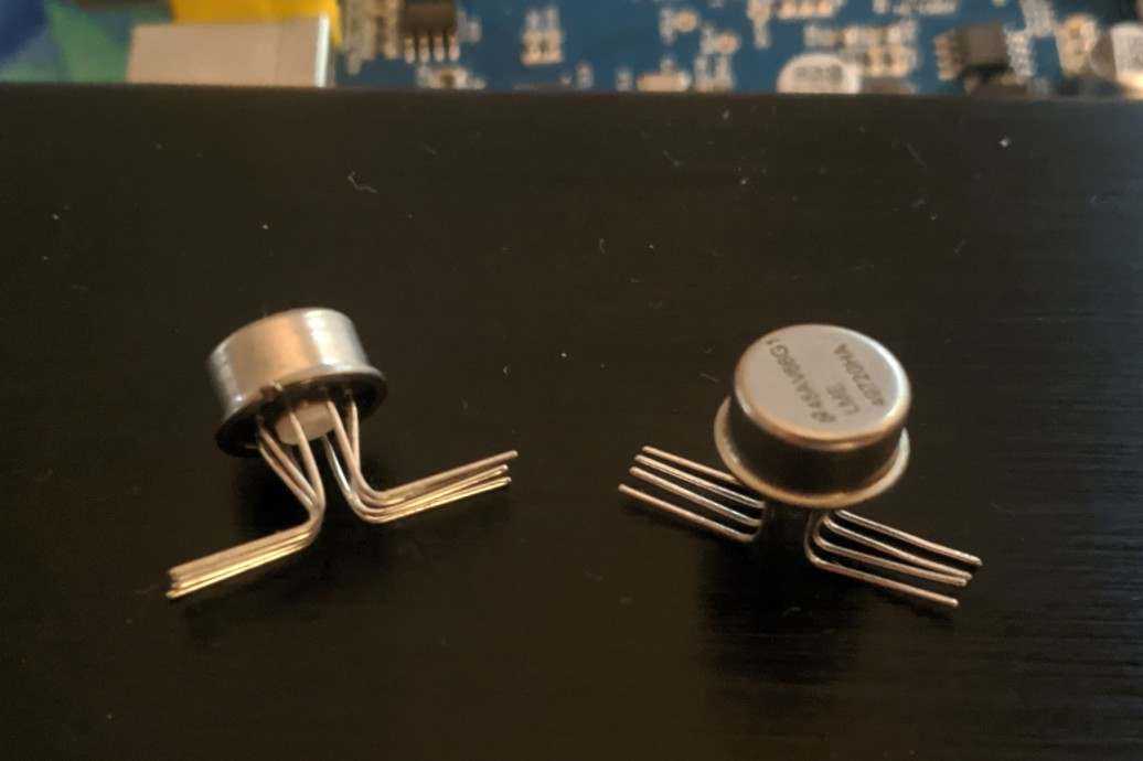

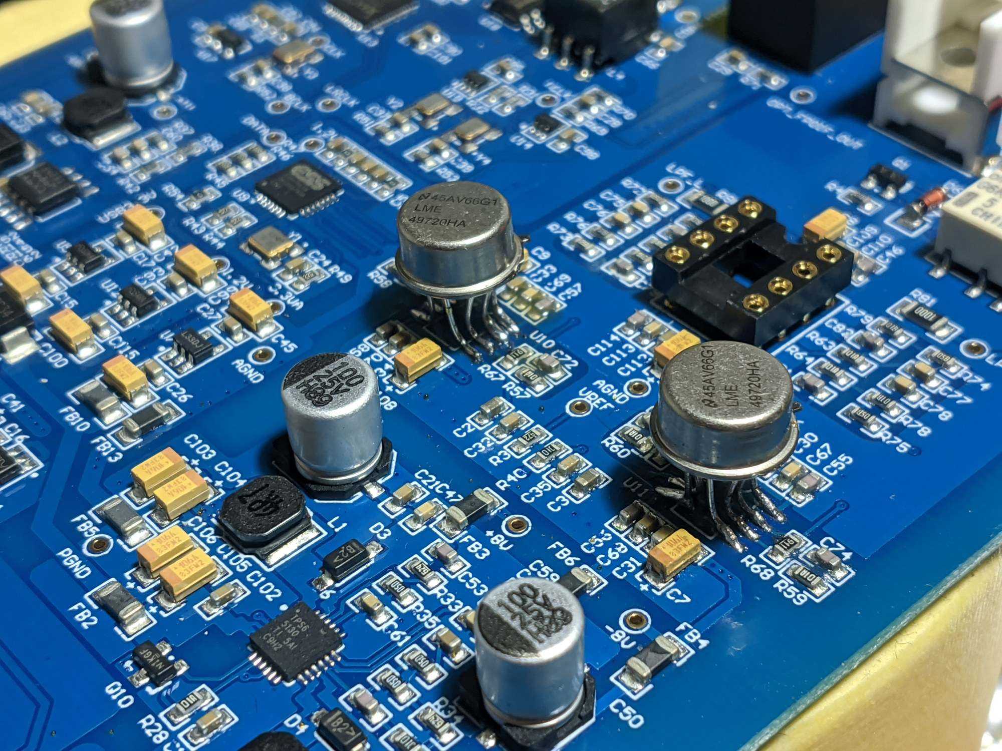

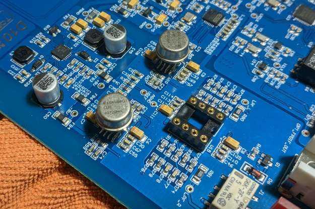

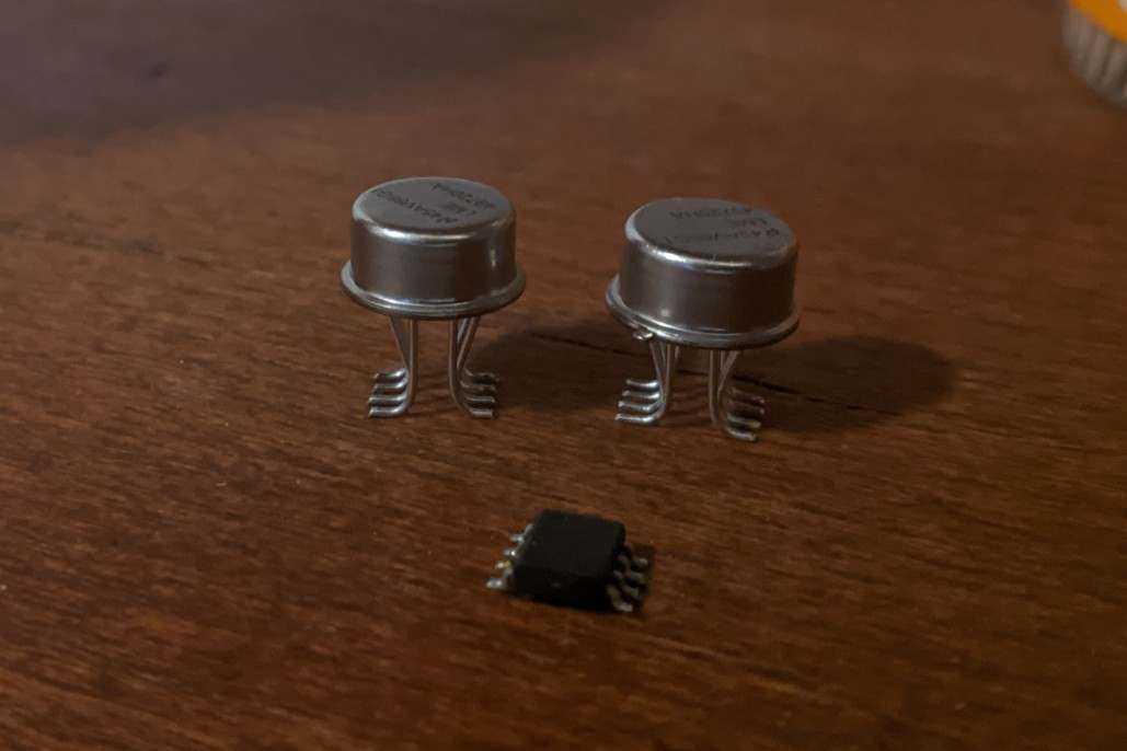

Mentok Napisano Jun 2, 2020 #711 Napisano Jun 2, 2020 eve, lemljenje je bilo skoro pa pič... dim, ali dok sam ih oblikovao na dimenziju, uhhh. lemovi su okej nego ni je najtanji tinol što sam imao 0,7mm, a i vrh na lemilici nije baš od najtanjih, mrzelo me da menjam vrh pa ostalo malo više kalaja na nožicama, al ko ga šiša... stefaca, Mikorist, krca44 and 4 ostalih je reagovao/la na ovo 4 3
Mikorist Napisano Jun 2, 2020 #713 Napisano Jun 2, 2020 pre 47 minuta, Mentok reče eve, lemljenje je bilo skoro pa pič... dim, ali dok sam ih oblikovao na dimenziju, uhhh. lemovi su okej nego ni je najtanji tinol što sam imao 0,7mm, a i vrh na lemilici nije baš od najtanjih, mrzelo me da menjam vrh pa ostalo malo više kalaja na nožicama, al ko ga šiša... sve je bolje od 2134.
Mentok Napisano Jun 2, 2020 #714 Napisano Jun 2, 2020 Pa ovo mi je bilo lokalno (čitaj - preko foruma) lako nabavljivo, a imam još neke AD826 SMD par, ali ajde reko ipak su ovi LME moderniji pa nek stoje. U filteru je trenutno OPA2111, tu ću tek da vidim šta ću, al otom potom, taj je lako menjati. Inače, nisam ni "upoređivao zvuk" pre i posle pošto mi je levo uvo začepljeno već treći dan pa slabo išta čujem oće to tako. Ali evo stigli opampi danas pa reko saću da vas zalemim ko bele lale...

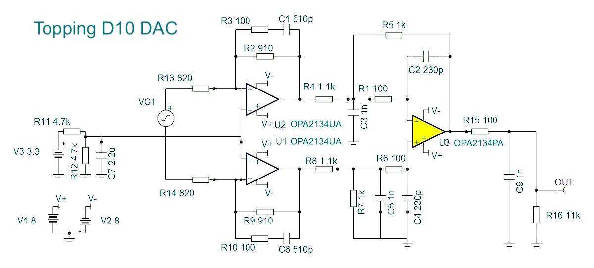

Zen Mod Napisano Jun 2, 2020 #715 Napisano Jun 2, 2020 skinu li ijedan deo seme analognog stepena ? odnosno - pojavi li se igde? onomad ne bese nesto da se nadje
Mentok Napisano Jun 2, 2020 #716 Napisano Jun 2, 2020 pa Mika je nešto kačio, ali ne znam da li je to bilo definitivno tačno, pogledaću ja jedan dan da ispratim vodove kolko mogu kad budem u meditativnom raspoloženju pa nacrtam kolko uspem da dešifrujem. mislim sićušno jeste, al opet samo dvoslojna štampa, znao sam da se snađem i po kokplikovanijim pcb-ovima
Zen Mod Napisano Jun 2, 2020 #718 Napisano Jun 2, 2020 e tacno me natera da ja sutra ili prekostra uzmem i izmerim Vout na 0db digisignala

Nesic Napisano Jun 3, 2020 #726 Napisano Jun 3, 2020 Te opampe u D10 bi valjalo napajati posebnim napajanjem.
