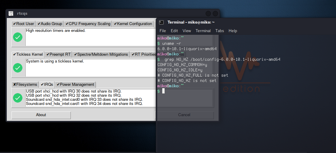

Mikorist Napisano Februar 16, 2023 #1762 Napisano Februar 16, 2023 pre 8 minuta, zika reče Tickless or not? Koliko vidim liqourix (damentz) ... 6.1.12-1 je rešio dosta štucanja sa preemtion, koliko vidim pod prstima, probe radi... apgrejdovat cu kernel na 6.1 stoji ovako podeseno CONFIG_NO_HZ_COMMON=y CONFIG_NO_HZ_IDLE=y # CONFIG_NO_HZ_FULL is not set # CONFIG_NO_HZ is not set
zika Napisano Februar 16, 2023 #1763 Napisano Februar 16, 2023 (izmenjeno) 11 minutes ago, Mikorist said: apgrejdovat cu kernel na 6.1 stoji ovako podeseno CONFIG_NO_HZ_COMMON=y CONFIG_NO_HZ_IDLE=y # CONFIG_NO_HZ_FULL is not set # CONFIG_NO_HZ is not set Da ne bi bilo nesporazuma... Ima nejasnoća u nazivima... https://www.kernel.org/doc/Documentation/timers/NO_HZ.txt CONFIG_NO_HZ_FULL selects CONFIG_NO_HZ_COMMON, so you cannot run adaptive ticks without also running dyntick idle. This dependency extends down into the implementation, so that all of the costs of CONFIG_NO_HZ_IDLE are also incurred by CONFIG_NO_HZ_FULL. NO_HZ: Reducing Scheduling-Clock Ticks — The Linux Kernel documentation WWW.KERNEL.ORG Izmenjeno Februar 16, 2023 od zika
Mikorist Napisano Februar 16, 2023 #1764 Napisano Februar 16, 2023 miko@miko:~ $ grep irq /etc/default/grub GRUB_CMDLINE_LINUX_DEFAULT="quiet iommu=soft mitigations=off threadirqs splash" miko@miko:~ $ grep NO_HZ /boot/config-6.0.0-10.1-liquorix-amd64 CONFIG_NO_HZ_COMMON=y CONFIG_NO_HZ_IDLE=y # CONFIG_NO_HZ_FULL is not set # CONFIG_NO_HZ is not set miko@miko:~ $ grep noatime /etc/fstab UUID=f1f947c8-da79-494b-aed6-785d48522abd / ext4 discard,noatime 1 1 UUID=ec53ea3d-267a-45cc-bf08-e425d5b3c7e1 /home ext4 discard,noatime 1 2 UUID=95F5-0D86 /boot/efi vfat noatime,dmask=0002,fmask=0113 0 0 miko@miko:~ $ sudo cat /proc/timer_list Timer List Version: v0.9 HRTIMER_MAX_CLOCK_BASES: 8 now at 14125999003449 nsecs cpu: 0 clock 0: .base: 0000000060acd70a .index: 0 .resolution: 1 nsecs .get_time: ktime_get .offset: 0 nsecs active timers: #0: <000000008d9165ca>, tick_sched_timer, S:01 # expires at 14125999252250-14125999252250 nsecs [in 248801 to 248801 nsecs] #1: <0000000056918a32>, hrtick, S:01 # expires at 14125999562309-14125999562309 nsecs [in 558860 to 558860 nsecs] #2: <000000009891ea5c>, hrtimer_wakeup, S:01 # expires at 14126000000275-14126000893616 nsecs [in 996826 to 1890167 nsecs] #3: <00000000a50d065f>, hrtimer_wakeup, S:01 # expires at 14126246670528-14126247670297 nsecs [in 247667079 to 248666848 nsecs] #4: <00000000fe61dc49>, hrtimer_wakeup, S:01 # expires at 14126504585649-14126505105648 nsecs [in 505582200 to 506102199 nsecs] #5: <00000000c02b8651>, hrtimer_wakeup, S:01 # expires at 14126619614659-14126620613658 nsecs [in 620611210 to 621610209 nsecs] #6: <000000003040ec4d>, hrtimer_wakeup, S:01 # expires at 14126836532134-14126836582134 nsecs [in 837528685 to 837578685 nsecs] #7: <00000000a215aec1>, hrtimer_wakeup, S:01 # expires at 14126839754630-14126839804630 nsecs [in 840751181 to 840801181 nsecs] #8: <00000000c874e835>, hrtimer_wakeup, S:01 # expires at 14127000300318-14127004296317 nsecs [in 1001296869 to 1005292868 nsecs] #9: <00000000df4d4887>, hrtimer_wakeup, S:01 # expires at 14127941398376-14127943398375 nsecs [in 1942394927 to 1944394926 nsecs] #10: <00000000b659340a>, hrtimer_wakeup, S:01 # expires at 14128620306948-14128624302947 nsecs [in 2621303499 to 2625299498 nsecs] #11: <0000000046329190>, hrtimer_wakeup, S:01 # expires at 14129000416429-14129050206427 nsecs [in 3001412980 to 3051202978 nsecs] #12: <000000002d8cc090>, hrtimer_wakeup, S:01 # expires at 14130008674678-14130038682677 nsecs [in 4009671229 to 4039679228 nsecs] #13: <00000000435e4885>, hrtimer_wakeup, S:01 # expires at 14130436315636-14130441315635 nsecs [in 4437312187 to 4442312186 nsecs] #14: <000000007f9926de>, hrtimer_wakeup, S:01 # expires at 14133656001782-14133656051782 nsecs [in 7656998333 to 7657048333 nsecs] #15: <0000000007e344a0>, hrtimer_wakeup, S:01 # expires at 14136104013401-14136104063401 nsecs [in 10105009952 to 10105059952 nsecs] #16: <000000007df657fb>, hrtimer_wakeup, S:01 # expires at 14140257902569-14140257952569 nsecs [in 14258899120 to 14258949120 nsecs] #17: <000000004dc27bc2>, hrtimer_wakeup, S:01 # expires at 14140462273684-14140492273683 nsecs [in 14463270235 to 14493270234 nsecs] #18: <00000000cc04a95f>, hrtimer_wakeup, S:01 # expires at 14152457067926-14152487067925 nsecs [in 26458064477 to 26488064476 nsecs] #19: <0000000093fec01d>, hrtimer_wakeup, S:01 # expires at 14155570230451-14155570280451 nsecs [in 29571227002 to 29571277002 nsecs] #20: <000000004a63d8b8>, hrtimer_wakeup, S:01 # expires at 14157916176946-14157916226946 nsecs [in 31917173497 to 31917223497 nsecs] #21: <00000000442abebd>, hrtimer_wakeup, S:01 # expires at 14406541245662-14406541245662 nsecs [in 280542242213 to 280542242213 nsecs] #22: <00000000523d9142>, hrtimer_wakeup, S:01 # expires at 86408998931119-86409098931119 nsecs [in 72282999927670 to 72283099927670 nsecs] #23: <0000000010575e92>, hrtimer_wakeup, S:01 # expires at 99072000498747-99072100498747 nsecs [in 84946001495298 to 84946101495298 nsecs] #24: <000000000fe68944>, hrtimer_wakeup, S:01 # expires at 2148093466983124-2148093566983124 nsecs [in 2133967467979675 to 2133967567979675 nsecs] clock 1: .base: 000000000bff3270 .index: 1 .resolution: 1 nsecs .get_time: ktime_get_real .offset: 1676524038303812479 nsecs itd ponavlja se za sve nastavak... Tick Device: mode: 1 Per CPU device: 4 Clock Event Device: lapic-deadline max_delta_ns: 1296538872401 min_delta_ns: 1000 mult: 14227683 shift: 25 mode: 3 next_event: 14126834903539 nsecs set_next_event: lapic_next_deadline shutdown: lapic_timer_shutdown periodic: lapic_timer_set_periodic oneshot: lapic_timer_set_oneshot oneshot stopped: lapic_timer_shutdown event_handler: hrtimer_interrupt retries: 94 Wakeup Device: <NULL> Tick Device: mode: 1 Per CPU device: 5 Clock Event Device: lapic-deadline max_delta_ns: 1296538872401 min_delta_ns: 1000 mult: 14227683 shift: 25 mode: 3 next_event: 14140066478539 nsecs set_next_event: lapic_next_deadline shutdown: lapic_timer_shutdown periodic: lapic_timer_set_periodic oneshot: lapic_timer_set_oneshot oneshot stopped: lapic_timer_shutdown event_handler: hrtimer_interrupt retries: 1106 Wakeup Device: <NULL> Tick Device: mode: 1 Per CPU device: 6 Clock Event Device: lapic-deadline max_delta_ns: 1296538872401 min_delta_ns: 1000 mult: 14227683 shift: 25 mode: 3 next_event: 14126840015058 nsecs set_next_event: lapic_next_deadline shutdown: lapic_timer_shutdown periodic: lapic_timer_set_periodic oneshot: lapic_timer_set_oneshot oneshot stopped: lapic_timer_shutdown event_handler: hrtimer_interrupt retries: 147 Wakeup Device: <NULL> Tick Device: mode: 1 Per CPU device: 7 Clock Event Device: lapic-deadline max_delta_ns: 1296538872401 min_delta_ns: 1000 mult: 14227683 shift: 25 mode: 3 next_event: 14126000252250 nsecs set_next_event: lapic_next_deadline shutdown: lapic_timer_shutdown periodic: lapic_timer_set_periodic oneshot: lapic_timer_set_oneshot oneshot stopped: lapic_timer_shutdown event_handler: hrtimer_interrupt retries: 212 Wakeup Device: <NULL>
Mikorist Napisano Februar 16, 2023 #1765 Napisano Februar 16, 2023 A ovako su podeseni IRQs za onaj DAC USB i ALC hda codec USB port xhci_hcd with IRQ 30 does not share its IRQ. USB port xhci_hcd with IRQ 32 does not share its IRQ. Soundcard snd_hda_intel:card0 with IRQ 33 does not share its IRQ. Soundcard snd_hda_intel:card1 with IRQ 34 does not share its IRQ.

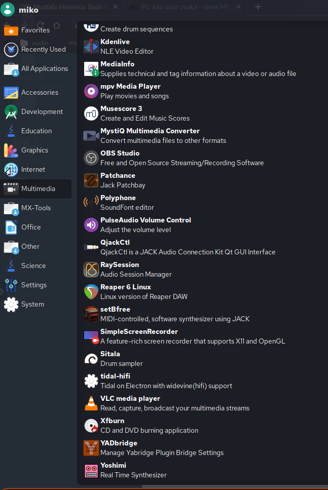

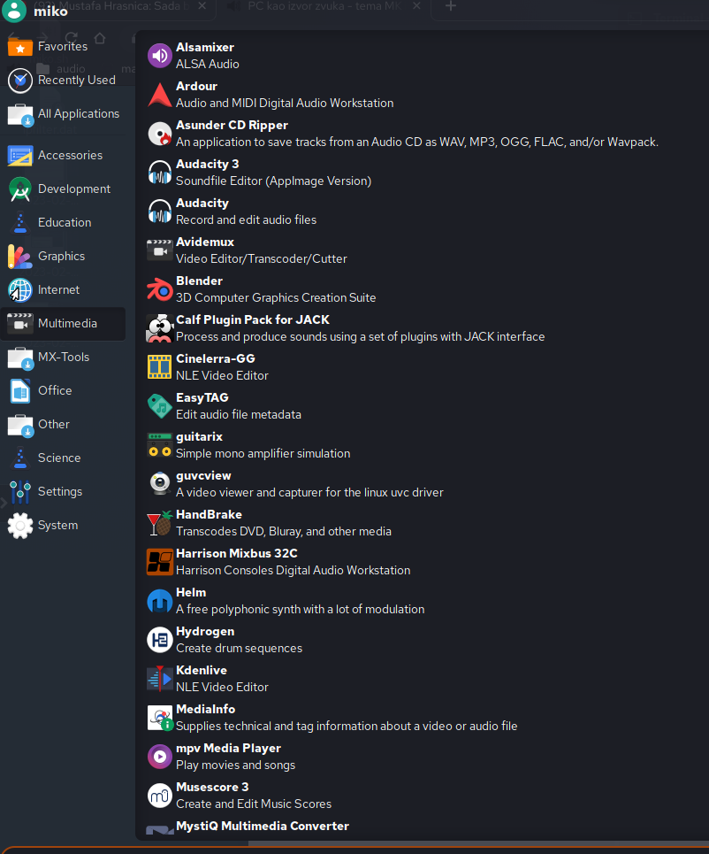

Mikorist Napisano Februar 16, 2023 #1774 Napisano Februar 16, 2023 Svira ovaj AV Linux za medalju. I ovako podesen na default. Sa nekim manjiom izmenama i dopunama je Vix, Srecko and Lemić je reagovao/la na ovo 1 2
asimze Napisano Februar 16, 2023 #1775 Napisano Februar 16, 2023 @Mikorist opet si se popalio i malo te je teško pratiti! Koje slovce više nije na odmet. Dal ovaj Linux ima svoj player ili treba instalisati neki drugi? Lemić je reagovao/la na ovo 1

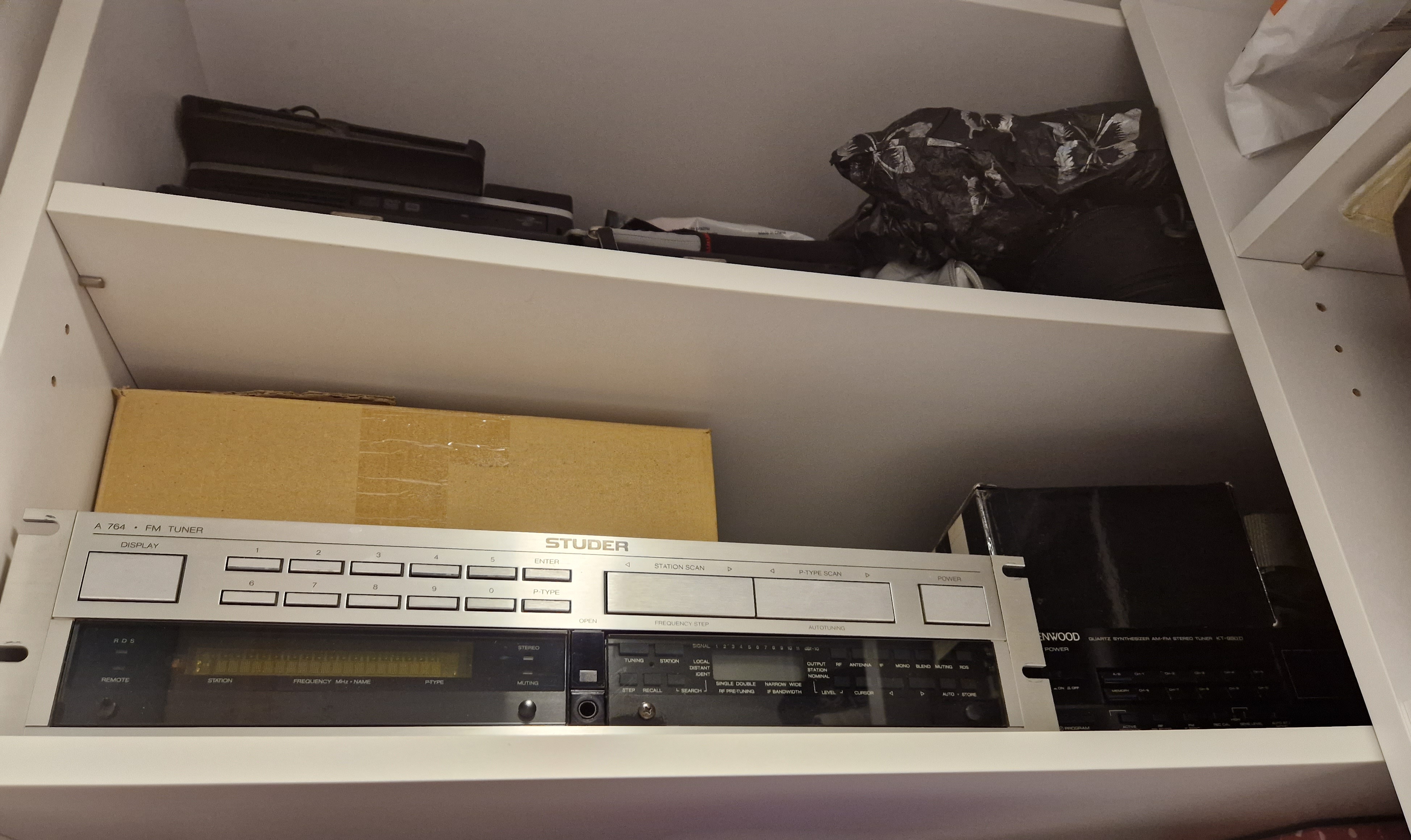

Srecko Napisano Februar 16, 2023 #1776 Napisano Februar 16, 2023 3 minutes ago, Zen Mod said: moze li se MAC upucati, umesto IP? Ipad neće (isto IOS) a OSX nisam probao (odlična ideja, probaću kad budem imao vremena, to mi je baš veliki posao da ga izvadim odmah me uhvati aritmija od stalnog penjanja na stolicu😁 a Mac Book Pro mi je u nekoj torbi, u nekoj od polica pa treba da izvadim gomilu stvari da bih ga našao i došao do njega, npr. Kenwood tjuner KT-990D, Študer tjuner A764, računara, kablova .... svašta nešto).

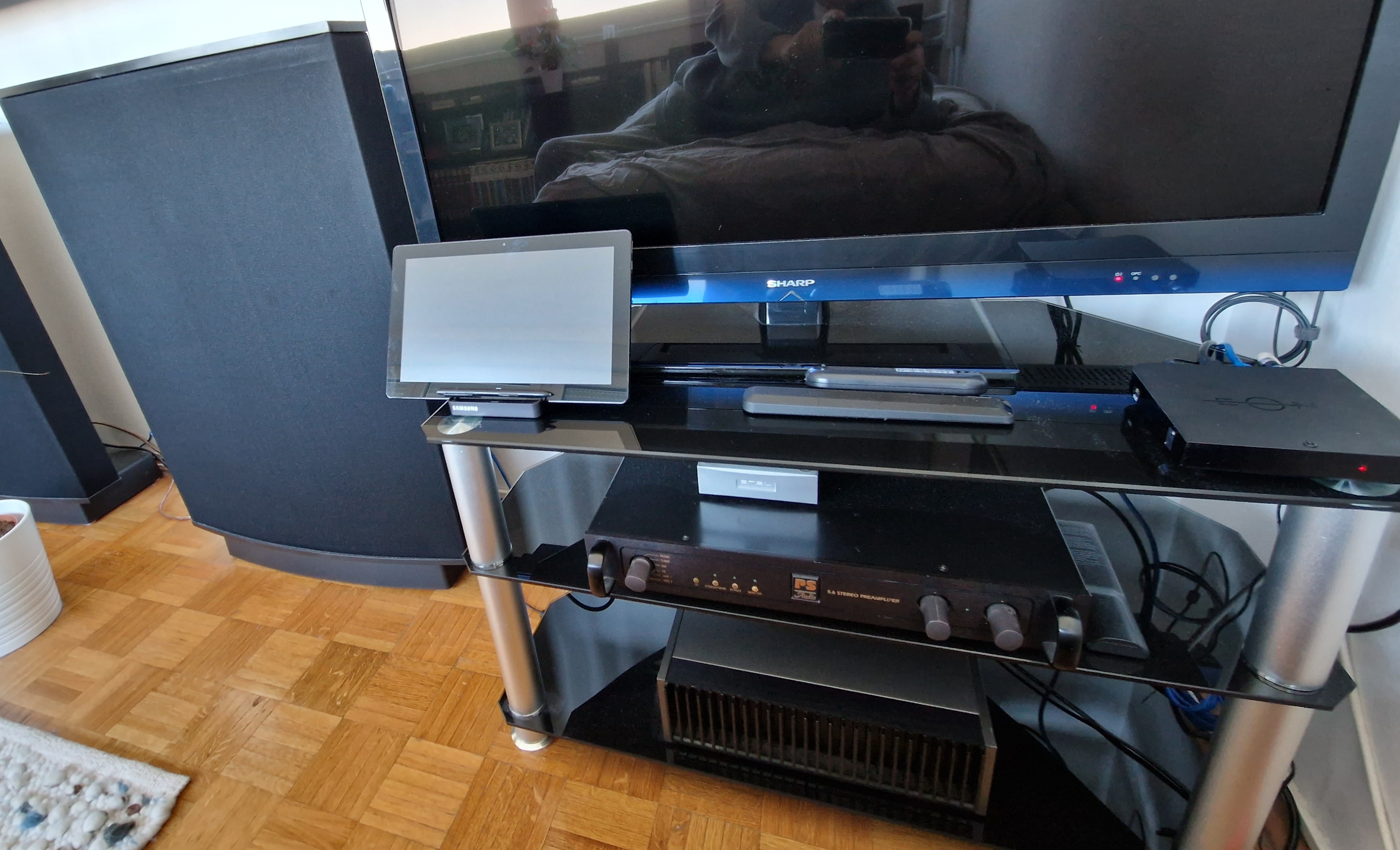

Srecko Napisano Februar 16, 2023 #1777 Napisano Februar 16, 2023 Sin mi to donese čim on kupi sebi nov, a meni žao da bacam sve je to super za mene, staro 5-6 godina (mnogo mlađe od mene😁). Moram da priznam da se ni ne sećam gde sam ga tačno stavio (to mi se inače nikad😁 ne dešava) jer sam ga sklonio iz sistema "B" zbog veličine-smetao mi je, i stavio neki Samsung Windows tablet sa olovkom (malecki je, koji sklonim u policu kad ne probam Quad ESL 63 svakih 3-4 meseca da me želja mine)😁. Lemić je reagovao/la na ovo 1

Vix Napisano Februar 16, 2023 #1779 Napisano Februar 16, 2023 57 minutes ago, Mikorist said: Svira ovaj AV Linux za medalju. I ovako podesen na default. Sa nekim manjiom izmenama i dopunama je Moze se instalira Tidal na njega?

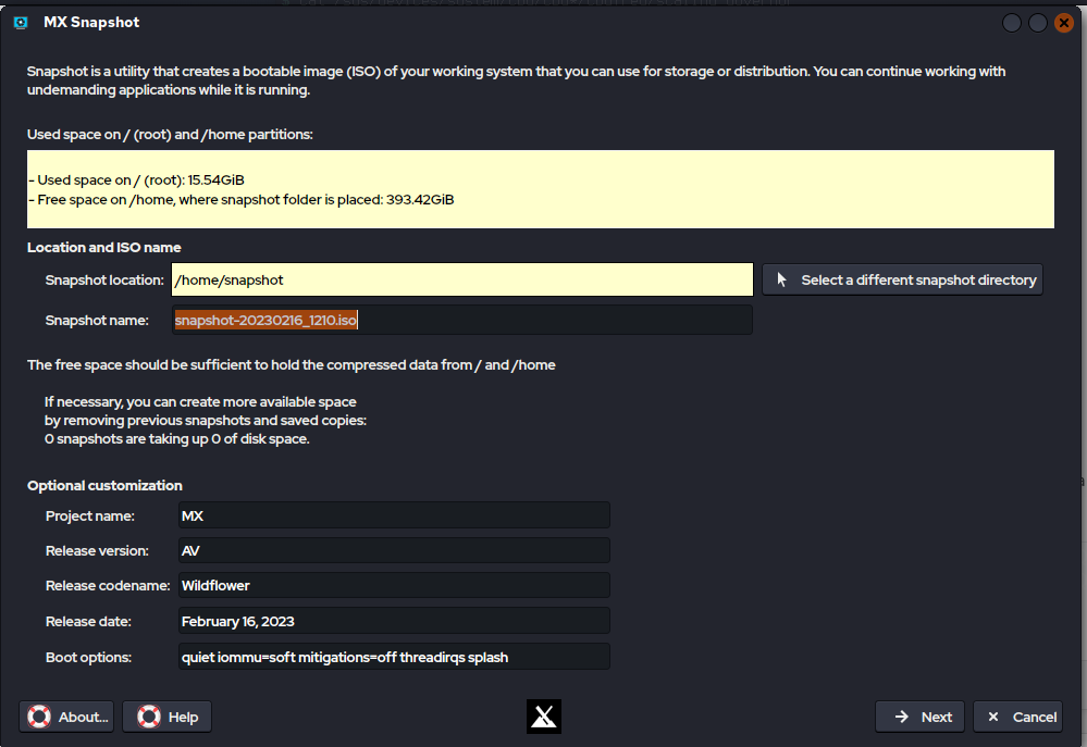

Mikorist Napisano Februar 16, 2023 #1780 Napisano Februar 16, 2023 Pre sat vremena, asimze reče Dal ovaj Linux ima svoj player ili treba instalisati neki drugi? Ama gomile plejera i alata za Audio - isto toliko mnogo i za VIdeo Doinstaliras par njih ako ti treba vise. Recimo Album Player mi je dovoljan. Video kako se renderuje ovde i procesira je takodje TOP topova Verovatno moze povrh svega ovoga i SnakeOil da se instalira - nisam probao....I jednom kada podesis - napravis ISO backup celog sistema - ako nesto posle ne radi samo pregazis sistem. Cak su i ikonice na istome mestu. LightMatic, Srecko and Lemić je reagovao/la na ovo 1 2

Mikorist Napisano Februar 16, 2023 #1782 Napisano Februar 16, 2023 pre 21 minuta, Mikorist reče Cak ne moras ni ti da podesavas. Recimo Kuja sve podesi za SnakeOil uradi MX Snapshot - okacimo na server i posle svi imaju isti SnakeOil -aktivirana licenca...Ili sta god ti padne na pamet..... Kuja, Srecko and Lemić je reagovao/la na ovo 2 1
