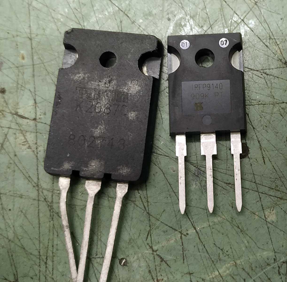

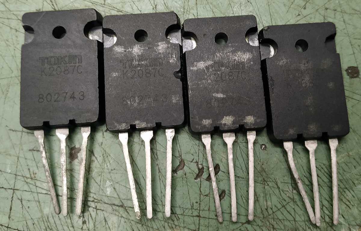

Zen Mod Napisano Maj 26, 2022 Autor #4146 Napisano Maj 26, 2022 https://www.diyaudio.com/community/threads/odd-sit-vfet-2sk2087c.385288/ 24kom je na carini
shonne Napisano Maj 26, 2022 #4147 Napisano Maj 26, 2022 😁🤗 vladd and LightMatic je reagovao/la na ovo 2
LightMatic Napisano Maj 26, 2022 #4148 Napisano Maj 26, 2022 pre 55 minuta, Zen Mod reče Čččččestitam, po-stali ste majk-a.
shonne Napisano Maj 26, 2022 #4149 Napisano Maj 26, 2022 58 minutes ago, Zen Mod said: Velicina u odnosu na klasican mosfet ne igra nikakvu ulogu. Megalomanija na delu 😁💪
Zen Mod Napisano Maj 26, 2022 Autor #4150 Napisano Maj 26, 2022 mala kolicina je kupljena, odjednom ih nema nigde nije ih ni Nele dobio, no stock na Aliju i ako sta bude, javlja mi se, komad ce bude 100$ LightMatic and shonne je reagovao/la na ovo 2
shonne Napisano Maj 26, 2022 #4151 Napisano Maj 26, 2022 5 minutes ago, Zen Mod said: mala kolicina je kupljena, odjednom ih nema nigde nije ih ni Nele dobio, no stock na Aliju i ako sta bude, javlja mi se, komad ce bude 100$ Po koliko komada bi trebalo da idu u izlaz? Da li se ima neka predstava, hoces li sa necim da kombinujes?

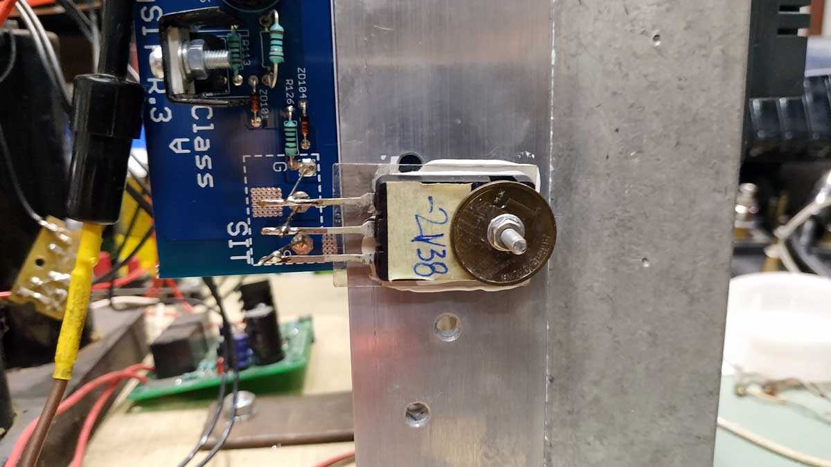

Zen Mod Napisano Maj 26, 2022 Autor #4152 Napisano Maj 26, 2022 https://www.diyaudio.com/community/threads/odd-sit-vfet-2sk2087c.385288/post-7031788

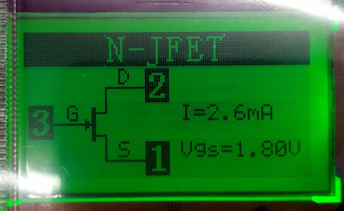

Zen Mod Napisano Maj 26, 2022 Autor #4154 Napisano Maj 26, 2022 Uds 24V Iq 1A8 gate current approx 20uA (0mV2 across 100R gate resistor) shonne and LightMatic je reagovao/la na ovo 2

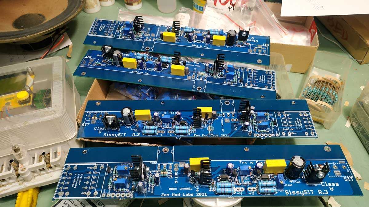

Zen Mod Napisano Maj 27, 2022 Autor #4155 Napisano Maj 27, 2022 On 5/26/2022 at 4:47 PM, Zen Mod said: https://www.diyaudio.com/community/threads/odd-sit-vfet-2sk2087c.385288/post-7031788 see here : https://www.diyaudio.com/community/threads/zms-2sk2087c-musings-phase-one-sissysit-as-cradle.386654/ shonne and LightMatic je reagovao/la na ovo 2
Zen Mod Napisano Maj 27, 2022 Autor #4157 Napisano Maj 27, 2022 zvuk, spooky, as it needs to be ne znam da li ce stici do W. , tesko da uklopim u raspored shonne je reagovao/la na ovo 1
Zen Mod Napisano Maj 27, 2022 Autor #4158 Napisano Maj 27, 2022 56 minutes ago, Zen Mod said: see here : https://www.diyaudio.com/community/threads/zms-2sk2087c-musings-phase-one-sissysit-as-cradle.386654/ LightMatic, chakija and shonne je reagovao/la na ovo 2 1
