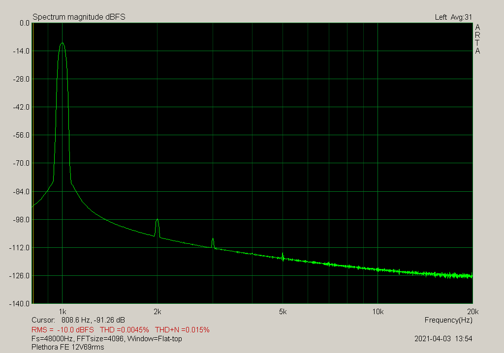

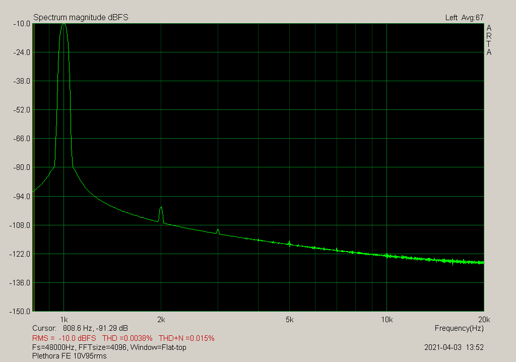

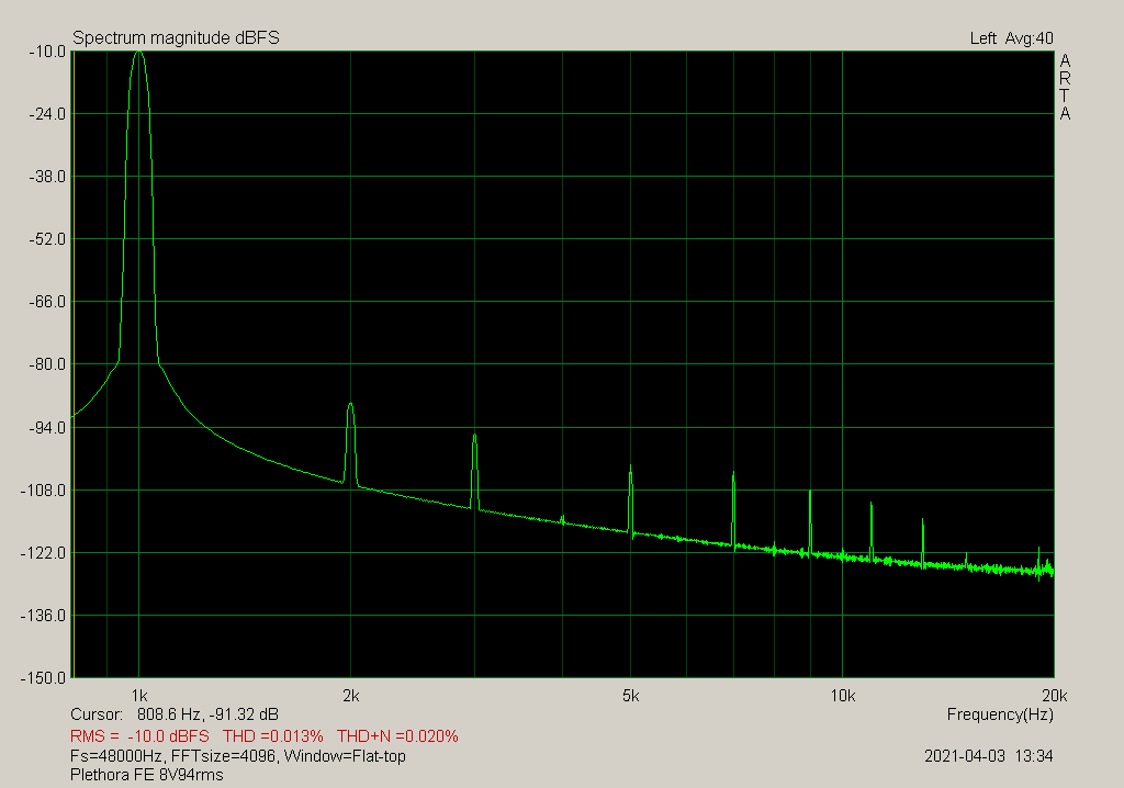

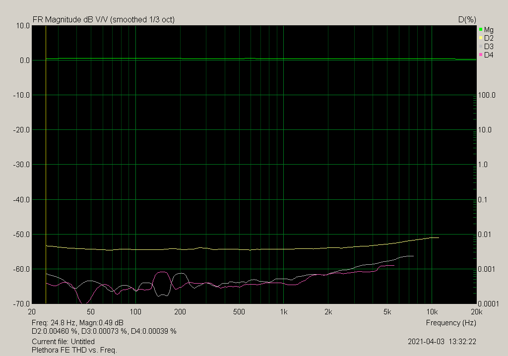

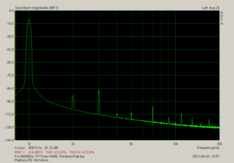

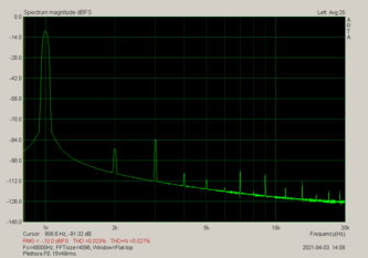

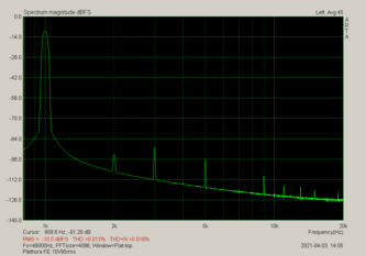

Zen Mod Napisano April 3, 2021 Autor #3358 Napisano April 3, 2021 22R zajednicki degeneration resistor u LTP, najveci OLG, najvise NFB

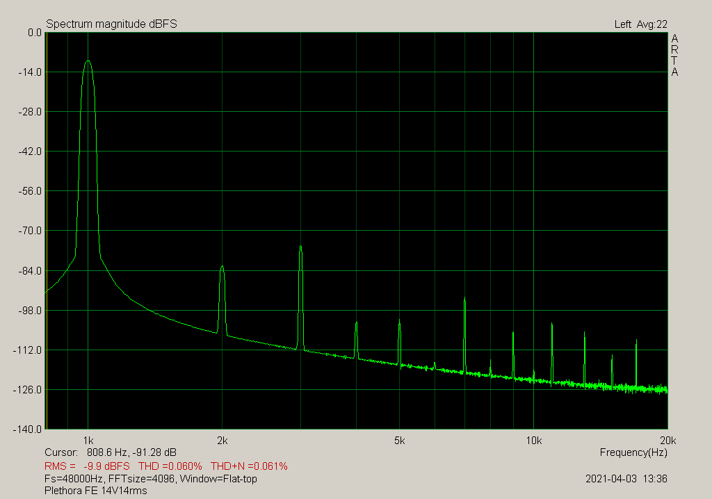

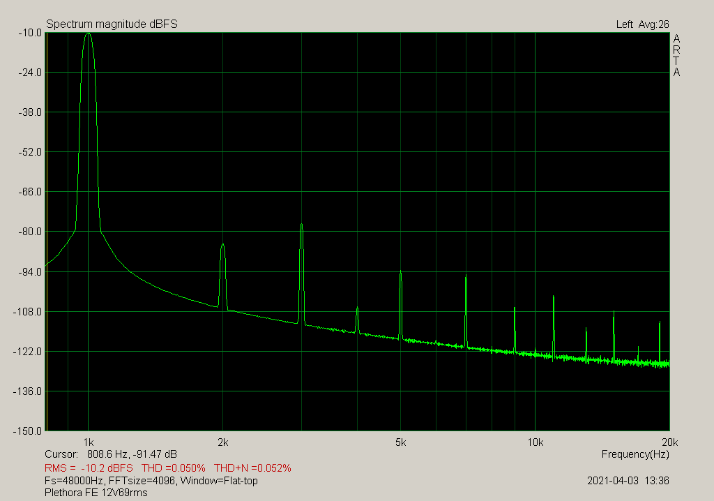

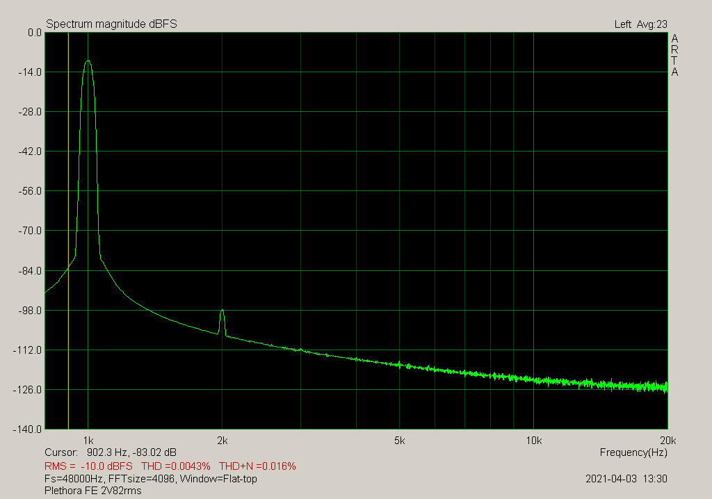

Zen Mod Napisano April 3, 2021 Autor #3359 Napisano April 3, 2021 druga krajnost 510R zajednicki degeneration resistor u LTP, manji OLG, manje NFB

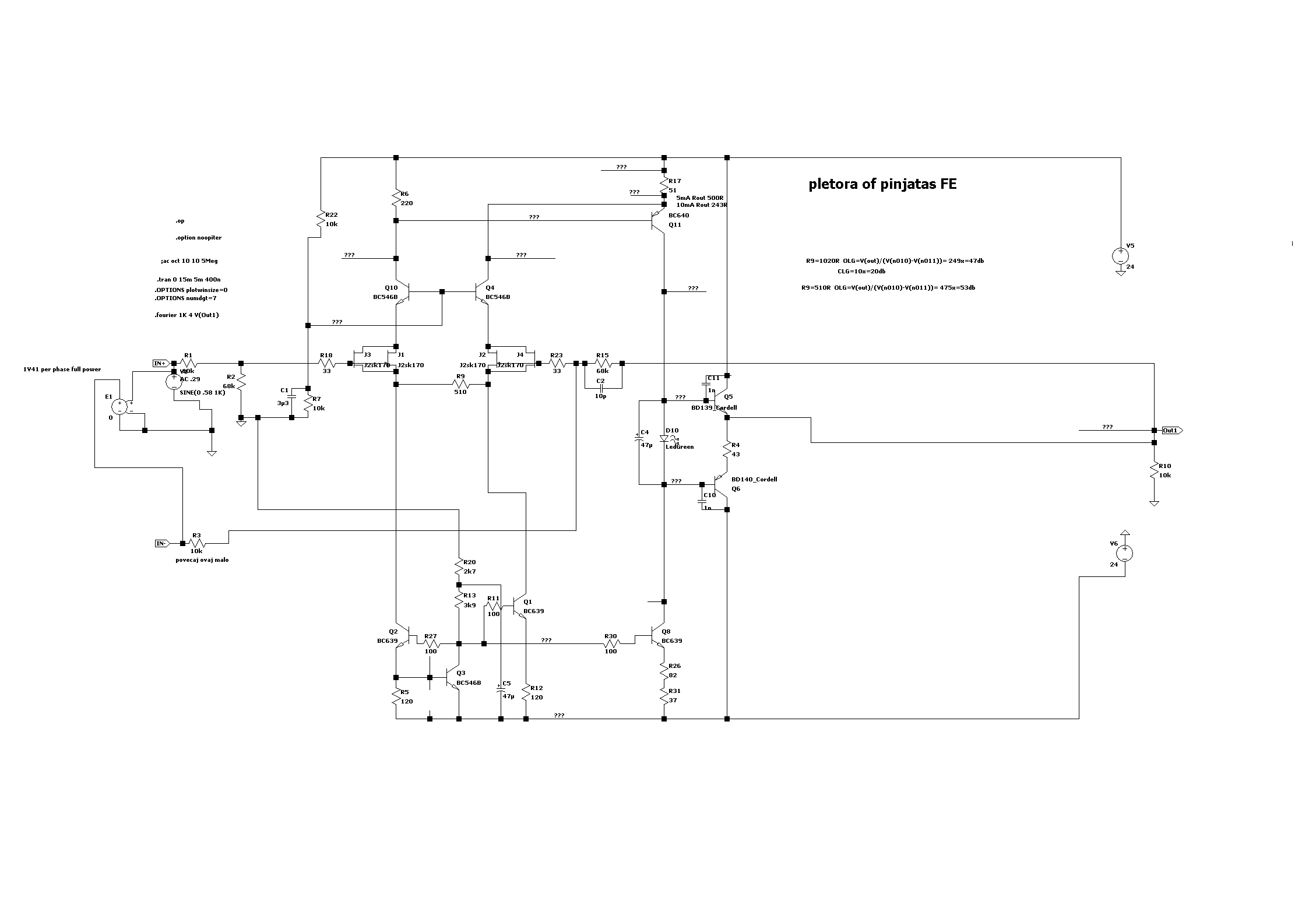

Zen Mod Napisano April 3, 2021 Autor #3360 Napisano April 3, 2021 eo vam i sema mutayu je reagovao/la na ovo 1

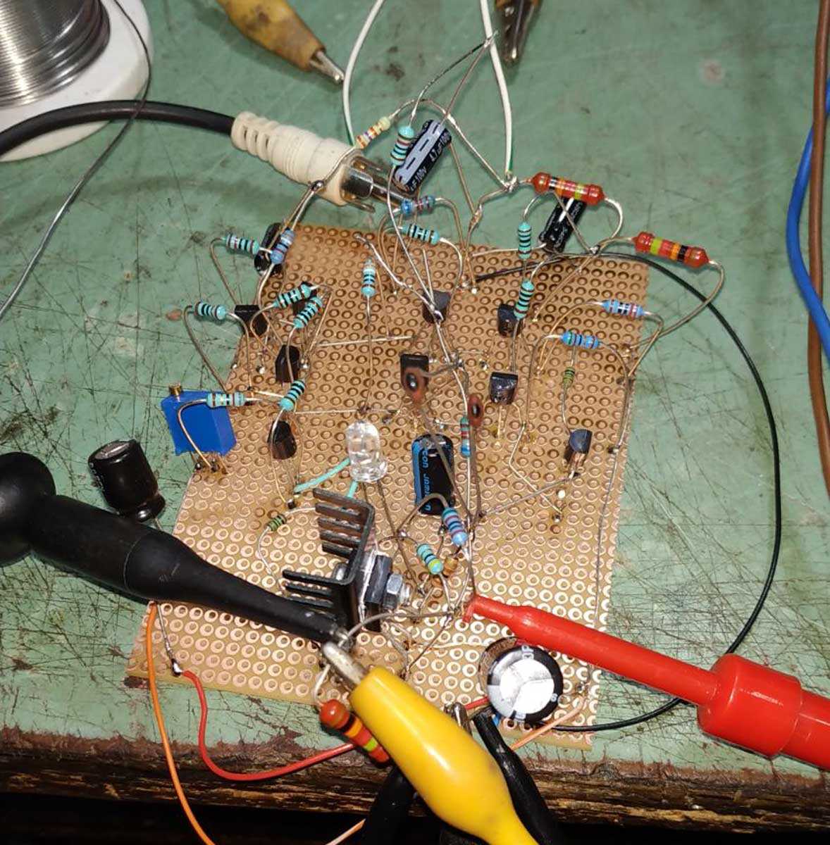

Mentok Napisano April 3, 2021 #3363 Napisano April 3, 2021 trebo bi ti neki Zen Mod R.2 samo da vodi evidenciju o uradcima 8 minutes ago, Zen Mod said:
