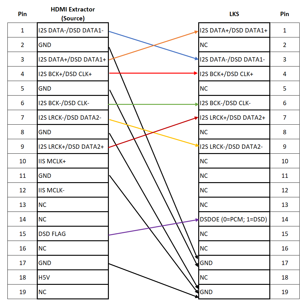

Mikorist Napisano Mart 8, 2023 Share #5153 Napisano Mart 8, 2023 pre 30 minuta, Brijac reče No, previse se zatrpava tema, moracemo napraviti jednu gde cemo isfiltrirati sadrzaj za izradu. I neku drugu temu kako I2S sprovesti direkt sa PC. Neki nov prenos signala I2S over HDMI ? HDMI/MHL To I2S IIS HDMI IIS I2S Dual-Mode Digital Audio I2S/Optical/DSD/Coaxial WWW.EBAY.COM Find many great new & used options and get the best deals for HDMI/MHL To I2S IIS HDMI IIS I2S Dual-Mode Digital Audio I2S/Optical/DSD/Coaxial at the best online prices at eBay! Free shipping for many products! I asimze je reagovao/la na ovo 1 Link to comment Podeli na ovim sajtovima More sharing options...
