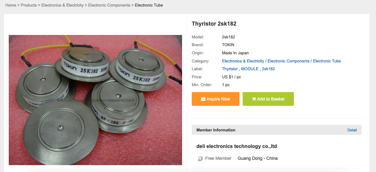

Muad'Dib Napisano Mart 31, 2021 Share #168 Napisano Mart 31, 2021 Ovaj ludi Japanac uradio spice modele za 2SK182 SJEP120R100 2SK60 2SK77 2SK180 Tokin SIT Pass SIT-1 (odakle mu Nelsonov SIT) https://paklaunchsite.jimdofree.com/spice-models/ Srecko je reagovao/la na ovo 1 Link to comment Podeli na ovim sajtovima More sharing options...
