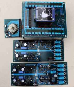

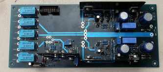

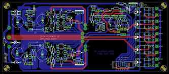

    so , schmtcs are here both Pumpkins ( meaning - what's on electronic pcbs ) are completely compatible to be used as (still MIA) Iron Pre , not yet visible in DiyA Store so , selector - pot - buffer - autoformer ( be it everything SE or Bal) is good and certainly cheaper way , even if definitely few notches down. schematics are proven , so there is one (little more complicated ) possible substitution for Toshiba/LS approach. feel free to try it , on protoboard or PtP , your choice how it sounds ? well - foot-tapping , music is there ..... no thoughts about spectrum dividing , music is simply there and - I'm not responsible for that ( even if Genius) ..... that's simply nature of Good Iron ....... remember M2, F6 , Ultrasimple BAF Sony amp ?

    Mda Objavih temu na Big Diya , ali me mrzi da kucam opet na naški, pa cu samo copy/paste kontam ce se snadjete ........... Well , it started long ago …. when I was really young(st)er, full with naivete and BS , came to pretty novel idea to make xformer loaded tube line stage … Result of first tests , hardly optimal ( using two halves of 6SN7 in parallel and loaded with ancient xformer from vertical section amplifier of ancient B-W tube TV set) , I was blown with ‘till then unknown dimension of sound – everything was so alive …. Later I made several iterations of line stage with same approach , being so proud for reinventing boiled water , until I got some xerox copies of Sound Practices , where I found that even in boiled water reinventing I wasn’t first ….. boyz from Italia already made Euridice preamp ; anyway , intermediate iteration was with two halves of 6DJ8 in parallel , latest one being with ubiquitous EC8010 and custom made xformer . That being even published on my old site – WOT preamp and battery charger

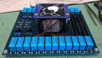

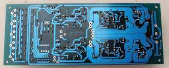

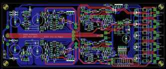

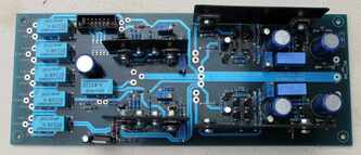

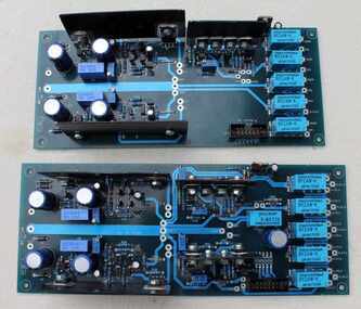

    Now , on to Iron Pumpkin (Bal) ; block schematic similar , except few facts : -two buffers per channel -AVC/autoformer connected in differential manner ; again – there is intrinsic SUSY -error correction , whatever you choose to call it . Facts about construction written for SE, applies here also . -One AVC Iron on one pcb , so two pcbs for stereo ; Newest iteration of I. Turtle pcbs optimized for stacking , so footprint stays the same as for SE. -There is option for using any of 5 inputs as SE ; put RCA instead of XLR , mount 1N4148 diode in adequate position for energizing one additional relay and that’s it . Trick is to energize additional relay , to break connection between negative side buffer ( now being without signal ) and negative side of AVC; that way buffer’s output is not acting as virtual zero to negative VAC winding , thus not choking it. AVC is now fed solely through positive side winding , producing ( naturally) output on both sides/phases . So – you can use SE inputs from none to 4 …….. in case that you want all 5 of them being SE inputs , having Bal output …….. then either use SE amp , so choose Iron Pumpkin SE instead , or use Iron Pumpkin with your Bal input amp , but skimp on neg. buffer elements .

    After successful realization of concept , I knew that few shortcomings of Iron Pre aren’t in necessity for Preputium made of parts , or Iron choice …… it is in fact of still having resistive attenuator …. and always tempting fact that somehow is possible to dispense scarce Toshibas for something you really can buy in nest Tobacco Store. So ,as a result of my day(night)dreaming, it came to prototyping of Iron Pumpkin , both SE and Bal iteration . Last one simply without suffix, while former obviously having SE as part of name. Due to intrinsic nature of balanced xformer ( fed ballanced , outputting signal also ballanced ) with necessary involvement of GND on either or both sides , it’s also having virtues of SUSY , as Papa patented it years ago. (Old Bull/Devil , always tongue in cheeks ). So , conclusion – to my ears – inductive attenuator is best sounding of all alternatives , and I really succeeded in dream of achieving (settable) gain with same device and , last but not least , natural conversion of SE to Bal , or other way around , in case of Iron Pumpkin (Bal) .

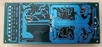

    did I forgot something ..... ? obviously - didn't uploaded some pics where applicable

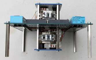

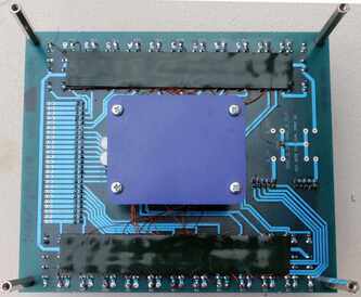

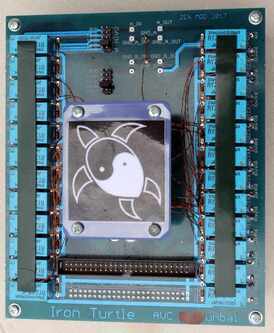

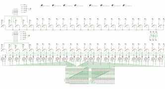

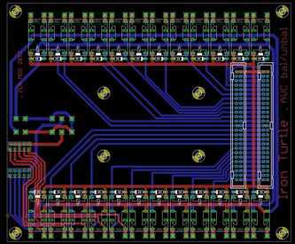

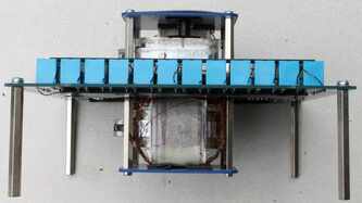

    more of Turtle

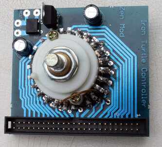

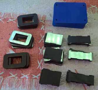

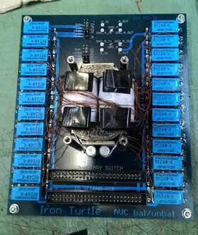

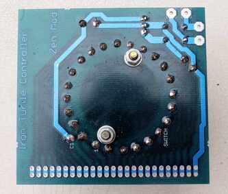

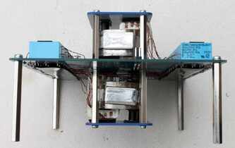

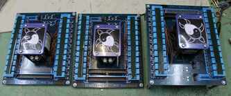

    Iron Turtle details ....... if you see two Irons (pcb sandwiched in between) that's stereo pack Iron Turtle SE ; if you see one Iron on pcb , that's mono (Balanced) Iron Turtle

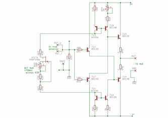

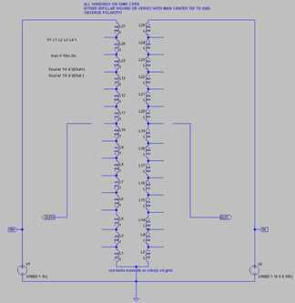

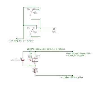

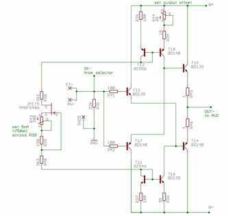

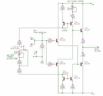

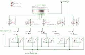

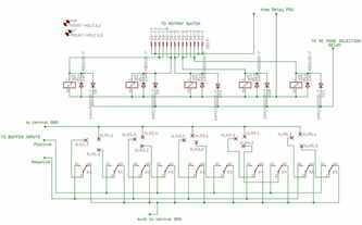

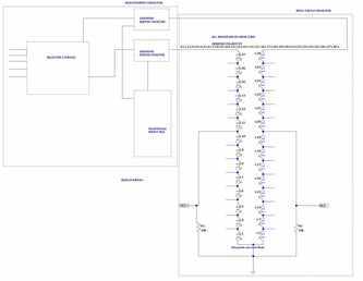

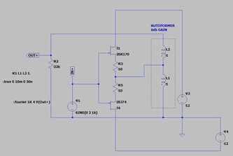

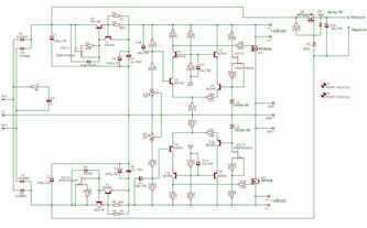

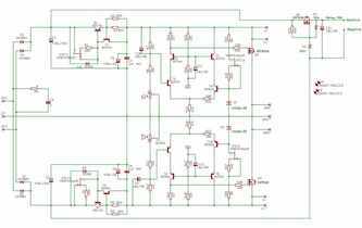

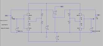

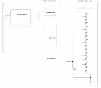

    Time for few block schematics ; first Iron Pumpkin SE ( chinch, RCA , whatever) What’s shown are basic blocks – input selector , single buffer ( single phase , yup) fed with Good Gemini shunt reg , then AVC , with selectable input tap ; when fed to top – possible gain is odb , with chooice of tapping in to -2 to -8 db , respectively , so possible gain from 2 to 8db. Selector – simple 5-position rotary switch operating with 5 Takamisawa relays ; they’re good for industrial and medical instruments , so …. Good Gemini – simplified but also hot-rodded iteration of well known Shunty. Buffer – current mirror biased Diamond Buffer …… nothing new , but painstakingly to achieve same THD spectra as with Toshibas , luckily with even beter behavior under heavier loads. AVC – called Iron Turtle SE ,based on Toshiba Metglas (AMCC008) cores. Coil – 10H/100Rdc jobbie , as (always!!) compromise between needed Good Inductivity and several Bad Factors (known as Bad Capacitances , Bad Inductivity etc. …. in fact , using AVC instead of TVC is Bad Inductivity non existent ); insulation between layers is Teflon based , bobbins are/will be custom ones , everything PVC coated after assembly. Disclaimer – as for difference to almost all AVCs on market , these aren't intended to be Swiss Knife universal jobbies , they are constructed to be driven with buffer or , at least , pretty potent signal source apparatus. Two AVC Irons on one Iron Turtle pcb , so that’s enough for stereo. Switching again through Takamisawa relays ; flat cable going from Turtle pcb to front plate mounted 24 position Chinese Switch . Chinese Switch – even if made by carefully chosen group of Chinese Virgins , only during full moon nights , each one is gladly disassembled then greased with graphite grease then assembled again , by Mighty ZM himself.

    m..pa da ...... elem gotovo i sa bal modulom ....... dakle sve je gotovo - sastavljeno i isprobano sad da se pripremi dokumentacija , otvoriza proper tema i da se objave seme i slike
