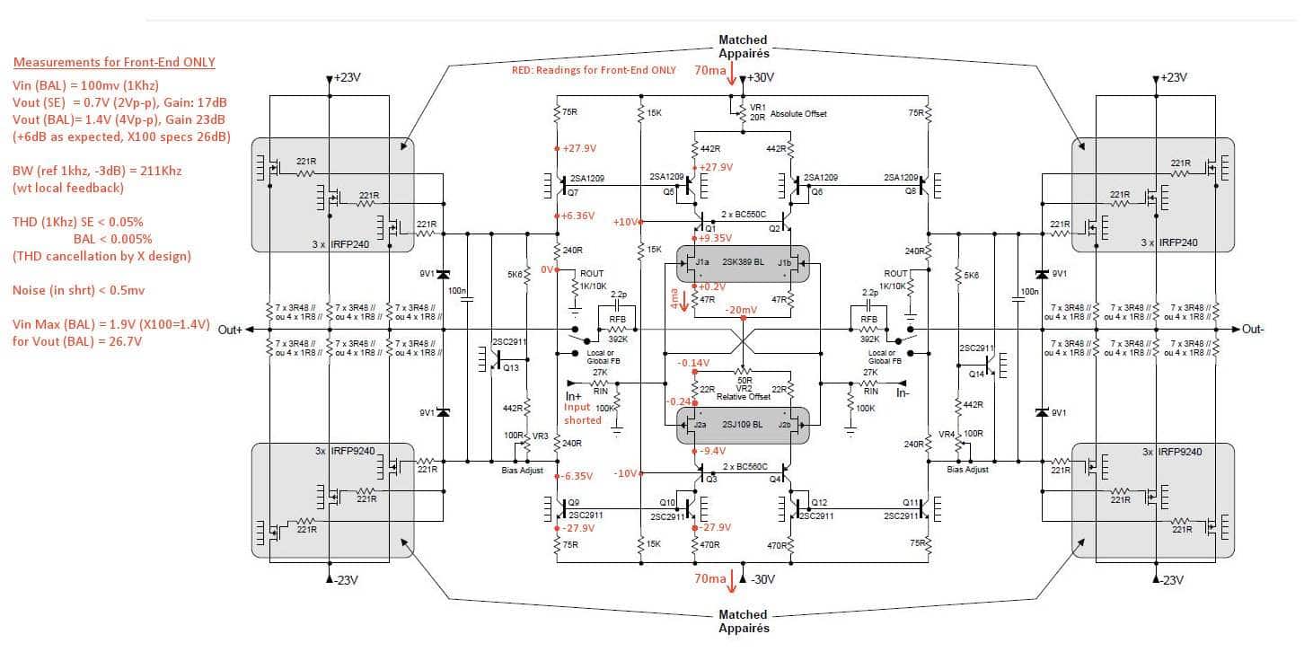

jok, nemam... imam samo za ugs preamp... Moracu malo da se pomucim ako ne dobijem konkretne savete.
ono sto oni kazu sa njihovog foruma.
And the gain in all this? Ben as it is, it is about 23dB. But it can be modified easily by changing some resistances (ROUT, RFB and RIN these last two being the resistances of the reaction), and according to the simus one has:
RFB = 392K / RIN = 27K / ROUT = 1K -> 22.1dB
RFB = 392K / RIN = 27K / ROUT = 10K -> 23.1dB
RFB = 392K / RIN = 22K / ROUT = 1K -> 23.7dB
RFB = 392K / RIN = 22K / ROUT = 10K -> 24.8dB
RFB = 499K / RIN = 27K / ROUT = 1K -> 23.9dB
RFB = 499K / RIN = 27K / ROUT = 10K -> 25.1dB
RFB = 499K / RIN = 22K / ROUT = 1K -> 25.5dB
RFB = 499K / RIN = 22K / ROUT = 10K -> 26.9dB
So you can adapt it as you want. The choice between a 10K or 1K Rout (or any other intermediate value) will be done by ear, the repercussions being subtle and highly subjective.
Another possibility that is offered is to be able to choose between a local or global feedback by closing the loop at the output of the first stage (CR "local") or on the whole of the amp (global CR). Again, the choice is by ear, but to summarize, the local CR sounds a bit warmer than the global CR, offering a more in line with the Alephs X. But it is mainly a matter of taste perso: P. Note however that the local CR slightly decreases the gain, since the "gain" output mosfets (mounted followers, and therefore gain <1) is no longer offset by the loop of CR.

ono, zasto sam se opredelio za UP-grade verziju na 32VDC tj 24VAC, @Aleks da vidi, da ne kaze da je samo snaga u pitanju, vec ima malo i nesto drugo.
