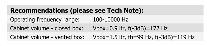

shonne Napisano Septembar 4, 2023 Autor Share #1388 Napisano Septembar 4, 2023 Kojo, vec imam kutiju koja mi odgovara za 2 bass drajvera, 63L. Mid zapremina je trenutno 20L ali za 12MU ce da se napravi posebna komora od 1.5L. Znaci, iskoristicu postojecu. To je vec odavno bilo u planu, bar za 2 bass drajvera. Link to comment Podeli na ovim sajtovima More sharing options...
Koja Napisano Septembar 4, 2023 Share #1389 Napisano Septembar 4, 2023 Da nije malo 1.5L? Ćeš da mu sabiješ Q-faktor. Stavi jedno 4-5L? Link to comment Podeli na ovim sajtovima More sharing options...
shonne Napisano Septembar 4, 2023 Autor Share #1390 Napisano Septembar 4, 2023 4 minutes ago, Koja said: Da nije malo 1.5L? Ćeš da mu sabiješ Q-faktor. Stavi jedno 4-5L? Videcu. To bar lako mogu da menjam, a iskreno prvi put radim samo sa mid. Ono sto scan preporucuje. Link to comment Podeli na ovim sajtovima More sharing options...

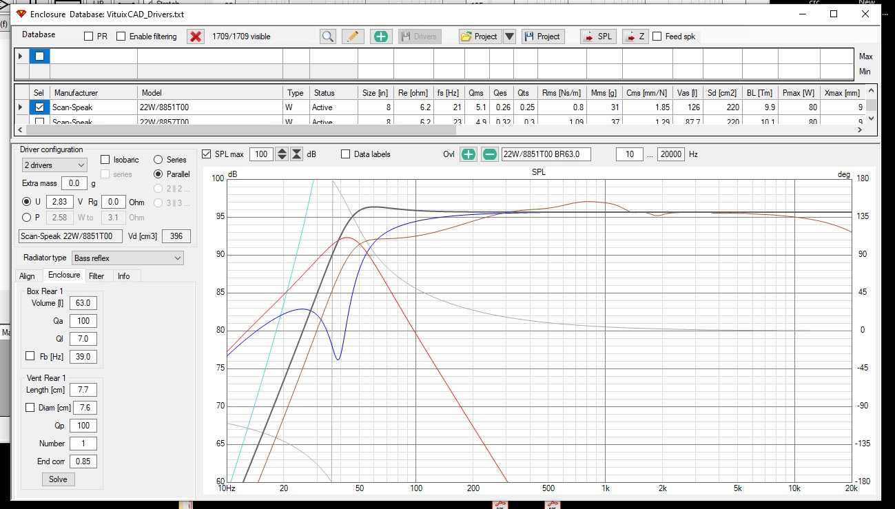

shonne Napisano Septembar 5, 2023 Autor Share #1394 Napisano Septembar 5, 2023 (izmenjeno) 10 hours ago, NIXIE said: A za basove, nešto mi malo 63l za oba. Nema tu mnogo filozofije. Radio sam bio i posebno test kutiju za njega, najbolje se pokazao u tim uslovima. Cak se i sa ovim amerom slazem u potpunosti sto se tice rezultata. I am using this driver in a current 3-way project (hopefully photos in a build thread when i figuer out how to do that). I am very pleased with its quality, its built like a tank. After actual measurments w/ WT3, modeling in bassbox pro and some test boxes, i came up with 1.1 ft and a 2" port X 10.3". a single 2" ports velocity is way high so i opted for dual 2" ports ( dual 2" instead of larger diam. due to space) at 21.6" each. I have been very impressed with the sound for an 8" "sub" it really digs low and sounds fantastic doing it, but an f3 of 30 hz i dont think so, more like f3 of 38-40. I would not use this driver as a stand alone sub, you can get alot more bang for your buck with a 10" or 12". but if you are looking for a GREAT 8" for a smaller 3-way and have the cash, this one is it. Izmenjeno Septembar 5, 2023 od shonne Link to comment Podeli na ovim sajtovima More sharing options...
shonne Napisano Septembar 5, 2023 Autor Share #1395 Napisano Septembar 5, 2023 Cubic f je otprilike oko 28L. Znaci 1.1 je negde oko 31L. Dva drajvera u kutiju izlazi tu oko 62-63l. Nije potrebno praviti sifonjere kao sto neki rade da se odlazu u njima stvari i skupi porcelan 😁 Ipak je ovo zvucna kutija 😛 LightMatic je reagovao/la na ovo 1 Link to comment Podeli na ovim sajtovima More sharing options...

shonne Napisano Septembar 5, 2023 Autor Share #1401 Napisano Septembar 5, 2023 evo sim difrakcija i odziv za one koji nisu ni merili Link to comment Podeli na ovim sajtovima More sharing options...
