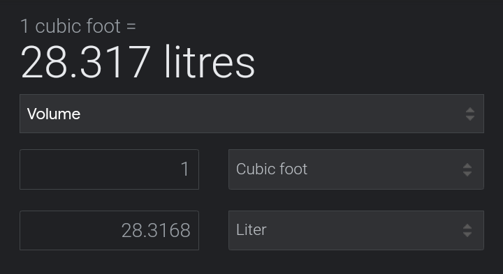

shonne Napisano Jul 16, 2022 Autor #1090 Napisano Jul 16, 2022 I am using this driver in a current 3-way project (hopefully photos in a build thread when i figuer out how to do that). I am very pleased with its quality, its built like a tank. After actual measurments w/ WT3, modeling in bassbox pro and some test boxes, i came up with 1.1 ft and a 2" port X 10.3". a single 2" ports velocity is way high so i opted for dual 2" ports ( dual 2" instead of larger diam. due to space) at 21.6" each. I have been very impressed with the sound for an 8" "sub" it really digs low and sounds fantastic doing it, but an f3 of 30 hz i dont think so, more like f3 of 38-40. I would not use this driver as a stand alone sub, you can get alot more bang for your buck with a 10" or 12". but if you are looking for a GREAT 8" for a smaller 3-way and have the cash, this one is it.
