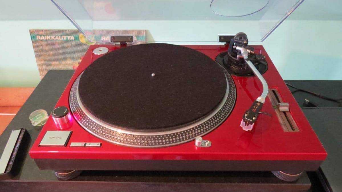

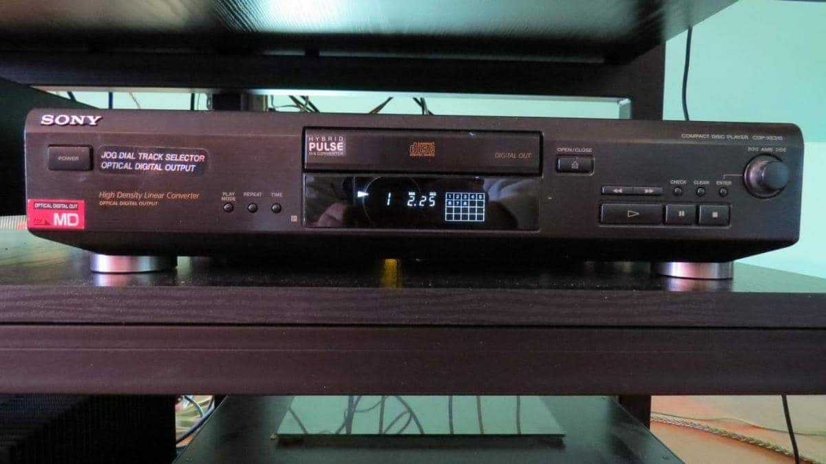

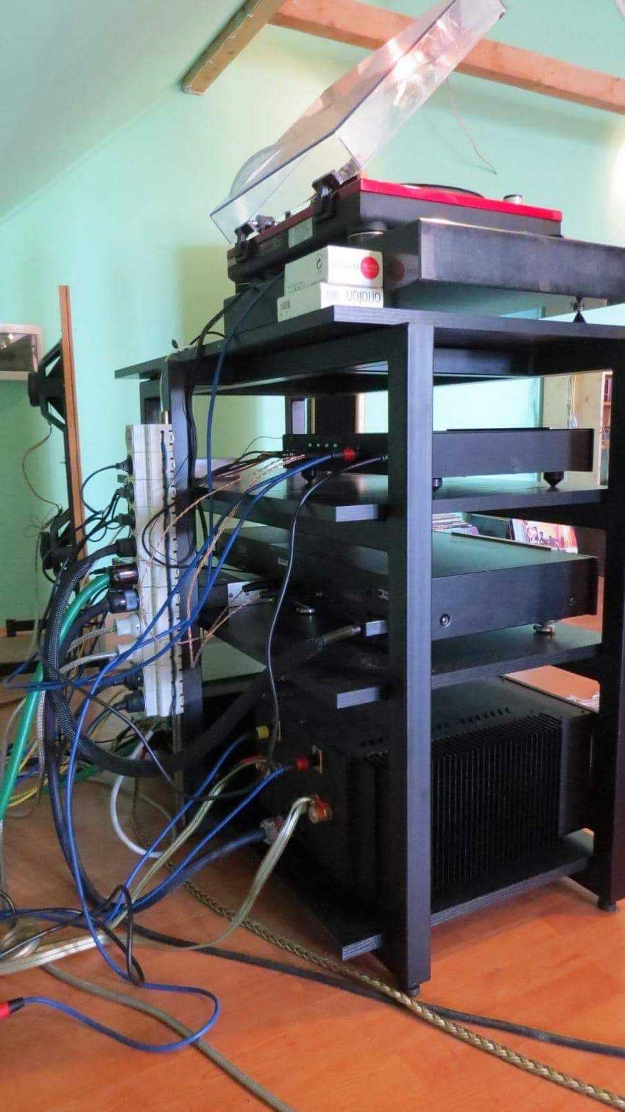

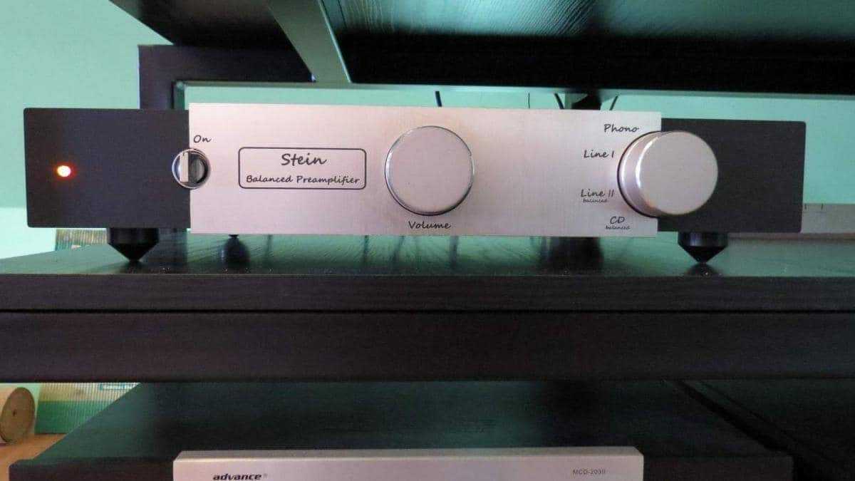

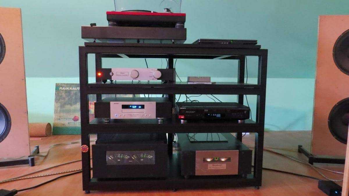

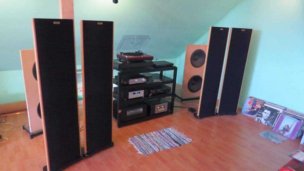

stein Napisano Januar 4, 2015 Autor #621 Napisano Januar 4, 2015 Analogni: Technics SL1210MkII sa ext napajanjem + Ortofon 2M Red Digitalni: CD : Acoustic Advance MCD 203MkII (balansirani izlaz sa E83CC) Transport: Sony XE330 PC Acer Extensa 5220 DAC Arcam rDAC Preamp: Balansirani preamp (šema Sipi) + MM/MC RIAA iz Denona R880 Active X-over: Behringer PWR Amps: Cirklotron (Sipi) Hibridni Cirklotron sa E88CC (Sipi & Zen) Zvučnici: HP: Soltanus ESL150 (2x2) + LP Eminence Alpha 15 OB (2x2) Posle mesec dana u nekom, da kažem, sređenom stanju, sistem je dobio i upgrade u formi prelaska sa "budžet" MM zvučnice na MC zvučnicu... Nisam stigao da provedem mnogo vremena slušajući muziku u ovom setapu (više sam se prčkao sa lemilicom) ali za razliku od osnovne (najjeftinije) verzije zvučnice Ortofona iz 2M serije, evo šta kažu za Denona: "The sound of the regular DL-103R is outstanding, and a super bargain at it's price point. Many have heard of it referred to as a super-cart, or giant-killer. And it is. It has the wonderful characteristic of allowing the music to come across as a composition, and not as a group of disjointed parts. This is not as common as we would like in cartridges today. Many carts will give great separation of instruments and holographic imaging and detail, but they never seem to merge as a musical whole. The Denon carts excell in this area of making the parts merge into a full musical presentation, and still retains the detail and delineation of the instruments and voices. This is one of the major reasons why the DL-103R is such a desireable cartridge." Razlika u ceni nove je oko 3.8x (2M Red ~100$, DL103R ~379$) Denon je poklon, doprinos, nazovite ga kako hoćete, od cenjenog člana foruma koji mi je na taj način neizmerno učinio i nadam se da ću imati priliku da tu ljubaznost i nesebičnost jednog dana uzvratim. Pošto nije reč o Tarzanu, znam da neće odmah skočiti i krenuti da se busa u grudi i svima da do znanja da je on taj... Voli da koristi svoje sposobnosti da bude nevidljiv, hoda po vodi i ima kontrolu nad prirodnim elementima... i to treba poštovati. Evo par sličica kako to sve zajedno izgleda... Aleks and grozni je reagovao/la na ovo 2

Aleks Napisano Januar 4, 2015 #623 Napisano Januar 4, 2015 Jesi li razmišljao da staviš te basove u kakvu kutiju? Nisam čuo kako to zvuči, pretpostavljam da je ubica i ne sumnjam u to, ali šta bi bilo kada bi bio neki MLTL ili nešto kao u priloženom pdf-u..? PP-sub-20hz.pdf
stein Napisano Januar 4, 2015 Autor #624 Napisano Januar 4, 2015 Jesi li razmišljao da staviš te basove u kakvu kutiju? Nisam čuo kako to zvuči, pretpostavljam da je ubica i ne sumnjam u to, ali šta bi bilo kada bi bio neki MLTL ili nešto kao u priloženom pdf-u..? Zvučnici na pločama su Eminence Alpha 15A... Samo kratak pogled u karakteristike će verujem, veoma jasno dati odgovor na pitanje zašto OB a ne kutija... Osim toga, transparentnost, živost i fenomenalno čista artikulacija svakog tona, bilo kojeg muzičkog materijala je fantastična ovako kako jeste. Možda je žrtvovan poneki Hz nauštrb ekstenzije ka tih 20Hz, ali... Ne bih ja to dirao kad je već ovoliko dobro, a da dodam i to, do sada ama baš niko ko je ovo ovde čuo na pitanje da li misli da fali "mase" u donjem području, nije imao primedbi ... (odsustvo koloracija koje uglavnom prate izvedbe sa kutijama su padež pride... prdež pade... tako nekako... http://www.eminence.com/pdf/Alpha_15A.pdf
chakija Napisano Januar 4, 2015 #625 Napisano Januar 4, 2015 nevidljiv ..... da ga jebes ko i behringer crossover na slikama
stein Napisano Januar 4, 2015 Autor #626 Napisano Januar 4, 2015 ko i behringer crossover na slikama Naravno, nalazi se iza Sony-ja... Jednom kad se podesi, nema šta da mi šljašti sa svim dugmićima i svetlećim diodama... Bar jedna dobra "kolateralna šteta" činjenice da su pojačala snage toliko duboka - bude i polica duboka pa ima mesta da se posakriva ono što ne treba da bode oči
skrstic Napisano Januar 4, 2015 #627 Napisano Januar 4, 2015 Mislim da ti fali još 4 Alfe (kad bi se zezali) Jel ti sad sweet spot veći?
stein Napisano Januar 4, 2015 Autor #628 Napisano Januar 4, 2015 Mislim da ti fali još 4 Alfe (kad bi se zezali) Jel ti sad sweet spot veći? Mnogo. Sada mogu tri ne preogromne osobe da sede i slušaju bez mnogo "gubitaka", pre je jedna osoba u centru prilično morala da pazi da se ne opusti previše i "ispadne" iz sredine Upgrade, kako rekoh već, vredan svake pare

stein Napisano Januar 5, 2015 Autor #636 Napisano Januar 5, 2015 Nikada kraja prčkanju. Izvadio teg kod zvučnice i stavio dva strugana alu prstena visine 3.0 mm da budu odstojnici. Sada može da se podesi visina ručice/zvučnice a bez potrebe da se dodaje dodatni mat pod ploču. (Denon je 3mm manje visine od Ortofona i većine zvučnica koje su visoke 18mm) Sad dolazi najveći štos... Sa izuzetkom naslova printanih u Mađarskoj i dva tri pop/rock albuma, sve su ex-Yu licencirane ploče. Jedini da kažem "originali" su iz domena "klasične" muzike (barok na primer zapravo i nije klasika nego barok itd) ali to ne menja činjenicu da mi je kolekcija ploča uglavnom to... upitan kvalitet otiska... Na sreću, sve ploče su vrhunski očuvane, nema tragova žurki ili divljanja, nemara... Ono malo tragova prašine koji se pojave po vađenju iz omota lako i netragom nestaju nakon apliciranja četke za čišćenje... Daklem, biće teško sada davati neke relevantne izjave na temu kvaliteta reprodukcije sa ovom zvučnicom... (Denon) Dobro svira, ali ako je otisak u startu inferioran nekom dobrom otisku, to je sasvim dovoljno da sve što pomislim ili kažem ne bude merodavno...
