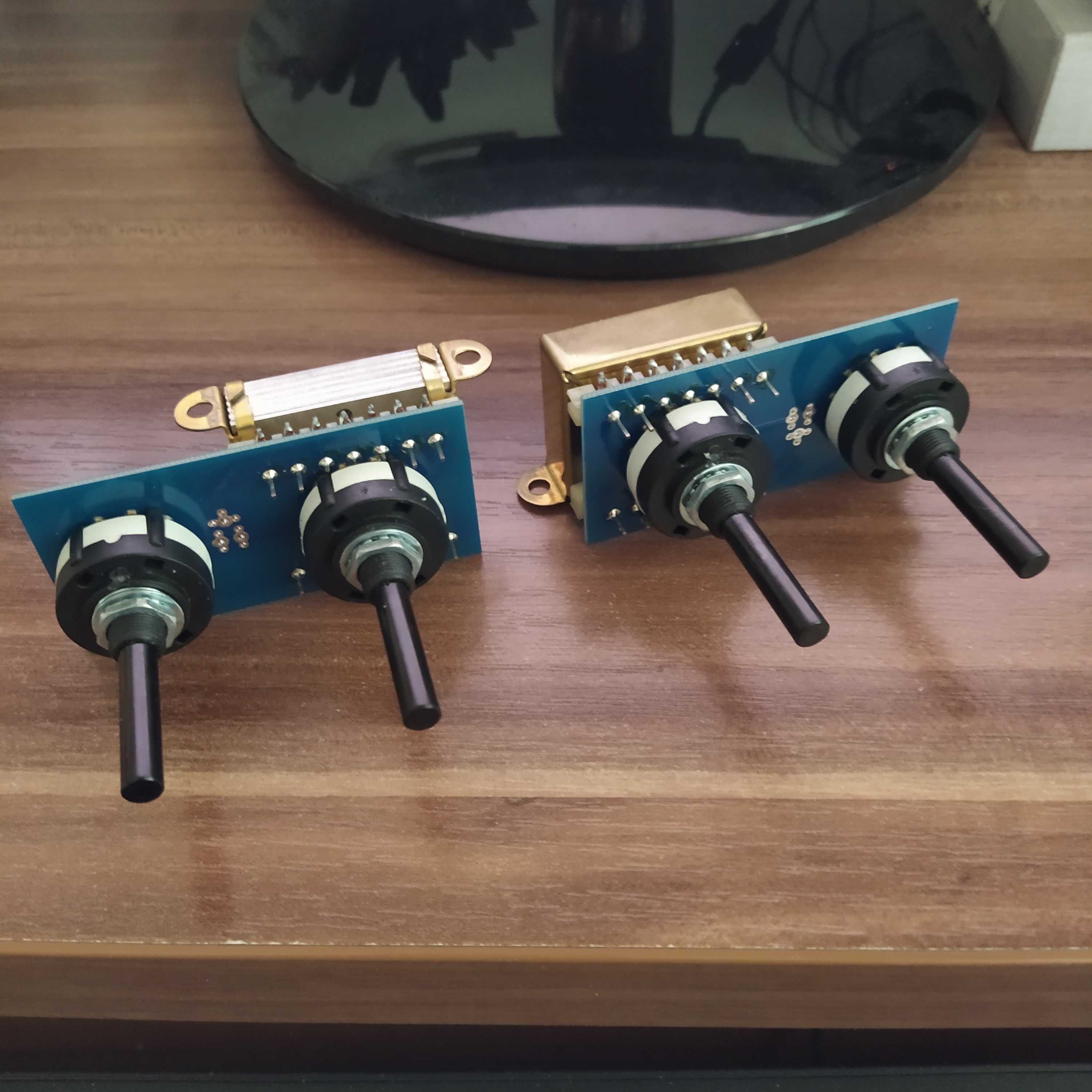

Zbora Napisano April 8, 2024 #78 Napisano April 8, 2024 (izmenjeno) On 4/6/2024 at 11:44 PM, NIXIE said: Potentiometer DACT Type SMD Stepped Attenuator 21Step Volume Control 100K System WWW.EBAY.COM <ul> <li>Description:</li> <li> <ul> <li>Type:potentiometer</li> <li>HI-END Step Potentiometer Steeped-in Potentiometer Volume Control DA*T Substitution AL*S. Without Foot Handle 20MM</li> </ul> <ul> <li>Condition:Disassemble parts</li> <li>Resistance: 100k</li> <li>Sturdy and durable replacement accessories</li> <li>Without foot handle</li> </ul> </li> <li>Package included:</li> <li> <ul> ... Meni ovao sljaka vec par godina bez problema , probacu neke fensije u buducnosti a da vidim neki problem i ne vidim samo kazem Izmenjeno April 8, 2024 od Zbora
NIXIE Napisano April 8, 2024 #79 Napisano April 8, 2024 Ne prave ti probleme, samo oni plavi što liče na ALPS. Možda ih treba otvoriti, očistiti zamenuti mazivo. Neki đavo ima.
NIXIE Napisano April 8, 2024 #80 Napisano April 8, 2024 ALPS potenciometri se pravi svuda po Aziji uključujući Kinu. Tako da gde god da se kupi, možda je ipak Kineski, ali original. Global Network | Company | Alps Alpine WWW.ALPSALPINE.COM Our aim is to transform into a sustainable value-creating corporate group that carries on contributing to people's lives through electronics and communication, with a focus on...
