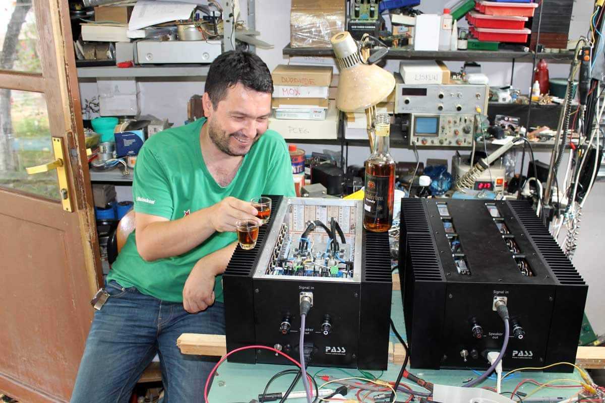

I am considering a B24 next year. I would like to mix the class A/B and class A versions and have a high biased class A/B where the first 30-40 watts would be class A and then go up to 80-100 in A/B. This means larger heatsinking and PSU. I have a hifi2000 5U 400mm dissipante for my diy first watt class A amp and it dissipates about 100W per channel without a problem, so it might be a good choice for the amp.
