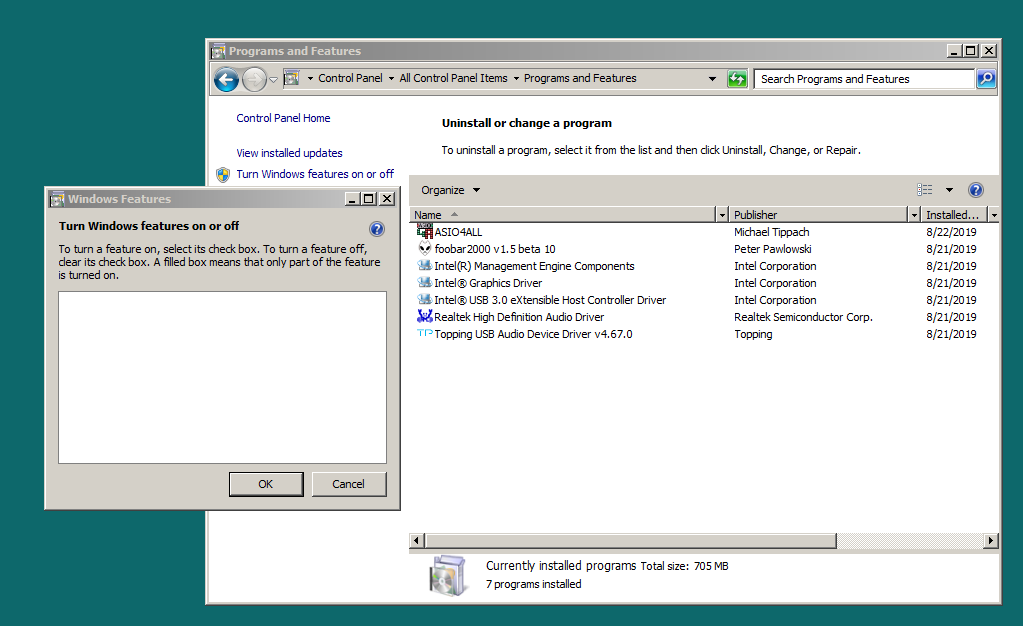

Mikorist Napisano Avgust 23, 2019 #819 Napisano Avgust 23, 2019 Još neki detalji o WES7 Quote An embedded system is a controller with a dedicated function within a larger mechanical or electrical system, often with real-time computing constraints Prevedeno Ugrađeni sistem (engl. embedded system) je računarski sistem posebne namene, koji je potpuno inkapsuliran uređajem koga nadzire. Ugrađeni sistem ima posebne zahteve i izvršava unapried određene zadatke, za razliku od (PC) ličnog računara opšte namene. I programiran za posebnu primenu.Ovo omogućava arhitekturi embedded sistema da bude namerno pojednostavljen u odnosu na opšte-namenski kompjuter.Embedded sistemi se nalaze u mašinama od kojih se očekuje dugogodišnji rad bez grešaka. Quote Windows Embedded Standard 7 (WES7) is based on the same kernel and is the componentized version of Microsoft Windows 7. In fact, both Operating Systems are based on the same binaries. WES7 is enhanced with special tools to target the needs of embedded systems that run continuously. While a desktop OS like Windows 7 is optimized for maximum user interaction, an embedded OS is the opposite. Embedded systems often run in environments where few user interactions are desired. Embedded systems often supervise safety critical facilities and thus need to be very robust, reliable and autonomous. This user manual covers some tools and techniques that help to reduce possible software and hardware breakdowns concerning the operation of Windows Embedded Standard 7 on an IPC in an industrial environment. It details some embedded features that can be configured. Basic knowledge of Windows operating systems is required. Quote Windows Embedded Standard 7 gives some features to improve the reliability of the system. These features are the Enhanced Write Filter (EWF) and the File-Based Write Filter (FBWF). Both filters improve the stability and prevent system crashes during power fail situations. The EWF is installed on the drive C: and the FBWF is installed on drive D:. Both are disabled by default. This filter is designed to protect a whole partition on sector level and provide the ability to write-protect a run-time image by redirecting all write requests to an overlay located in RAM. For the user the drive appears as a regular drive and allows all write operations. But after reboot all the operations are being set back to the last defined state. Like this the embedded system will always behave the same. Remark: EWF is configured using RAM Reg Mode. To disable the EWF use the CommitAndDisable command or the Icon available on the desktop. Some helpful commands: Ewfmgr Shows the status of the EWF EWFmgr c: /enable Enables the EWF Filter after the next restart Ewfmgr c: /CommitAndDisable Disables the EWF Filter and applies the actual changes to the drive. Ewfmgr c: / commit Applies the currently made changes to the disk by the next restart. Problem je instalirati ga na PC opšte namene. Pravi pain in the ass Mora pomoću trikova da se instalira - preko Windows 7PE - kroz posebnu aplikaciju - koja će forsirano da ga instalira na običan PC na HDD Tako da pojma nemam da li ga neko koristi za audio sem ja Lemić je reagovao/la na ovo 1

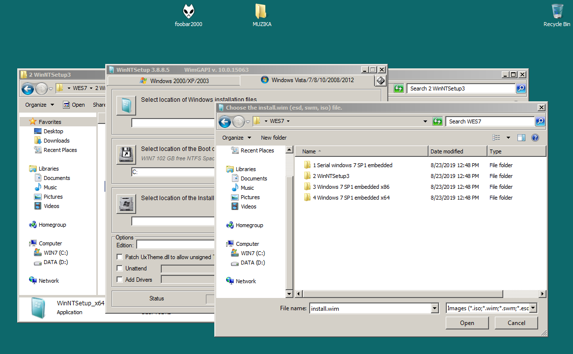

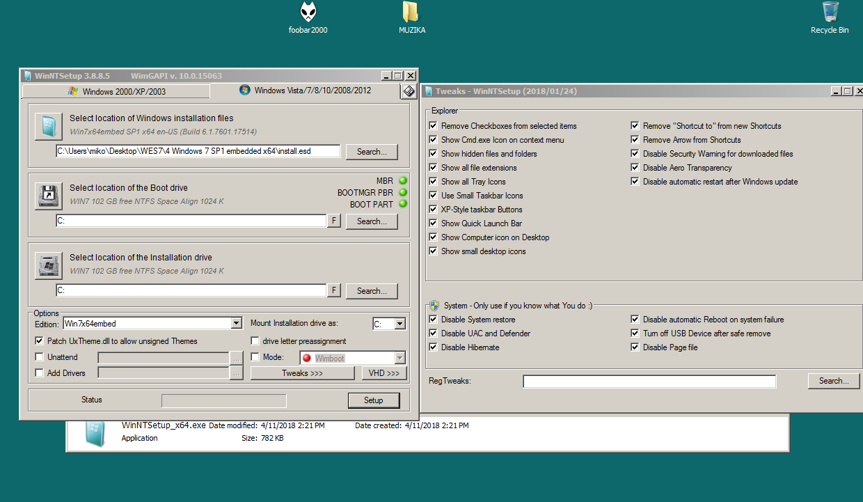

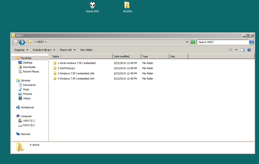

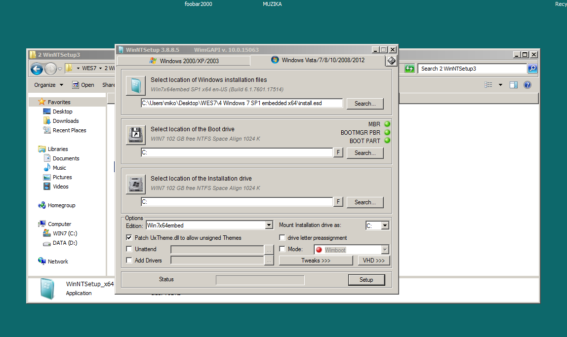

Mikorist Napisano Avgust 23, 2019 #826 Napisano Avgust 23, 2019 Evo ovako..... Ovde se nalazi sve potrebno ko već radi po WIN okruženjem. https://www.diyaudio.rs/WES7.zip Ja sam po MacOs koristio poseban programčić - da bih napravio NTFS i ceo disk (sve particije) iz GPT prebacio u MBR. Za Windows preporučujem Paragon free - https://www.paragon-software.com/free/pm-express/ Kad se skine ono gore i unzipuje na Desktop vidi se sledeće U ova 4 foldera je sve što je potrebno bez obzira da li je 64bit ili 32bit mašina - za obe imaju njihove verzije. Windows aktivator za ovu verziju ne postoji - aktivira ga serial koji je gore u folderu 1. Nijedan aktivator - čak ni DAZ - ga ne prepoznaje kao Windows. Setup će tražiti - serial - i kad se ubaci gornji permanentno je aktiviran. Nisam instalirao nikakav apdejt niti izlazio van na internet peko njega .... pa nemam pojma da li je i u tom slučaju doživotno aktiviran..... Kad se uđe u folder br 2 u njemu je WinNTSetup - preko koga se forsirano instalira na bilo koju prepoznatu particiju. Izabere se iz programa koji vam treba 64bit ili 32bit - Install.esd (nije kao wim) potom se vidi sledeće. Izabere se lokacija buutdrajva i instalacijonog drajva da bude ista - C, D koji god ste namenili za ovog mališana. Štiklira se Patch Ux Theme - sa ovim može bilo koja neoficijalna tema da se instalira. Ja inače koristim običnu temu NT - najprostiju - jer i ona smanjuje latenciju.... Potom se klikne na Tweaks i sve štiklira. Posle toga klikne na Setup - i ovaj program će da ga raspakuje tamo. Da bi se nastavio SETUP - mora da se restartuje - i butuje baš ta particija. Negde na kraju posle drugog restarta tražiće serial.... To je sve ukratko. Preporučujem da sve drajvere poskidate unapred i pripremite ih za ovo. Ili koristite Double Driver da ubrzate proces http://boozet.id/download/dd410.zip Ja lično na toj particiji uoppšte ne koristim mrežnu ni Wi-Fi - dizejblovao sam ih. I to smanjuje latenciju. Pa da bi izlazio na NET - stalno restartujem mašinu i ulazim u drugi OS Ko hoće dodatno može da pokrene skriptu koja dodatno skida neke stvari - još više ubrzava procese za AUDIO. Nju treba pokrenuti poslednju - kad narihtate sve drajvere - sve programe potrebne.... Zove se Opotimizacija.cmd Da se sve vrati natrag skripta je Original.cmd I to bi bilo to - ukratko Optimizacija.cmd Original.cmd p.s. Nemojte da se uplašite ako u Windows feauteres listi - on or off- nema NIŠTA. I nema ništa u njoj bukvalno... Lemić, dejanco32, zeljko_v and 1 član je reagovao/la na ovo 3 1
