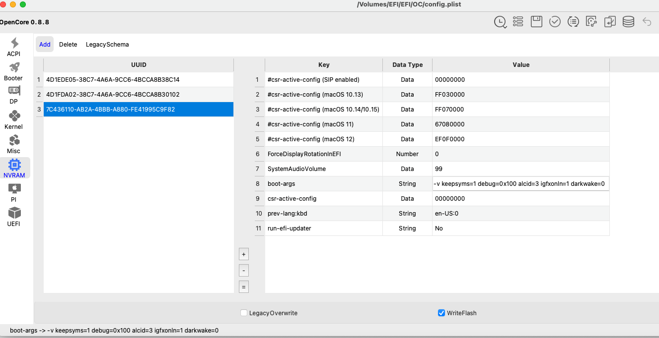

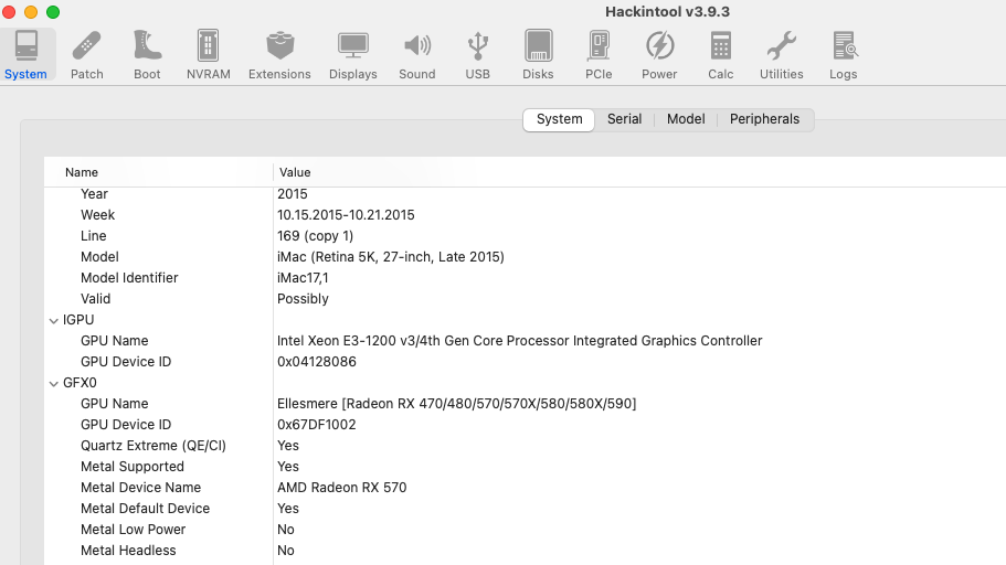

Mikorist Napisano Januar 18, 2023 #1 Napisano Januar 18, 2023 Maticna ploca GA-H81.AMP-UP (rev. 1.0) Overview | Motherboard - GIGABYTE Global WWW.GIGABYTE.COM Lasting Quality from GIGABYTE.GIGABYTE Ultra Durable™ motherboards bring together a unique blend of features and technologies that offer users the absolute ... Procesor Intel® Core™ i7-4770 Processor (8M Cache, up to 3.90 GHz) - Product Specifications | Intel WWW.INTEL.COM Intel® Core™ i7-4770 Processor (8M Cache, up to 3.90 GHz) quick reference with specifications, features, and technologies. Graficka EX-RX570-O4G|Graphics Cards|ASUS Global WWW.ASUS.COM ASUS Expedition graphics cards are the perfect starting point for a thrilling journey into your favorite game. Engineered for durability and reliability, Expedition cards are tested to their limits, including a 144-hour diskless-system test and extensive compatibility checks to ensure a smooth ride. Memorija Kingston 16 GB 2133 MHz DDR3 HyperX Beast T3 *(radi na max 1600 MHz za ovu maticnu) Kuciste MS ELEMENT M100, USB 3.0, bez napajanja Napajanje Seasonic B12-BC-550, 80PLUS Bronze Bios Settings: XHCI Hand-off: Enabled EHCI Hand-off: Enabled Execute Disable Bit: Enabled XHCI Mode: Auto Legacy USB Support: Enabled SATA Mode: ACHI ( with UEFI Settings ) VT-d feature : Disabled X.M.P. Memory Profile to Profile1 Integrated graphics. Disabled - PCI graphics Enabled Kako se macOS skida i instalira sa Linux-a https://dortania.github.io/OpenCore-Install-Guide/installer-guide/linux-install.html#downloading-macos Kako se macOS skida i instalira sa Windows https://dortania.github.io/OpenCore-Install-Guide/installer-guide/windows-install.html#downloading-macos Opencore boot-loader konfigurisem (apdejtujem) podesavam i proveravam sa OCAT https://github.com/ic005k/OCAuxiliaryTools Svo citanje za Opencore je ovde https://dortania.github.io/OpenCore-Install-Guide/prerequisites.html Neverovatno kako radi ovaj operativni sistem..... EFI sa podesenim OpenCore je u prilogu EFI.zip dejanco32, LightMatic, Doktor and 2 ostalih je reagovao/la na ovo 3 1 1

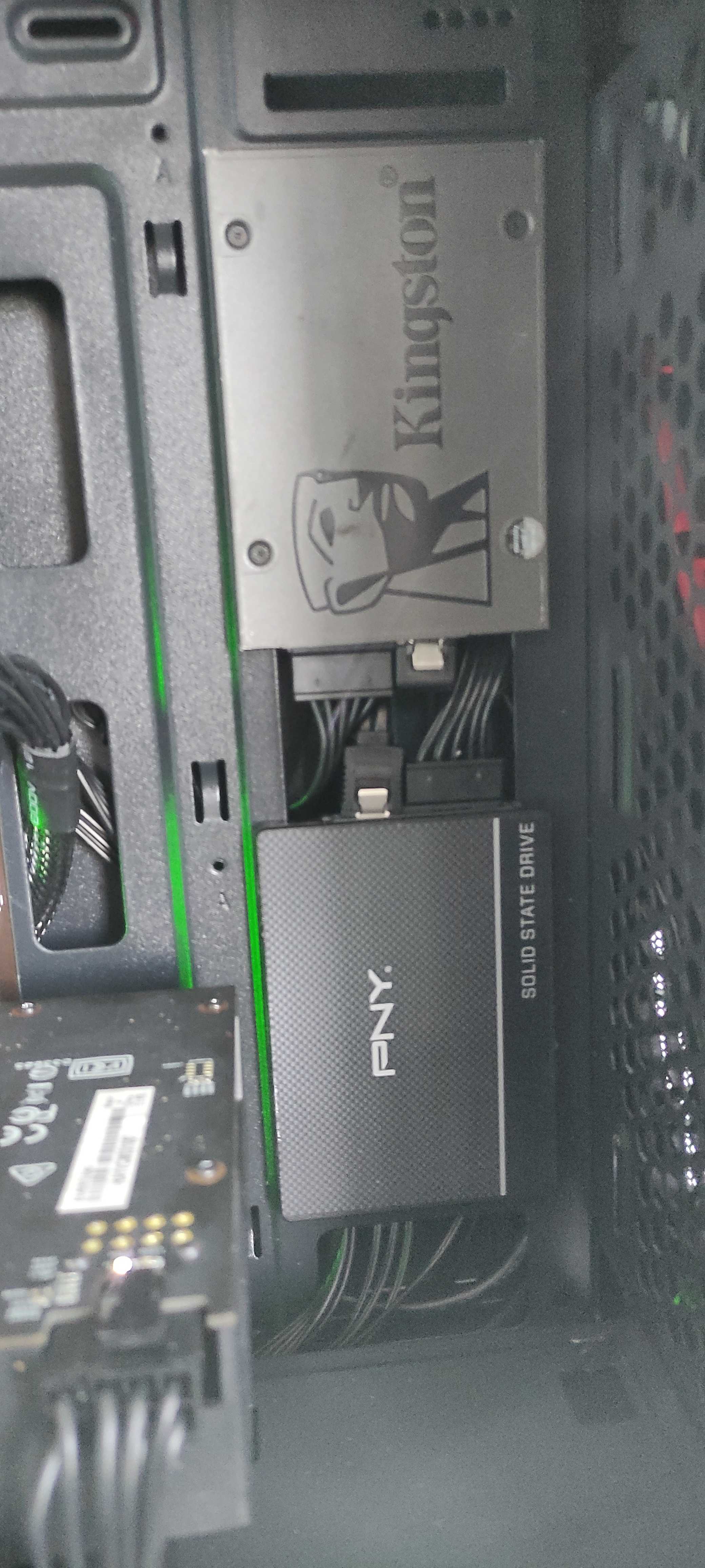

Mikorist Napisano Januar 18, 2023 Autor #3 Napisano Januar 18, 2023 Zaboravio sam da navedem dva SSD od tera. Nece bez njih da radi Zaboravio sam da napisem sta radi i sta ne radi na ovom build-u. Radi sve sem hibernacija - jos nisam otkrio *(a otkricu) kako iz hibernacije da se Aktivira slika na RX 570. Inace sve ostalo fercera kao fabricki Mac - ukljucujuci quartz extreme i VDA dekoder za Apple TV Zvuk ubija sa ALC889...O DAC da ne pricam.... shonne and LightMatic je reagovao/la na ovo 2

Mikorist Napisano Januar 18, 2023 Autor #5 Napisano Januar 18, 2023 pre 4 časa, Mikorist reče Radi sve sem hibernacija - jos nisam otkrio *(a otkricu) kako iz hibernacije da se Aktivira slika na RX 570. -v keepsyms=1 debug=0x100 alcid=3 igfxonln=1 darkwake=0 obicno sa darkwake=0 u boot-args je fix -ali nece ovde
Mikorist Napisano Januar 18, 2023 Autor #6 Napisano Januar 18, 2023 Evo ga ovde resenje https://www.tonymacx86.com/threads/black-screen-bigsur-only-get-video-after-sleep-wake.321962/#post-2336792 sudo pmset autopoweroff 0 sudo pmset powernap 0 sudo pmset standby 0 sudo pmset proximitywake 0 sudo pmset tcpkeepalive 0

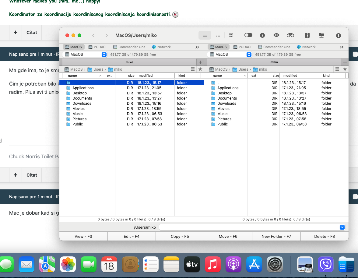

Koja Napisano Januar 18, 2023 #10 Napisano Januar 18, 2023 Ma gde ima, to je smešno. Čim je potreban bilo kakav rad sa fajlovima, sve pada u vodu. Na win ima Totalcmd. Na macu nema ništa ni blizu, tražio sam kad sam bio primoran da radim. Plus svi ti unixoliki sistemi imaju užasnu organizaciju fajl sistema.
Koja Napisano Januar 18, 2023 #11 Napisano Januar 18, 2023 Mac je dobar kad si grafički dizajner pa treba da edituješ 3-4 slike i da ništa ne diraš.
Mikorist Napisano Januar 18, 2023 Autor #12 Napisano Januar 18, 2023 pre 39 minuta, Koja reče Na macu nema ništa ni blizu, Ali mene mrzi i da klikcem na to....Brze kroz terminal radim sa fajlovima Ni na Windows-u kad sam bio nisam koristo TC Koja je reagovao/la na ovo 1

Mikorist Napisano Januar 18, 2023 Autor #15 Napisano Januar 18, 2023 Radi sad i hibernacija. Ko na Windows-u. Izmenjen EFI i ubacen u prvi post.
