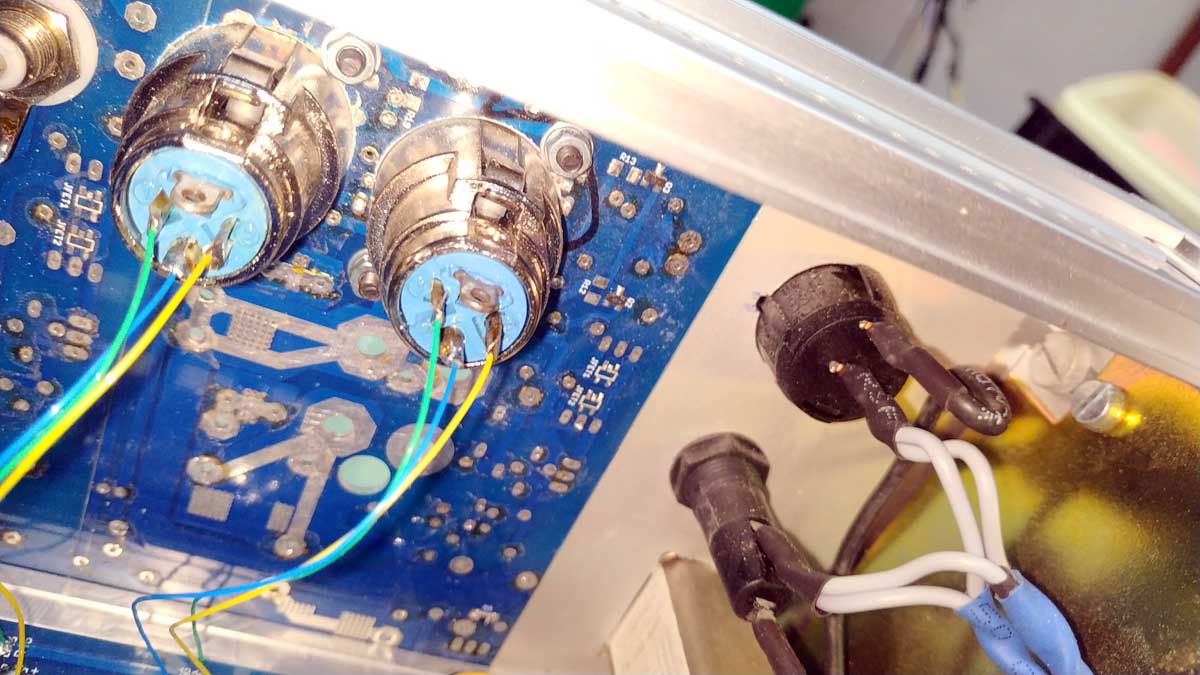

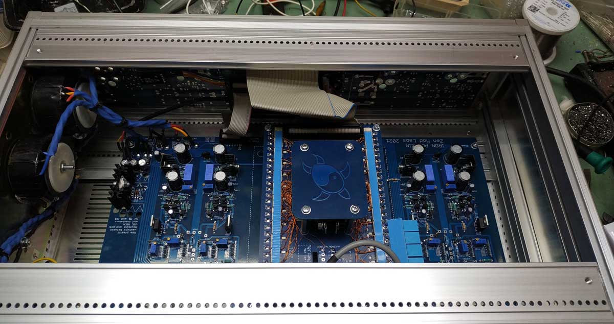

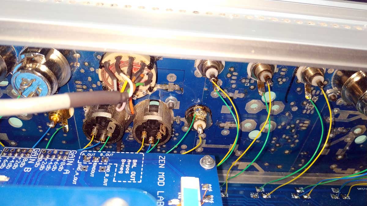

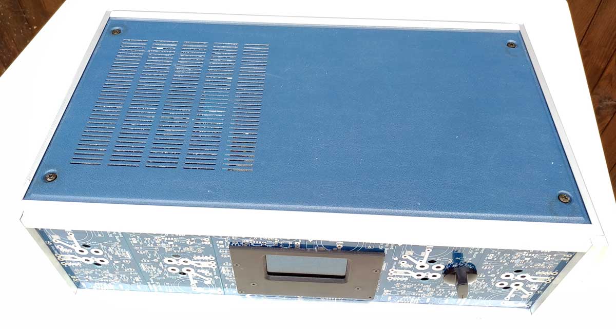

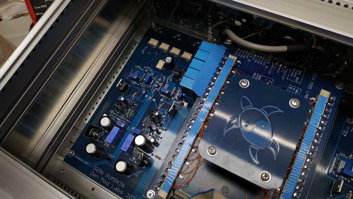

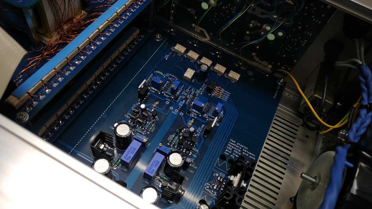

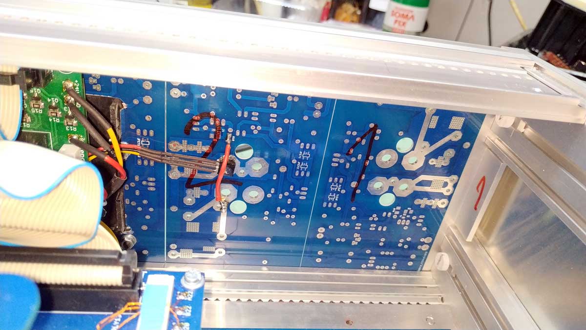

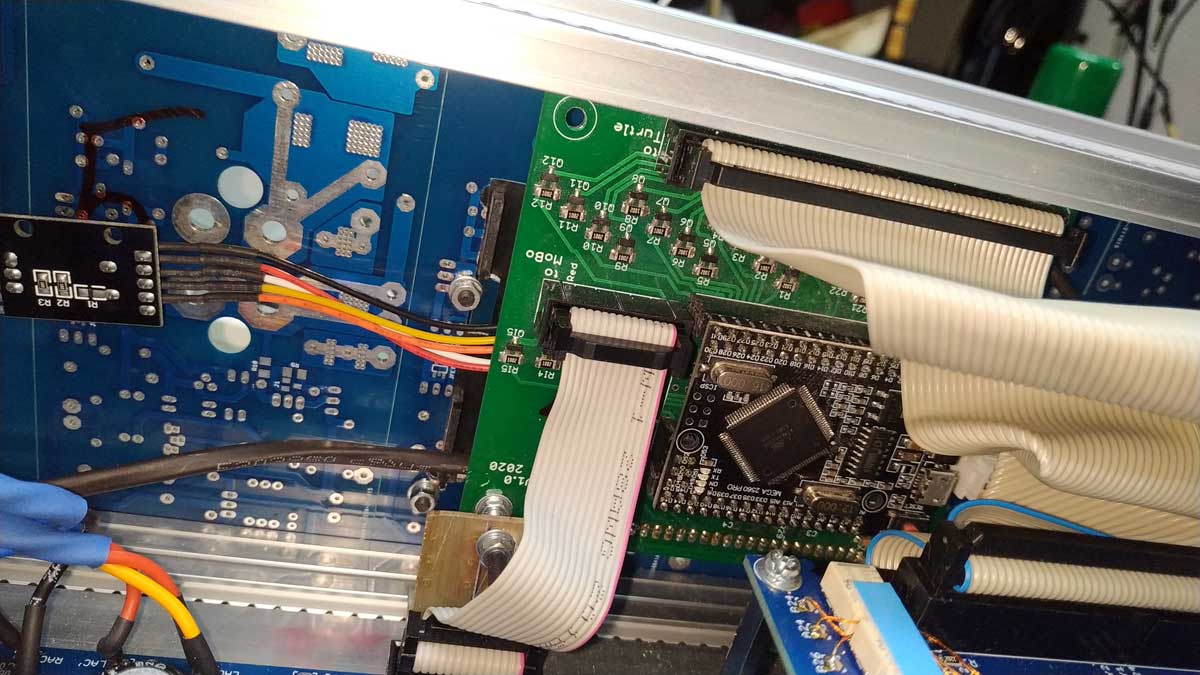

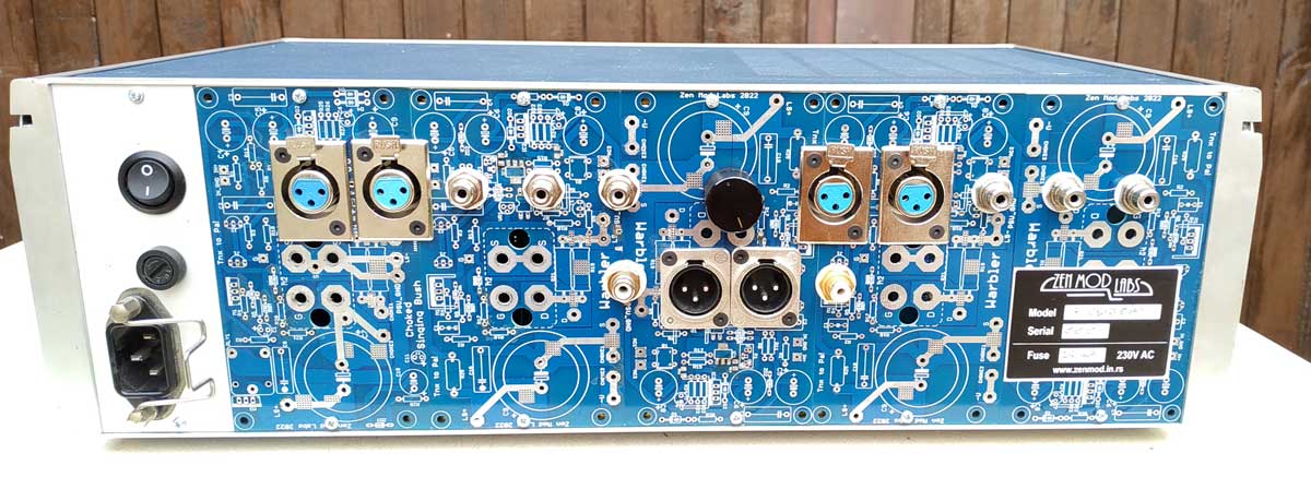

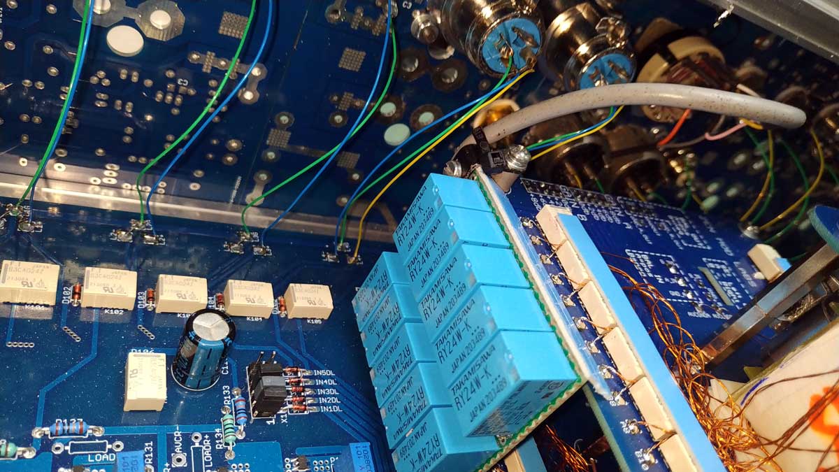

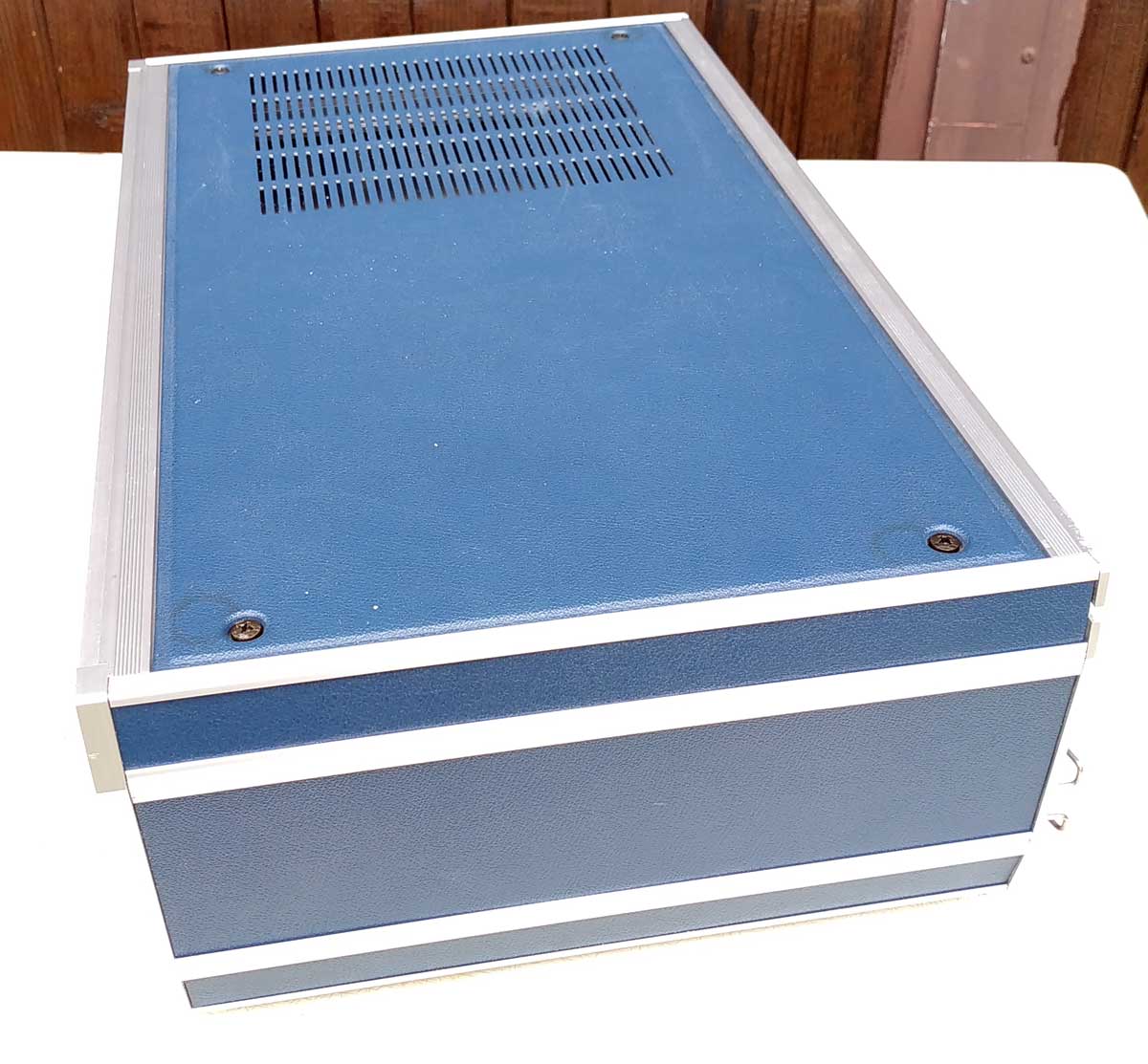

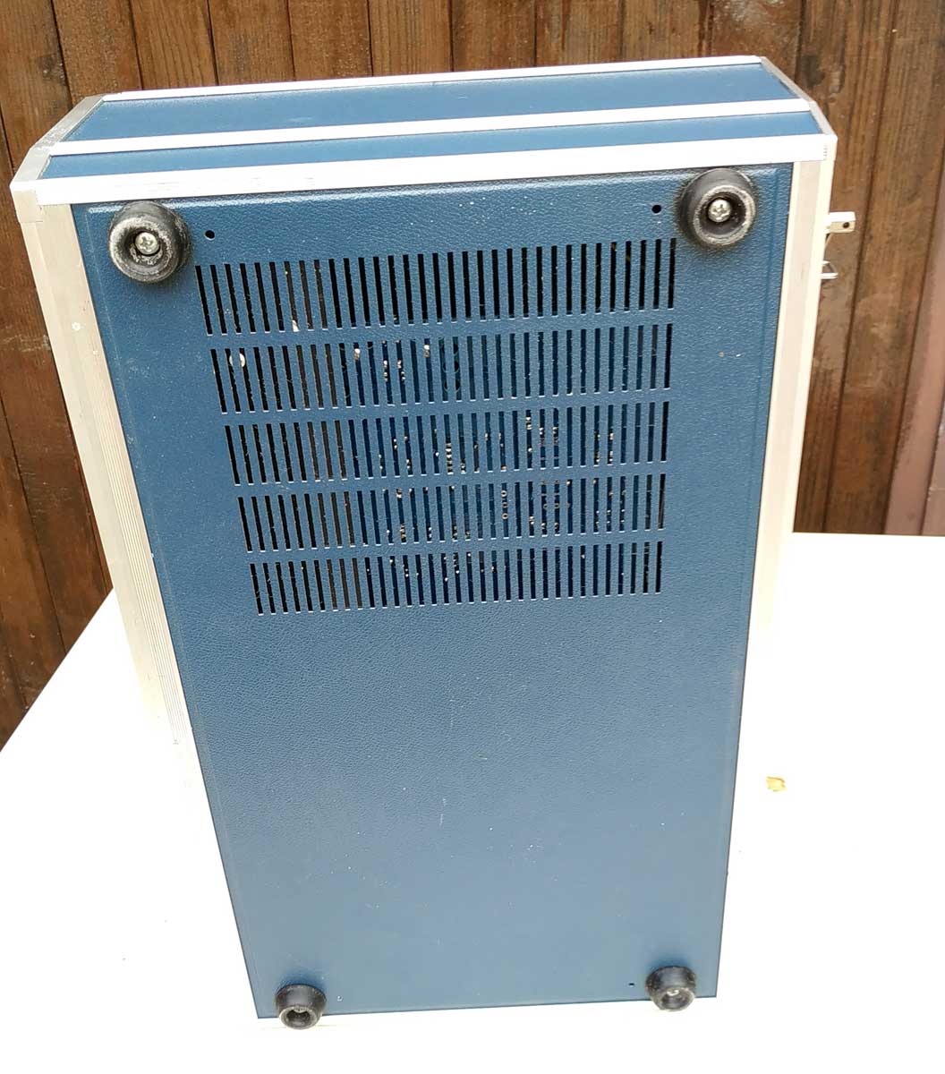

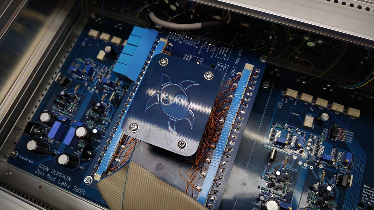

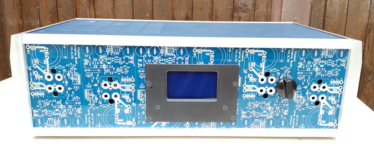

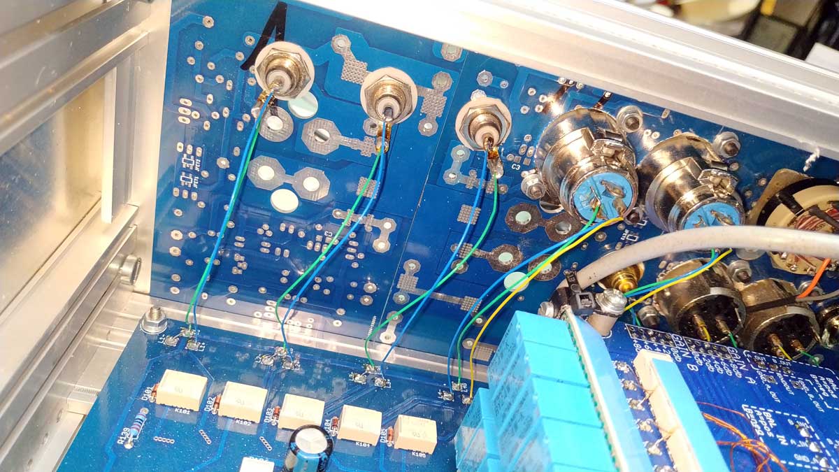

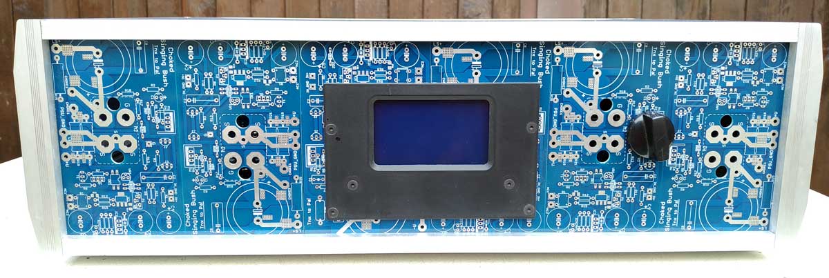

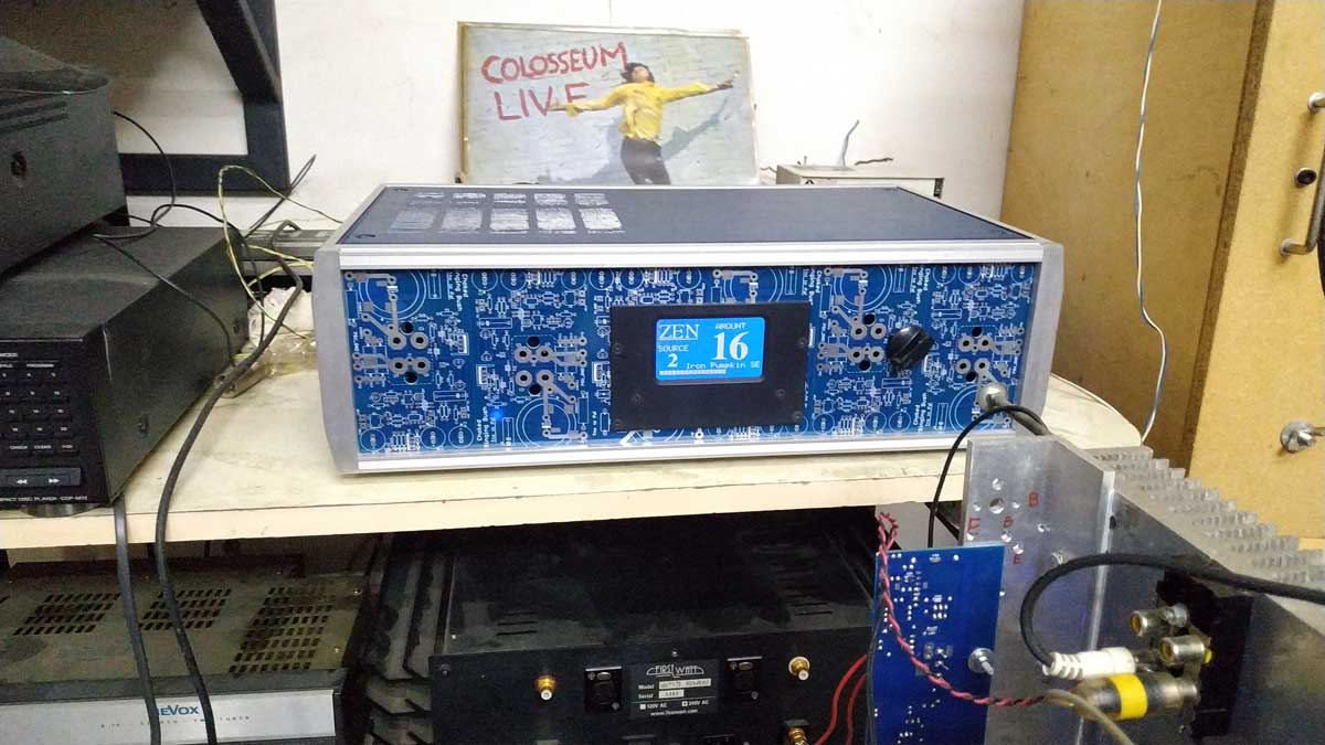

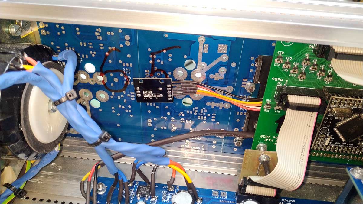

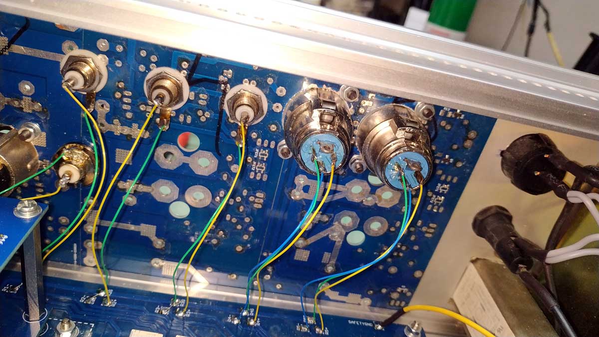

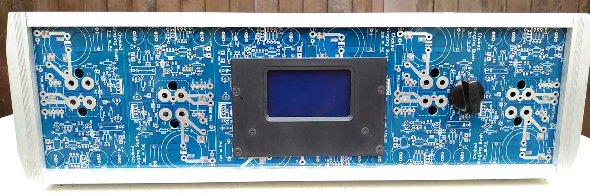

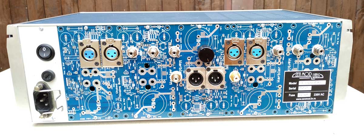

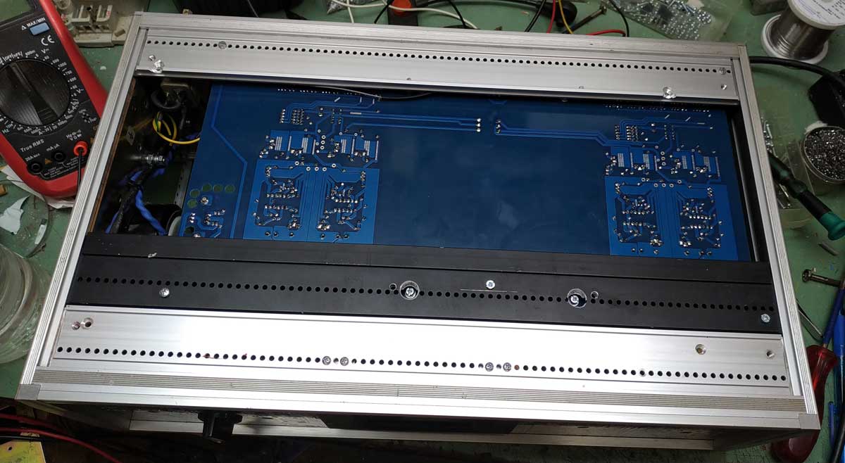

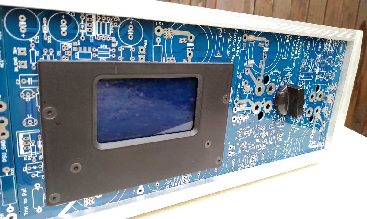

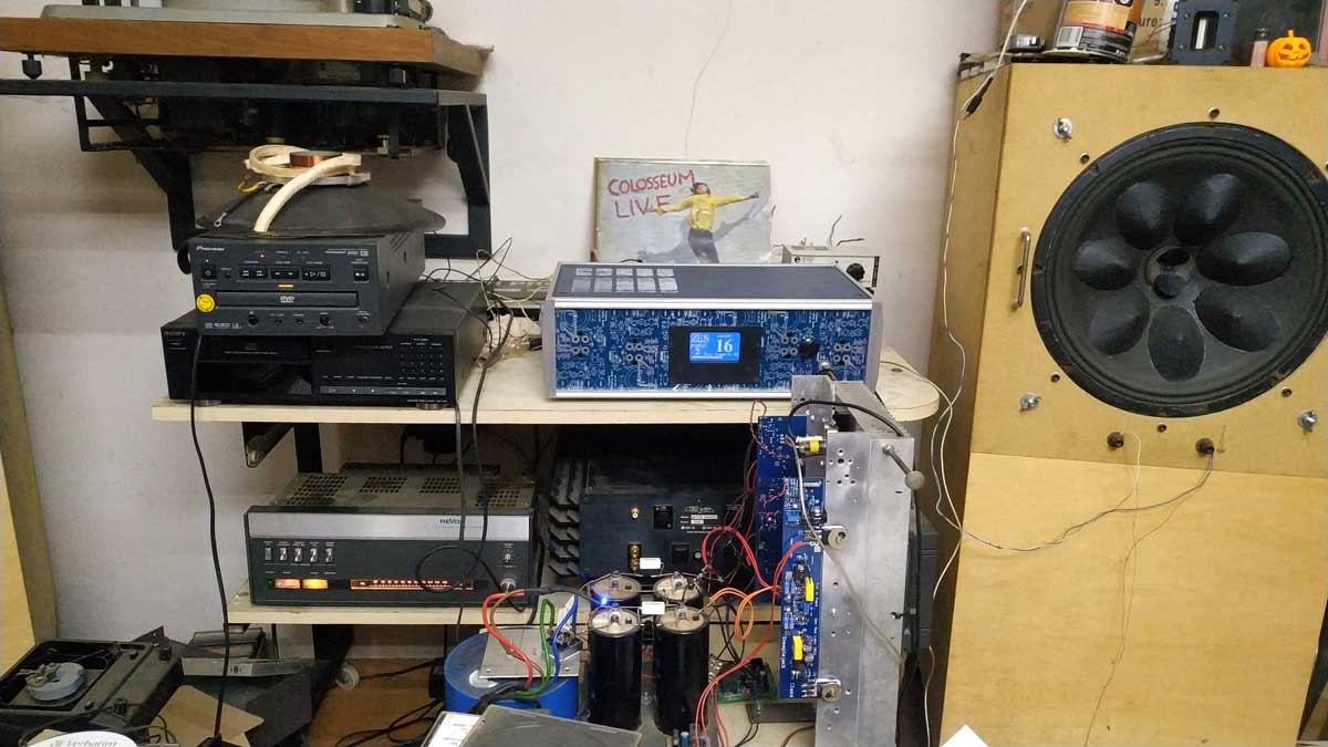

Zen Mod Napisano Oktobar 22, 2022 #1 Napisano Oktobar 22, 2022 Make it super ugly - only possible way to have it for good, without someone buying it of me, as it already happened few times with those I had as mine - simply because they already been on disposal. One of cases I bought cheaply, exactly for prototypes purpose, redundant pcbs ( leftovers from protowork) used for both front and back plates, old/initial crude display. As intended to serve also as demo specimen, set of gain setting jumpers replaced with battery of relays, controlled with 5-step rotary switch at back. Title on functional display sez "SE", will re-flash later, because I evidently made it balanced - 3 SE inputs, 2 Bal inputs. Lousy pics - Alu case elements showing bad on white background LightMatic, Aciko, shonne and 5 ostalih je reagovao/la na ovo 3 4 1

Brijac Napisano Oktobar 22, 2022 #3 Napisano Oktobar 22, 2022 Ima nesto u tom zvuku releja 😁 Zer gut 💪🏻
zika Napisano Oktobar 22, 2022 #5 Napisano Oktobar 22, 2022 E, pa,ne mrda se gumb kada se koristi daljinski... Protiv uroka...
NIXIE Napisano Oktobar 22, 2022 #7 Napisano Oktobar 22, 2022 Baš je vopla. asimze and Zbora je reagovao/la na ovo 2
Mikorist Napisano Oktobar 22, 2022 #8 Napisano Oktobar 22, 2022 pre 1 sat, Zen Mod reče ih, lepšiji je od Mikumovog Veći. pre 59 minuta, NIXIE reče Baš je vopla. Dobro je ima neko još luđi od mene sa idejama za dizajn
