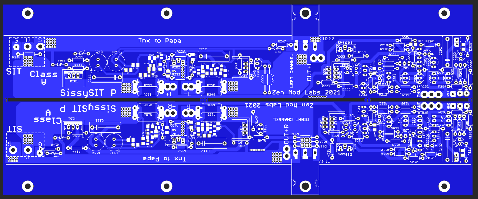

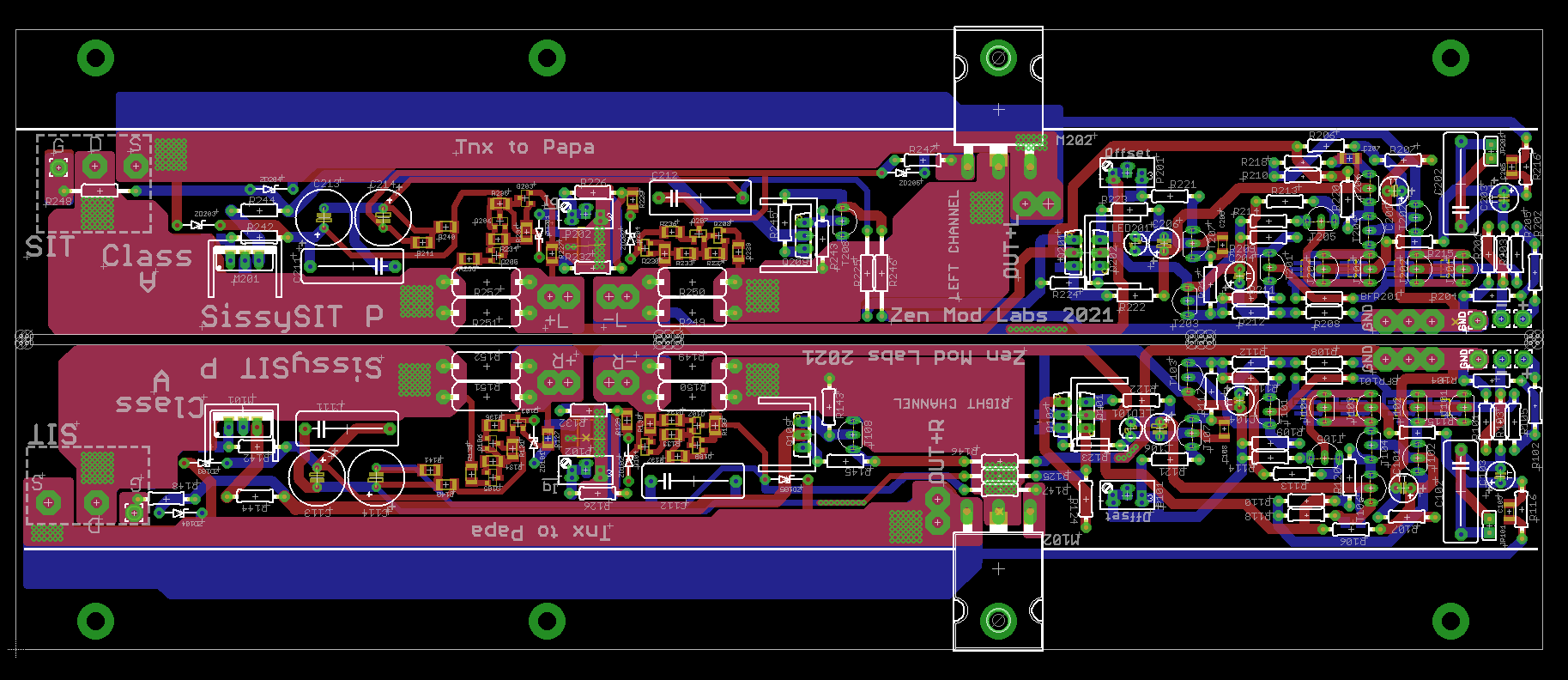

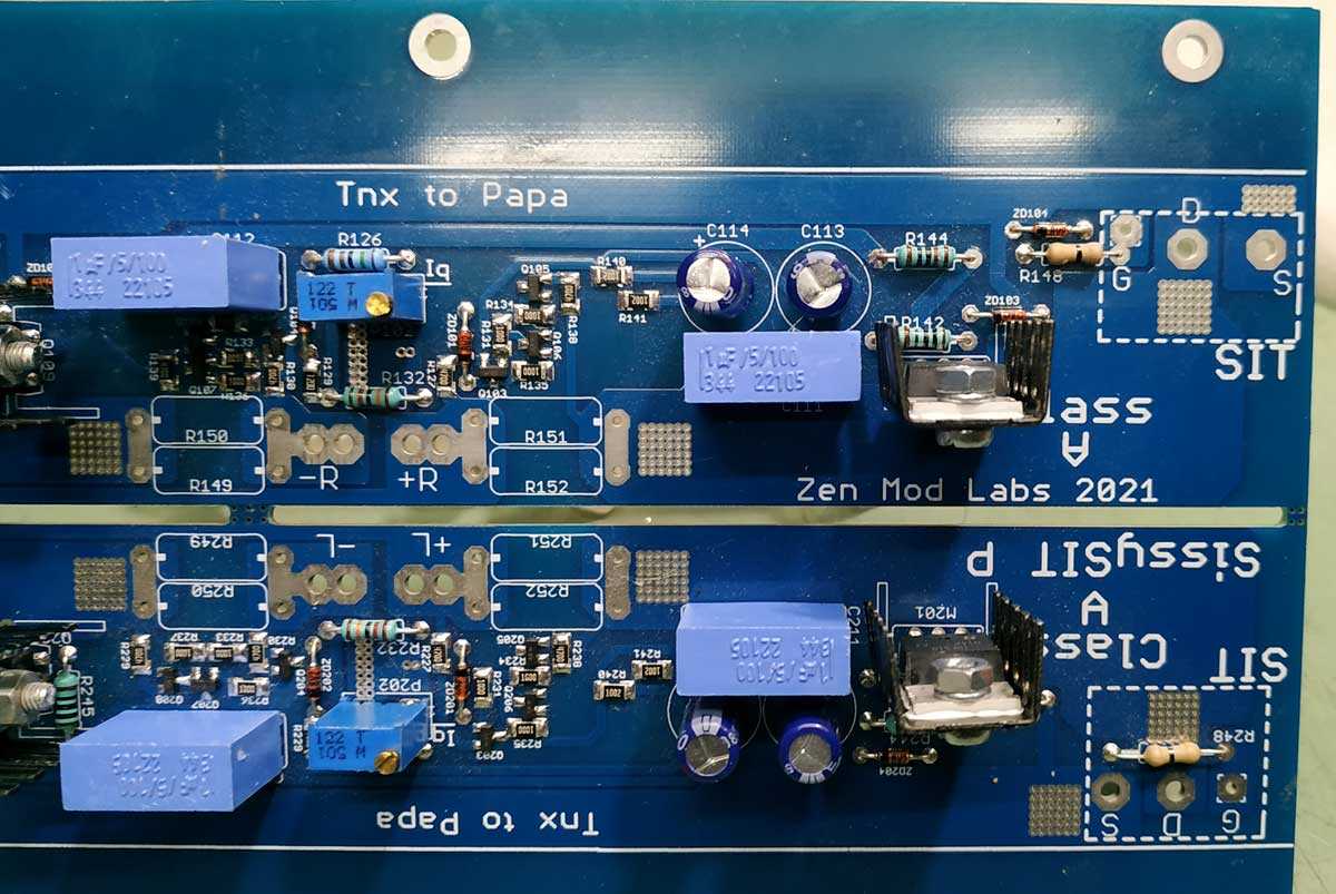

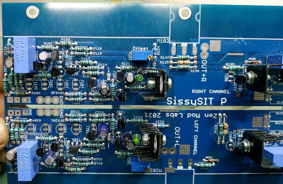

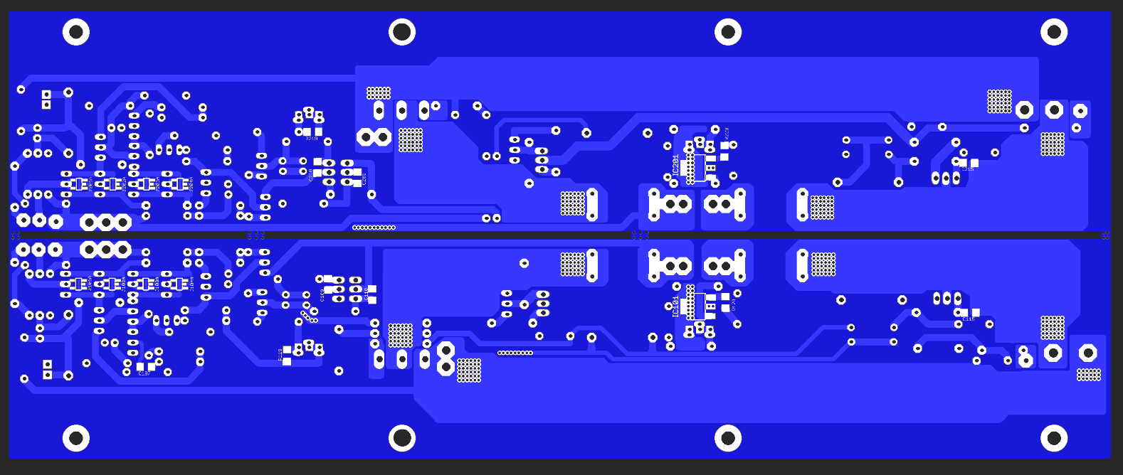

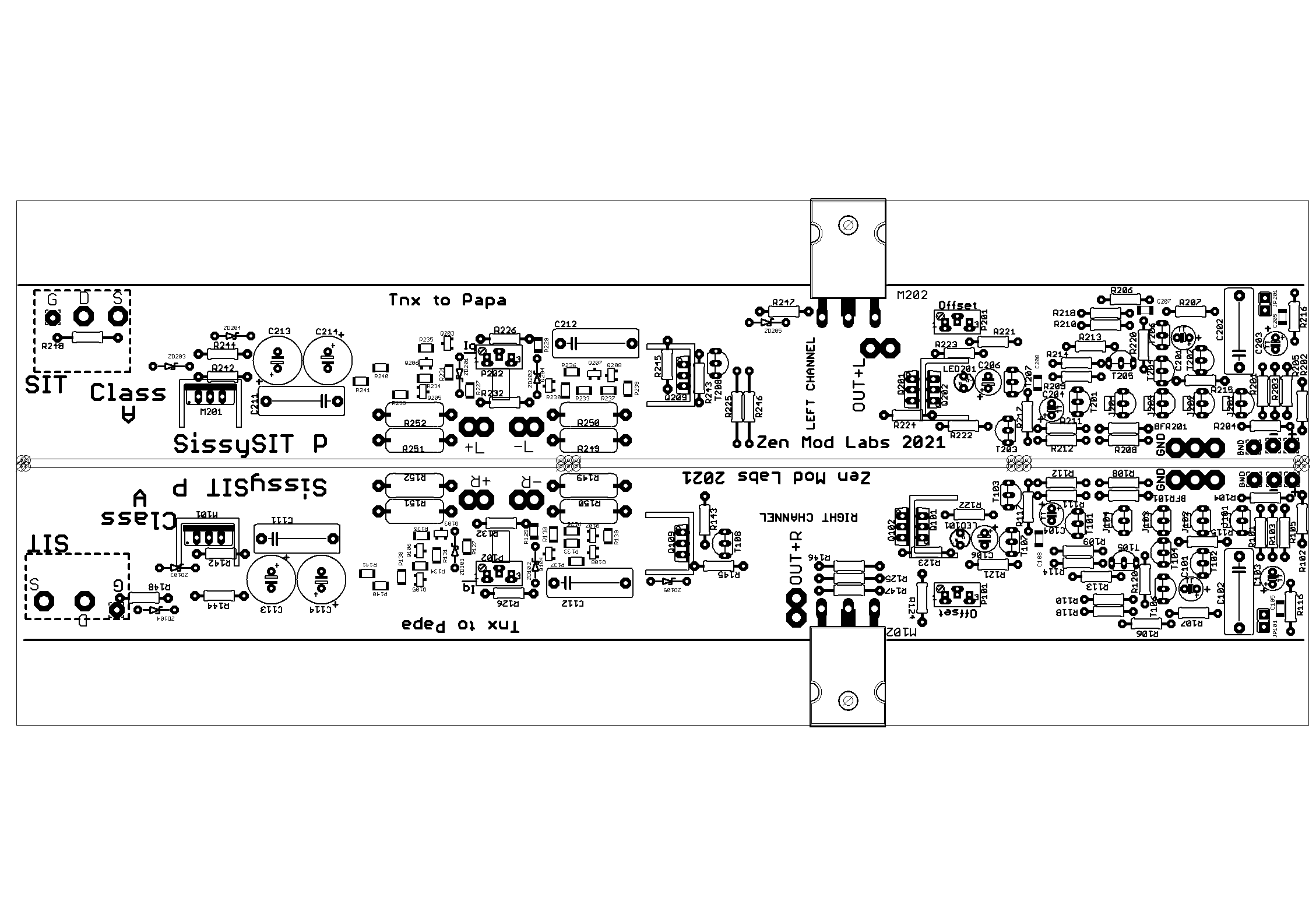

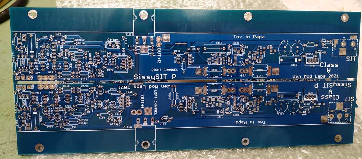

Zen Mod Napisano April 18, 2022 Autor #2 Napisano April 18, 2022 some fancy prepared pics shonne, LightMatic and Vix je reagovao/la na ovo 3

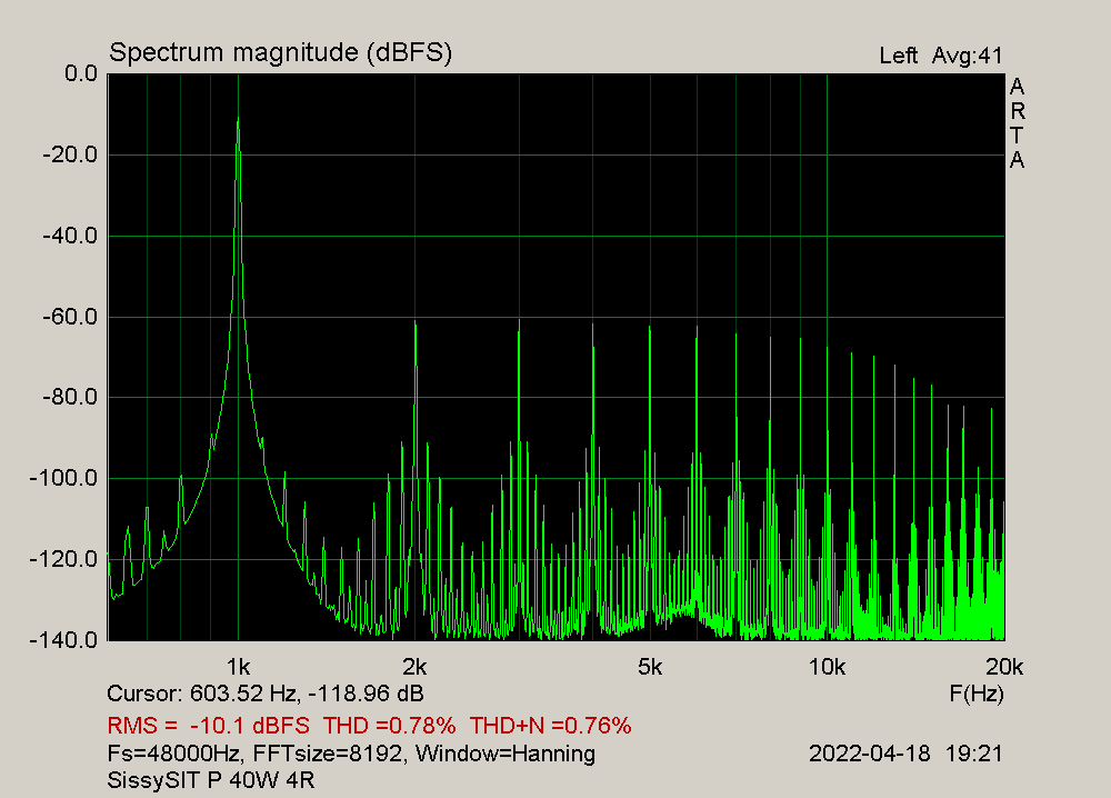

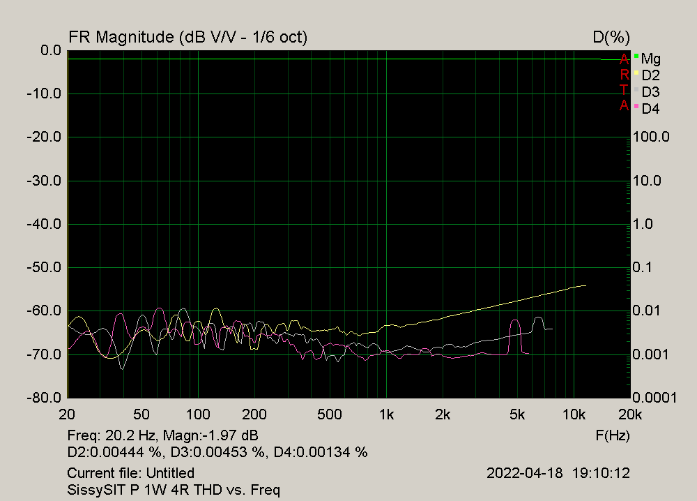

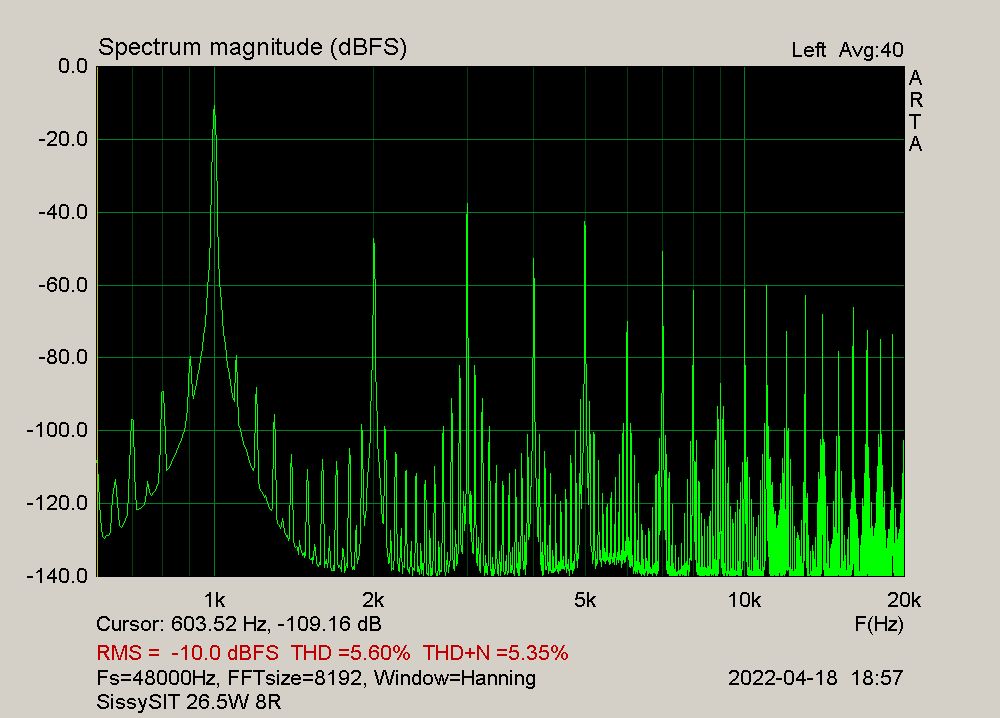

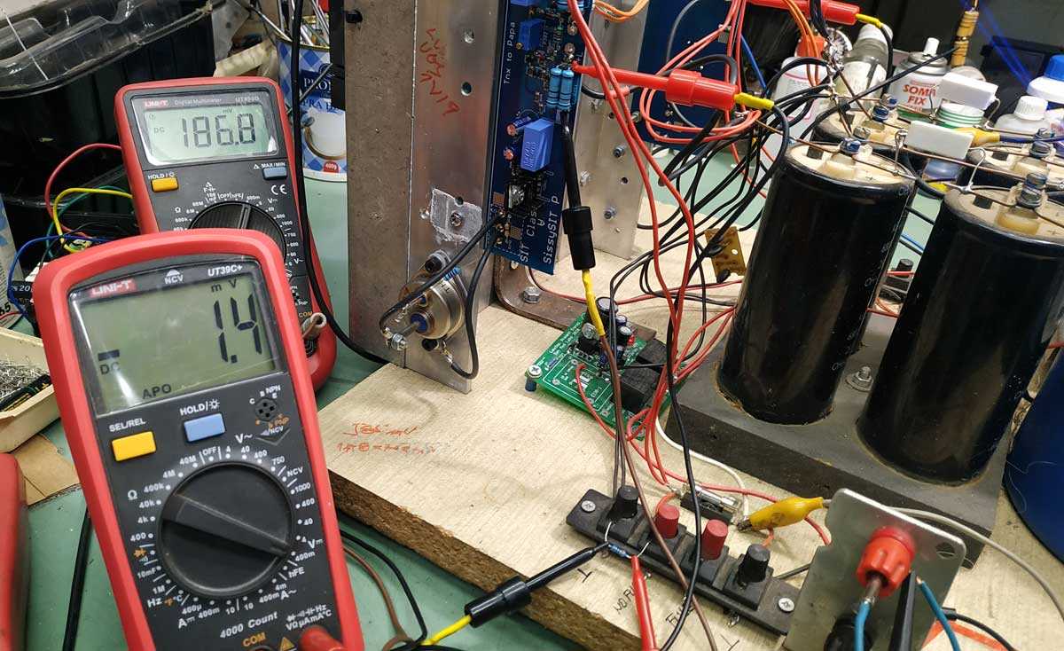

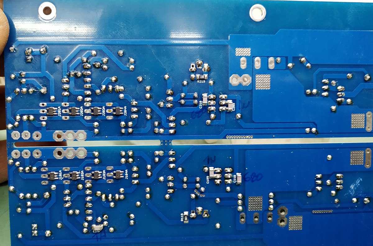

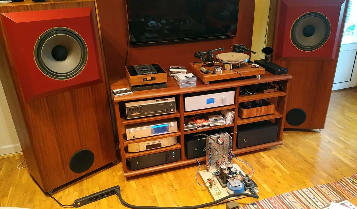

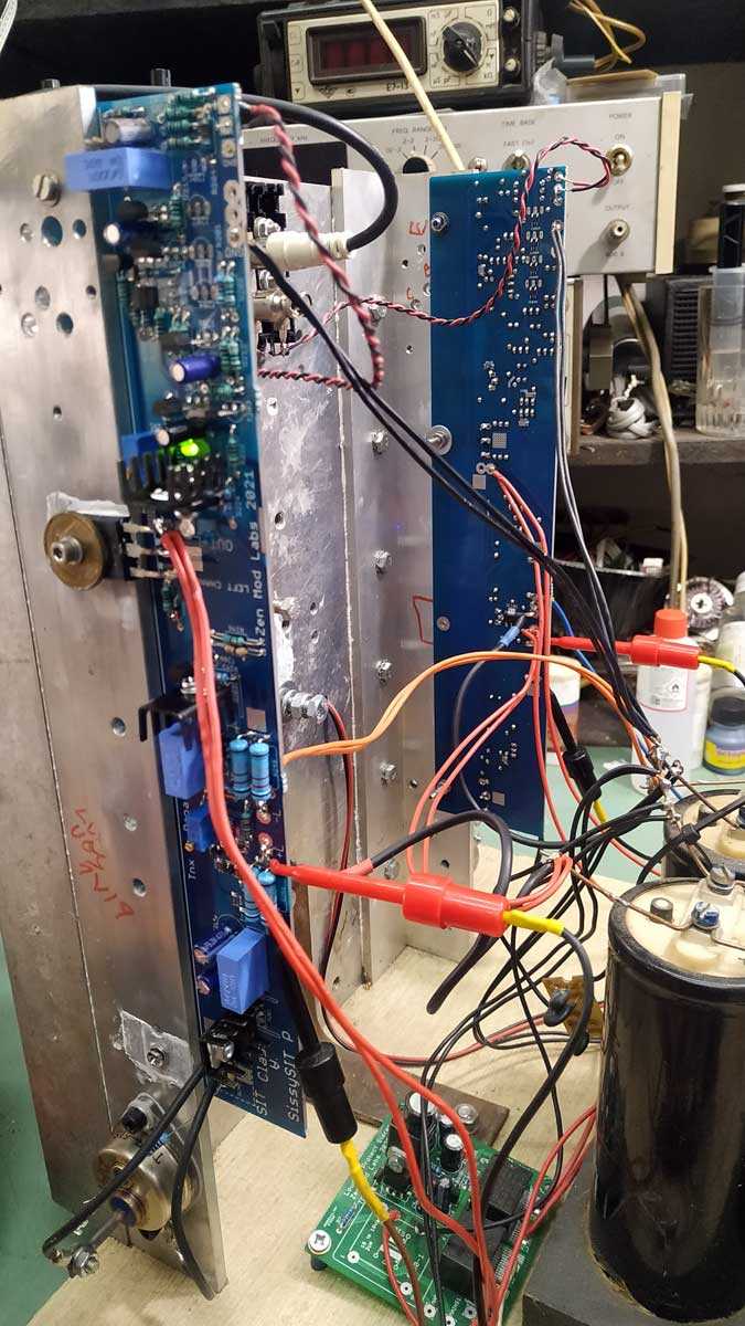

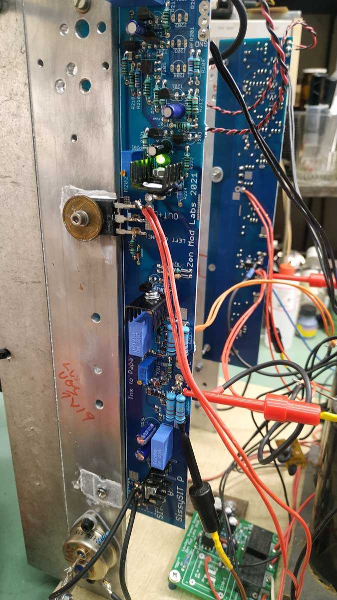

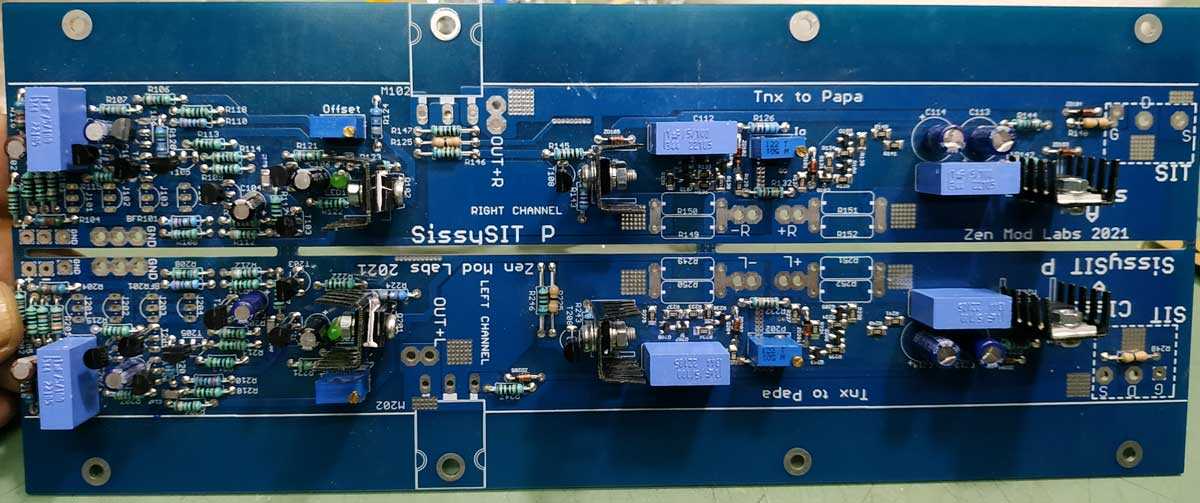

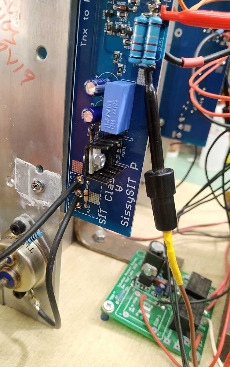

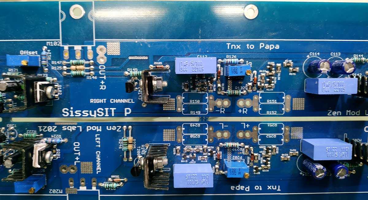

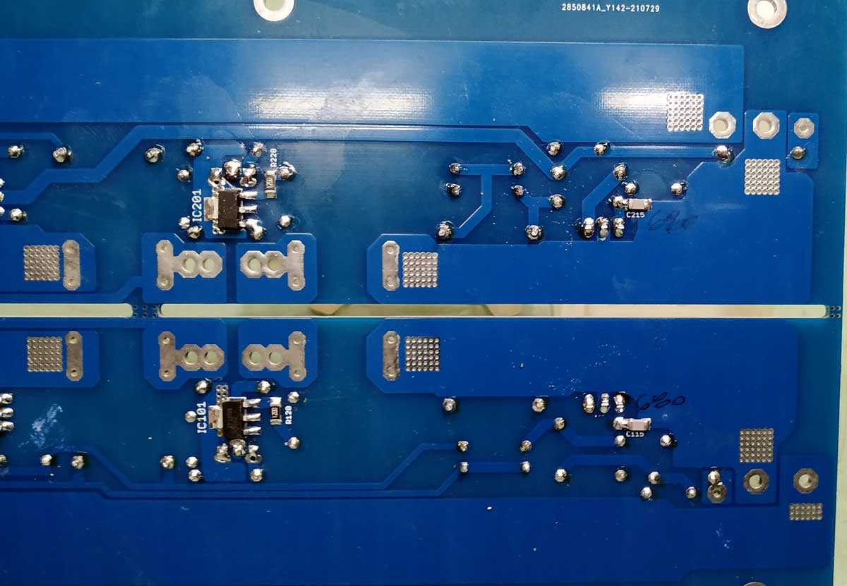

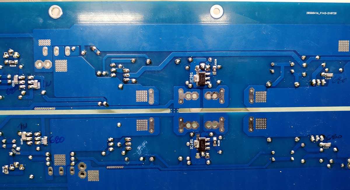

Zen Mod Napisano April 18, 2022 Autor #3 Napisano April 18, 2022 now some not so fancy pics 1/2 shonne, Vix and LightMatic je reagovao/la na ovo 3
Zen Mod Napisano April 18, 2022 Autor #4 Napisano April 18, 2022 2/2 Vix, LightMatic and shonne je reagovao/la na ovo 3

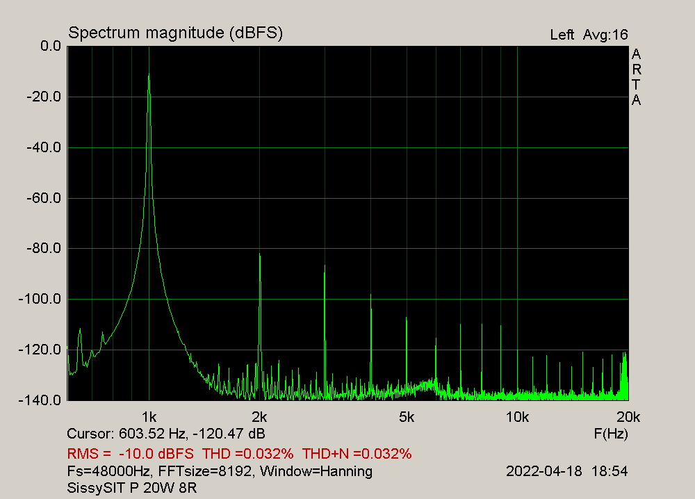

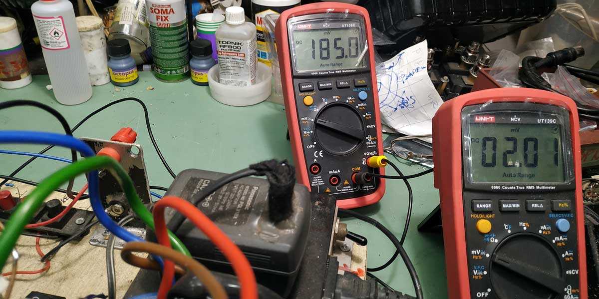

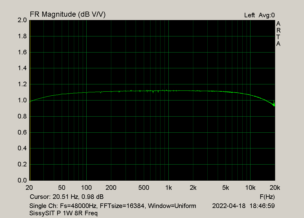

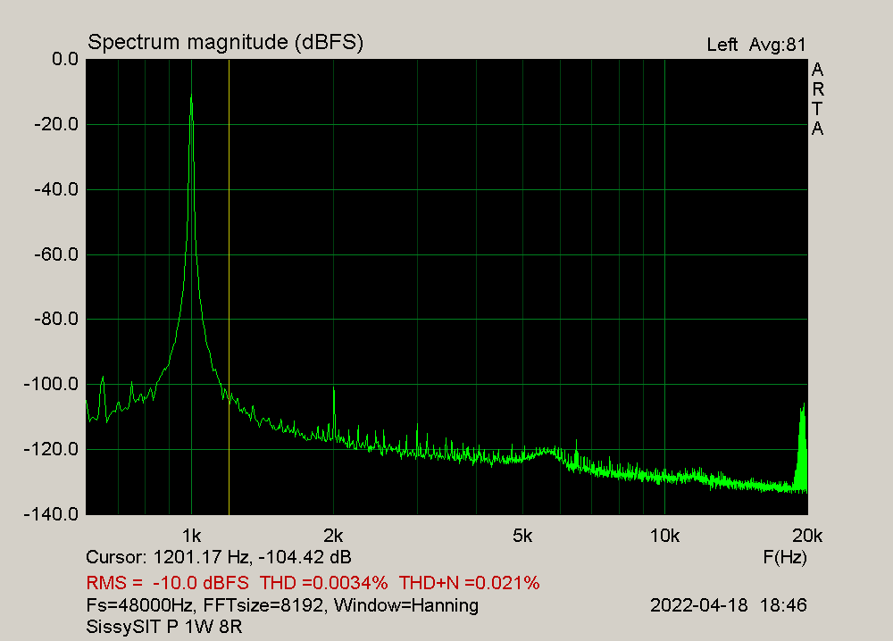

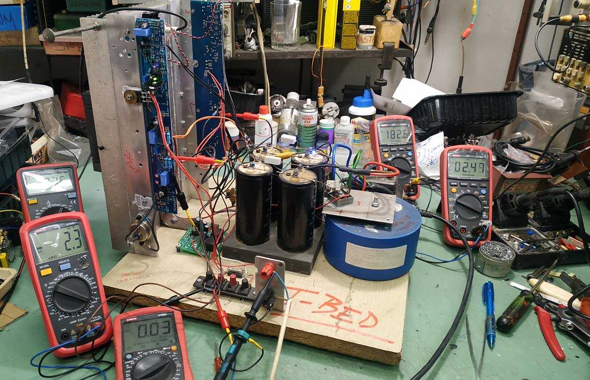

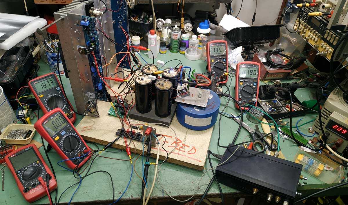

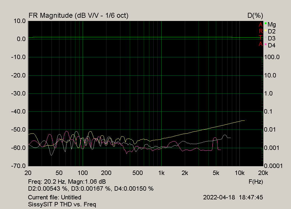

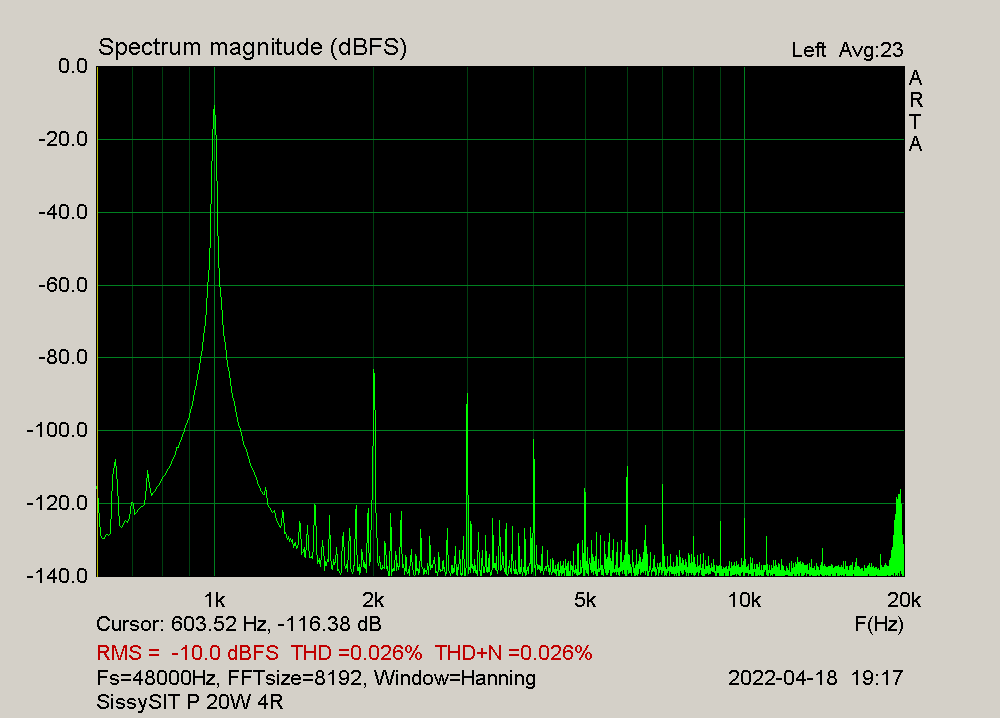

Zen Mod Napisano April 18, 2022 Autor #5 Napisano April 18, 2022 Proof is in da Pudding ( or how me Mom always said - eat your Porridge if you wanna grow strong and handsome!) Rails +/-24Vdc-ish, Iq 1A7-ish Load 8R shonne je reagovao/la na ovo 1

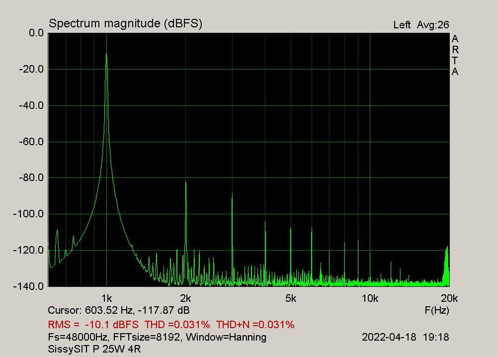

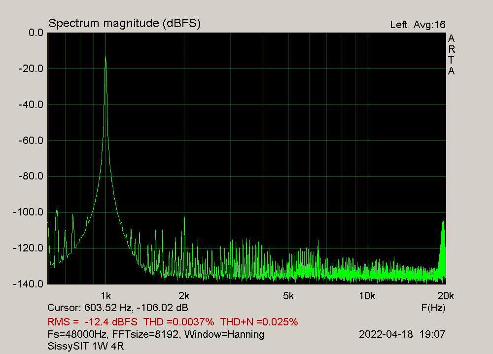

Zen Mod Napisano April 18, 2022 Autor #6 Napisano April 18, 2022 Second Jar of Porridge same conditions, 4R load shonne je reagovao/la na ovo 1

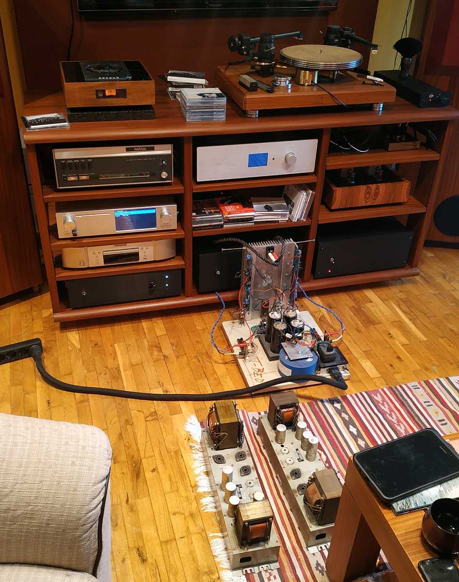

Zen Mod Napisano April 18, 2022 Autor #7 Napisano April 18, 2022 How it sounds? Well, as close Cousin ( younger one) of Babelfish XA252 SIT Good enough for Mighty Moi chakija, LightMatic and zerowaf je reagovao/la na ovo 1 2
shonne Napisano April 18, 2022 #8 Napisano April 18, 2022 Lepo ovo izgleda... cini se da je neutralno pojacalo po merenjima? Hoce li na slusanje nedje i impresije?
Zen Mod Napisano April 18, 2022 Autor #9 Napisano April 18, 2022 pa, po merenjima ..... uporedi sa sebi omiljetim ce vidimo za slusanje

chakija Napisano April 19, 2022 #11 Napisano April 19, 2022 Po merenjima ne može da svira dobro... NIXIE je reagovao/la na ovo 1

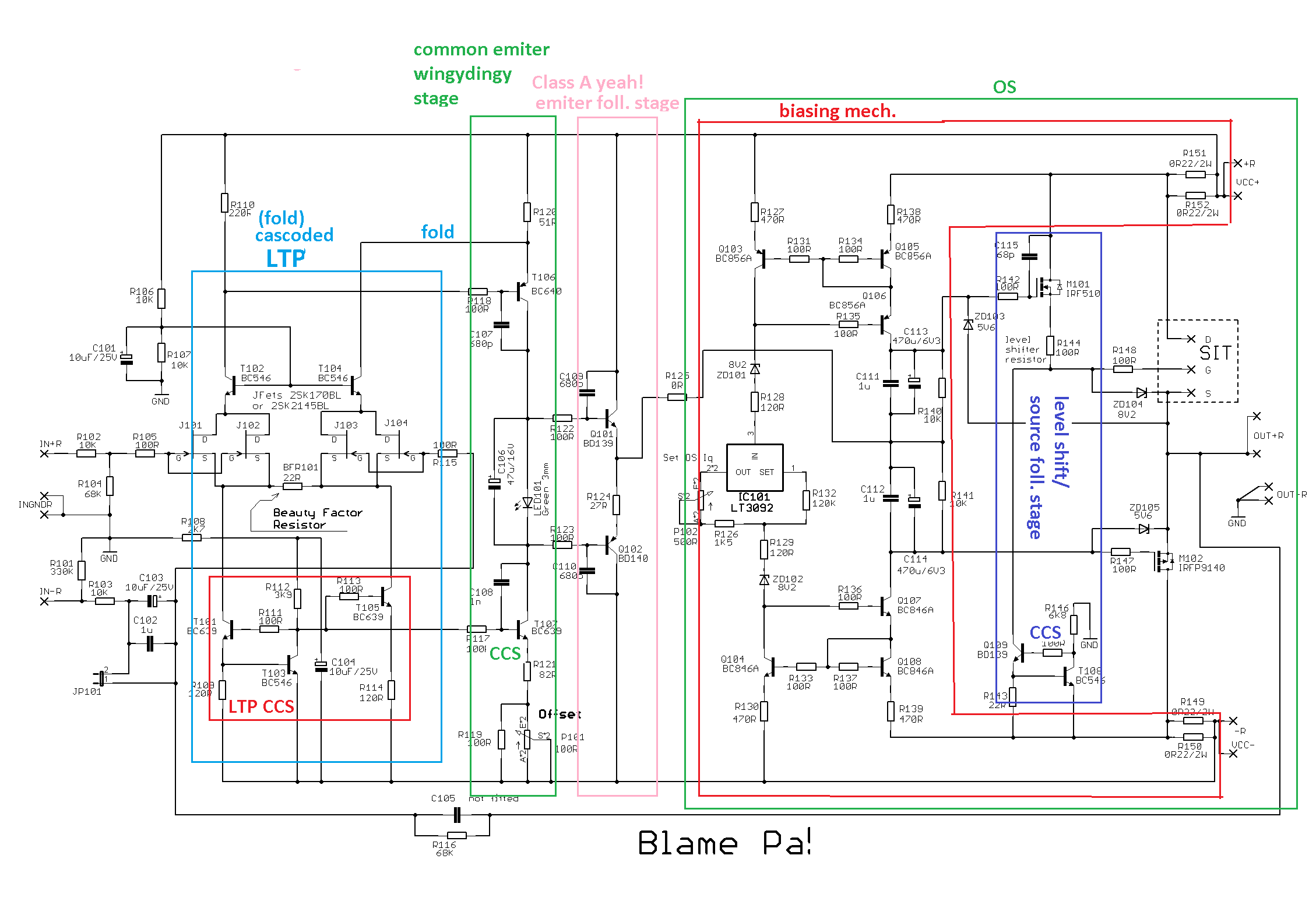

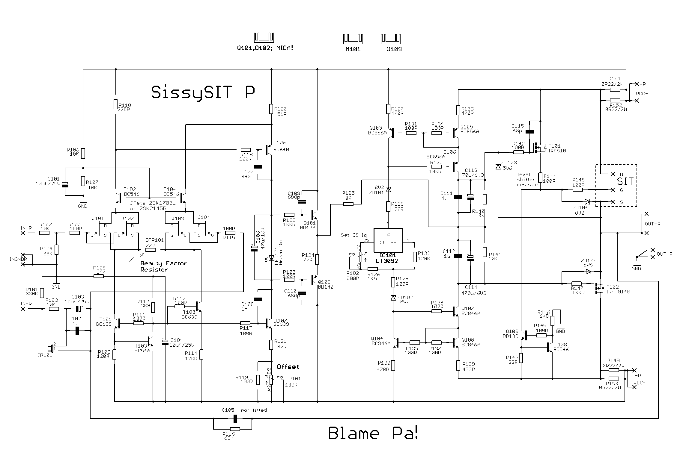

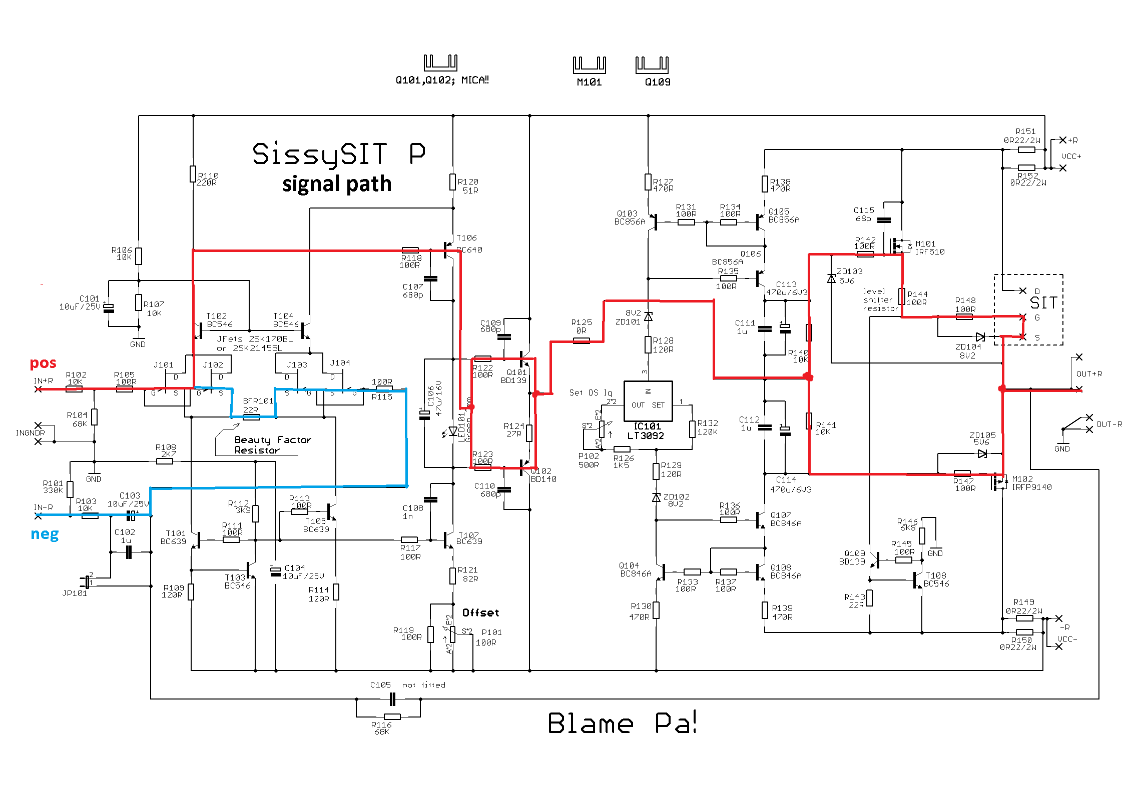

Zen Mod Napisano April 19, 2022 Autor #12 Napisano April 19, 2022 SissySIT P signal path, simple as it can be
Zen Mod Napisano April 19, 2022 Autor #13 Napisano April 19, 2022 and, while in Office SissySIT P block schm. as Pa would count it , two stages, plus two half stages ( how would Dr. Haus comment ? considering M2 derivatives, where we have - half stage, xformer stage, half stage ..... so by ZM Count - no stages at all!)
Mikorist Napisano April 19, 2022 #14 Napisano April 19, 2022 Eto i napismeno gde treba da se stavljaju fensi otpornici
Zen Mod Napisano April 19, 2022 Autor #15 Napisano April 19, 2022 aha za take cu da napravim pcb od hektar, i da naplacujem u tezini zlata audiofooleraj treba postovati

Woland Napisano April 20, 2022 #18 Napisano April 20, 2022 nije se obru'ko, džaba sam se ponadao - nedade mi priliku da ga pošteno opljunem a, ono P u nazivu mu ga dođe od Pošteno, a ne od štatijaznam šta su ti Plethora of Pinjatas (znam al' me boli uvo), zato što pošteno svira križanac je to između SissySIT i XA252, malo više zanosi na XA stranu: zvuk čist na drugu decimalu, sa dominantnim drugim harmonikom, dakle muzikalan, poprilično detaljan i pocupkujući, dakle zabavan.. brzo pojačalo, veoma konkretno u sredini, očekivano precizno u basu i neopterećujućih visokih i ova iteracija sledi već poznatu (meni) ideju na dnu druge fotki se vidi poklon koji sam dobio hvala još jednom i da - slušali smo Gabi Novak, ploču sa kraja šezdesetih dejanco32, zerowaf and LightMatic je reagovao/la na ovo 3

Koja Napisano April 20, 2022 #20 Napisano April 20, 2022 (izmenjeno) 1 hour ago, Zen Mod said: Suviše tanak taj kabel za struju Nadam se da je samo probni Izmenjeno April 20, 2022 od Koja
