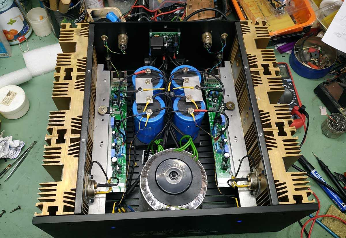

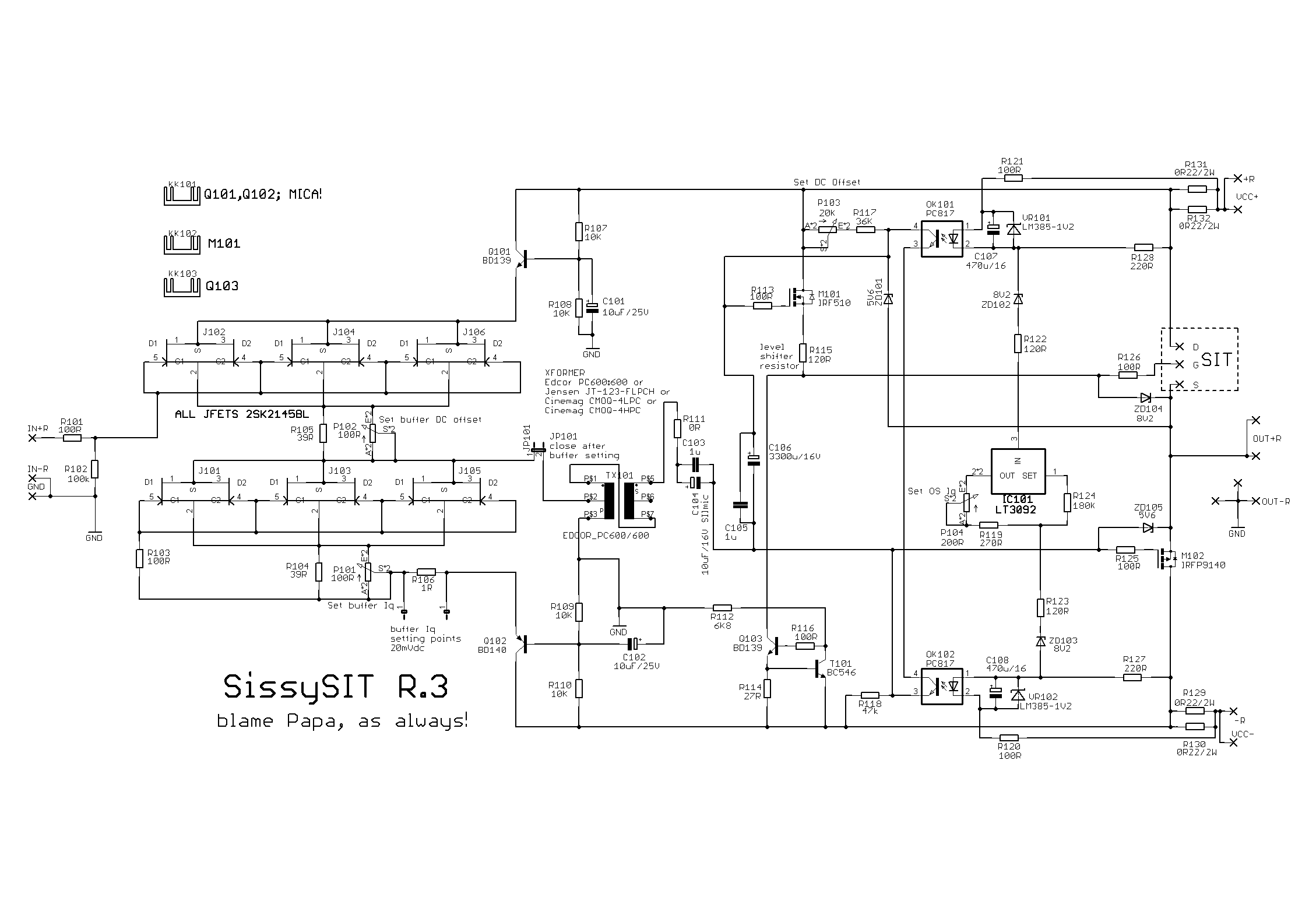

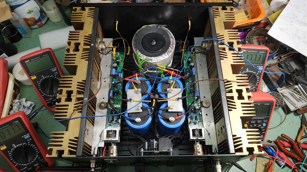

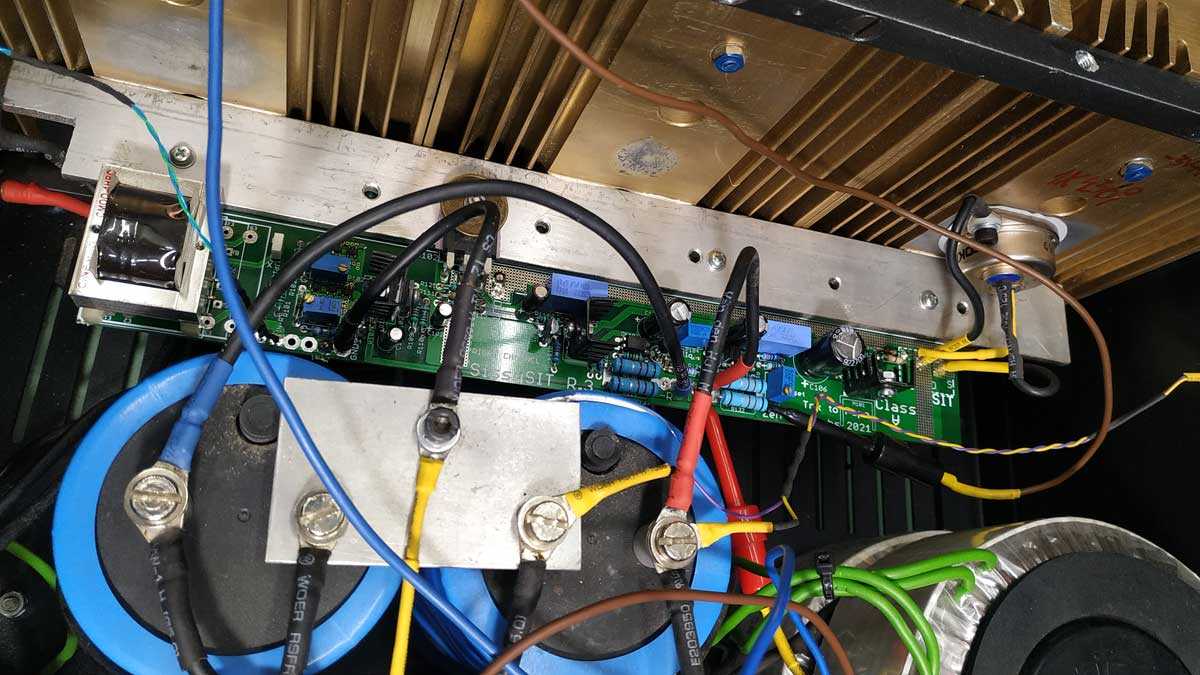

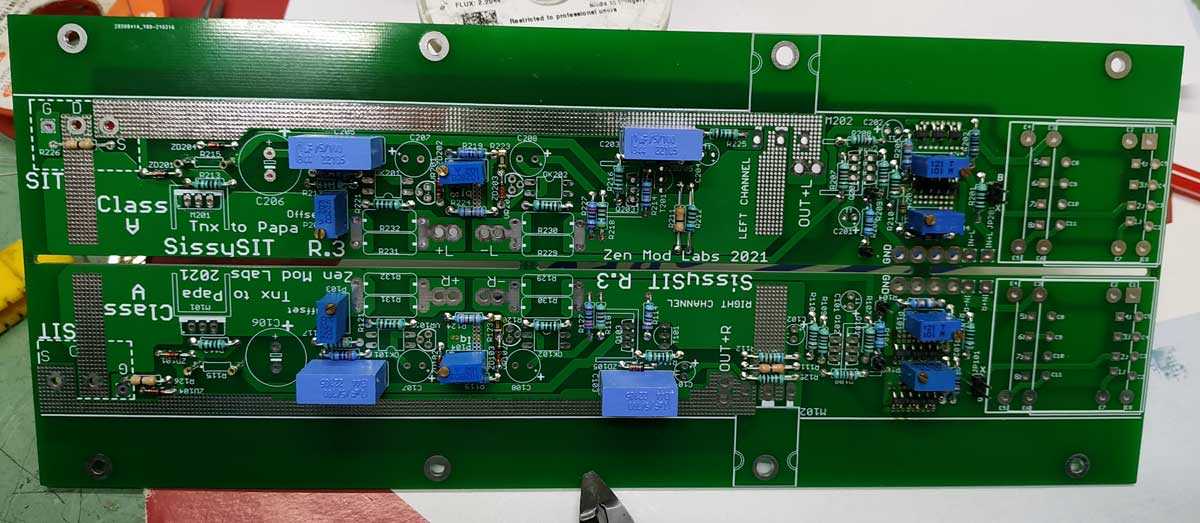

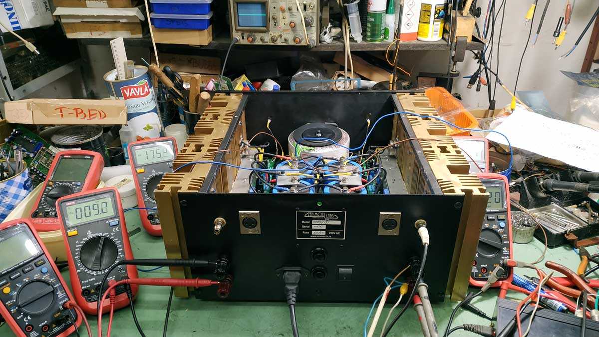

Zen Mod Napisano April 21, 2021 #1 Napisano April 21, 2021 Lenj da prekucavam, kao i obicno, pa ce samo copy-paste sa Big DiyA or - Look Ma, with no hands,Beast with thousand iterations!! Logic demands that main schm is here, and all future edits, if and when needed Few facts, for start, so when you ask, I can point you to this post: Rails - regular FW Format - in my case that is 300VA Donut per channel, 18+18Vac secondaries, two Graetz bridges per Donut Iq - 1A7 to 1A8 Autoformer - Cinemag CMOQ-4HPC OS - generic ( means don't care which Factory) IRFP9140 and THF51S Keratherm 86/82 pad for Mosfet, no-name silicon sheet for THF so, schm (as you can see, it is in fact simplified LuDEF ....... which is logical - this exactly lead me to LuDEF and few other Bstrd amps; stay tuned ) Aleks, Vix, shonne and 1 član je reagovao/la na ovo 3 1

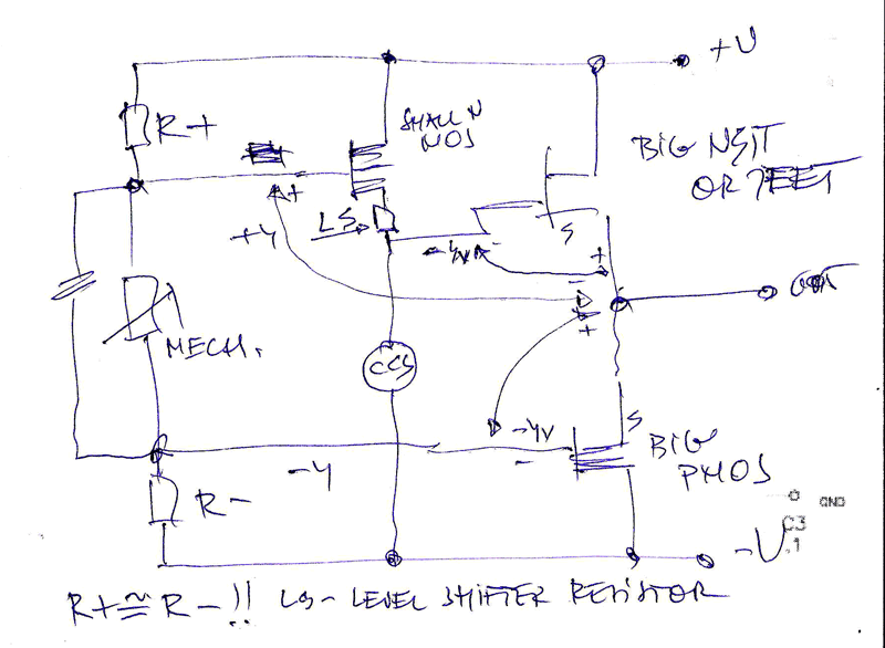

Zen Mod Napisano April 21, 2021 Autor #2 Napisano April 21, 2021 Main reason/objective for this - third iteration of same amp is twofold : - to enable use of any Ugs SIT ( so no more preferred range); - to feed that little Devil in my head, saying all the time - "you didn't make it properly, you didn't make it properly..... " I believe I succeeded in both To explain logic and problems, I think it's easiest to paste here few posts from LuDEF thread ( instead of putting links to them, I know many Greedy Boyz are if not lazy, they;re at least spoiled ) so, read this for fun .... if you already did, just skip down, unitil you see some porn posts Biasing Mechanismus: well, really nothing new under the Sun - meaning there is hardly anything specially new or unique that I put here even if Papa really started us Greedy Boyz playing with Square Law OS arrangements, thing is old as Wheel, in fact also - using rail series resistors, again Papa's bag of tricks ( for us) but again nothing especially new neither source follower ( which is introduced here in front of upper output device) used as level shifter is anything new ..... thing is - it's hard to make anything absolutely unique, and wishing just that is right recipe to get yourself in not making anything at all ....... so , studying schematics from everywhere and one can just hope to get in situation to stand on Giant's shoulders one day ...... one day ............ anyway - here is basic , lets call it , M2 biasing mechanismus; simple as that: we have R+ connected to upper part gate, we have R- connected to lower part gate, we have some variable impedance connected between gates; varying that impedance we are varying voltage sag across R+ and R- , thus positioning gates at appropriate voltage potential ( one vs. another) , thus setting how much Iq will pass trough output devices call that variable impedance Rvar, further Mech. , shorted of mechanismus cap between gates is there to eliminate AC to appear between gates - we don't want that ........ and also worth to mention - R+ and R- are sorta same in value , difference being just what we need to set output offset to 0 ( N gate and P gate voltages not exactly being identical)

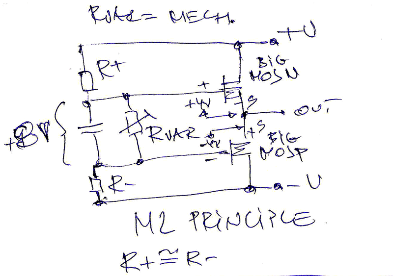

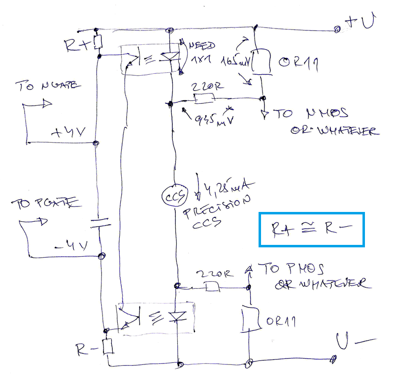

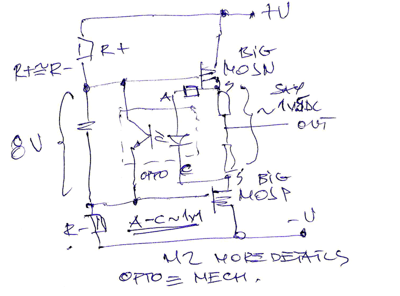

Zen Mod Napisano April 21, 2021 Autor #3 Napisano April 21, 2021 M2 in more details; as said - it's relatively easy when we want to use source resistors as Iq reference points; I mean - easy when we got recipe from Mithrandir also easy when we are using lower and upper output parts having so-so equal gate voltages, opposite side of output node, meaning +4V and -4V optodiode connected across source resistors, series resistor to optodiode taking care that diode is not getting more than nominally 1V1 , at preferred Iq through source resistors opto transisttor is now MECH. , governing current through R+ and R- , everything is Wine and Roses

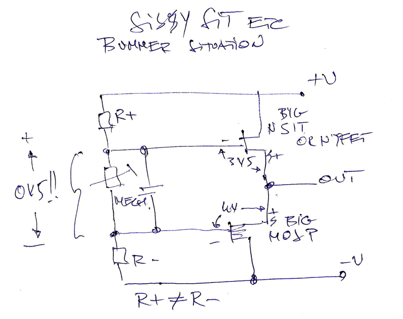

Zen Mod Napisano April 21, 2021 Autor #4 Napisano April 21, 2021 things are getting tricky when we want to use different part than Mosfet ( either up or down) , while using same biasing technique say SissySIT (DEFiSIT) - Toking Bigun is different to N mosfet in that way that gate voltage is opposite in sign (differene between enhanced vs. depletion mode parts, +4V-ish vs. -3V-ish) now voltage window between gates is no more twice 4v (+4V reaching down to -4V), now it is -3Vsomething reaching to -4V we are happy campers if we have SIT with Ugs no greater in number than, say , 3V7 , so we have big enaough voltage window between gates, to squeeze optotransistor in some P mosfets are having Ugs in range of -4V5, thus allowing as little broader batch of Tokins to be used, but that's just one more thing to take care with, endless parts picking ....... current through R+ and R- is, logically, one current; due to fact that gates are not symmetrical to output node, now R+ and R- can't be approx. same in value, resulting in few problems, of which most important one is that mains fluctuation resulting in sliding output DC offset , also parts TempCo playing game with Iq, then rails fluctuating down ( if not regged) etc. Luckily , I succeeded more or less in set of compromises while making SissySIT , both first one and R.2
Zen Mod Napisano April 21, 2021 Autor #5 Napisano April 21, 2021 now, how to solve those issues ...... unequal Rail resistors , SIT parts with greater Ugs number ..... sometimes time is needed either to make space for new problems in thick skull, or just to have some leeway, then be able to step aside and look at problem from another point level shifter part, that's it small mosfet, so Ugs is sorta symmetric to big mosfet down Ugs, .... suddenly Rail resistors are sorta equal again, practically no gate currents to complicate things ( as is case with some not so well behaving Tokins) principal schm down; ignore MECH. principle fro now I think everything is clear, except note about LS resistor - its value is roughly SIT Ugs divided with current trough small Mosf/LS res./CCS ;say that you put value just being in ballpark; you can always go back and alter its value , to get wanted symmetry of lower and upper mosfet Ugs values
Zen Mod Napisano April 21, 2021 Autor #6 Napisano April 21, 2021 now, as all important is explained, time to mull about rail sense I know for sure that Pa is using something in that manner already in PL products, but him being Pa - solving everything with resistors and zeners as level shifters Mighty ZM , being chicken , I didn't up to recently even know that resistor can be described as CCS ( even if poor one), and I decided to use helper CCS ( see explanation) in form of ultramumbojumbo5$specialpart in M2 case - wee see that optodiode is fed with voltage from source resistors, where we have voltage in abundance, even shaving it with series resistor in SissySIT ( still damn good piece of work, if you ask Mighty Modesty Moi), I did use Hall chips ( tnx, Mighty Indra) ....... slope of voltage given at chip output is (2V5 to 5V)/(0 to 5A) ........ but effectively lower due to all summing and whatnot; didn't tried zeners as level shifters to decrease summing losses, but damn slope must be same , shifted with resistors or with anything else working, but I maybe didn't knew that I can do better, but I obviously wished that I can do better, regarding Iq and offset stability in rail voltage/temp/time domains so, if one choose to use ( minimal needed value of) rail resistors as current sense chain, even with 0R11 ( two of 0R22 in parallel) we have better effective voltage slope with current change ; numbers doesn't compute exactly, but from actual circuit, behavior is better than with Hall Chips now ....... say that current is 1A5 , as in LuDEF we have 165mV across 0R11 sense resistor......... ( I didn't want bigger value, sue me ...... later I got that voltage slope is enough with that value ) ..... but optoled needs nominally 1V1 to shine happily ............. so- there is a trick with helper CCS ( again, Pa using resistor there) , which is going to add some voltage to optoled - simple addition of 220R resistor and CCS pulling some current , we got additional 935mV from there, when you gotta that optoled is shining happy, everything is just matter of more or less voltage through series 0R11 all that nicely transposed to opto in lower rail, so we now have rail resistors, each of them having own optotransistor to pull current trough, optotransistors are summed together again, cap between two rail resistors, if using any of preceeding solutions with two mosfet gates ( one up, one down) we have symmetrical values of rail resistors, everything behaving nicely and polite and .......... almost boring (M2 is same boring, regarding that) so, what was left - put all these puzzle pieces on table and combine them much greater problem is to choose which one of wast number of permutations is worthy of becoming an amp, than drawing any of them if I forgot something , blame Pa
Zen Mod Napisano April 21, 2021 Autor #7 Napisano April 21, 2021 Iq 1A7 no significant difference between stone cold and Temp. equilibrium state load 8R
Zen Mod Napisano April 21, 2021 Autor #10 Napisano April 21, 2021 .......... Vix, dejanco32 and sp300b je reagovao/la na ovo 2 1
Zen Mod Napisano April 21, 2021 Autor #11 Napisano April 21, 2021 .......... krca44, dejanco32, shonne and 1 član je reagovao/la na ovo 2 2

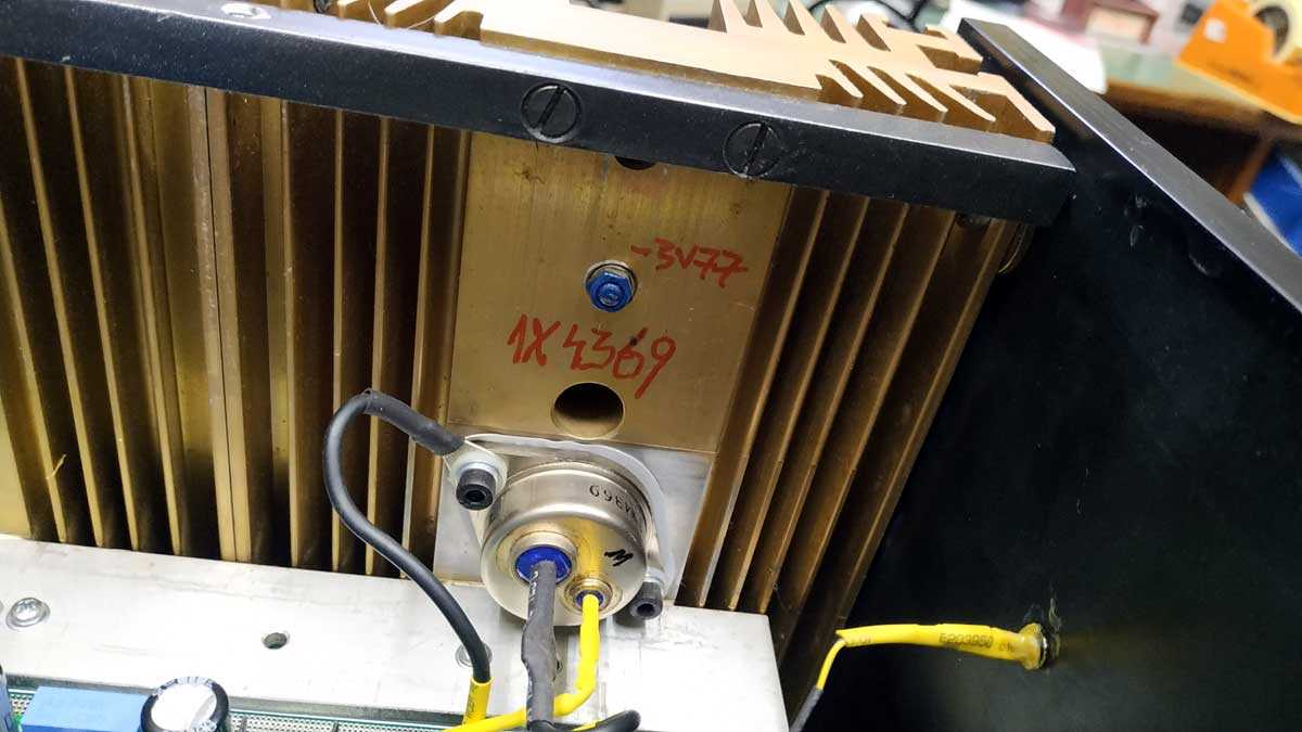

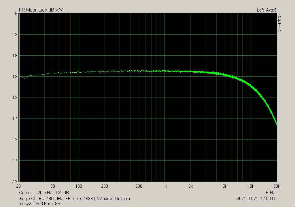

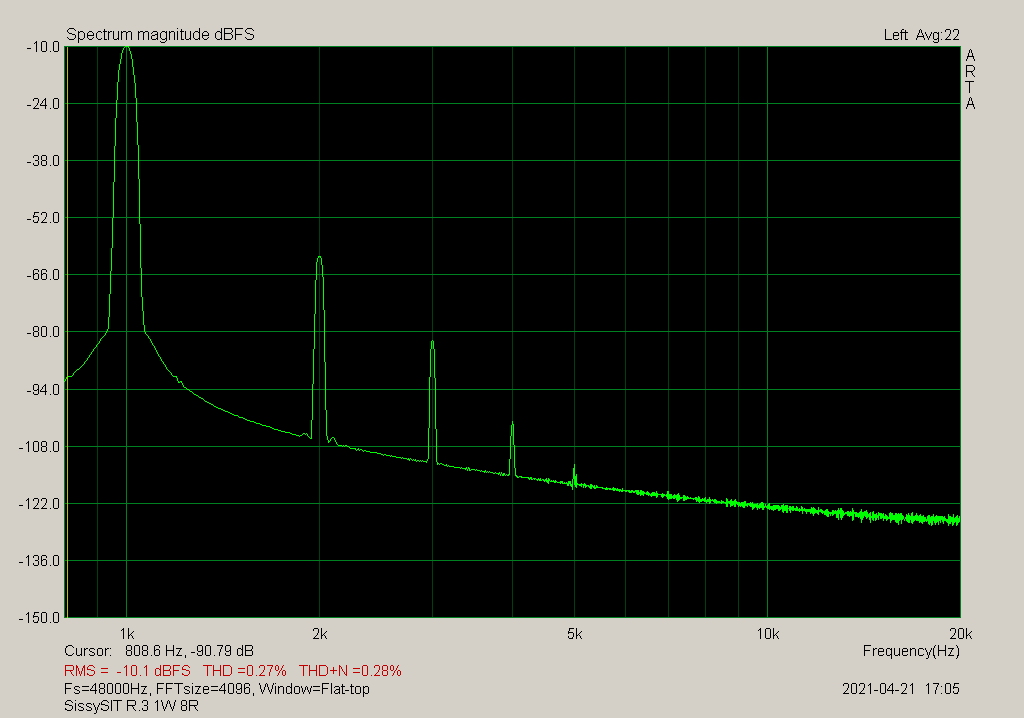

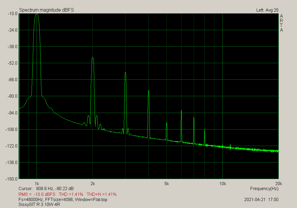

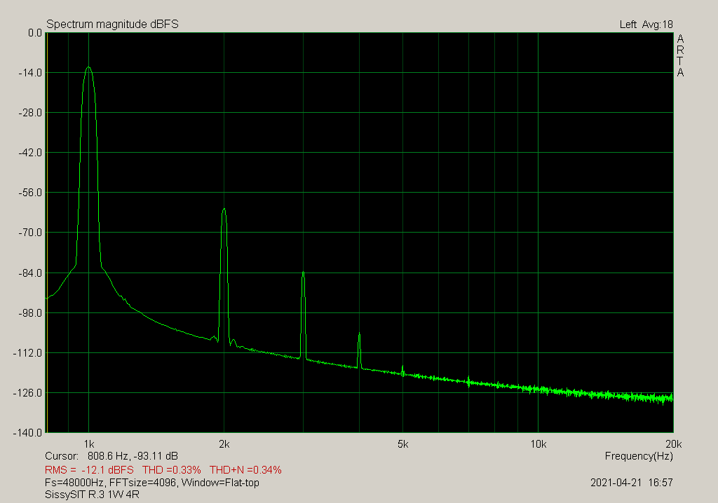

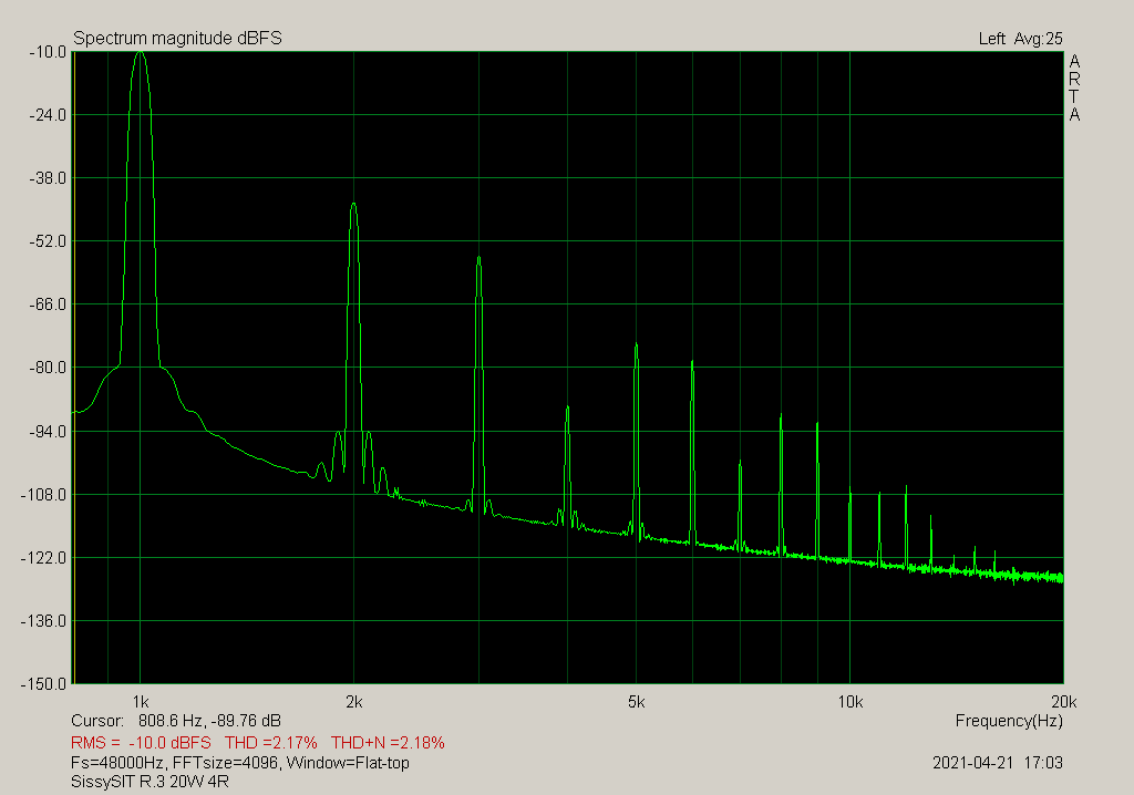

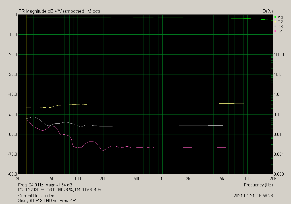

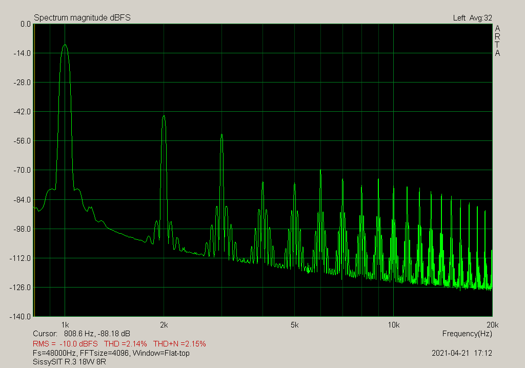

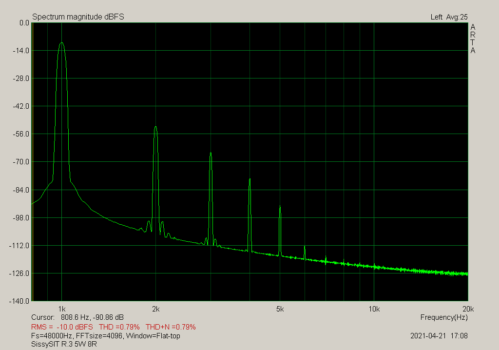

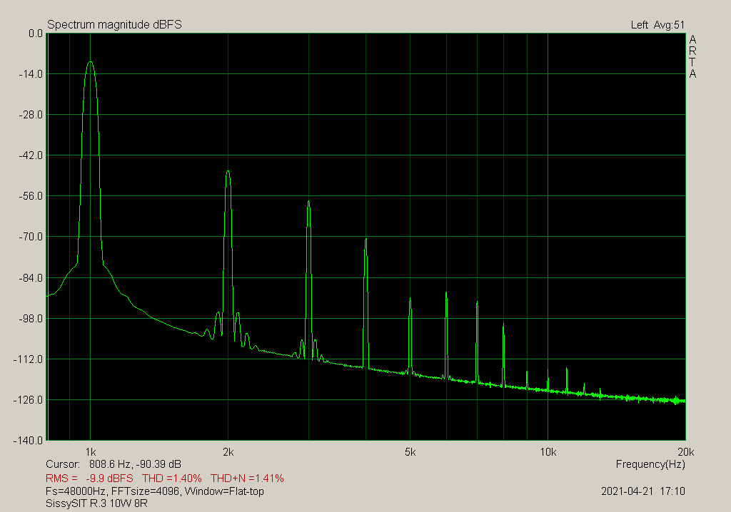

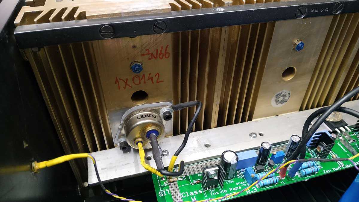

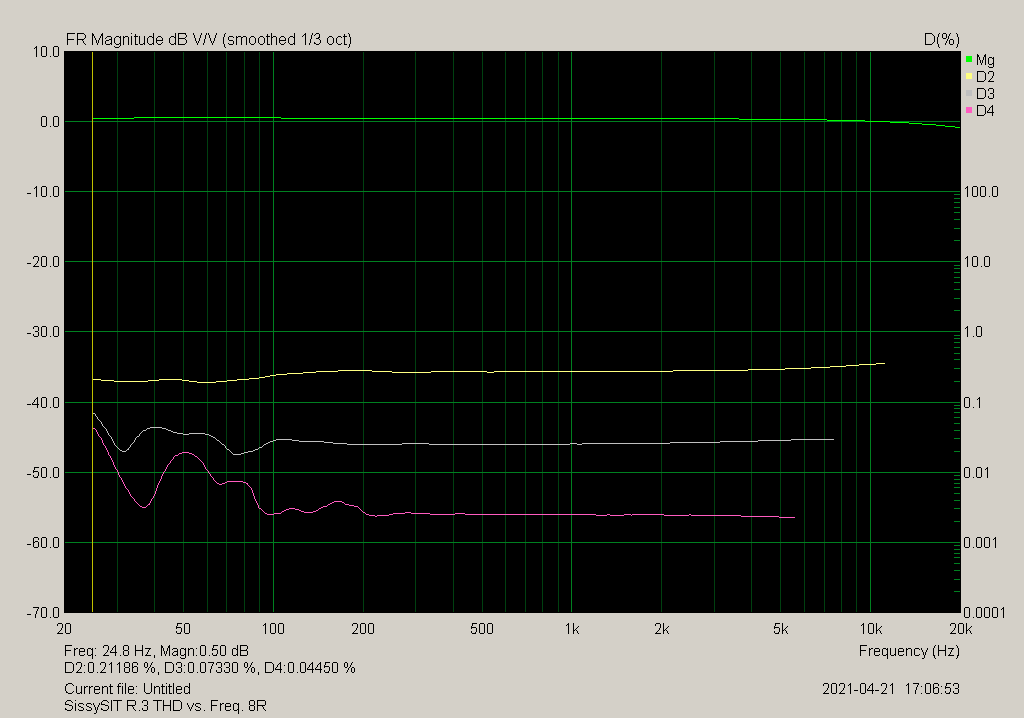

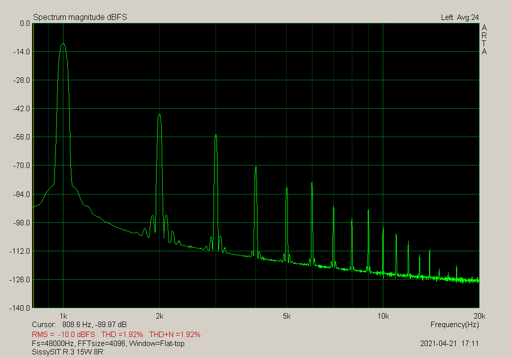

Zen Mod Napisano April 21, 2021 Autor #12 Napisano April 21, 2021 .matching of SITs - hard facts as shown on two last pics in previous post - see specific part No. and Ugs of each - one is -3V66, second is -3V77 ( already established method - 24V@1A8) so , they are so-so close by Ugs, and not matched in any way by curves ( don't have that thingie and certainly not going to have one) find enclosed all measurements for both channels in one zip file if you are curious enough to open it, you'll see that THD of both channels is very close ...... maybe it's just sheer luck I'm having ( that parts are close by curves) or DEF OS is really so magic and enigmatic concept..... in any case, I'm bedazzled with DEF concept - I mean in general - use of two dissimilar parts in arrangement usually reserved for max. possible complementary ones SissySIT R.3 measurements.zip

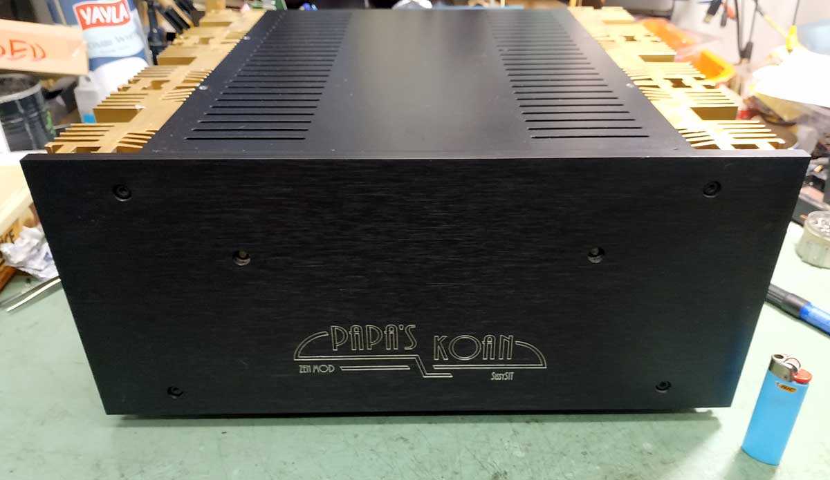

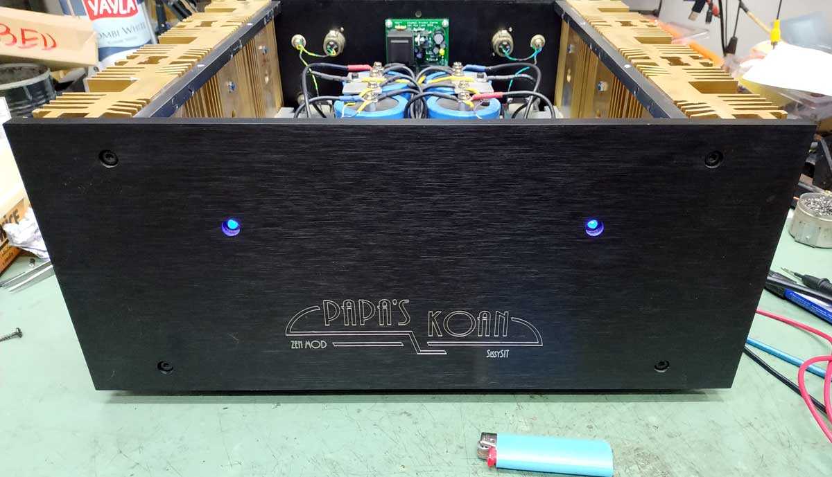

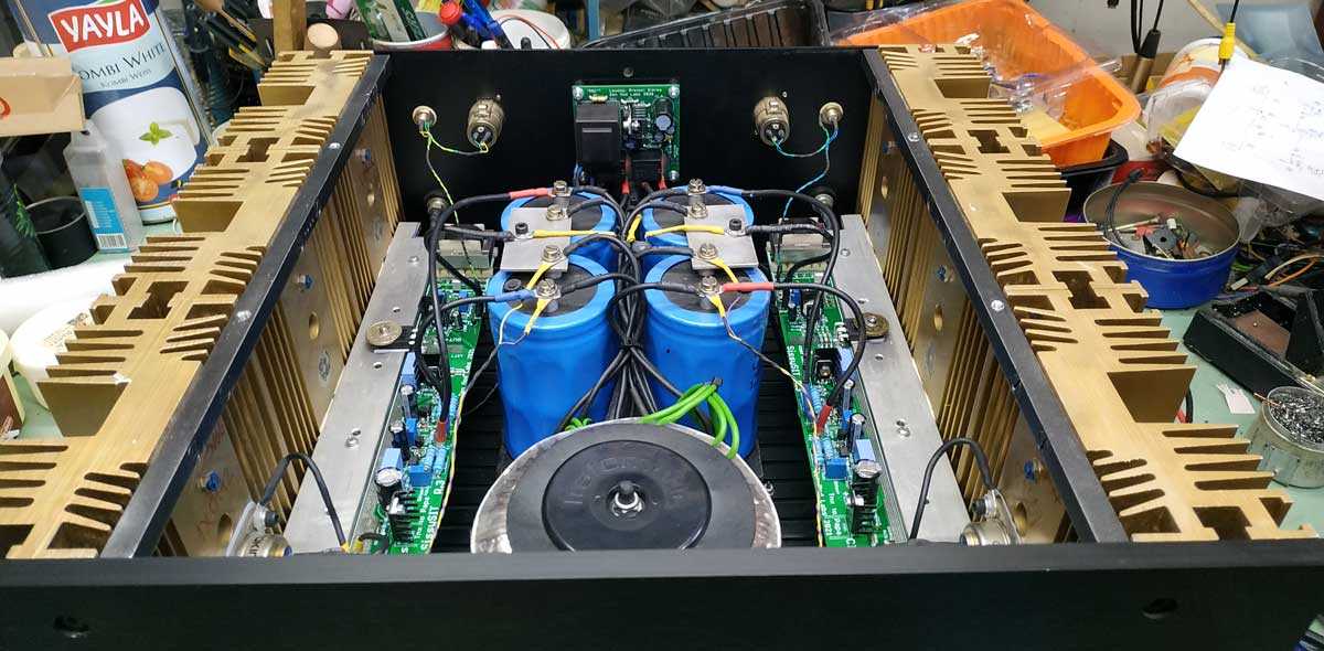

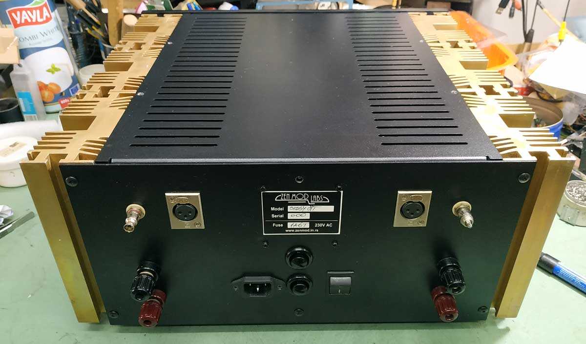

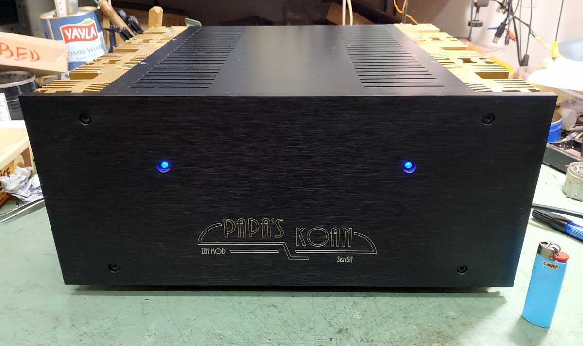

Zen Mod Napisano April 21, 2021 Autor #13 Napisano April 21, 2021 How it sounds.... will it drive F4? Oh, yes - it sounds ... Spooky! will it drive F4 - dunno, didn't tried does it sound different to previous SissySIT iterations (both no-R and R.2) > no - there is no difference , simply because there is no other difference than made in biasing department I was personally curious to establish is it going to be any difference, considering that SIT is now driven by source follower ....... and - nope, nada, zilch ........ SIT gate is enough benign and polite thingie to be driven, while small IRF source follower is enough benign and polite ..... I mean - benign and polite in context of generally so crude THD generator, which SissySIT certainly is in my book, that's good enough Mimic of Papa's DEFiSIT ZM Happy Camper, Omnilucky, avoided Public Disgrace once more

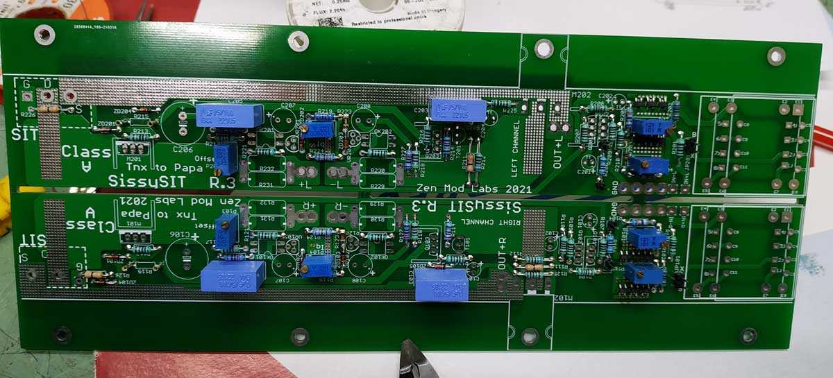

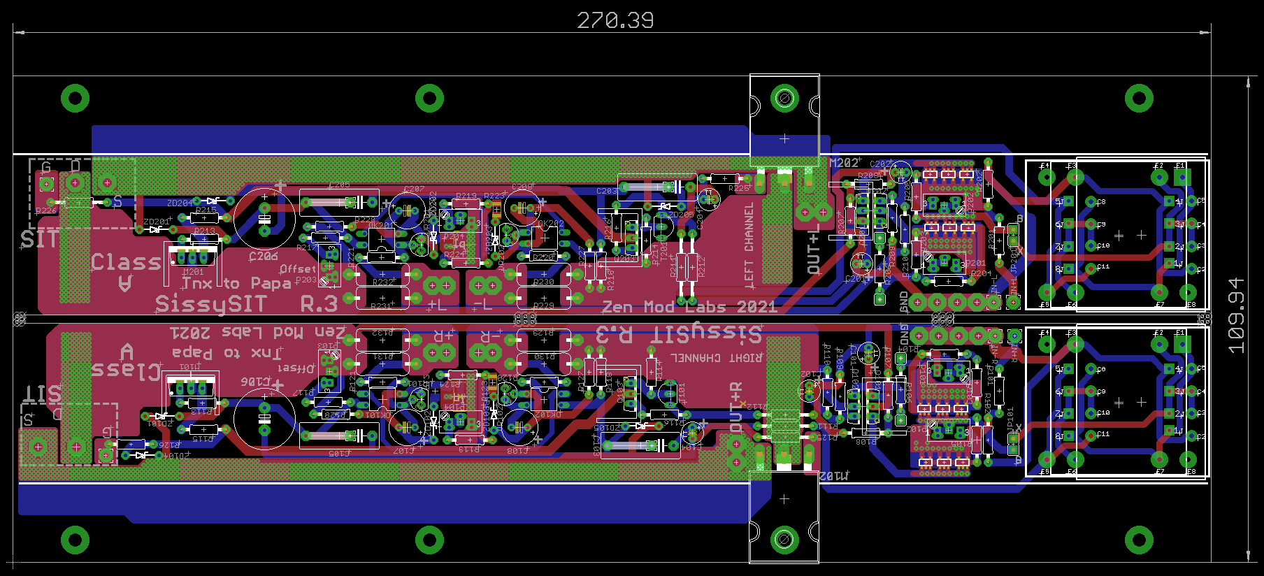

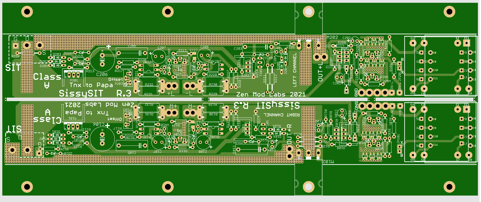

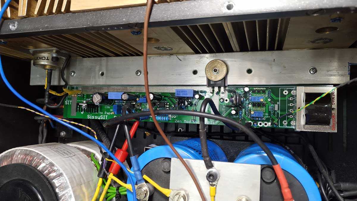

Zen Mod Napisano April 21, 2021 Autor #15 Napisano April 21, 2021 Level shifter resistor fine tune schm, post #1 , resistor name is R115 and there is note beside in later sketches - level shifting resistor, explained goal is to have so so symetricall gate voltages of IRFP down and IRF up ....... (so DC offset behavior in Temp/time/mains voltage variations domains is predictable and minimally changing) let's say that they are 4V nominally logic is that source of IRF is approx at level of amp output let's say that you know which Ugs is of SIT you're using ( even if you don't , easy to make adjustment later) ....... and let's say it is nice round figure of -3V value of R115 needs to be adjusted in a way that we have voltage sag across exactly in value of SIT Ugs and that's easy to compute - programmed current of Q103+T101 CCS is in range of 30mA, so for 3V voltage sag calculus is easy R=3V/30mA= 100R in my case I did use 120R for both channels in case that you're using unknown Ugs SIT - all you need after ballpark setting of Iq and DC Offset is to measure Ugs of M101 and M102, and fix** R115 to get them approx. same in absolute number easypeasy **it's cunning to solder there 1pin holders first then push preliminary/temporary resistor in; when final resistor is determined, just solder it in 1pin holders, for better sleep would pack these 1pinners in kits, ZM Genius vladd and mutayu je reagovao/la na ovo 2
