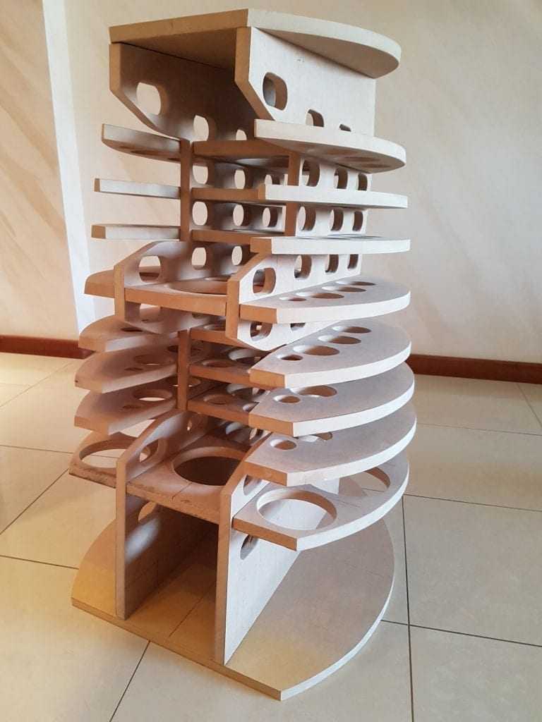

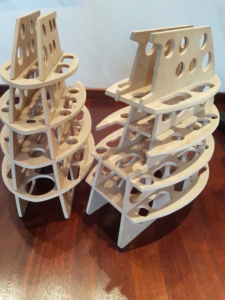

jororaitchev Napisano Februar 2, 2017 Autor #23 Napisano Februar 2, 2017 On 31.01.2017 г. at 1:37 AM, jororaitchev said: Нищо криминално. Благодаря Ви, улеснихте задачата ми и ...я обезсмислихте. Не знам, дали има смисъл да пускам другият проект? Добро вече ! Живимо у глобалном свету, нема велика изненађења у информације. These columns have their new owner and I work on a new project. To move the evening! I decided to move my evening as you presented my new project: 2a3, Aleks, ab and 4 ostalih je reagovao/la na ovo 7

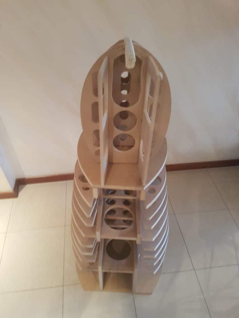

Dacho Napisano Februar 3, 2017 #25 Napisano Februar 3, 2017 Great matrix construction!! Do you have your own CNC machine or you work with manual tools?

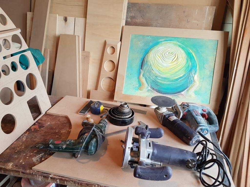

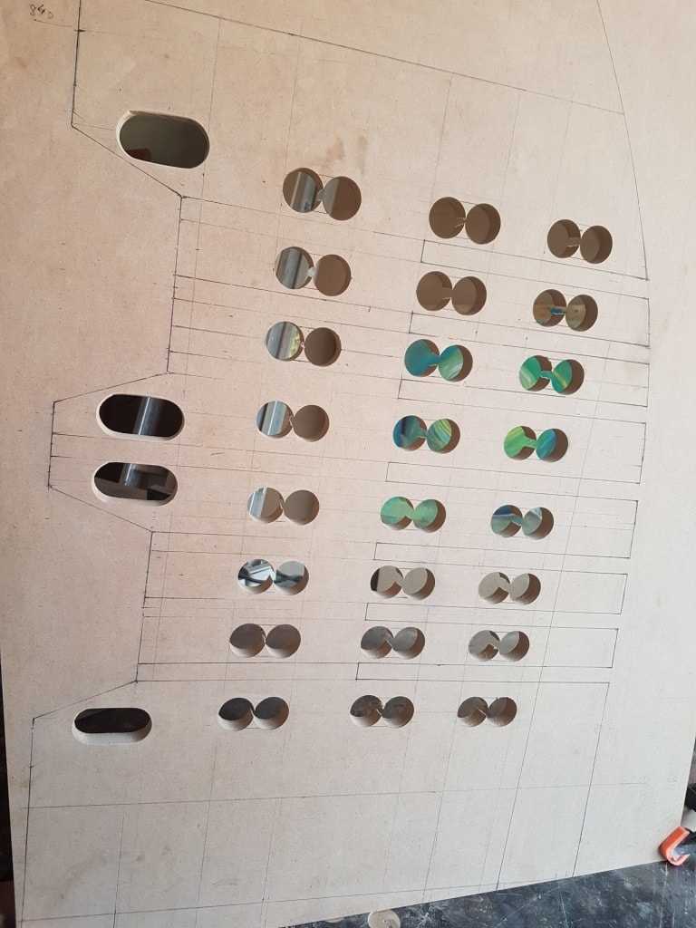

jororaitchev Napisano Februar 3, 2017 Autor #26 Napisano Februar 3, 2017 1 hour ago, Dacho said: Great matrix construction!! Do you have your own CNC machine or you work with manual tools?
jororaitchev Napisano Februar 3, 2017 Autor #27 Napisano Februar 3, 2017 1 minute ago, jororaitchev said: ^I've never used CNC machine, everything is made by my hands.Regards,Joro
kan042 Napisano Februar 3, 2017 #28 Napisano Februar 3, 2017 Unbelievably! Bravo Which tools you use?
Vix Napisano Februar 3, 2017 #29 Napisano Februar 3, 2017 Hi Zhoro. Very nice. For some time I have also followed bulgarian diyaudio scene, but over time lost contact since I haven't been to Bulgaria since 2006 (I lived in Blagoevgrad for 5 years-student days). If I ever come again (if my wife allows-guess why I will come to listen to these speakers! Vsichko dobro and just continue posting speaker pics!

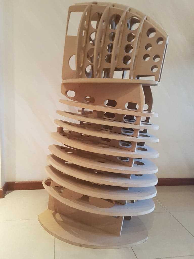

jororaitchev Napisano Februar 3, 2017 Autor #30 Napisano Februar 3, 2017 38 minutes ago, jororaitchev said: Pay attention to the most important tool-panel behind /my job - I must finish her - never ever!/. Zflazar and hifish je reagovao/la na ovo 2
jororaitchev Napisano Februar 3, 2017 Autor #31 Napisano Februar 3, 2017 17 minutes ago, Vix said: Hi Zhoro. Very nice. For some time I have also followed bulgarian diyaudio scene, but over time lost contact since I haven't been to Bulgaria since 2006 (I lived in Blagoevgrad for 5 years-student days). If I ever come again (if my wife allows-guess why I will come to listen to these speakers! Vsichko dobro and just continue posting speaker pics! Sorry, they already have a new lucky owner! It may then be ready new project. Greetings!
Vix Napisano Februar 3, 2017 #32 Napisano Februar 3, 2017 Pay attention to the most important tool-panel behind /my job - I must finish her - never ever!/. This reminds me on Cornu Spiral Horn speaker Sent from my HTC One A9 using Tapatalk
jororaitchev Napisano Februar 3, 2017 Autor #33 Napisano Februar 3, 2017 2 minutes ago, Vix said: This reminds me on Cornu Spiral Horn speaker Sent from my HTC One A9 using Tapatalk Thus you see things.

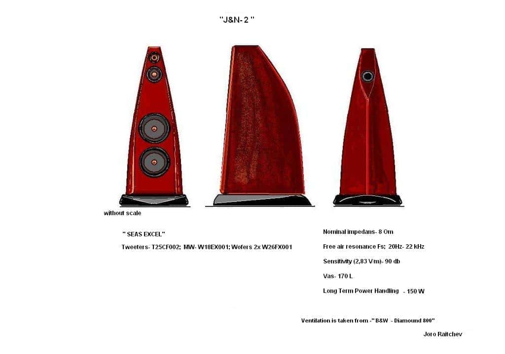

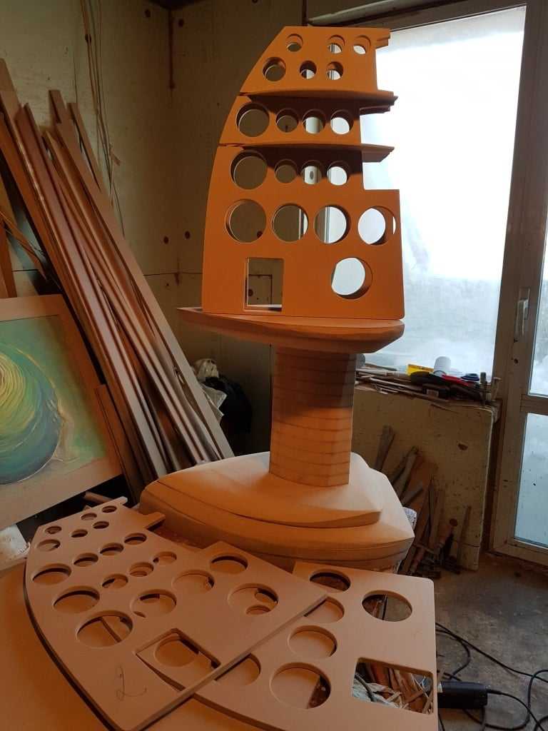

sir Oliver Napisano Februar 3, 2017 #34 Napisano Februar 3, 2017 Is this your design ( drivers, crossover, cabinet ) or some other guy?
jororaitchev Napisano Februar 3, 2017 Autor #35 Napisano Februar 3, 2017 34 minutes ago, sir Oliver said: Is this your design ( drivers, crossover, cabinet ) or some other guy? No one but me / for the first project ,for the construction of crossover i used the services of "pas_bg" /.

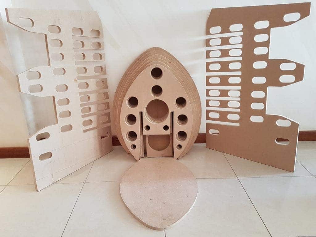

Dacho Napisano Februar 4, 2017 #36 Napisano Februar 4, 2017 More picture and details please...we are waiting!!

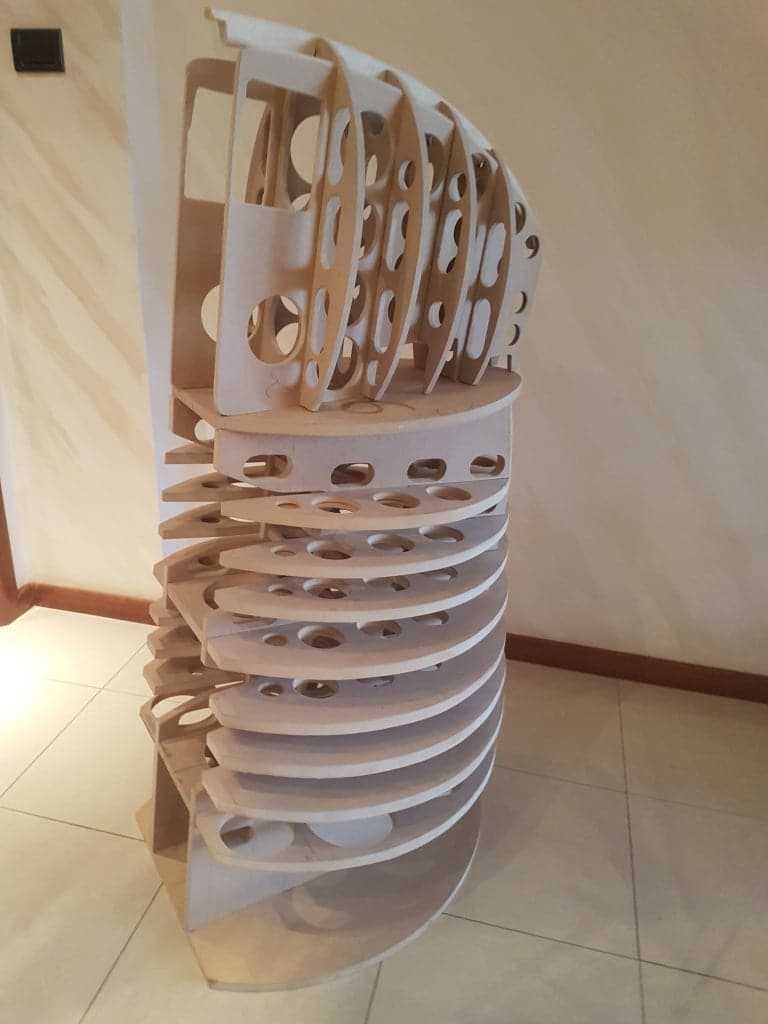

jororaitchev Napisano Februar 10, 2017 Autor #37 Napisano Februar 10, 2017 On 4.02.2017 г. at 0:10 PM, Dacho said: More picture and details please...we are waiting!! 2a3, hifish and Dacho je reagovao/la na ovo 3
jororaitchev Napisano Februar 27, 2017 Autor #38 Napisano Februar 27, 2017 On 10.02.2017 г. at 4:17 PM, jororaitchev said: A nod to "B & W" Beli_Ninja, Dacho, hifish and 1 član je reagovao/la na ovo 4
vladd Napisano Februar 27, 2017 #39 Napisano Februar 27, 2017 Sjajno! Jadni zvucni talas i ne zna sta ga je snaslo.

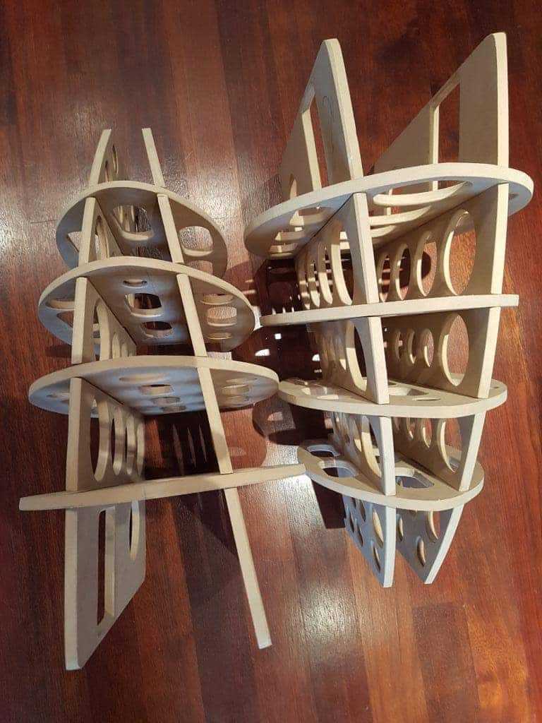

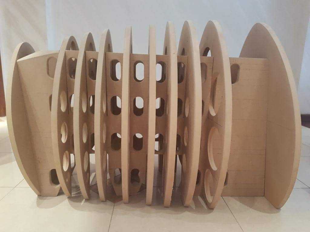

ZZZ Napisano Februar 27, 2017 #40 Napisano Februar 27, 2017 Excellent work !!! I just want to point one thing if You don't mind. Air in the chamber have a mass. And center of that mass and-or volume. With this kind of bracing, that global mass-volume divided into many smaller volumes and masses. Also the center of global mass shift from one to many points, apart from each other. This is resulting for driver to saw much smaller volume that it actually present, if You subs-tract volume of bracing from the global volume. Much smaller... We have had this topic in the forum if I am remembering well, before some time. And a guy, remove inside bracing, reporting with the huge step forward in the sound outcome. In the lower end and ballance generally. The common builder reflex is just to add volume of bracing inside to accomplish same volume from the starting point, but it is not just like this... On the other hand, walls are really isolated. Try to measure the cab, and compare to the simulated result in the low region. If it is differs, it would be from that effect i was explain. And it will act like smaller volume in the simulations. cheers
jororaitchev Napisano Februar 27, 2017 Autor #41 Napisano Februar 27, 2017 21 minutes ago, ZZZ said: Excellent work !!! I just want to point one thing if You don't mind. Air in the chamber have a mass. And center of that mass and-or volume. With this kind of bracing, that global mass-volume divided into many smaller volumes and masses. Also the center of global mass shift from one to many points, apart from each other. This is resulting for driver to saw much smaller volume that it actually present, if You subs-tract volume of bracing from the global volume. Much smaller... We have had this topic in the forum if I am remembering well, before some time. And a guy, remove inside bracing, reporting with the huge step forward in the sound outcome. In the lower end and ballance generally. The common builder reflex is just to add volume of bracing inside to accomplish same volume from the starting point, but it is not just like this... On the other hand, walls are really isolated. Try to measure the cab, and compare to the simulated result in the low region. If it is differs, it would be from that effect i was explain. And it will act like smaller volume in the simulations. cheers Ventilation has two missions - to make sure that the cabinet to keep "quiet" and helps in the construction of the boxes.

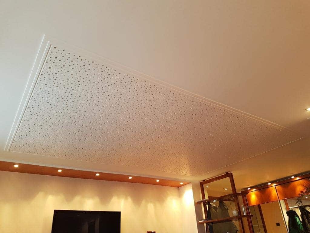

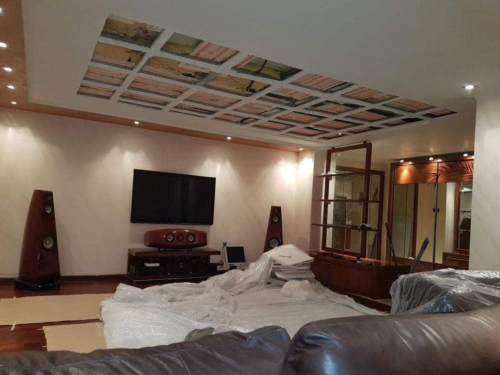

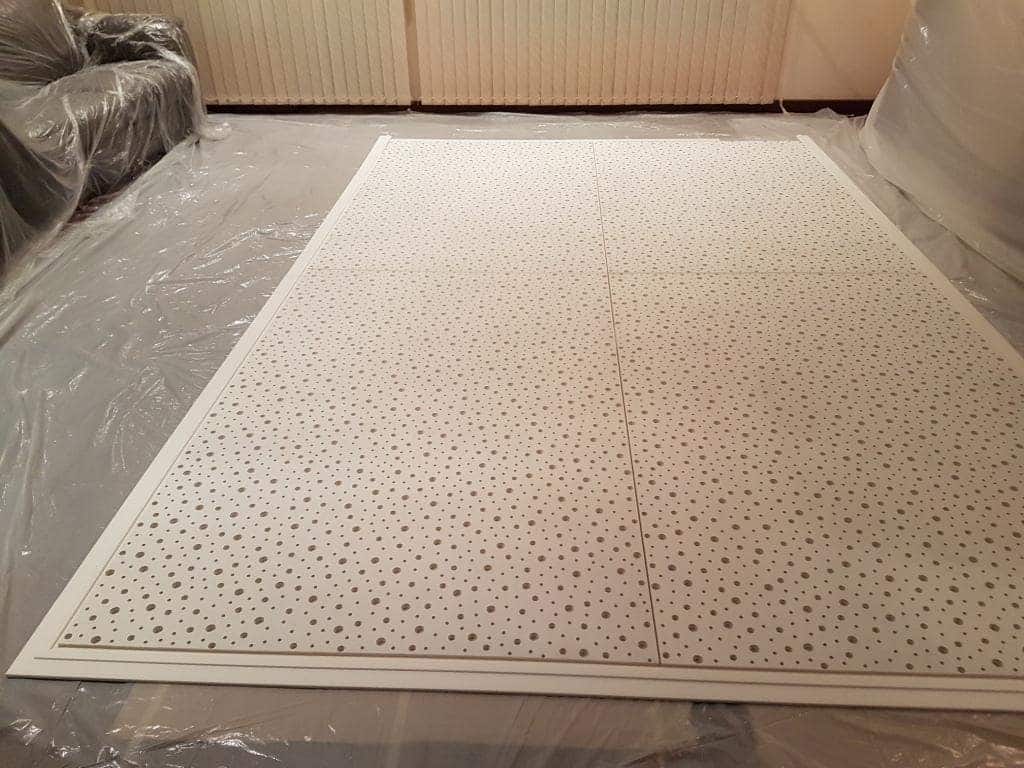

jororaitchev Napisano Mart 12, 2017 Autor #42 Napisano Mart 12, 2017 Do not forget acoustics .... hifish and Aleks je reagovao/la na ovo 2
jororaitchev Napisano Mart 12, 2017 Autor #44 Napisano Mart 12, 2017 4 minutes ago, Alex said: Instead of TV set: There is no way, there will be bass traps.
