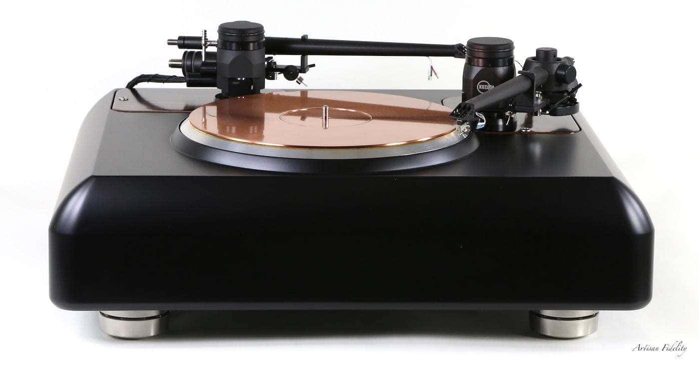

mrcelavi Napisano Jun 20, 2019 #2046 Napisano Jun 20, 2019 Artisan Fidelity's Technics SP10 Mk3 NGS Kuzma 4Point
