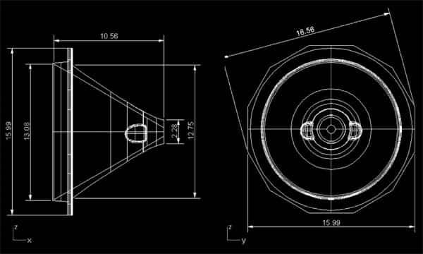

Wayne (http://www.pispeakers.com/contents.html) does use the B&C DE250. Same as Geddes (http://www.gedlee.com/). I have three on QSC waveguides now and I like it. The advantage of a 1" throat is that it doesn't beam until about 15khz. A 1.4-1.5" throat beams at about 11-12khz. A 2" throat beams around 7khz like he said. Not only that, most 2" throat CDs don't even play much above 12khz. The TADs being the exception but they are very expensive.
The disadvantage of the 1" CDs is that they usually don't like being played lower than about 1000hz and many can't even play that low cleanly. The 1.4-1.5" drivers usually work well down to the 500-600hz range.
There is a tradeoff to be made and some people would rather cross over lower and beam a little up top. Others would rather get good directivity up higher and cross over higher. There is no right answer, it is just a tradeoff

Zapravo, može da kupi neke dobre ali to ni u kom slučaju ne znači da će ti kompresioni drajveri "sarađivati" sa tom hornom. Može da se desi da kupi i jeftinije ali čiji se izlazni ugao kompresionog drajvera poklapa sa tim koji je koristio bata sa tog sajta pa da svira mnogo bolje od gomile drugih/skupljih.B&C DE250 (koji košta 130 evra po komadu) u waveguide-u koji imam radi sa dipom od 6dB na oko 10KHz dok se za 30% cene može kupiti Selenium D220Ti koji radi skroz linearno u istom waveguide-u. Tek posle modifikacije adaptera bolt on /screw on može da proradi kako treba...Iznalaženje kompresionog drajvera koji bi radio dobro sa hornom sa linka bi bio "trial and error" proces. Za to čovek treba imati ili dosta poznanika koji imaju kompresione drajvere ili jako mnogo parica na "probanje".Što se tiče prostorije u kojoj bi se ovo čulo kako treba... Pa trebala bi biti ogromna. Nemam ništa protiv nekih ovakvih horni ako nekada budem imao svu mernu opremu, malo više novca i kuću od barem 250kvm pa da izdvojim 50-ak kvm za di00rnik* i slušaonicu. :)*diJAJArnik
