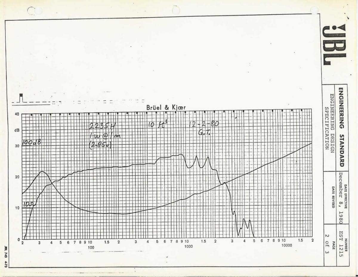

T/S za 2235:
THIELE - SMALL PARAMETERS:   fs: 20 Hz Re: 6.0 ohms Qts: 0.25 Qms: 2.5 Qes: 0.28 Vas: 460 L ( 16.2 ft3) Sd: 0.089 m2 ( 138 in2) Xmax: 8.5 mm (0.33 in) Vd: 757 cm3 (46 in3) Le: 1.2 mH

T/S za 2235:
