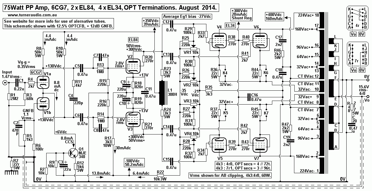

Mikorist Napisano Decembar 16, 2021 Share #69 Napisano Decembar 16, 2021 pre 9 časa, krca44 reče Ima li neko preporuku za 6L6GC PP ? The 80W is a nominal maximum output power very easily and cheaply achieved using a quad of octal tubes such as EL34, 6CA7, 6L6GC, KT66, 807, 5881. 80W-AB1-amp-2014 WWW.TURNERAUDIO.COM.AU Ovo je bre vudu nauka. Mislim na trafoe, choke i bobine Link to comment Podeli na ovim sajtovima More sharing options...
