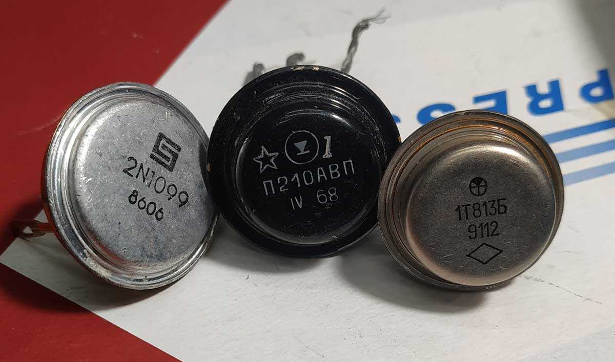

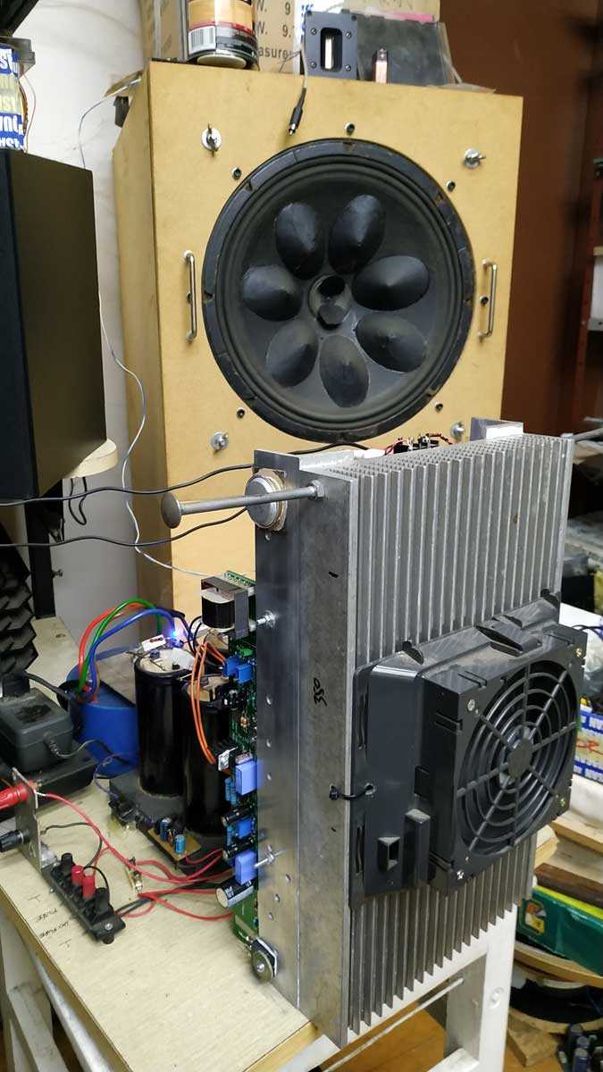

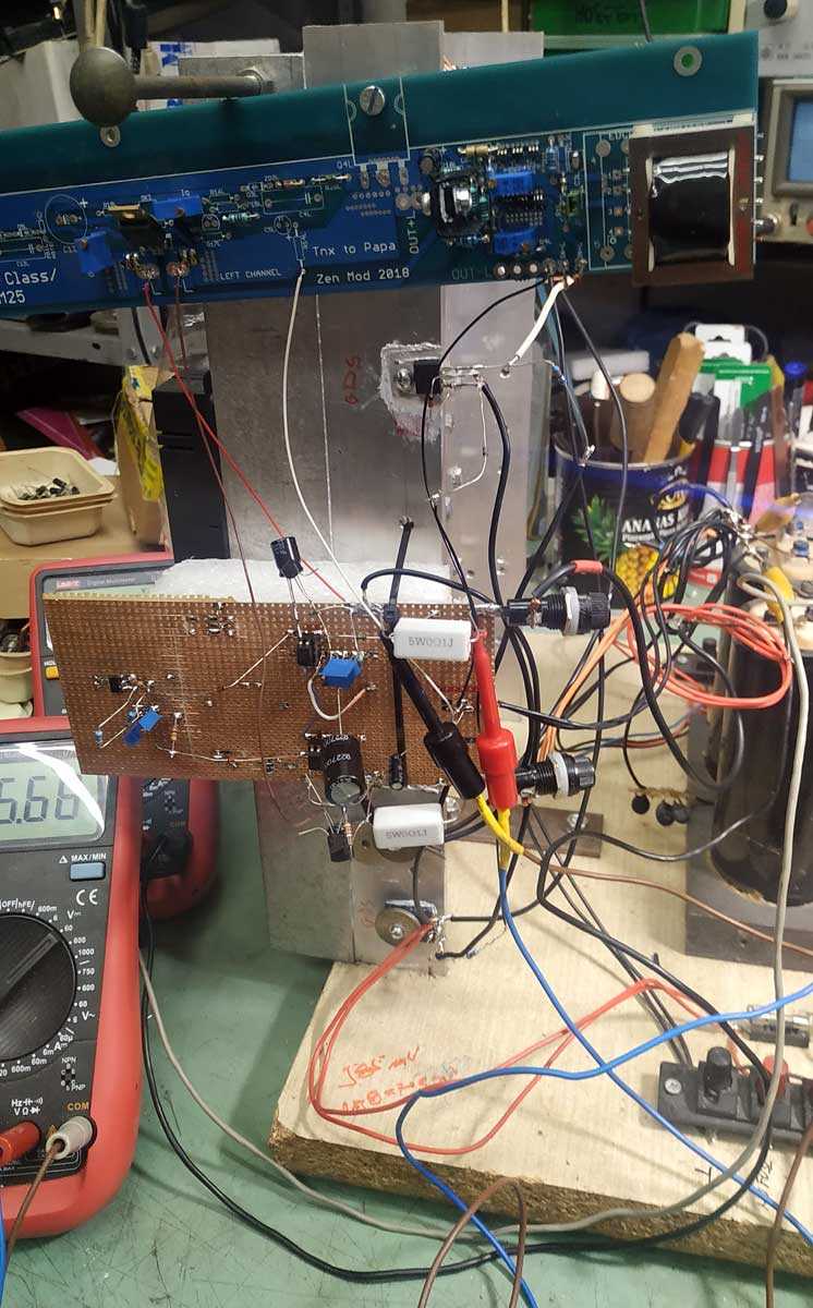

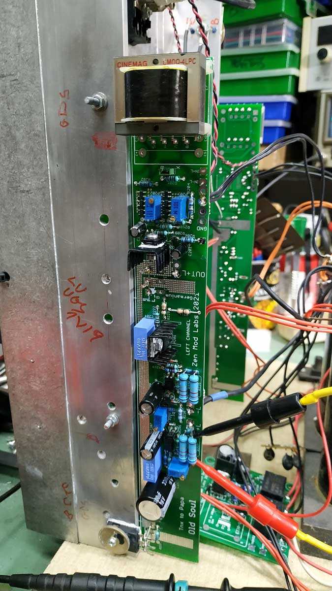

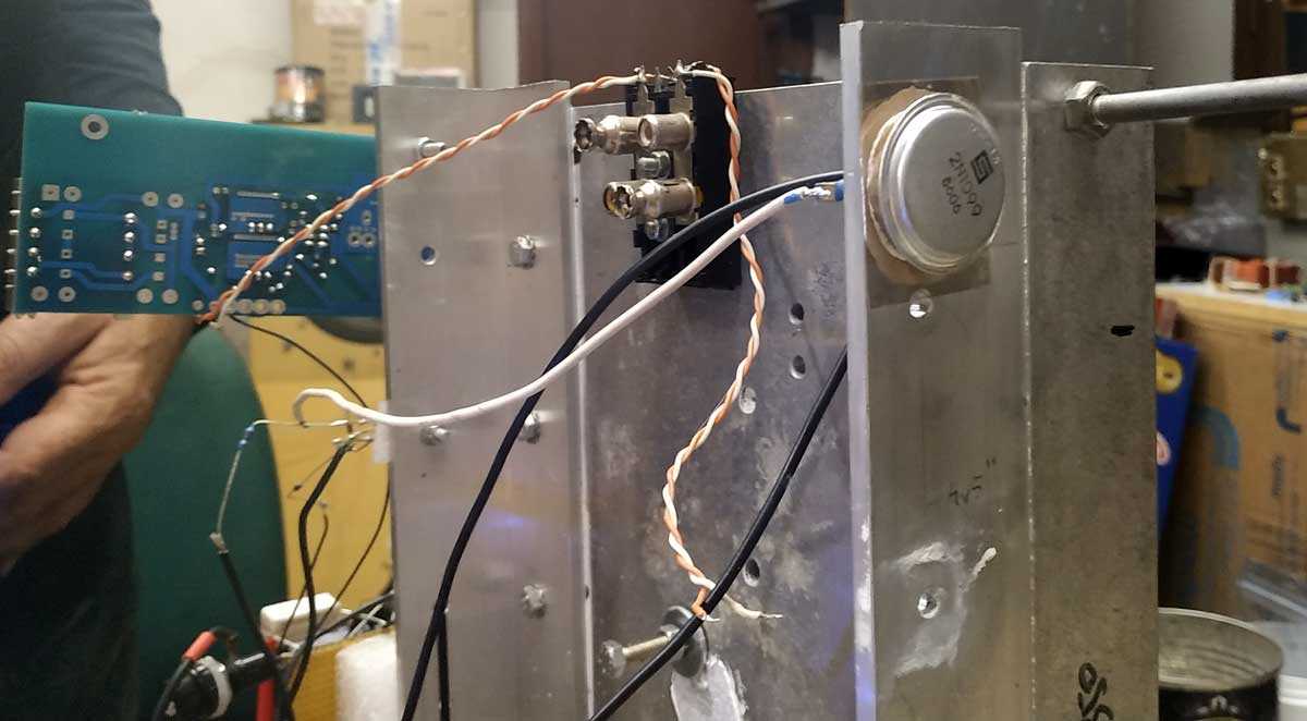

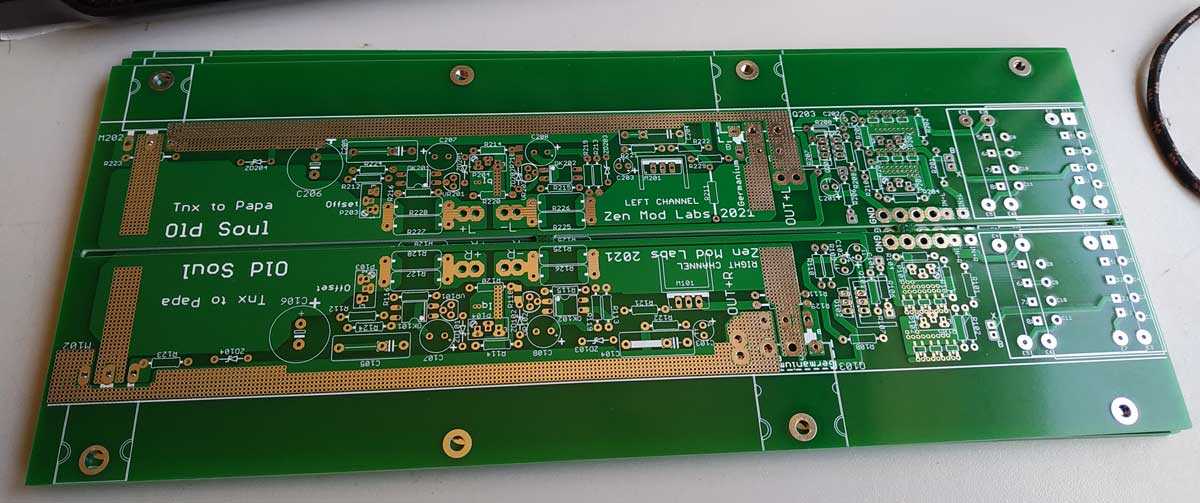

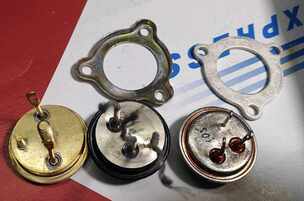

Zen Mod Napisano April 10, 2021 #1 Napisano April 10, 2021 mrzi me da kucam , zato copy-paste sa Big Diya I'm tired, long day So, not too much babbling , for change Objective: make it before Pa, and (normally) make it more complicated than Pa What: amp using Germanium Biguns sp300b je reagovao/la na ovo 1

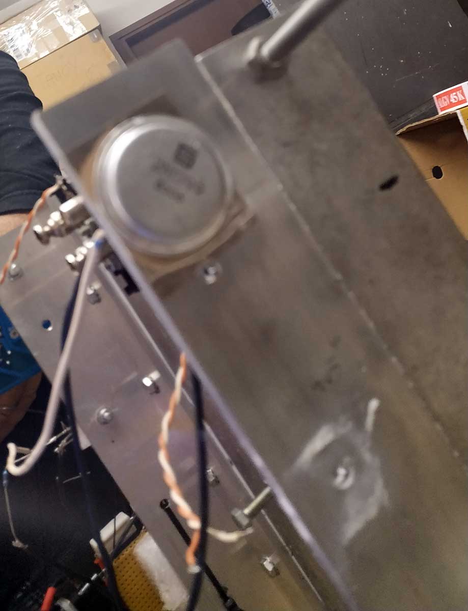

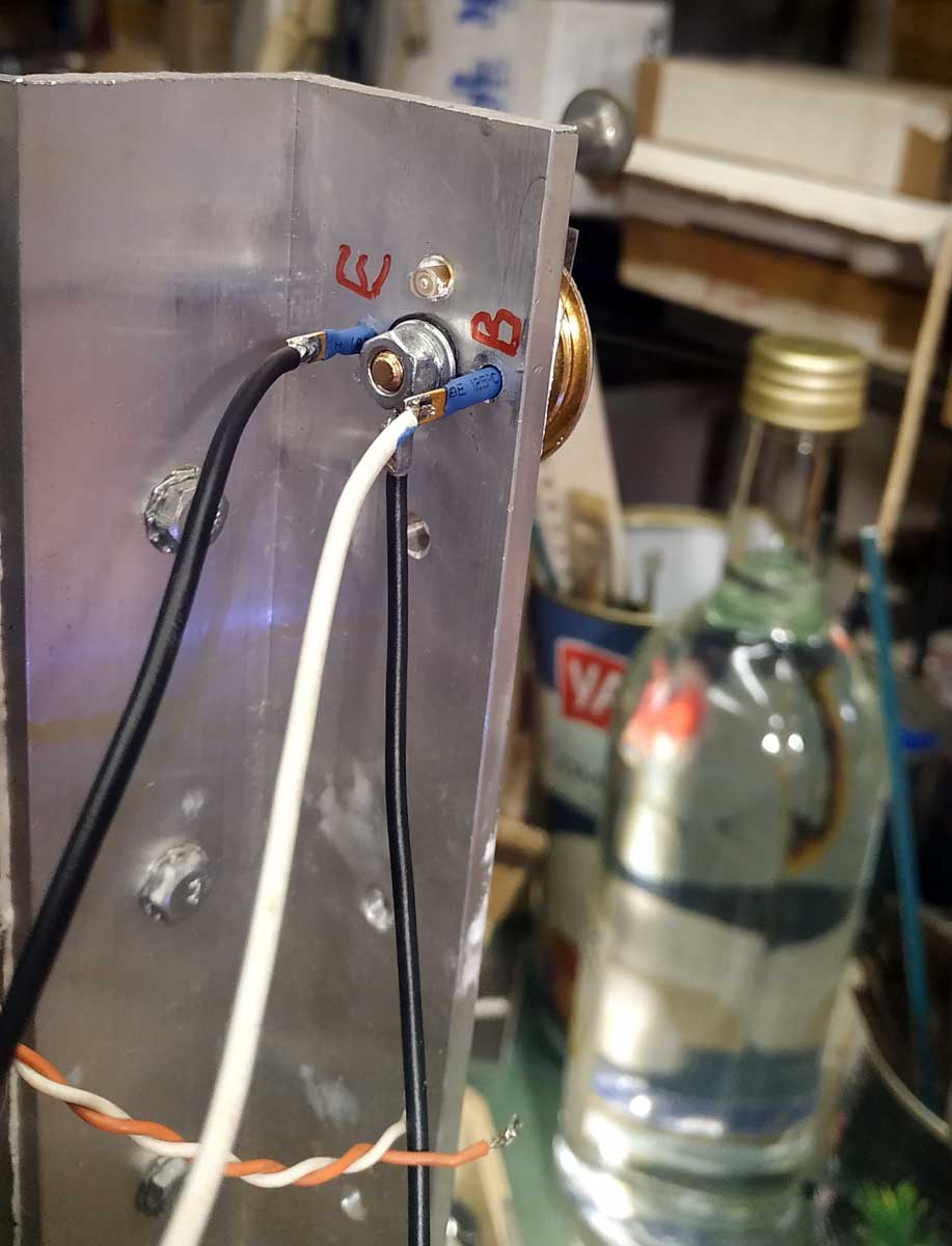

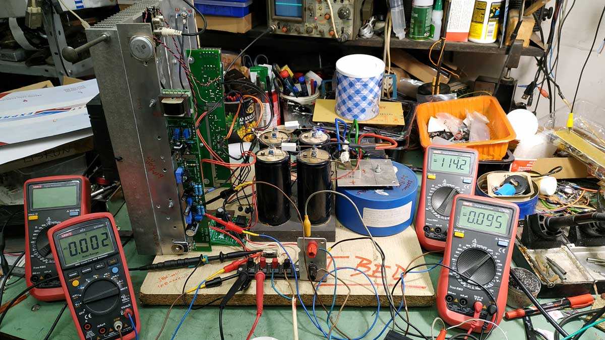

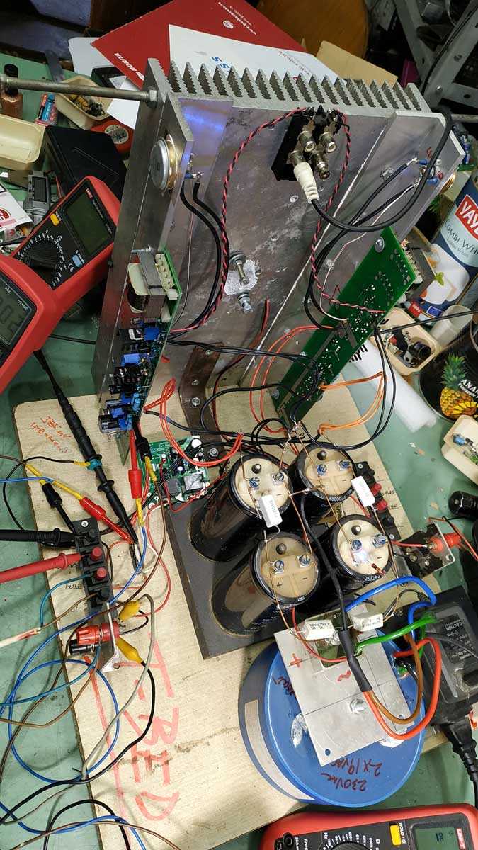

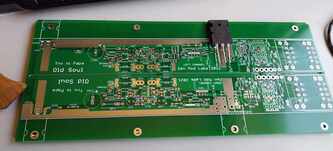

Zen Mod Napisano April 10, 2021 Autor #4 Napisano April 10, 2021 prototyping krca44 and _MM_ je reagovao/la na ovo 1 1

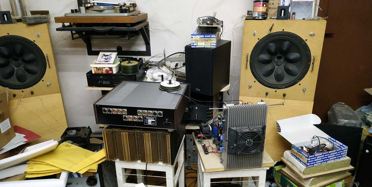

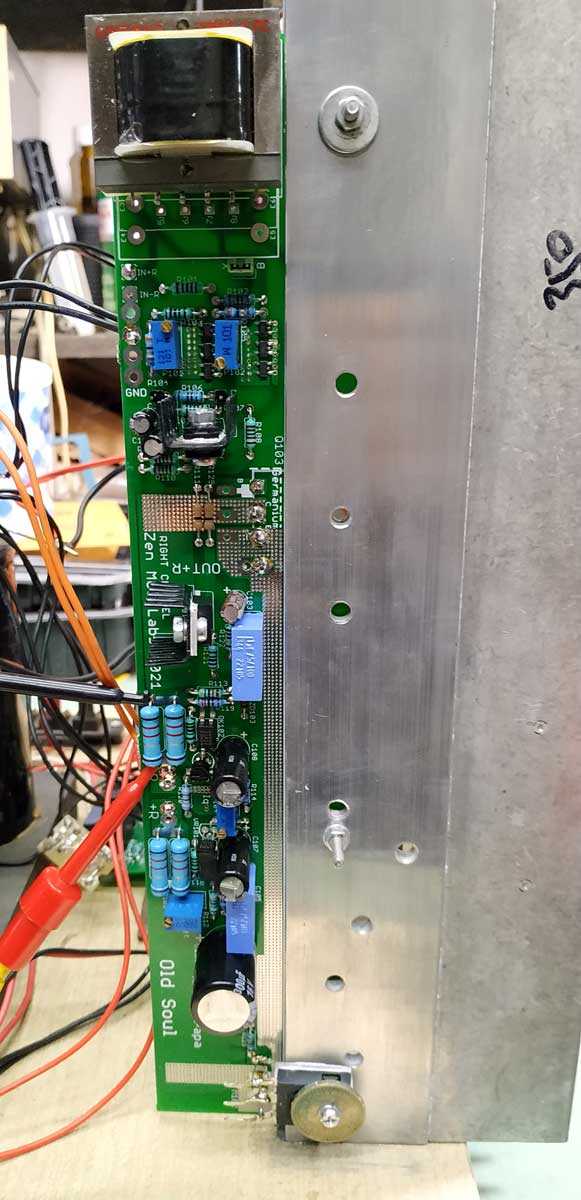

Zen Mod Napisano April 10, 2021 Autor #6 Napisano April 10, 2021 LuDEF out of T-Bed, Old Soul on T-Bed Vix, sp300b, zerowaf and 1 član je reagovao/la na ovo 4

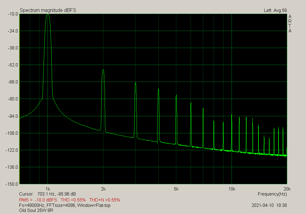

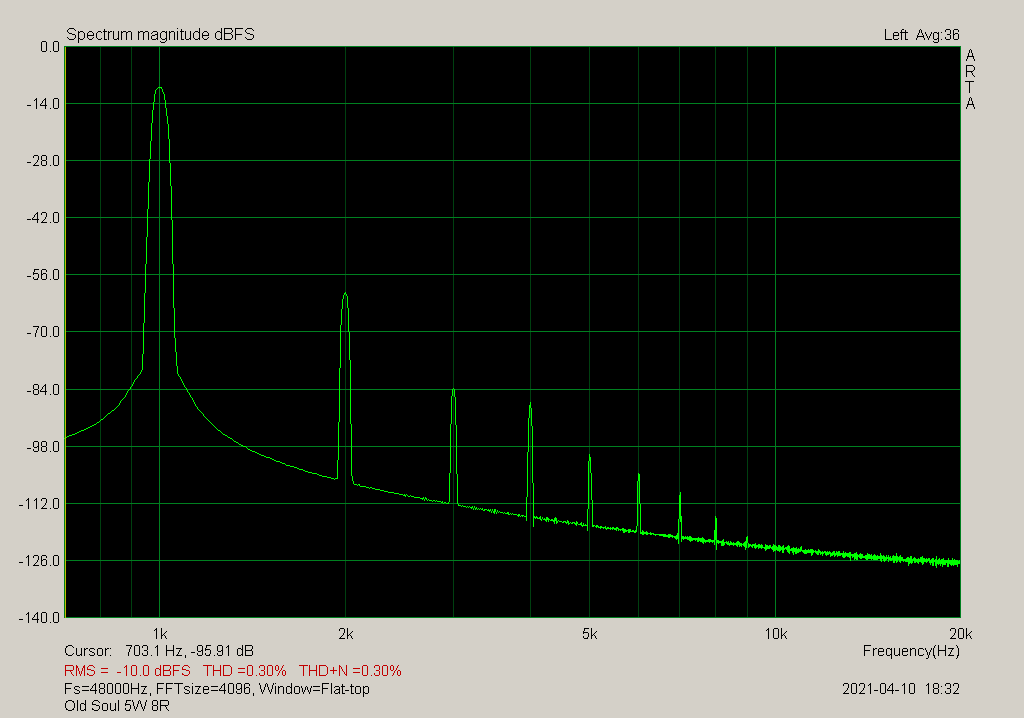

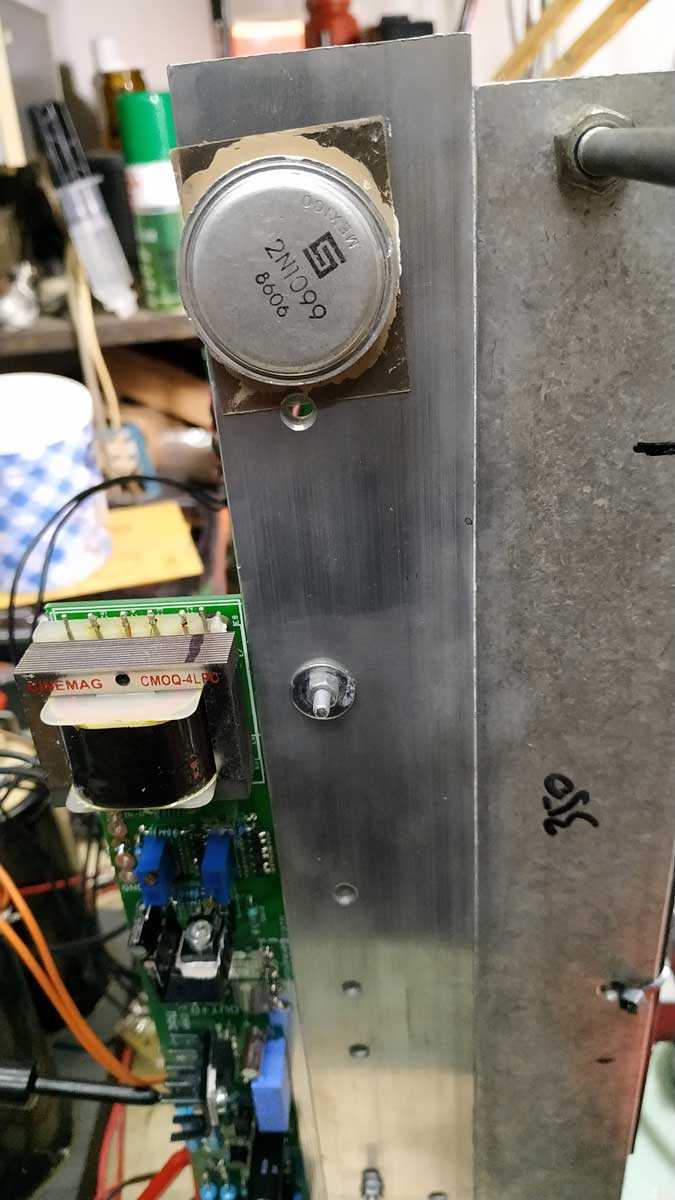

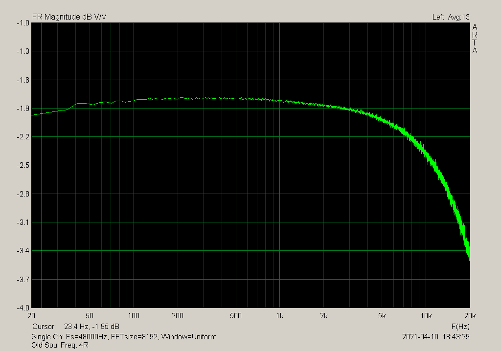

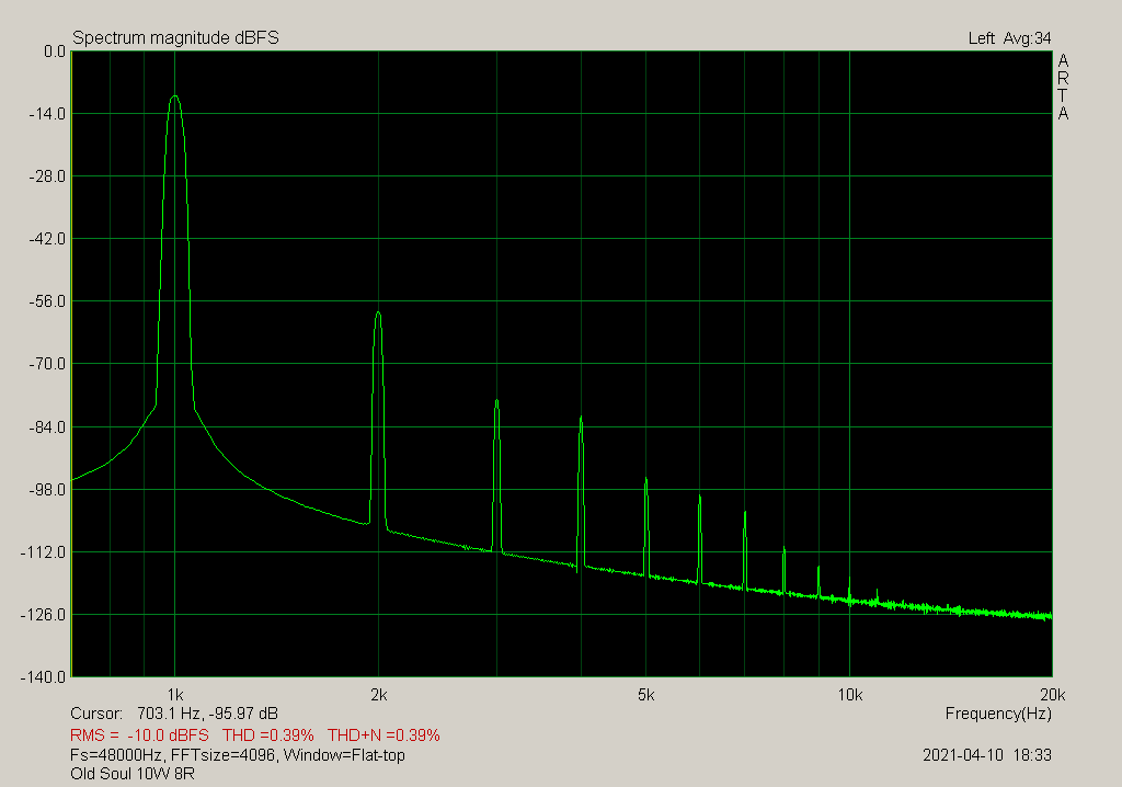

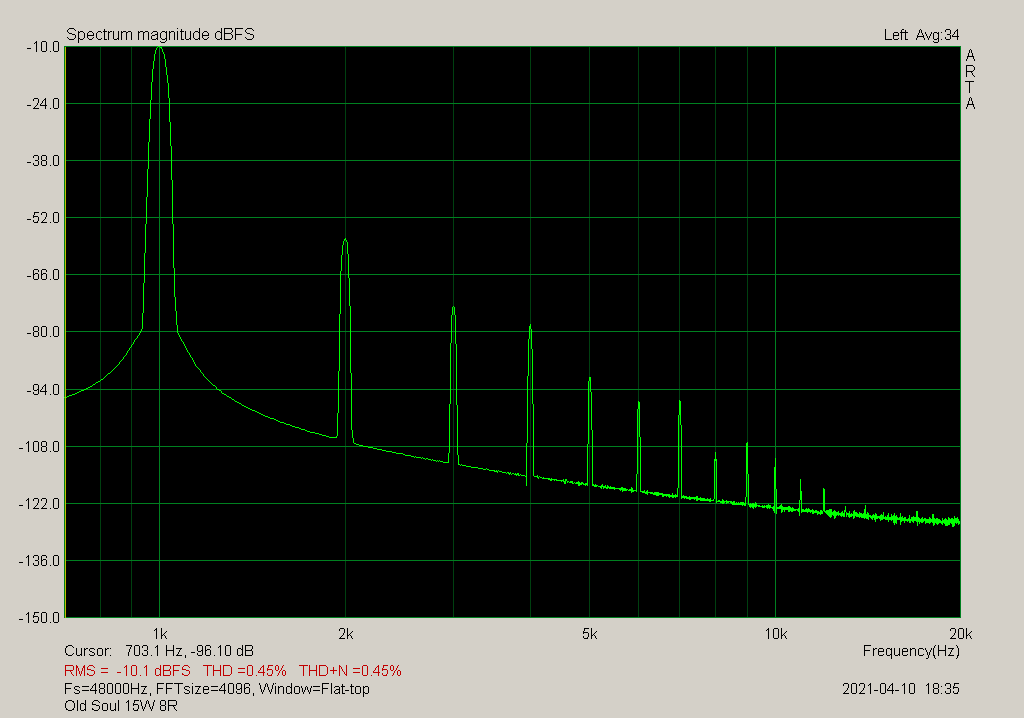

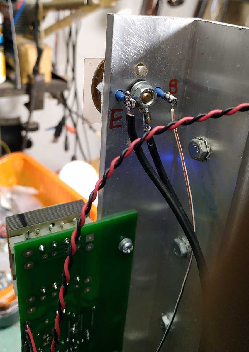

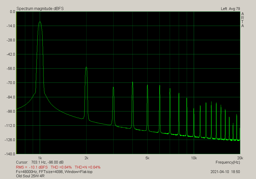

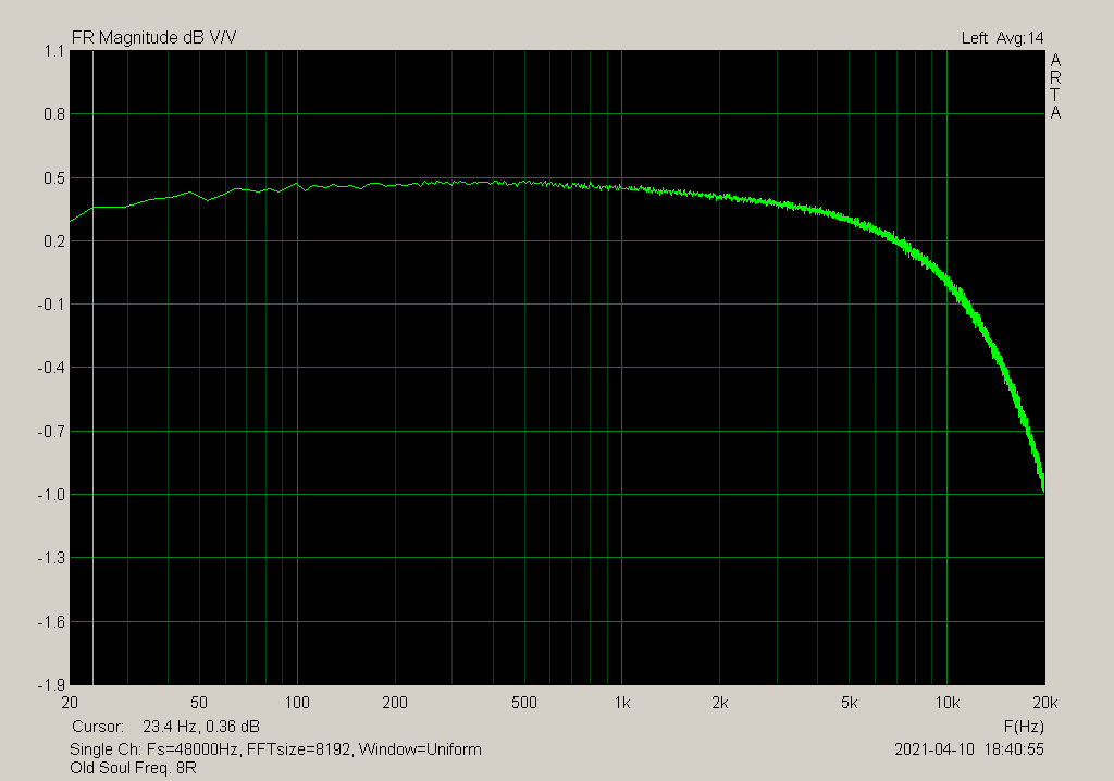

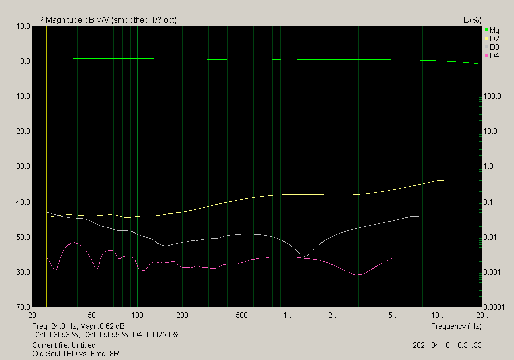

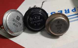

Zen Mod Napisano April 10, 2021 Autor #8 Napisano April 10, 2021 hard data, 8R load rails 24Vdc, Iq 1A (yes, just 1A; ZM Chicken, want to preserve that funny Ge, to have long and prosperous life) a seen on pictures, Ge used 2N1099 _MM_ je reagovao/la na ovo 1

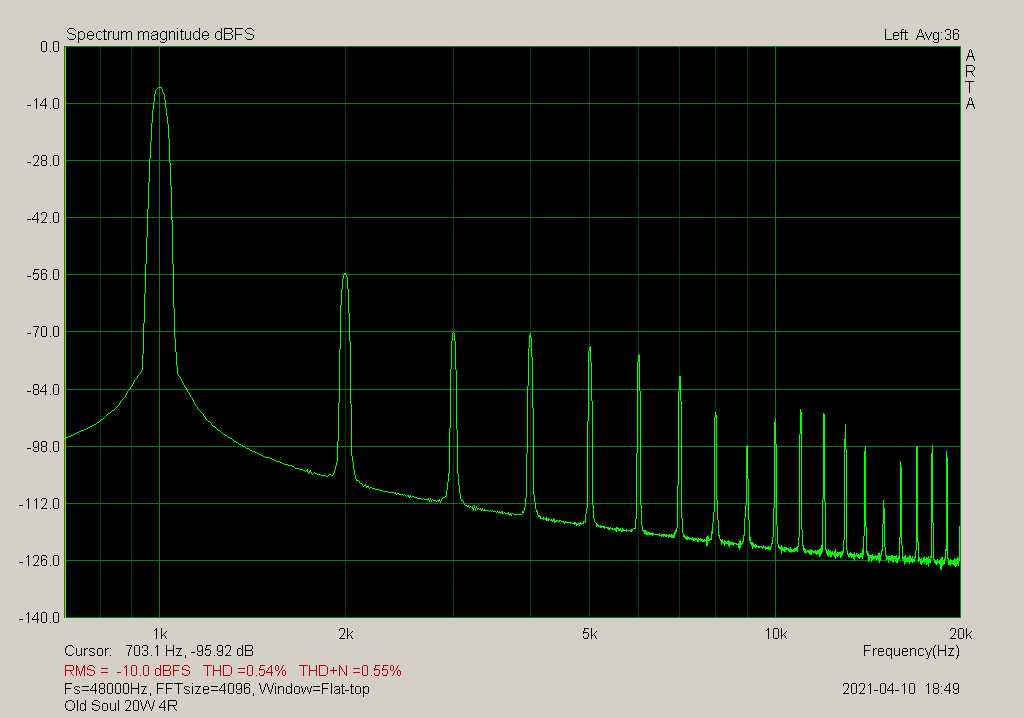

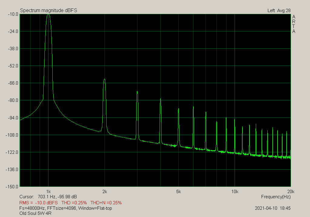

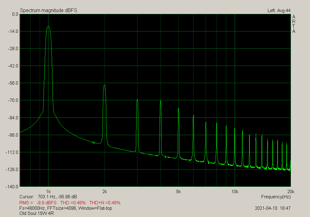

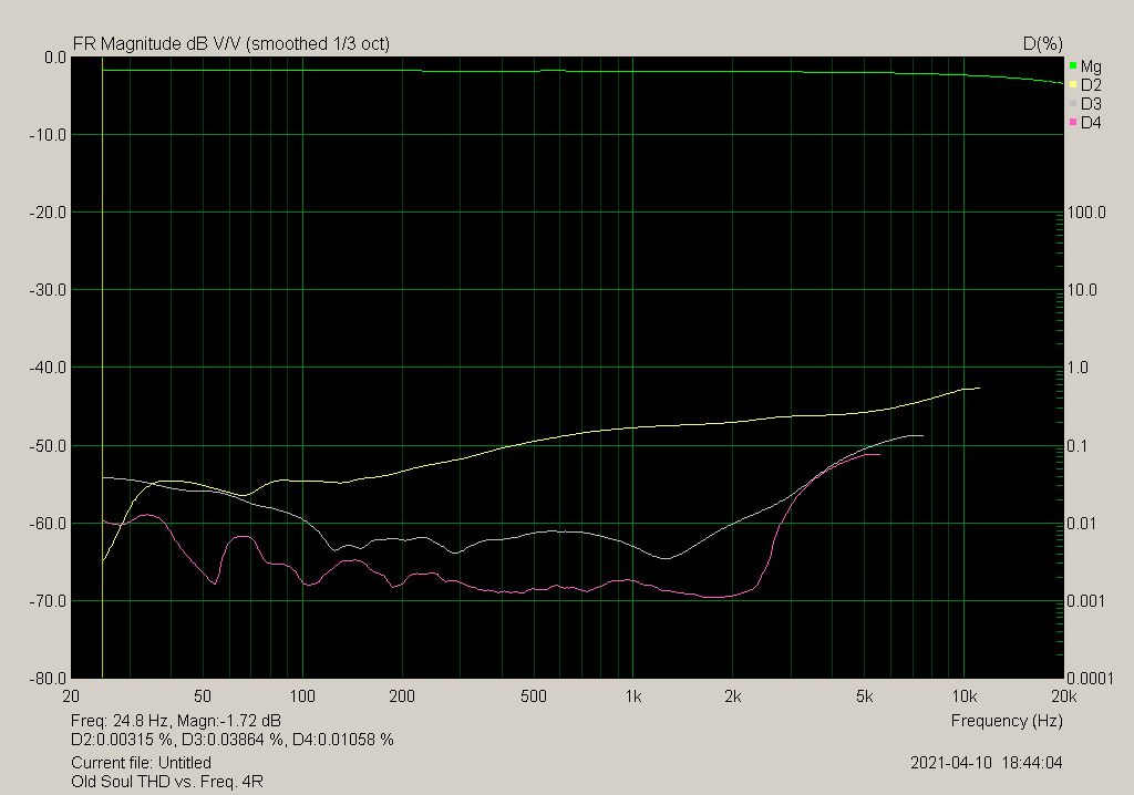

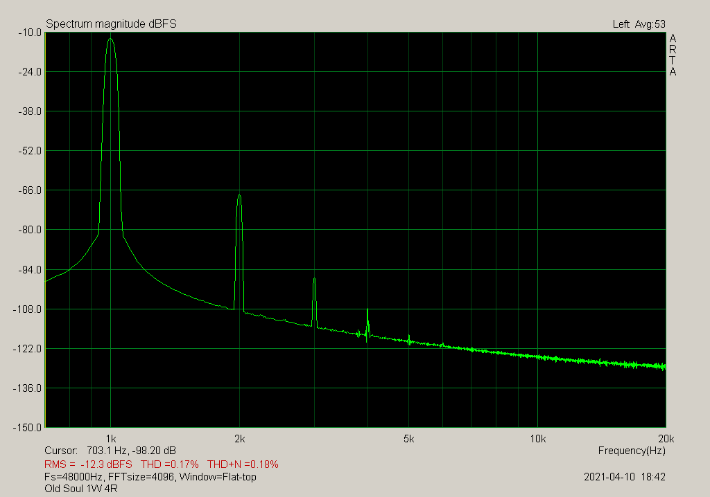

Zen Mod Napisano April 10, 2021 Autor #9 Napisano April 10, 2021 hard data, 4R load, same conditions as previous _MM_ je reagovao/la na ovo 1

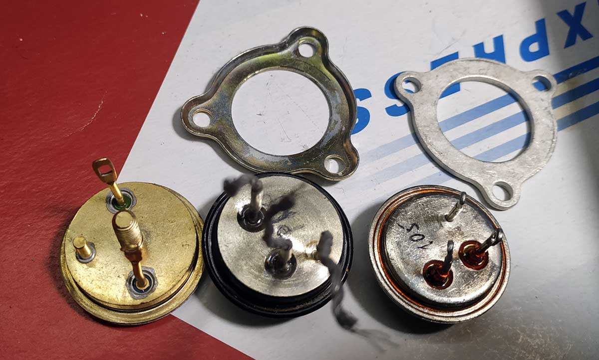

Zen Mod Napisano April 10, 2021 Autor #10 Napisano April 10, 2021 how it sounds - SIT-ish; Blasphemy; Surprise; insane Summer amp will post measurements with other two Russian Ge Biguns, and also with 2SA1943 in place of Ge (as viable and worthy option) that last one working and resulting in surprisingly funny foot-taping sound

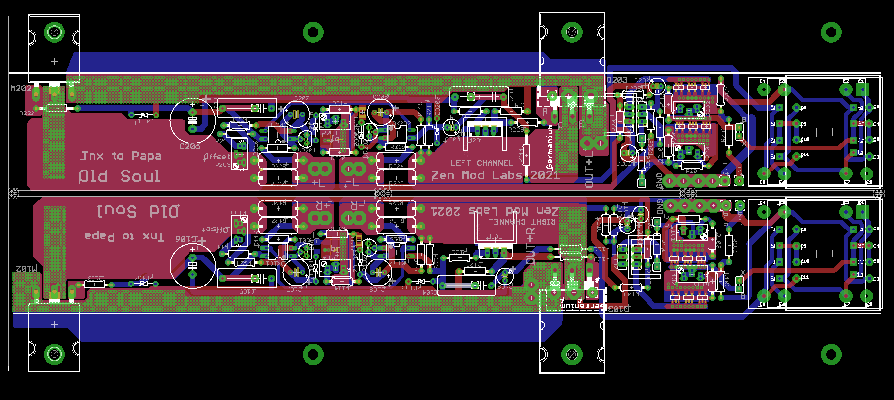

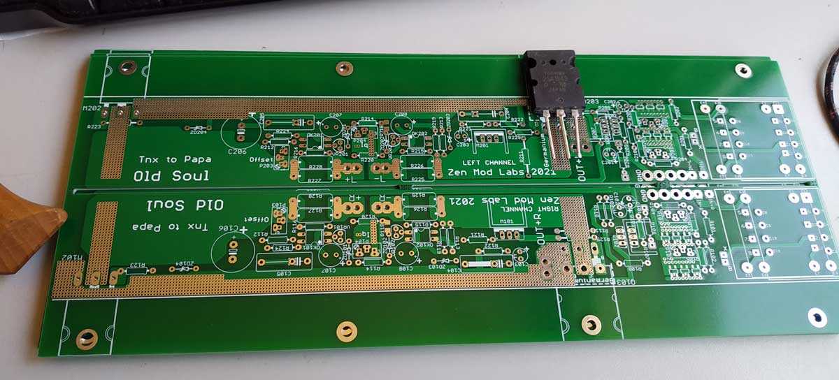

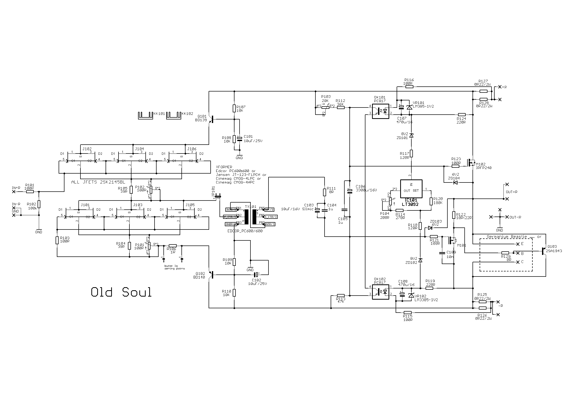

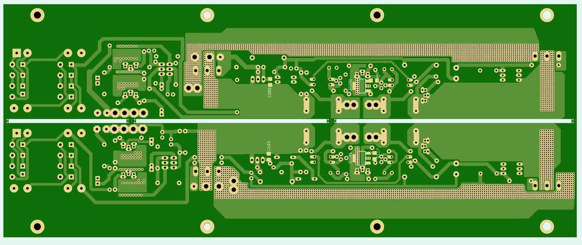

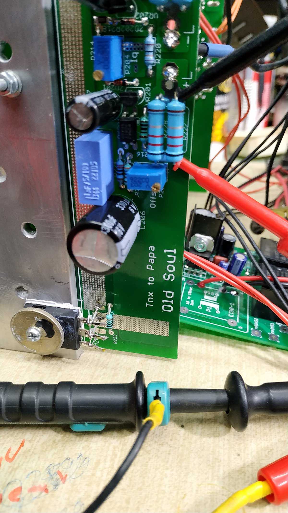

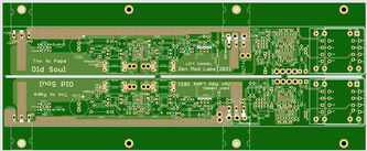

mutayu Napisano April 11, 2021 #18 Napisano April 11, 2021 Ostaje 1A ruhestrom i za 2SA1943, mislim koji je gornji prakticni limit i ima li koristi podizati je? M101 ostaje IRFP9140? Kako i sta sa setovanjem P102 (doduse lenj sam i nisam do kraja izucio domaci)?
Zen Mod Napisano April 11, 2021 Autor #19 Napisano April 11, 2021 9 minutes ago, mutayu said: Ostaje 1A ruhestrom i za 2SA1943, mislim koji je gornji prakticni limit i ima li koristi podizati je? M101 ostaje IRFP9140? Kako i sta sa setovanjem P102 (doduse lenj sam i nisam do kraja izucio domaci)? sa 1943 Iq je 1A5 i nema potrebe za vise, Square Law (nema source/emiter otpora) tako da i u klipingu ne izlazi iz A klase moja omaska - nisam napisao M1 type - to jeste i ostaje IRF9510 dva leva trimera su za Iq i Offset buffera , gornji desno trimer je izlazi DC offset, centralni desno trimer je OS Iq vladd and _MM_ je reagovao/la na ovo 1 1

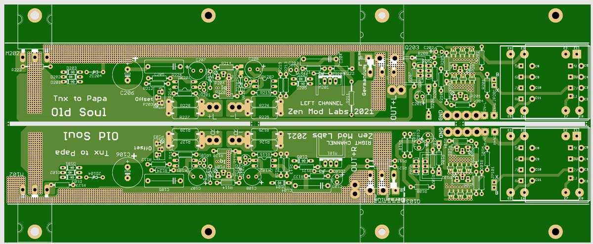

mutayu Napisano April 11, 2021 #20 Napisano April 11, 2021 Hvala na brzom odgovoru! Hoce li biti skoro dostupnih plocica? Kakvo napajanje preporucujes da se primeni?
vladd Napisano April 11, 2021 #21 Napisano April 11, 2021 15 hours ago, Zen Mod said: rails 24Vdc, Iq 1A (yes, just 1A; ZM Chicken, want to preserve that funny Ge, to have long and prosperous life) Prijala bi mu regulacija, mali napon mala struja, nije neka drama. I na par W je prelepa paleta harmonicica...
Zen Mod Napisano April 11, 2021 Autor #22 Napisano April 11, 2021 33 minutes ago, mutayu said: Hvala na brzom odgovoru! Hoce li biti skoro dostupnih plocica? Kakvo napajanje preporucujes da se primeni? standardno FW format - dual 18Vac sekundari, pa onda dalje - dva greca, 33mF-0R1-33mF po railu za Ge moze i manje mF i manje VA u torusu za 2SA to sto sam naveo msm, detaljnije - ono sto ja standardno radim je {Trafomatic 300VA (navedeno da je za A klasu) , dva greca, 33mF-0R1-33mF po railu}, po kanalu ako je zajednicki trafo za oba kanala, onda 400-500VA , minimalno 33mF-0R1-33mF po railu 4 minutes ago, vladd said: Prijala bi mu regulacija, mali napon mala struja, nije neka drama. I na par W je prelepa paleta harmonicica... nema potrebe ono , bar ja ne volim rezultat koji se dobija uvodjenjem regulacije/aktivne filtracije za izlazni amp - ako nije bas obavezno samom konstrukcijom a ovde nije vladd and mutayu je reagovao/la na ovo 2
