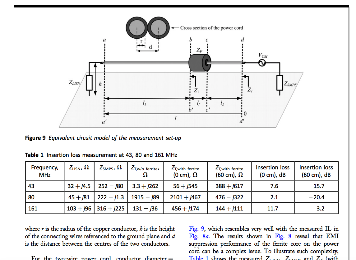

Mikorist Napisano Januar 13, 2019 Share #411 Napisano Januar 13, 2019 Evo naučni rad na temu feritna jezgra i odbijanje EMI Quote Conclusions A more realistic assessment approach to evaluate the EMI suppression performance of a ferrite core under its intended operating condition has been described and validated. Using a practical example of a power cord loaded with a ferrite core under the standard EMI test set-up, the EMI suppression performance of the ferrite core at any position on the power cord can be easily evaluated. The evaluation shows that the source and load terminations, as well as the transmission characteristic of the cable, have a very strong influence on the EMI suppression performance. Also, by placing the ferrite core nearest to the noise source provides the most consistent EMI suppression performance throughout the frequency range of interest. The conventional 50 V measurement system that assumes matched terminating source and load impedance tends to overestimate the EMI suppression performance of the ferrite core. The existing work can be extended further to practical electromagnetic compatibility (EMC) situations with multiple equipment and multiple cables so that useful EMC design guide could be established. Further work will be carried out to correlate the IL performance of the ferrite core with the reduction of CM current on the cable. https://www.researchgate.net/profile/KY_See/publication/224151284_Assessment_of_electromagnetic_interference_suppression_performance_of_ferrite_core_loaded_power_cord/links/0fcfd5054252090525000000/Assessment-of-electromagnetic-interference-suppression-performance-of-ferrite-core-loaded-power-cord.pdf Link to comment Podeli na ovim sajtovima More sharing options...

vladd Napisano Januar 13, 2019 Share #413 Napisano Januar 13, 2019 Vala bas. Mislim pokazuje efekat ferita, ali za nase verzije sa trafoom, bi morao malo drugaciji setap. I sami su se izogranicavali terminalnim impedansama, a pride se iz dijagrama vidi rezonansa na 80MHz..to su neupotrebljive situacije, nezgodne prelazne pojave. Mozda ferit pomogne nekima kojima osciluje amp na 2-8 mega, pa da ne smeta ostalim finim spravama Link to comment Podeli na ovim sajtovima More sharing options...
