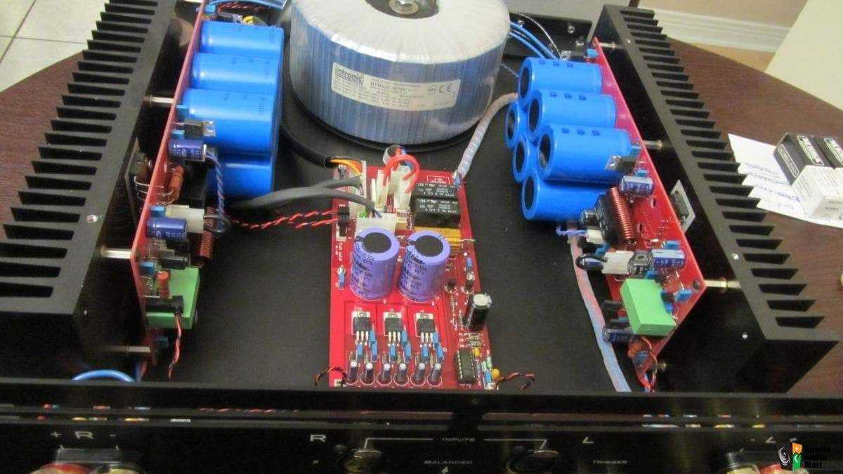

BokiTokiVoki Napisano Jul 6, 2019 Share #1 Napisano Jul 6, 2019 Ako nešto može da se iscedi iz donjeg texta, što bi bilo dovoljno za mišljenja o kvalitetu ove skalamerije (made in Swiss) tehničkim crtama, kao i nekim karakterističnim crtama u zvuku....? Mislim da malko naginjem ka Mosfet karakteru zvuka. Pass XA mi je ponekad pre-analitičan...naravno, zavisi od ostatka sistema i muzičke produkcije... POWERAMPLIFIER MIMETISM 45.2 2 x 180 Watts RMS at 8 ohms , 230 V - 2 x 360 Watts RMS at 4 ohms , 230 V 1'000 VA power supply - Inputs - 1 x unbalanced - 1 x balanced From a purely technical standpoint, the challenge was to design a circuit that would be simple and yet uncompromising in terms of musicality and reliability. Using Surface Mounted with tight tolerance components associated with traditional ones at the most strategic places enabled to shorten the signal path length. The amplification uses the highly acclaimed Hitachi Lateral Mosfets 2SK1058 & 2SJ162 complementary power transistors, in a configuration of two pairs per channel. The input section uses a cascode differential stage for the best performance. Both the pre-driver and the driver stages are based on High-Voltage Power Bipolar Transistors used in HF designs. The driver operates in pure class A. The circuit is fully direct-coupled but for a single ingress capacitor. Each channel has its own power supply with a lefty 60,000 microfarads of filtration, achieved via high current diodes without switching peaks. A delayed start-up function linked to the D.C. protection circuit is built into each channel. The gigantic 1000 VA toroidal transformer has two separate windings for each channel. To avoid current saturation, a power resistor has been placed in the power supply. After a very short delay, this is coupled to a power relay that limits the current. The loudspeaker output terminals are fed by solid copper bars. TECHNICAL DATA with AUDIO PRECISION analyser MIMETISM 45.2 AMPLIFIER Output power 180 Watts RMS at 8 ohm , 230 V Description 360 Watts RMS at 4 ohm , 230 V Power Amplifier Dual Mono Signal to noise 110 dB Power Supply 1'000 VA Input Unbalanced RCA Distortion at 8 ohm 0.005 % 80 Watts / 100 Hz Input Balanced XLR 0.005 % 80 Watts / 1000 Hz Speakers Bi-Wiring 0.010 % 80 Watts / 10 KHz Trigger In / Out Input impedance 47 Kohm Rise time 1.8 us / 10 KHz Link to comment Podeli na ovim sajtovima More sharing options...
Zen Mod Napisano Jul 6, 2019 Share #2 Napisano Jul 6, 2019 pa , u textu izrecene sve prave stvari , ali nema necega sto bi moglo da iole informise kakav je karakter zvuka ono sto se moze primetiti sa slike je da hladnjacici izgledaju pomaleni za deklarisanih 180W/8R a kamoli za 360W/4R, a bogumi dva para navedenih izlaznih mosfeta nisu garancija da to nece biti spepeljeno na prvoj ozbiljnoj zurci veci hladnjaci, najmanje 4 para tranzistora po kanalu , i nemam onda nikakve zamerke mozda konzervativno , ali to je moj stav Link to comment Podeli na ovim sajtovima More sharing options...
Fukushima Napisano Jul 6, 2019 Share #3 Napisano Jul 6, 2019 Vidi se iz opisa o čemu se radi klasična hitachi varijacija. Sve ok, s tim što je nelogično što ima samo po 1 par laterarnih mosfeta ako dobro vidim sa priložene slike. Link to comment Podeli na ovim sajtovima More sharing options...
Fukushima Napisano Jul 6, 2019 Share #4 Napisano Jul 6, 2019 Zen, me preteče za 2 sekund ? Link to comment Podeli na ovim sajtovima More sharing options...
Zen Mod Napisano Jul 6, 2019 Share #5 Napisano Jul 6, 2019 Quote The amplification uses the highly acclaimed Hitachi Lateral Mosfets 2SK1058 & 2SJ162 complementary power transistors, in a configuration of two pairs per channel. Link to comment Podeli na ovim sajtovima More sharing options...
Fukushima Napisano Jul 6, 2019 Share #6 Napisano Jul 6, 2019 Just now, Zen Mod said: Pročitah ali na polčici vidim samo 1 par, ako nisam dibiduZ oćoraveo ? Link to comment Podeli na ovim sajtovima More sharing options...
Zen Mod Napisano Jul 6, 2019 Share #7 Napisano Jul 6, 2019 e , ja na taj fakat uvek racunjam - i ja vidim samo jedan par , al znam da sam corav Link to comment Podeli na ovim sajtovima More sharing options...
Aleks Napisano Jul 6, 2019 Share #8 Napisano Jul 6, 2019 Je, samo je jedan par na pcb definitivno. Sve što preko nekih 80W sinusa isporuči ovaj amp tera taj jedan izlazni par u danger zone. Link to comment Podeli na ovim sajtovima More sharing options...

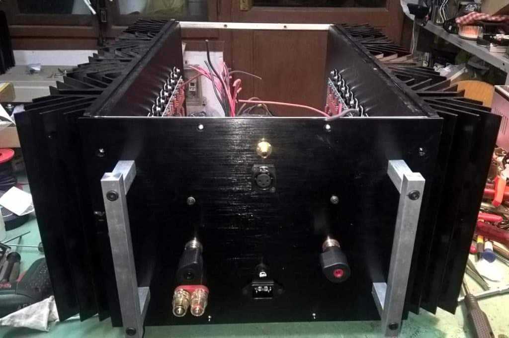

Mikorist Napisano Jul 6, 2019 Share #12 Napisano Jul 6, 2019 Ima slika kod Zen na blogu količačka je kutija za 1 kanal na 100W meni je ovo preterano ogromno. ali to je realna A klasa https://www.zenmod.in.rs/pass/babelfish-xj-or-jx-or-whatever/ Link to comment Podeli na ovim sajtovima More sharing options...

vladd Napisano Jul 6, 2019 Share #14 Napisano Jul 6, 2019 4 tranzistora u izlazu. Sa ove se bolje vidi. Mada, zbijeni, uz grupisanu disipaciju, doticne brojke moguce u vrlo kratkom periodu. Link to comment Podeli na ovim sajtovima More sharing options...

Aleks Napisano Jul 6, 2019 Share #17 Napisano Jul 6, 2019 34 minutes ago, vladd said: 4 tranzistora u izlazu. Sa ove se bolje vidi. Mada, zbijeni, uz grupisanu disipaciju, doticne brojke moguce u vrlo kratkom periodu. Da, ovde se lepše vidi... Ok onda može kratko izbaciti, al da ne pričamo o snazi - miriše na neku varijaciju Crescenda (možda i preslikan šta ga znaš), a to je jako autoritativan amp. Precizan, moćan, sa vrlo malo šećera (taman kolko treba), nema muljanja, nema distorzije. Mnogo podcenjeno pojačalo. Uz ovaj trafo i napajanje trebalo bi da je odlično pojačalce. Link to comment Podeli na ovim sajtovima More sharing options...
