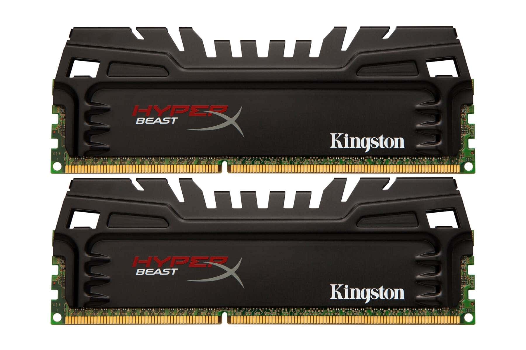

Mikorist Napisano Januar 3, 2018 Share #1 Napisano Januar 3, 2018 GA-B85M-D3H-A (rev. 1.0) with BIOS F2 http://www.gigabyte.com/products/product-page.aspx?pid=5417#ovCore i5-4460 https://ark.intel.com/products/80817/Intel-Core-i5-4460-Processor-6M-Cache-up-to-3_40-GHzKingston 16 GB 2133 MHz DDR3 HyperX Beast T3 (2x8GB - RAM slot 2&4 - only working like that correctly - i also removed the RAM heatsinks ) https://www.techpowerup.com/reviews/Kingston/HyperX_Beast_Black_2133_C11/Chieftec UC-02B-500S8 Uni, Midi Tower http://www.chieftec.eu/en/chassis/midi-tower-entry-level/uc-02b-new.htmlHD R7770-PMD1GD5 (This is a good card, especially at the price of the refurbished model.) https://www.msi.com/Graphics-card/R7770-PMD1GD5.html#hero-overviewYou do not need anything for this motherboard. No special adjustment.A single file I have not touched here in MacOS.Bios Settings:XHCI Hand-off: EnabledEHCI Hand-off: EnabledExecute Disable Bit: EnabledXHCI Mode: AutoLegacy USB Support: EnabledSATA Mode: ACHI ( with UEFI Settings )VT-d feature : DisabledX.M.P. Memory Profile to Profile1Integrated graphics. Disabled - PCI graphics EnabledSeveral Kext in Clover with proper config.plist. For install USB & OS X .Nothing else. It is also one of the rarely small boards where the audio section is well-made.No weird buzzing/humming noise coming from this motherboard. Sound from this motherboard is amazing. (have Nippon Chemicon ARE series audio capacitors) Also no need for CodecCommander everything works from EFI (A single file I have not touched here outside EFI) screenshots Boot arguments for ATI ( Verde.kext + Lilu.kext + WhateverGreen.kext) "-lilubetaall radpg=15" EFI/CLOVER/kexts/Other directory. and my clover folder . you can see from this folder everything I done. all kexts are last one versions... CLOVER.zip zeljko_v and ab je reagovao/la na ovo 2 Link to comment Podeli na ovim sajtovima More sharing options...

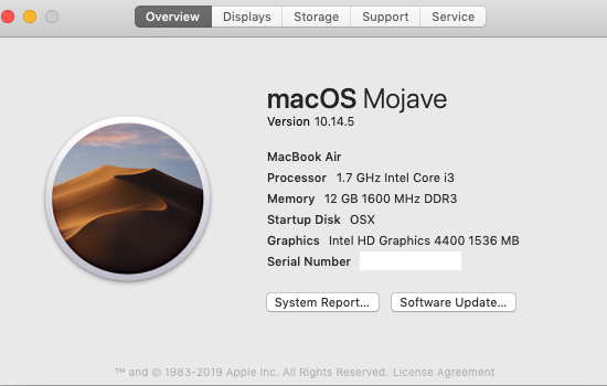

Mikorist Napisano Maj 15, 2019 Autor Share #3 Napisano Maj 15, 2019 Skrinsot sa laptopa. Z-Book Asus X302LA Koji god da sam instalirao OS, a sve sam moguce probao , nemam ovako kristalnu sliku. Gledam preko DELL UltraSharp U2518D 25" Tek kad se video pusti vidi se razlika. 4K, 1080p . kojigod.... Slika ne titra, nema glicheva....Isto kao kad pustis sa boljeg Blu-ray disc plejera.... Zvuk isto. Kroz njegovu zvucnu ili preko DAC..... Link to comment Podeli na ovim sajtovima More sharing options...

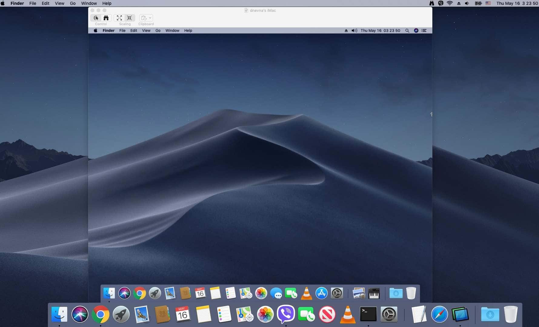

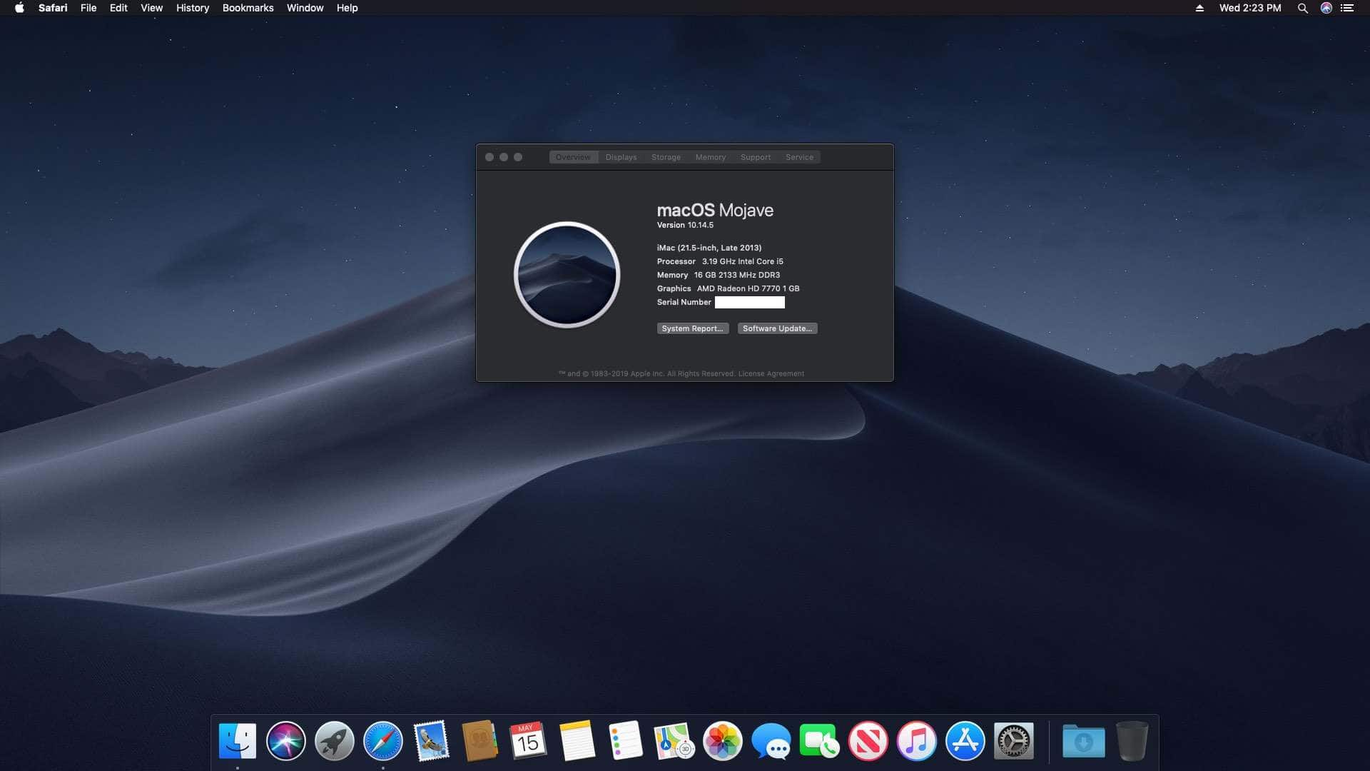

Mikorist Napisano Maj 15, 2019 Autor Share #5 Napisano Maj 15, 2019 Evo i mene na Desktopu. Ma brukaaaaa Link to comment Podeli na ovim sajtovima More sharing options...

Mikorist Napisano Maj 15, 2019 Autor Share #7 Napisano Maj 15, 2019 za multimediju u dnevnoj je dosta. btw 2133 MHz DDR3 HyperX Beast je 16GB Link to comment Podeli na ovim sajtovima More sharing options...

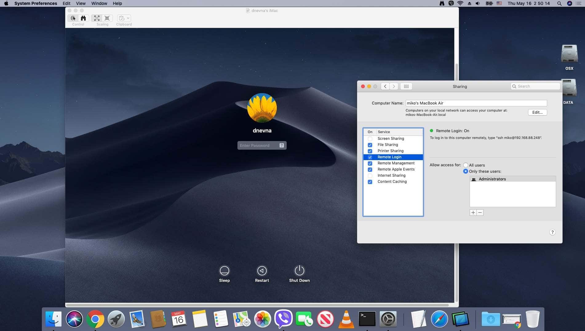

Mikorist Napisano Maj 16, 2019 Autor Share #10 Napisano Maj 16, 2019 Ali kakav je sistem za Sharing napravljen....Ima i sherovanje ekrana. Gledas sa drugog kompa film. Ili ga startujes na daljinu. Sve ugradjeno u menije Findera Nesto slicno kao NoMachine ali jos savrsenije i ugradjeno u Finder..... sve na klik. Potpuna kontrola drugog PC... Logovanje u bilo kog usera a da ne vidi. Nadgledanje....Rad sa fajlovima kao fajlserver. Babaroga OS.... Link to comment Podeli na ovim sajtovima More sharing options...
