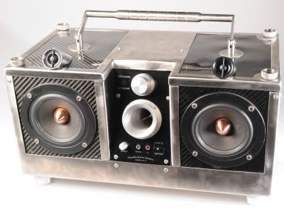

Mikorist Napisano Januar 15, 2011 Autor #70 Napisano Januar 15, 2011 swr145a definitivno cu da pravim kao drugi par ali ne sada. odlucio sam se za cssFR125S The Boominator a vi razradjujte temu dalje

Mikorist Napisano Januar 17, 2011 Autor #83 Napisano Januar 17, 2011 to je bre trip TB Rulez! kakav je tek trip CSS ako je dublji i detaljniji - citaj ovo:http://www.diyaudio.com/forums/full-range/68288-tb-w4-1320b-vs-css-fr125s.htmlI had both in DBR enclosure and closed box. They are real close in mids and high range. Both would benefit from a notch filter in the 7 kHz region.CSS has a better bass, 6mm Xmax and can go quite deep. Overall a bit more detailed than TB W4-Bamboo. TB on the other hand played good "out-of-the-shipping-box", CSS needs some time to break-in. kako se samo ova mala membrana krece: :sarcastic_hand:oba mogu da idu u potpuno iste kutije

Mikorist Napisano Januar 17, 2011 Autor #85 Napisano Januar 17, 2011 evo ovde je do u creva razradjeno, uporedni test OB Mark Audio Alpair 6 metal cone driver, Tang Band W3-1364 bamboo cone driver, Tang Band W4-1320 bamboo cone driver and CSS FR125S paper cone driver : http://www.gadgets.co.nz/mjv/loudspeakers/exp03.shtml Measurements were made from the rear of the driver simply because I was curious. There has been some discussion recently about the significance (or lack thereof) of the presence of high frequency content in the rear wave coming off an open baffle speaker. These measurements demonstrate that if you want a full range signal being projected rearwards you had better introduce a rear facing driver to do it; the full range drivers alone cannot be relied upon to carry out the task. Conclusion The Alpair has a limited top end compared with the other drivers, making for a very laid back sound. The CSS and Tang Band W4-1320 seem to be identical except for the difference in sensitivity. The CSS has the much larger X-max of the two. The upshot being the CSS is possibly more suitable for producing bass or large amounts of it, compared with the Tang Band. The Tang Band W3 has much better high end extension than the other drivers. It remains to be seen which driver sounds the best, but I'll be putting both of the Tang Band units at the top of my short list. CSS ima jebeni 6mm X-max i zato je dublji za 10Hz a i skuplji........
