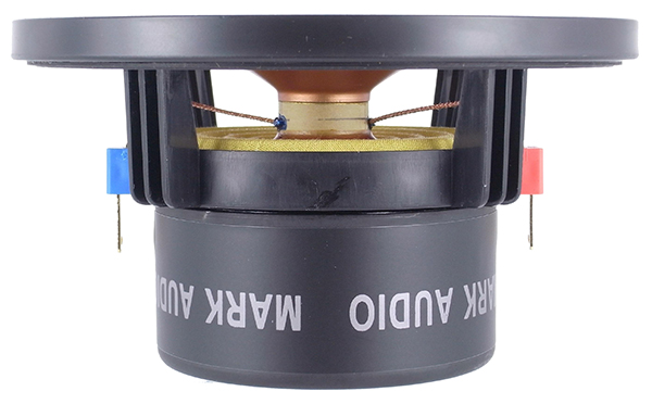

Features
* Two colour choices, gun-metal grey and classic gold.
* Drivers are packed in pairs with 2 X 2mm thick seals and 8 X 22-mm long Hex head wood screws.
* Handling Donʼt touch the cone or cap. These are delicate components.
* Running in period The Alpair 7 has advanced suspensions that require careful running in: Donʼt use any kind of artificially generated sound signal. Hours 1 to 20. Low volume vocal and light music, no heavy bass. Hours 21 to 120, gradually increase the volume to normal listening levels and gently introduce rhythmic bass music. Patience and care will bring musical rewards.

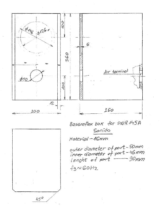

verovarno da Alpair 7 ima bolji bas i srednje tonove no nisam siguran i za disperziju visokih :scratch_head:
projektuj mi kutiju do 11 litara za taj drajver pa se ne ubij :sarcastic_hand:idem sa kutijom od 7-11 litara preko toga necu da slusam ni kod sebe ni kod drugih a ni da uporedjujem..... :hi:
kod Slobe cujes osnovni karakter a onda uzmes varijantu tog istog drivera - AlNiCoeve ti Sonido nacrt za kutiju , a od toga moze i bolje - moze da se uradi transmisijacena - po cenovniku u onoj Sonido temi - bese oko 110 par , ali mislim da je to i manje ako uzimas ditto kod njih
