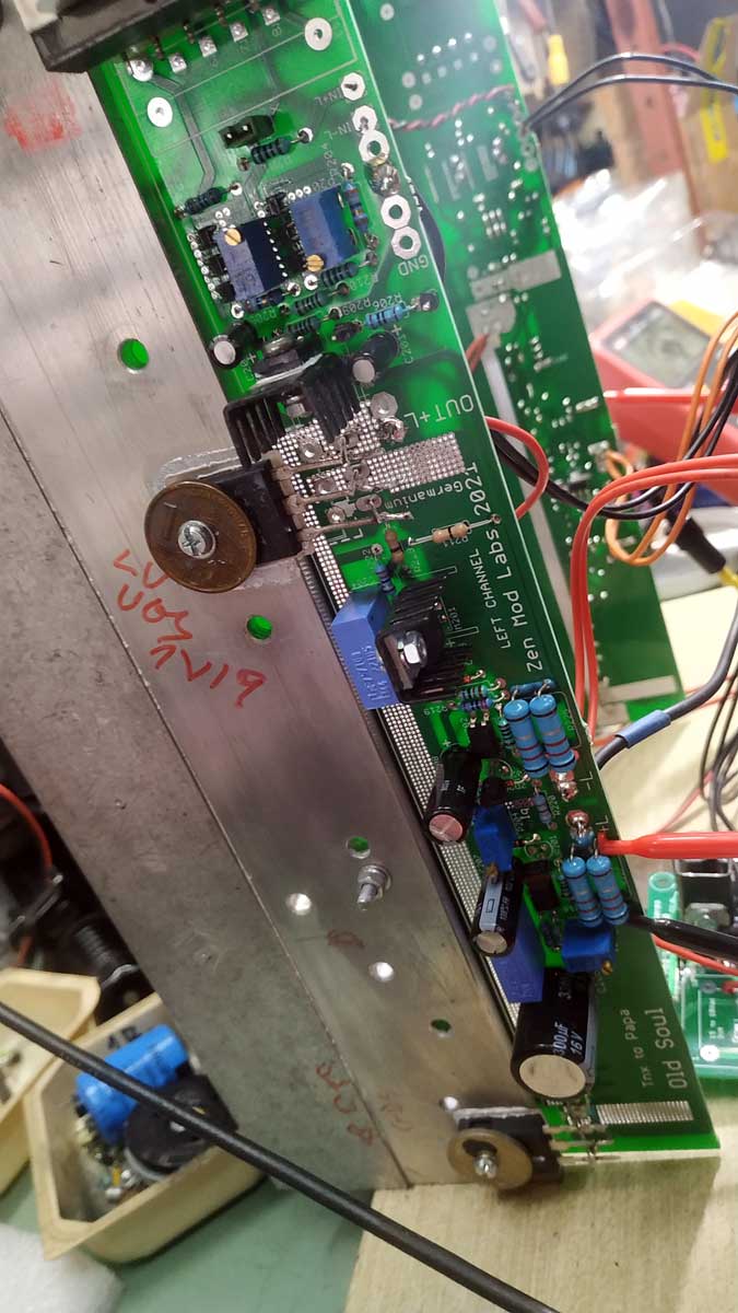

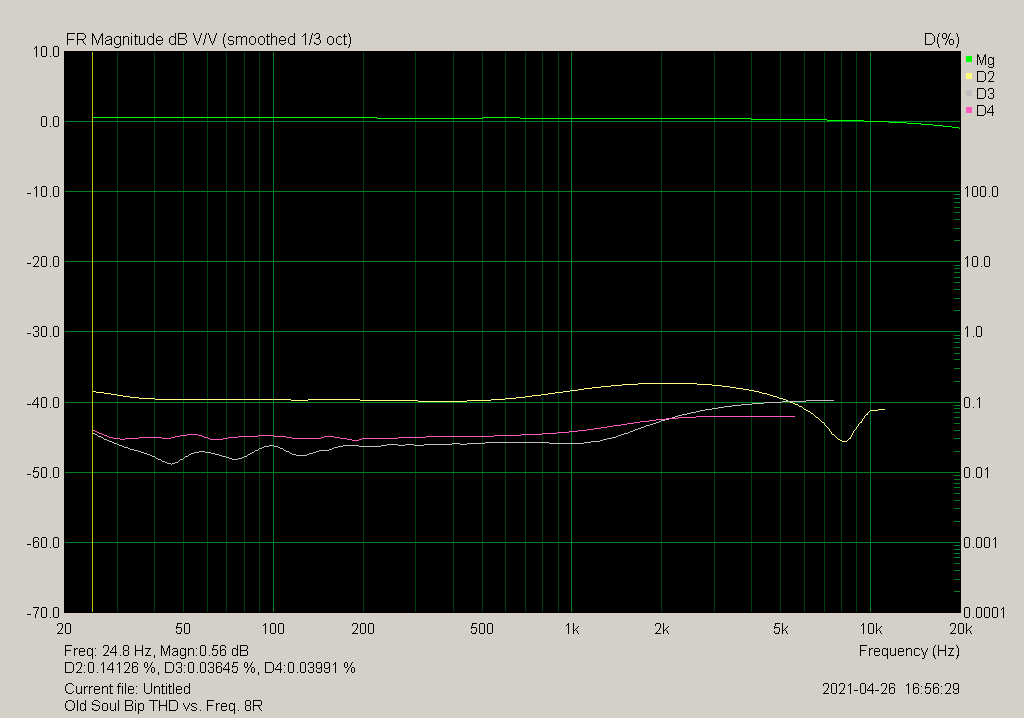

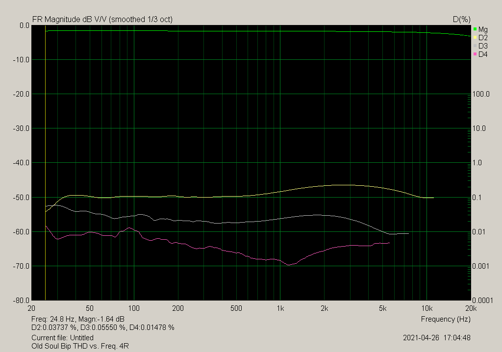

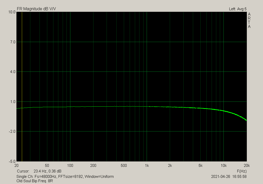

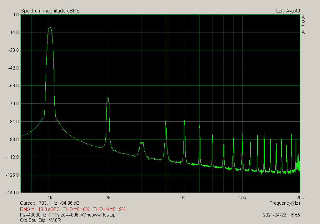

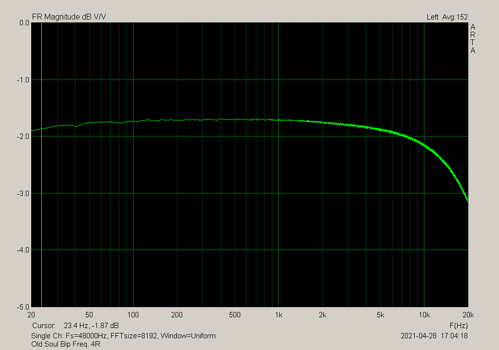

Zen Mod Napisano April 26, 2021 Autor #68 Napisano April 26, 2021 Final Old Soul installment Old Soul B or Bip, whatever instead of Ge Bigun, plain and common Si Bigun All changes needed are - replace part and replace shifting resistor (R122( value from 10R ( adequate for Ge Ube of 180-2--mV) to 22R ( adequate to Si Ube of 650mV), as part which defines current through Level shifting small mosfet M101 Had few 2SA1943 mounted them , fired up and Iq was sorta same as set for Ge - 1A-ish started upping Iq and fine-tuning DC Offset , did one channel and when I'm almost done, 2SA1943 in that second channel stopped pretending, taking R122 and output mosfet together with him, most probably South Ok, power down, remove both 2SA1943 , replace R122, replace IRFP240, mount undoubtedly and certainly original 2SA1491 power up, set what is needed , let it cook for a while and here it is - same wakoo shape of THD Spectra rails as before, Iq increased to 1A5 Load 8R

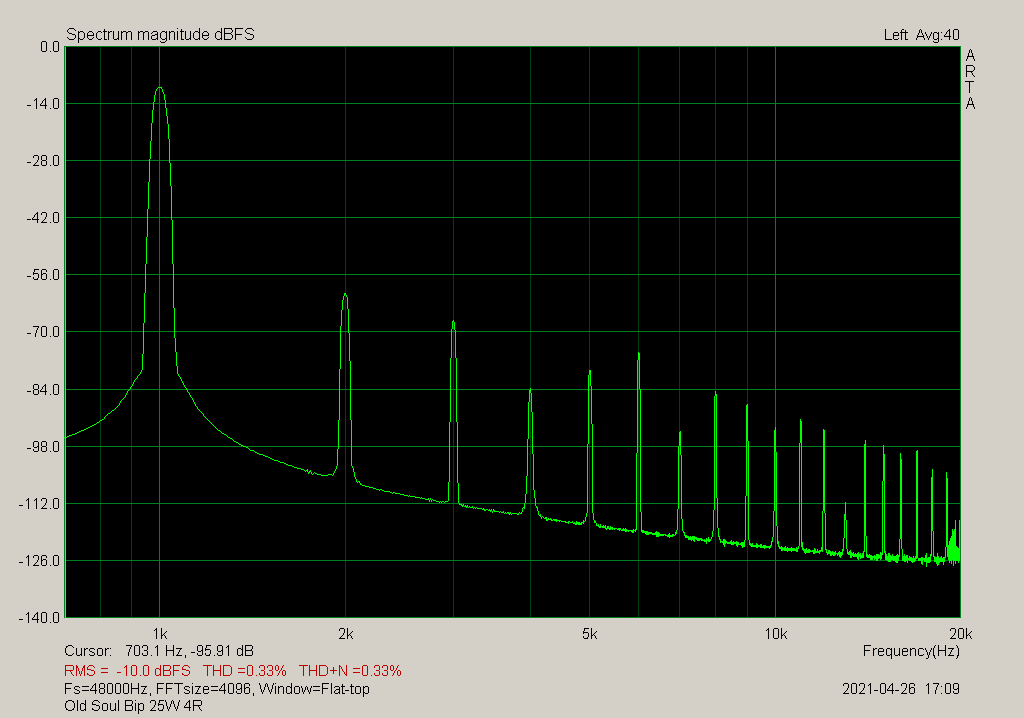

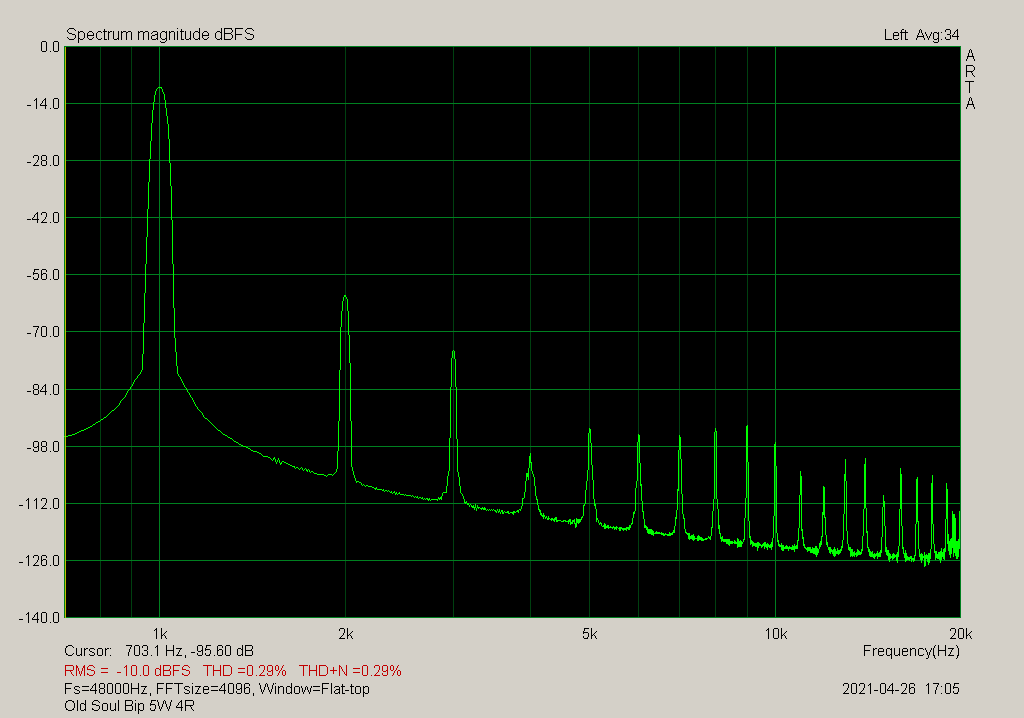

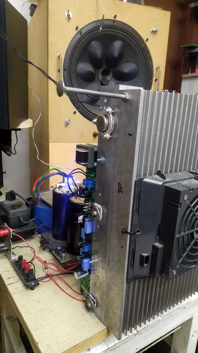

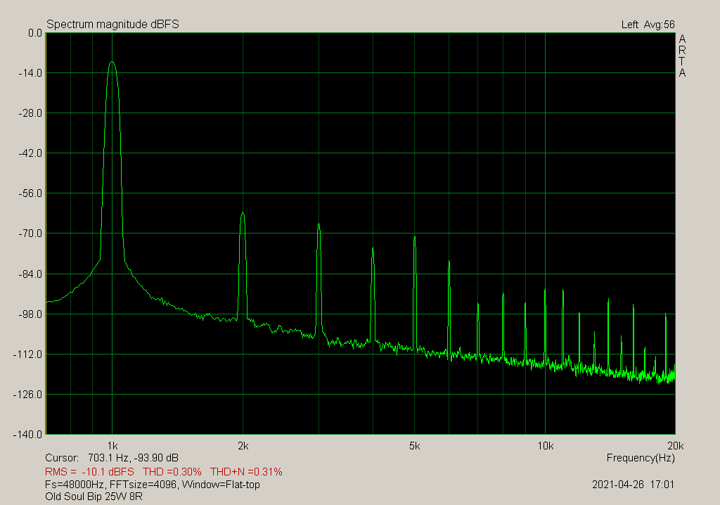

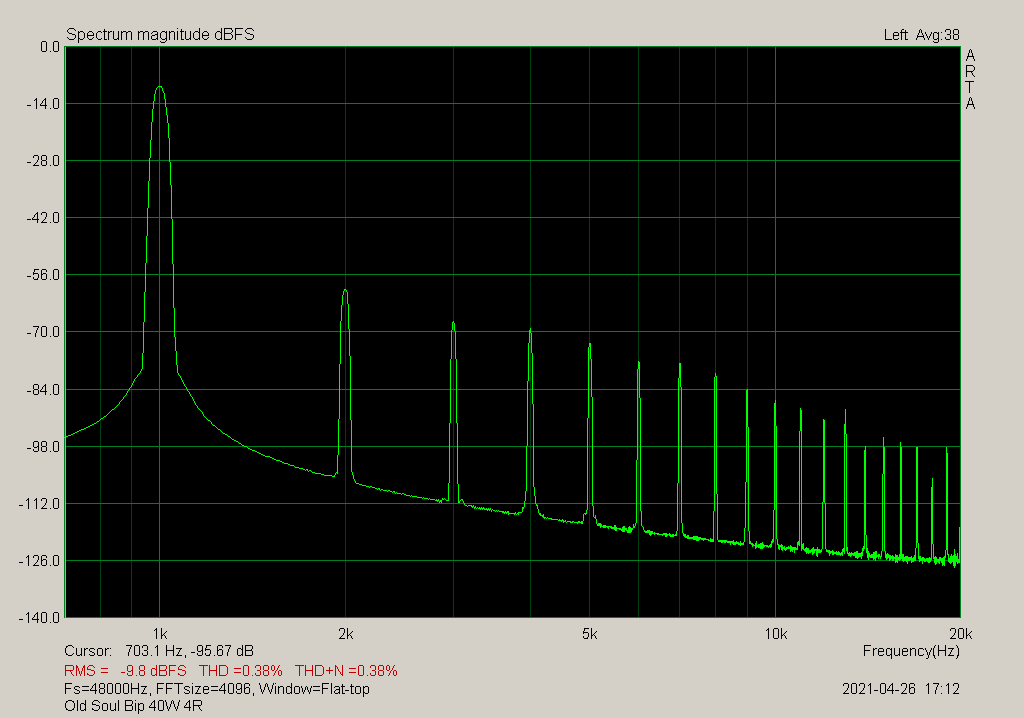

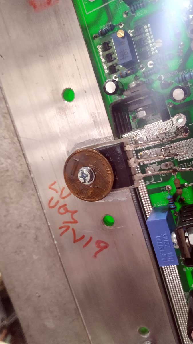

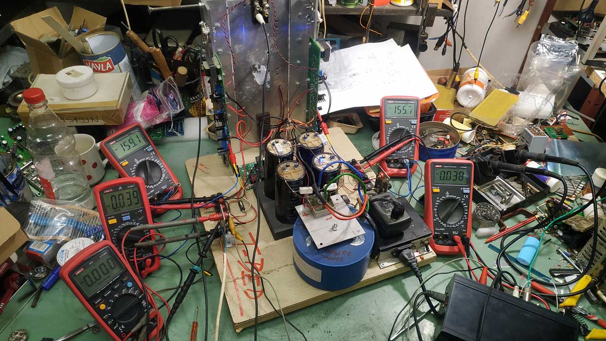

Zen Mod Napisano April 26, 2021 Autor #70 Napisano April 26, 2021 few funny pics more conclusion - all 3 iterations (2N1099, 1T813, 2SA1491) are fun to listen, sharing same holographic quality, which is most probably result of extrafunny THD Spectra krca44 and Mentok je reagovao/la na ovo 1 1
