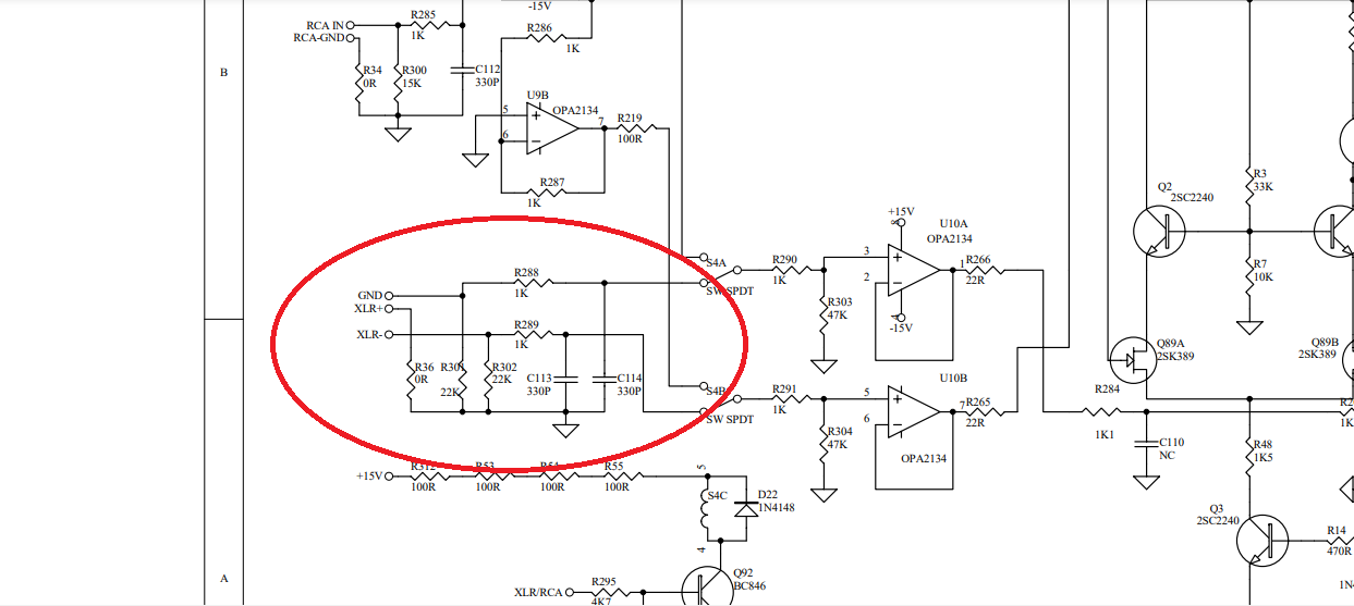

Gosha Napisano Avgust 30, 2020 #34 Napisano Avgust 30, 2020 55 minutes ago, Srecko said: Možda mog Google boli glava ali ja nađoh ovo a to je mnogo više od 16kg. Ne treba ovolika kuticina (i sa slike se vidi) za 16kg. Features and Specification 2000VA toroidal transformer. - A total of 180,000 uF electrolytes in the power supply. - Dual set of speaker terminals for each channel. - Balanced (RCA) and Unbalanced (XLR) inputs. - Input impedance: 15kohm, RCA and XLR - Output Power (both channels driven): 2x250W 8 ohms load 20Hz-20Khz - 2x400W 4 ohms load 20Hz-20kHz - THD+N: below 0.05% in both cases. - THD+N: 1kHz, 250W, 8 ohm load below 0.01%. - Frequency response: 20Hz-100kHz –0.5dB - Noise: below –100dBV - Gain: 26dB unbalanced, 20dB balanced. - Trigger input range: 4-15V. - Weight 40 kg. Dimensions 430 x 540 x 230mm (WxDxH) Malo bacih pogled na SM sto je Zen okacio. Radi se o demonstarciji snage, bridge pojacavac sa 16 izlaznih tranzistora (2SC520/2SA1943) po kanalu. Hvale se sa 180000uF u napajanju, sto je efektivno, u ovom slucaju 4 puta manje jer su kondovi redno vezani. I ova sitna greska: "Balanced (RCA) and Unbalanced (XLR) inputs" I greska u semi: Srecko je reagovao/la na ovo 1
vladd Napisano Avgust 30, 2020 #35 Napisano Avgust 30, 2020 PA dobro, vidis da je parada lapsusa Zamenili su samo nazive tackica ulaza, XLR+ i GND, ostalo je ok u semi.
