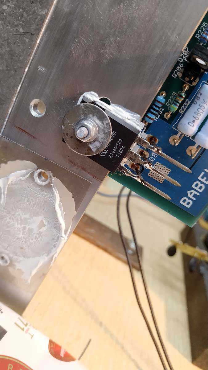

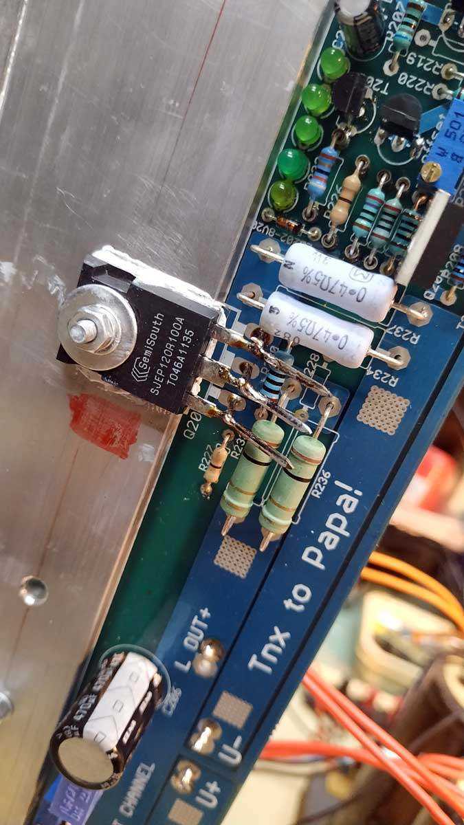

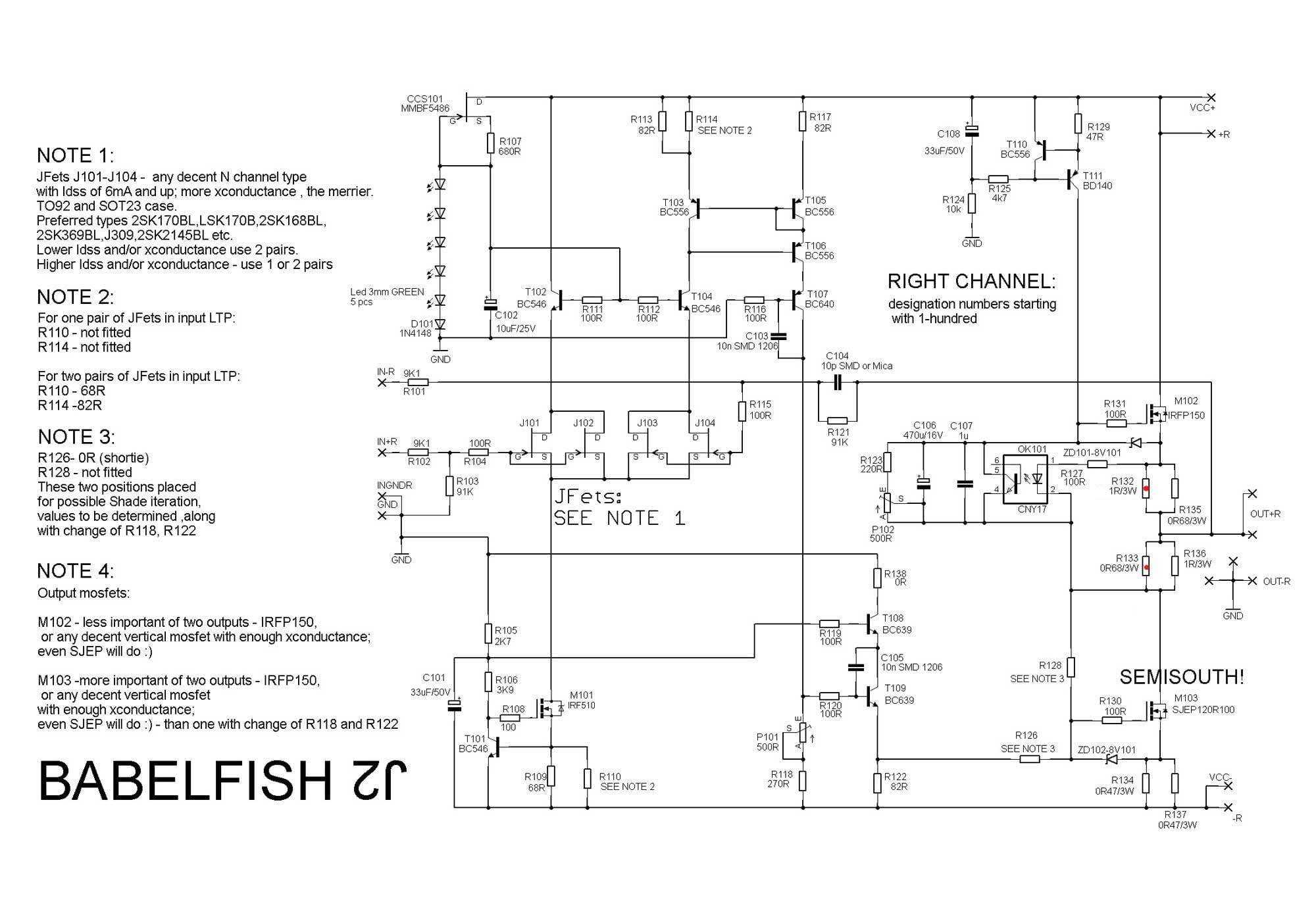

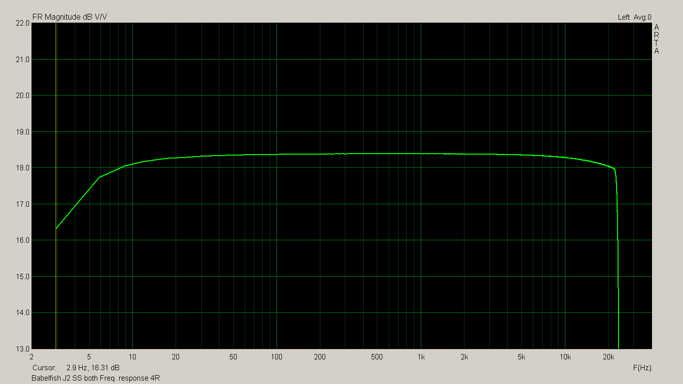

Zen Mod Napisano Septembar 25, 2019 Autor Share #23 Napisano Septembar 25, 2019 Quote with already presented iteration with both output positions occupied with mighty IRFP150 , we are having nice Pleasure Machine , with nice and cozy low THD ...... but! - when SJEP120R100 is introduced in lower output position, we got Pinpoint Machine eto to Link to comment Podeli na ovim sajtovima More sharing options...
Zen Mod Napisano Septembar 25, 2019 Autor Share #24 Napisano Septembar 25, 2019 Link to comment Podeli na ovim sajtovima More sharing options...
Zen Mod Napisano Septembar 25, 2019 Autor Share #25 Napisano Septembar 25, 2019 Vix je reagovao/la na ovo 1 Link to comment Podeli na ovim sajtovima More sharing options...
Zen Mod Napisano Septembar 25, 2019 Autor Share #26 Napisano Septembar 25, 2019 Link to comment Podeli na ovim sajtovima More sharing options...
Zen Mod Napisano Septembar 25, 2019 Autor Share #27 Napisano Septembar 25, 2019 Link to comment Podeli na ovim sajtovima More sharing options...
Aleks Napisano Septembar 25, 2019 Share #28 Napisano Septembar 25, 2019 Interesantno. Glasam za IRFP150 Link to comment Podeli na ovim sajtovima More sharing options...
Zen Mod Napisano Septembar 25, 2019 Autor Share #29 Napisano Septembar 25, 2019 a jes sto bi rekao Šojić - meta je zgođena! Link to comment Podeli na ovim sajtovima More sharing options...

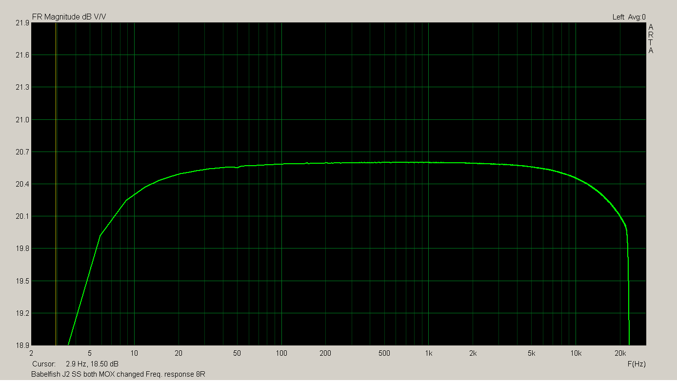

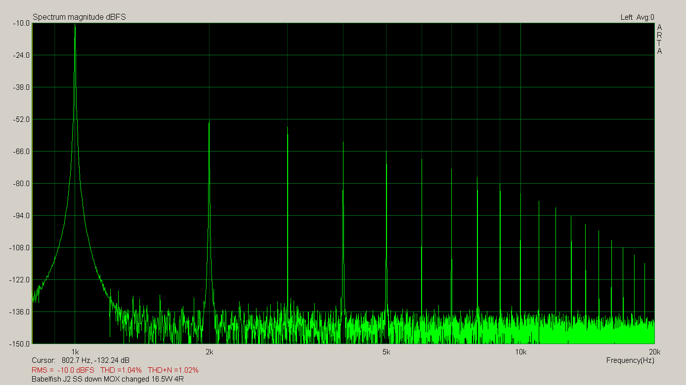

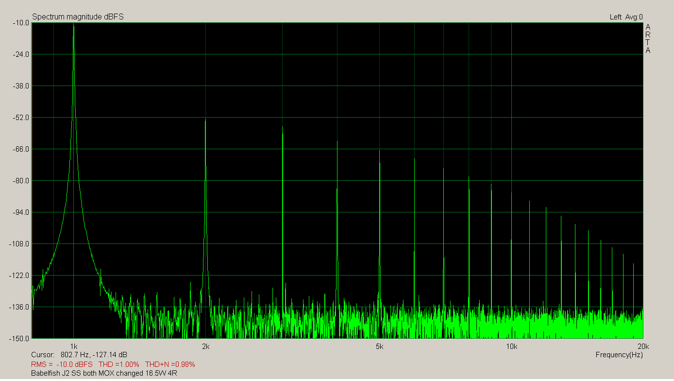

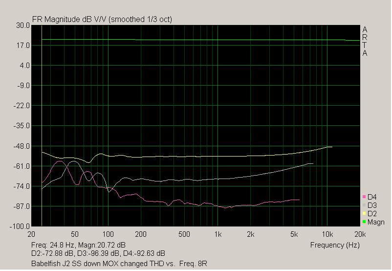

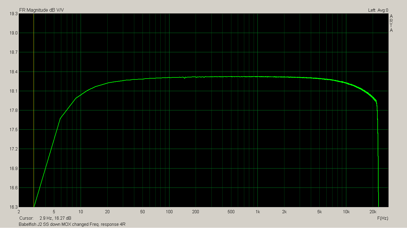

Zen Mod Napisano Septembar 30, 2019 Autor Share #30 Napisano Septembar 30, 2019 Malo igre sa vrednostima MOX otpora , da se izazove malo vise 2nd harmonika Semisouth dole IRFP150 gore , 8R load Link to comment Podeli na ovim sajtovima More sharing options...

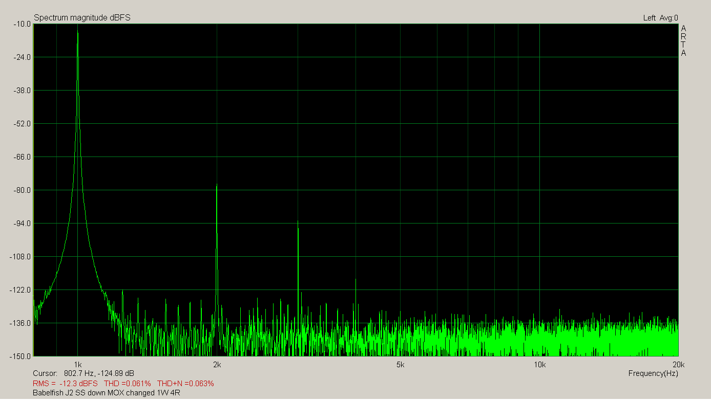

Zen Mod Napisano Septembar 30, 2019 Autor Share #31 Napisano Septembar 30, 2019 isto , 4R load Link to comment Podeli na ovim sajtovima More sharing options...

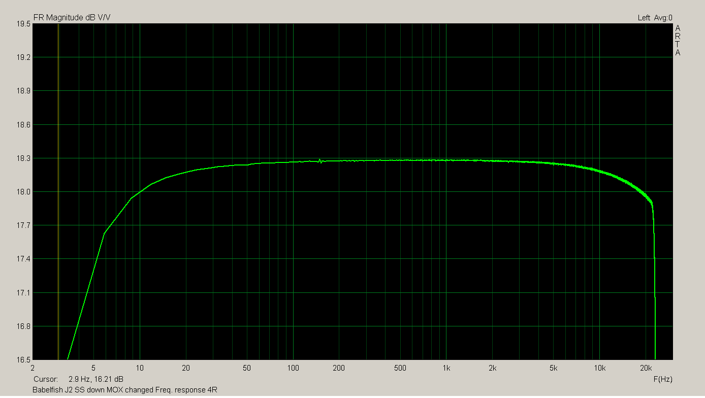

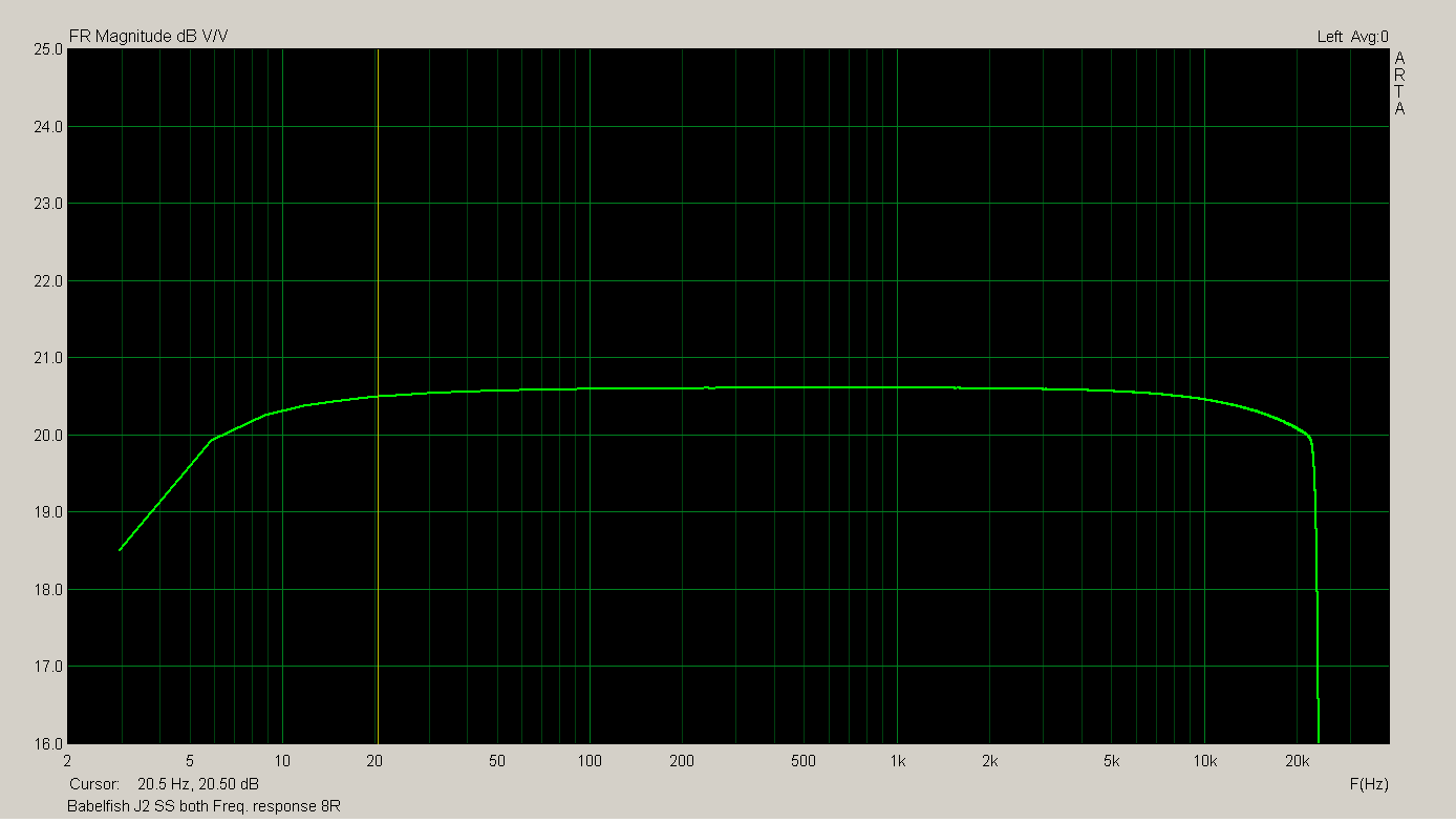

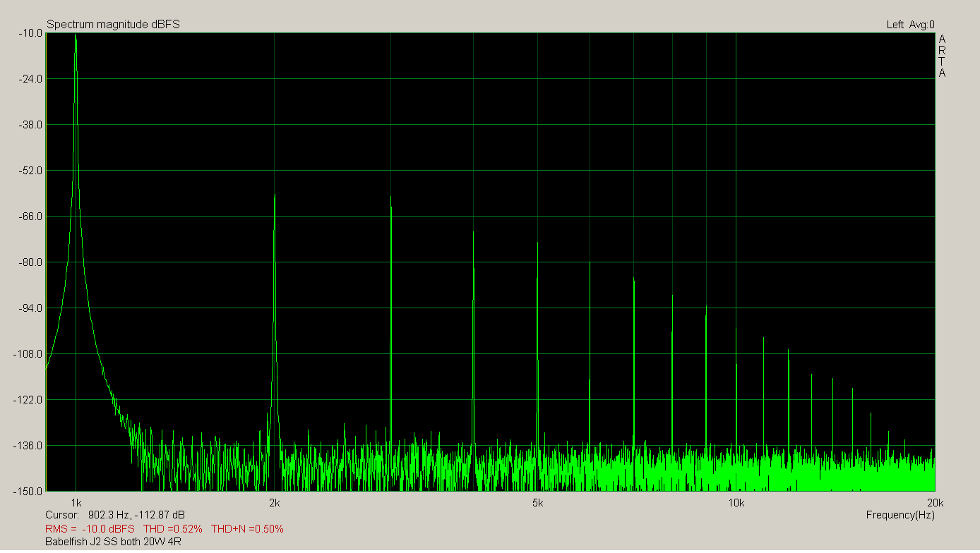

Zen Mod Napisano Septembar 30, 2019 Autor Share #32 Napisano Septembar 30, 2019 sema ista , oba Semisouth u izlazu , 8R load Link to comment Podeli na ovim sajtovima More sharing options...

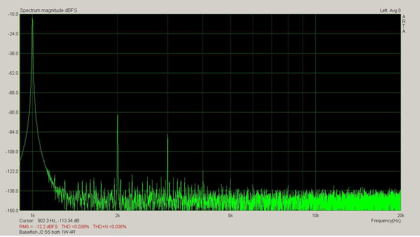

Zen Mod Napisano Septembar 30, 2019 Autor Share #33 Napisano Septembar 30, 2019 kao prethodno , 4R load Aleks je reagovao/la na ovo 1 Link to comment Podeli na ovim sajtovima More sharing options...
Zen Mod Napisano Septembar 30, 2019 Autor Share #34 Napisano Septembar 30, 2019 Babelfish J2 full set of measurements september 2019.zip Link to comment Podeli na ovim sajtovima More sharing options...

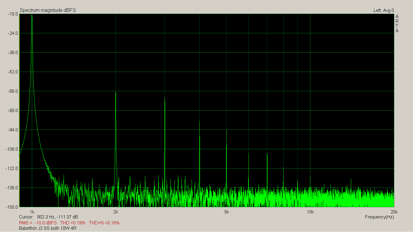

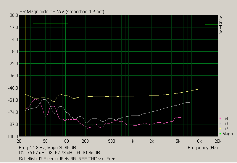

neskor Napisano Septembar 30, 2019 Share #35 Napisano Septembar 30, 2019 ovo lepo izgleda da li mozda imas i THD sa harmonicima? Link to comment Podeli na ovim sajtovima More sharing options...
Zen Mod Napisano Septembar 30, 2019 Autor Share #36 Napisano Septembar 30, 2019 ti ne vidis harmonike na tim grafovima? Link to comment Podeli na ovim sajtovima More sharing options...
neskor Napisano Septembar 30, 2019 Share #37 Napisano Septembar 30, 2019 1 hour ago, Zen Mod said: ti ne vidis harmonike na tim grafovima? mislio sam na ovako nesto Link to comment Podeli na ovim sajtovima More sharing options...
Zen Mod Napisano Septembar 30, 2019 Autor Share #38 Napisano Septembar 30, 2019 aha , THD vs. Freq , sto ne kazes ....... nisam tolko jos napredovao i oko ovih se naradih oko copy-paste-kuckuc -save za ono sto je mene interesovalo simple THD na 1K mi je sasvim dosta , i cetvrtke na 400/1K/10K/20K full throttle al to me mrzelo slikati na CRO mozda uradim to sad kad budem vracao sa full SS, pa na SS dole , pa full IRFP edit: msm ipak nema sanse sa ARTA i EMU1212 , i za ovaj osnovni setup se napatih da podesim vrazji control panel kartice to cemo resavamo Tractorom za QA400 , ili kod Magacionera na prave sprave Link to comment Podeli na ovim sajtovima More sharing options...

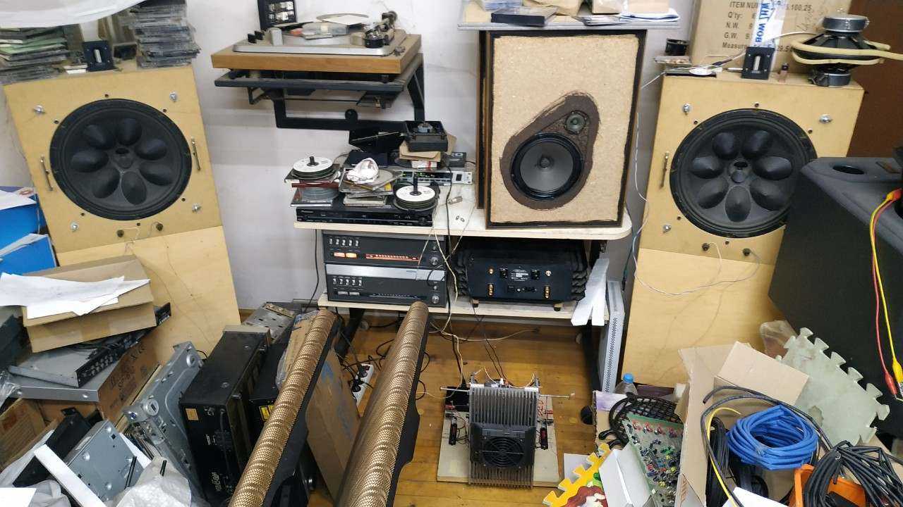

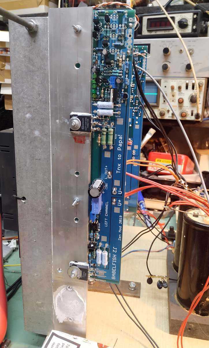

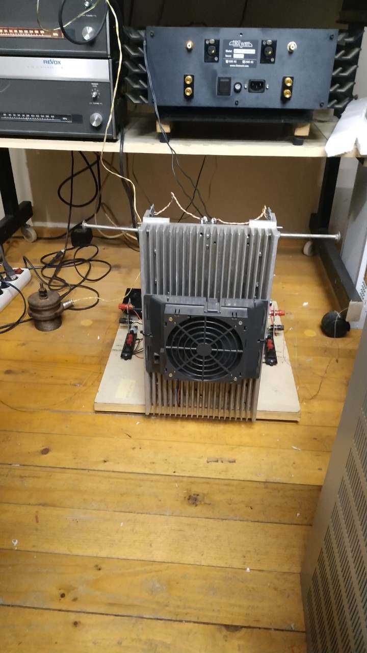

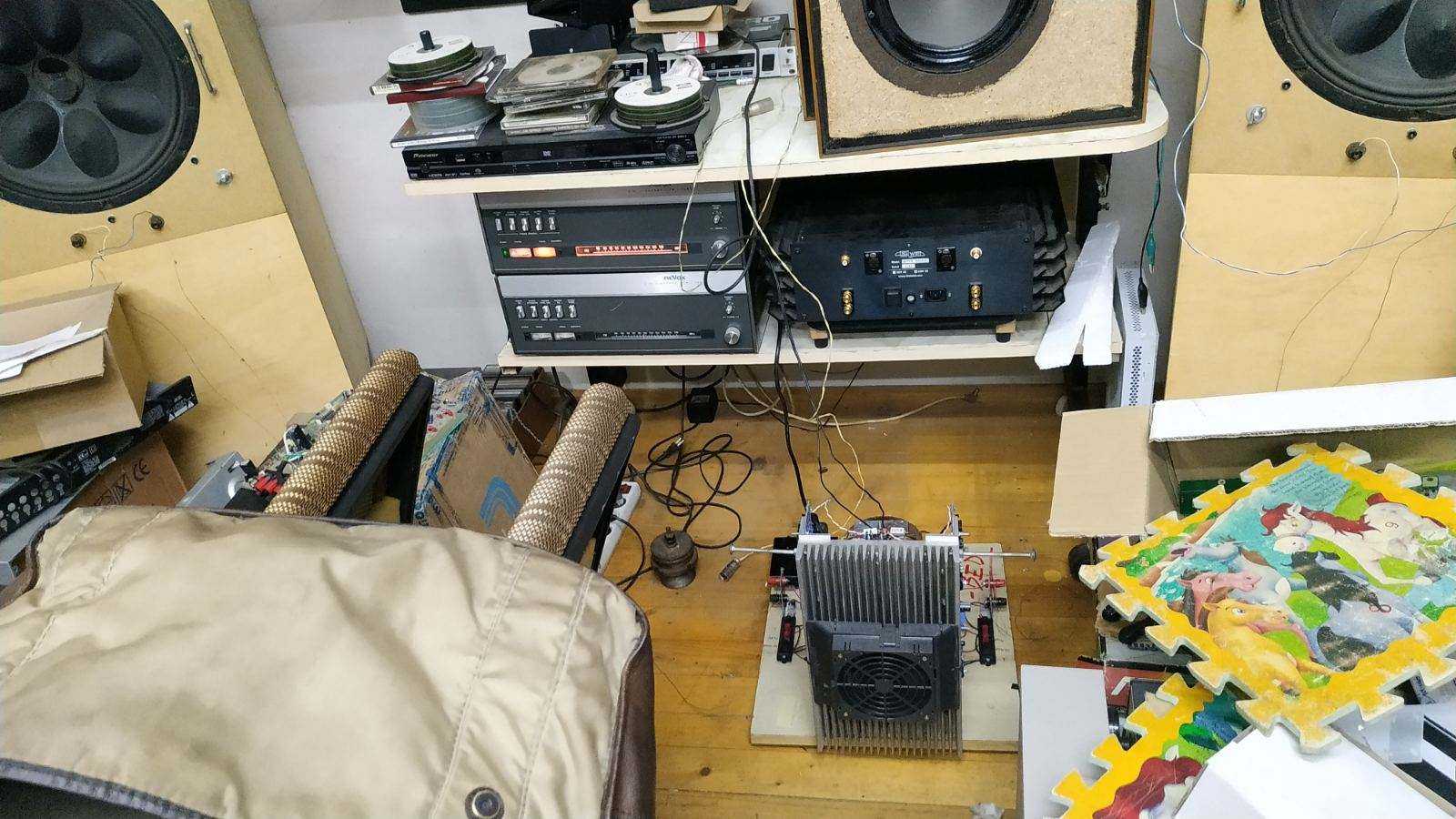

Zen Mod Napisano Oktobar 3, 2019 Autor Share #41 Napisano Oktobar 3, 2019 posle silnih merenja , vrnuo se malisa na svirku, full IRFP iteracija ...... semisouthi vrnuti u pakovanje i u fioku obsetih se malopre , kad ga pomenuh u Wolanderaju dejanco32 je reagovao/la na ovo 1 Link to comment Podeli na ovim sajtovima More sharing options...
Aleks Napisano Oktobar 3, 2019 Share #42 Napisano Oktobar 3, 2019 I? Koliko vredi generalno dati 100x više para za izlazne? Zvučno gledano. Samo nemo kažeš: "ne znam ja, ene gluv sam na jedno uvo a i to drugo mi ne radi nešto najbolje ovih dana" i slični odgovori.. Realnost: Koliko vredi ulaganje dobro očuvanog Yuga u 4 tranzistora? Link to comment Podeli na ovim sajtovima More sharing options...
Woland Napisano Oktobar 3, 2019 Share #43 Napisano Oktobar 3, 2019 ^ ću ti kažem merodavno kad ga lapim na neko vreme.. a na prvu loptu: ne vredi Srecko and Aleks je reagovao/la na ovo 1 1 Link to comment Podeli na ovim sajtovima More sharing options...

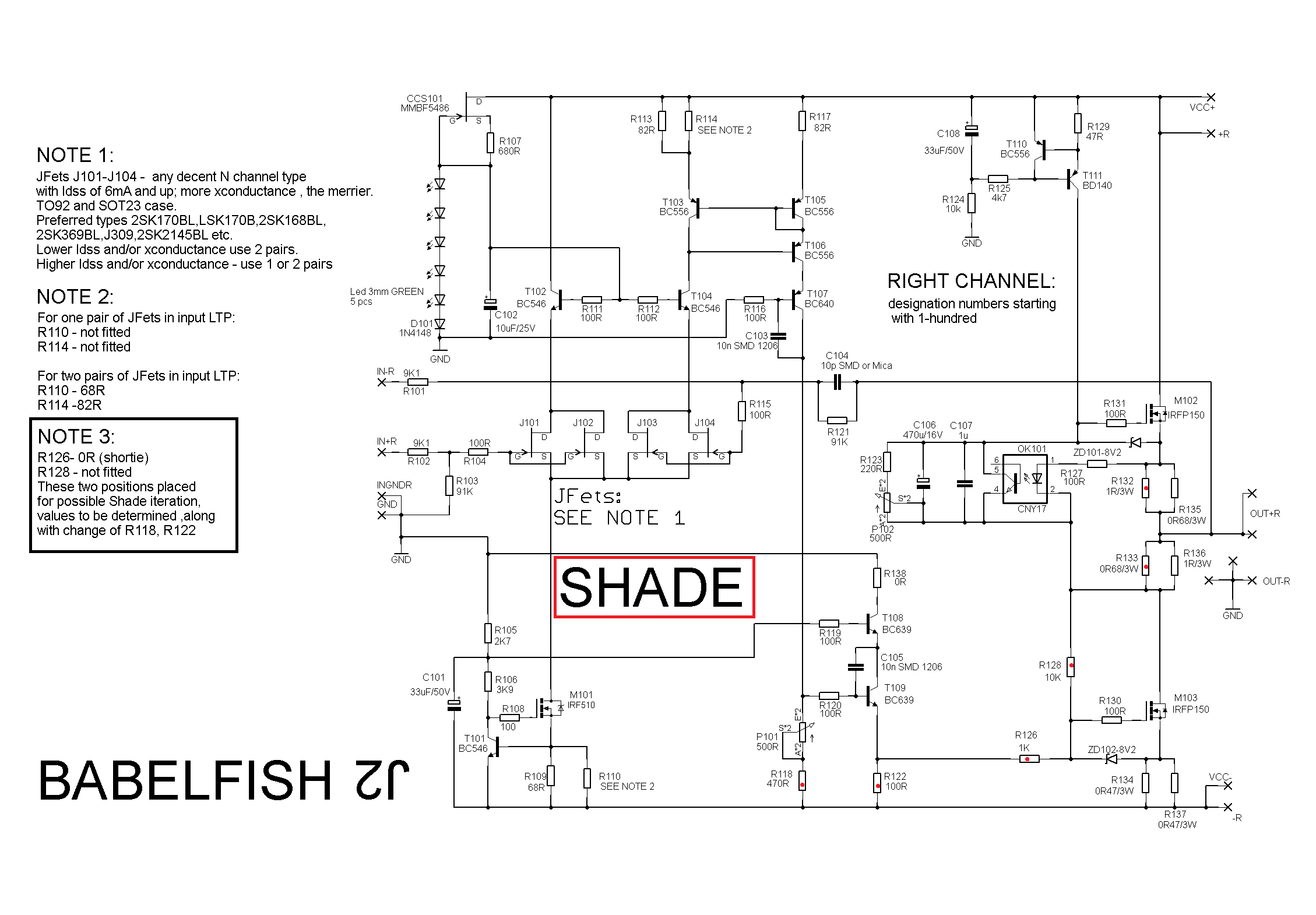

Zen Mod Napisano Oktobar 11, 2019 Autor Share #44 Napisano Oktobar 11, 2019 Babelfish J2 SHADE Link to comment Podeli na ovim sajtovima More sharing options...
