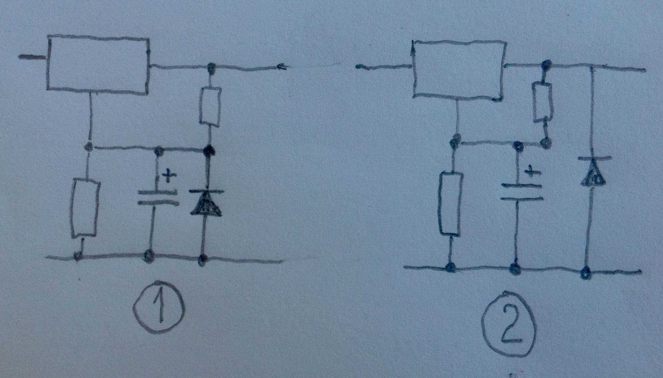

NIXIE Napisano Septembar 21, 2018 #67 Napisano Septembar 21, 2018 40 minutes ago, mutayu said: Pa sta konkretno predlazes? Ma stavi sve tri diode, nek ide život.
mutayu Napisano Septembar 21, 2018 Autor #68 Napisano Septembar 21, 2018 1 hour ago, vladd said: Mislio sam na ovo https://ece.vt.edu/files/undergrad/tutorials/Preventing_Voltage_Regulator_Latch-up.pdf U sustini, isti posao radi dioda paralelna tantalu(ima relativno mali otpornik prema izlazu), uz to stiti tantal koji ne trpi obrtanje polariteta i moze da se zapali od inverznog napona. Pri ukljucenju, iskljucenju, prelaznim pojavama uspostavljanja napona. Jasno mi je zasto ali nije mi jasno kako. Pogledaj na crtezu pa reci 1 ili 2 ili da uradim kako ONSemi predlaze na semi gore, posto po njima obe diode stite Cadj. Sto kaze @NIXIE mogu da stavim i sve tri, imam dioda, ali mislim da je poenta da naucim nesto pa da resavam probleme samostalno. Evo sta kaze ON Semi o diodama na gornjoj semi: Protection Diodes When external capacitors are used with any IC regulator it is sometimes necessary to add protection diodes to prevent the capacitors from discharging through low current points into the regulator. Figure 18 shows the LM317 with the recommended protection diodes for output voltages in excess of 25 V or high capacitance values (CO > 25 mF, CAdj > 10 mF). Diode D1 prevents CO from discharging thru the IC during an input short circuit. Diode D2 protects against capacitor CAdj discharging through the IC during an output short circuit. The combination of diodes D1 and D2 prevents CAdj from discharging through the IC during an input short circuit.
NIXIE Napisano Septembar 21, 2018 #69 Napisano Septembar 21, 2018 25 minutes ago, mutayu said: Jasno mi je zasto ali nije mi jasno kako. Pogledaj na crtezu pa reci 1 ili 2 ili da uradim kako ONSemi predlaze na semi gore, posto po njima obe diode stite Cadj. Sto kaze @NIXIE mogu da stavim i sve tri, imam dioda, ali mislim da je poenta da naucim nesto pa da resavam probleme samostalno. Evo sta kaze ON Semi o diodama na gornjoj semi: Protection Diodes When external capacitors are used with any IC regulator it is sometimes necessary to add protection diodes to prevent the capacitors from discharging through low current points into the regulator. Figure 18 shows the LM317 with the recommended protection diodes for output voltages in excess of 25 V or high capacitance values (CO > 25 mF, CAdj > 10 mF). Diode D1 prevents CO from discharging thru the IC during an input short circuit. Diode D2 protects against capacitor CAdj discharging through the IC during an output short circuit. The combination of diodes D1 and D2 prevents CAdj from discharging through the IC during an input short circuit. Ranije sam pravio stabilizatore za pretpojačala sa LM317/337 i uvek sam stavljao one dve diode, onu treću nisam, osim jednom na LM317 za pogon nekog ventilatora. Sve to i dan danas radi koliko znam bez problema. Pošto je preamp u pitanju, nema tu puno verovatnoće da se desi nešto nepredviđeno, ali stavi sve tri diode da ne strada LM slučajno tokom probanja, one dve obavezno, treću po želji.
vladd Napisano Septembar 21, 2018 #70 Napisano Septembar 21, 2018 Da to je taj deo price. I to se desava i kada se ulaz kratkospoji, i kada je na izlazu reaktivni potrosac koji moze da vrati veci napon na regulator, pa je izlazni veci od ulaznog. Sto kod tebe nije slucaj, a ako se kratkospoji ulaz, imaces vec skupi kvar sa trafoom, LM manje ili vise.:) Ono sto je na umu je sum mase i desavanja na njoj u prisustvu neg regulatora, a dioda paralelna kondu je prakticno ista kao i na slici 2 samo sto na red ima otpornik 240 oma.
