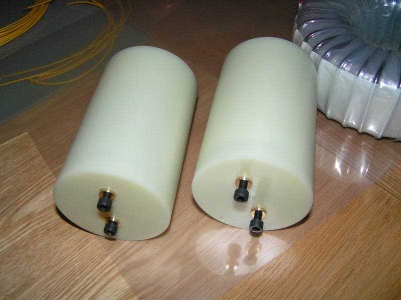

So, the caps got dressed today.Magura :moil:

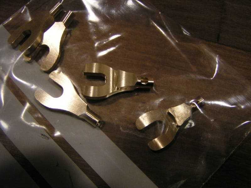

So, I figured a bunch of respectable spades would be nice....Pic is of the first few spades from today's little DIY event.Magura :cheers:
So, I figured a bunch of respectable spades would be nice....Pic is of the first few spades from today's little DIY event.Magura :rofl:
