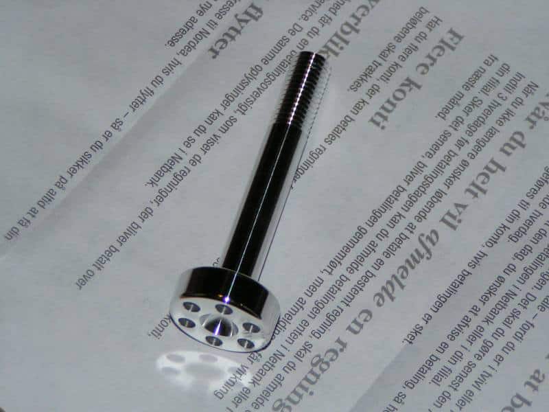

Donut a' la overkill
Magura
I envy you, you seem to get enough time to fiddle with such details I can't even get enough time to think about... Beatiful details, though... To make myself clear, have to drill 8 holes in a copper rod and make M3 thread inside the holes, mount the output devices and finish my Aleph 5. Doing it since September last year... :msn-rofl:

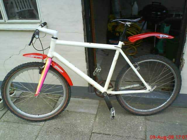

Love the bikes Stein. I've had a recumbent once, now I stick to fixed gear road bikes and a single speed MTB.Magura:)
We mainly and mostly sell trikes, guess that's where we are the best at. However... we do some bikes as well, but not fixies... http://www.bentrideronline.com/messageboar...ead.php?t=29746

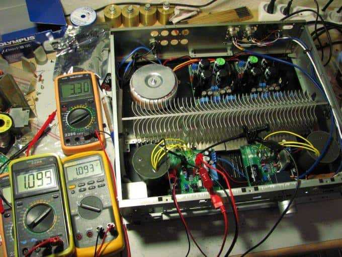

The psu that worked best, was a Lm317/337 supply. The BosoZ supply on the pic, wasnt good (noisy!) A clean psu is a must, as ZM said, way back.I had the Drek playing for a while, and it does sound extremely good. It betters everything else at one point: dynamic sound. It is not quite as good as the Pumpkin and LeCheff's UGS on more delicate matters like details, soundstage and the crispy silkysmooth topend. (Just my subjective oppinion ofcourse)Since I dont need so much gain in my system, the Drek is stashed away with the Pumpkin and other stuff I build. Totally nuts ;) Must be a neverending journey. I am building Juma's famous Pre4F5 with lightspeed attenuator, right now :msn-rofl: BTW, be prepared for a little tweaking with the Drek! It's a tweakers amp and I think it blew a channel just before it was put aside.BTW BTW, Nice bikes, Stein.
I have played a bit around with the Drek by now, yes you're right, it's hard to adjust, and somewhat sensitive, but mine is still alive :msn-rofl: Magura ;) This is the forum post # 1000 ;)
whazzat ya nutz ? :) put pic you sent to me today ......

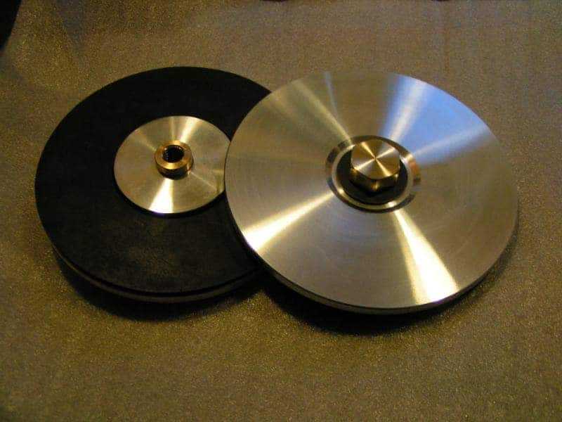

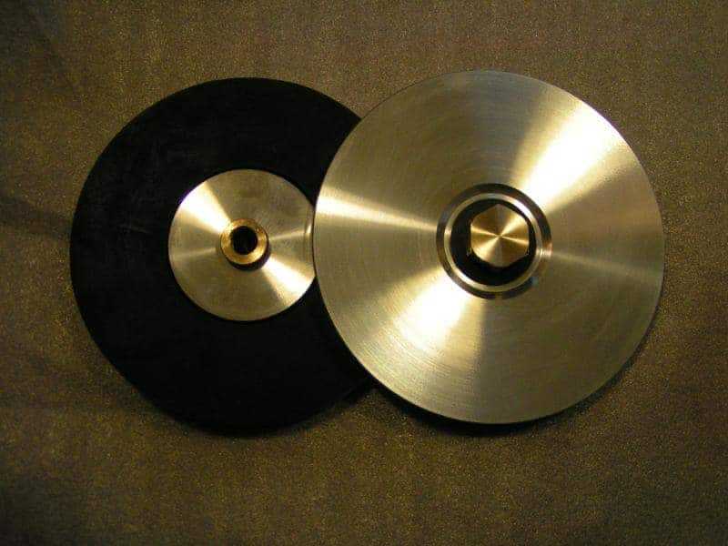

Those are for clamping the transformers, note the rubber on the backside. A nice little detail, is the spring washer. I've found them to be a great help in keeping the tension on the transformer over time.I'll post a better pic later, like the one you got today. It was just quick and dirty by cell-phone. If you don't know what it's supposed to show, it doesn't show much :diablo: Magura :)
What do you expect us to say when you put so much effort in mere toriod holder, but to stare in awe :)
Well, your critics has actually helped me from making stupid mistakes, so a critical comment here and there is nice :diablo: Magura :)
