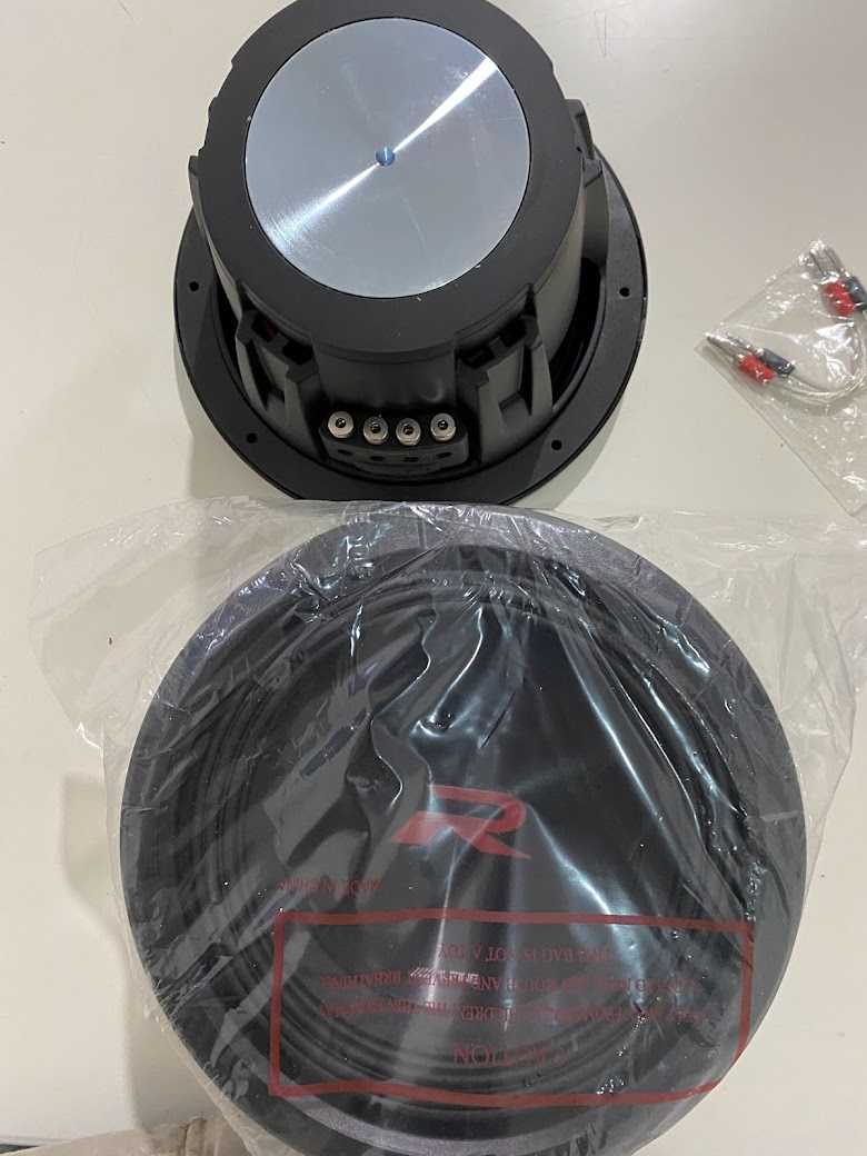

grone Napisano Decembar 13, 2023 #1 Napisano Decembar 13, 2023 Napravio sam ranije prije 2-3 god Danley DTS-10 "clone" origigi je ovaj: DTS10 | Danley Sound Labs WWW.DANLEYSOUNDLABS.COM The DTS10 theater subwoofer is the ideal subwoofer for home theatre and cinema use with a powerful low end sound. Pratio sam temu u AVS forumu ima i na drugim forumima: https://www.avsforum.com/threads/danley-dts-10-super-spud-diy-kit.1189404/ Ispostavilo da Alpine R2-W12D4 drivers 2 komada rade bolje nego ono sto Danley koristio custom Eminence koje ne moze se kupiti. Sve to lepo i jeftino uradio jos ga koristim zavisi sta slusam gledam. Posto imam dosta PWR amps na njega je povezano 2500w crown xls2501 na bridge modu. Kao taped horn ima oko 7m lavirint unutra, znam da sam stavio negde ovde u forumu... ide veoma nisko oko 15 Hz sa dosta Spl, rezano je na 60Hz, podesen je aktivno sa time delay i PEQ dosta sam se bavio stime. Vise se to primecuje u filmovima na dobar source i ne smeta uopte u muzici. U toku svega toga sam primetio da Danley ima manji model THSPUD koji isto moze se klonirati sa isto tako Alpine SWR-843D Origigi je ovaj: THSPUD | Danley Sound Labs WWW.DANLEYSOUNDLABS.COM The THSPUD subwoofer is ideal for a home theater and is a great way to bring Danley Sound Labs products into your home. Ima dosta oko Clone toga: DIY THSPUD clone - Subwoofers - The Klipsch Audio Community COMMUNITY.KLIPSCH.COM So I decided to start a actual build thread on the THSPUD clones I will be building, instead of hijacking the thread I have on plywood. Now I am going to be lazy and copy what I wrote on another thread. First if this isnt allowed then I apologize in advance, and please delete it. If not, then enj... Danas su stigli i nisam hteo temu da stavim u "novo pristigle skalamerije" da bude tema ovde. Nastavak sledi ubrzo... NIXIE, LightMatic, Vix and 4 ostalih je reagovao/la na ovo 1 3 1 2

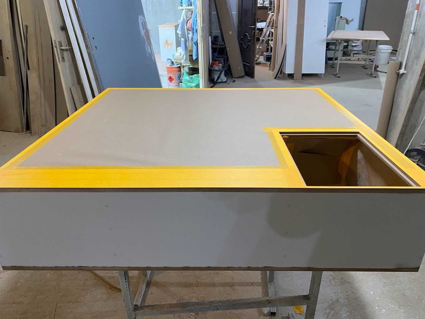

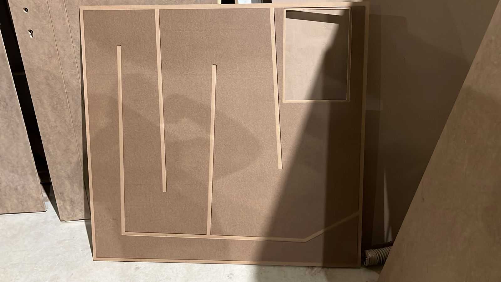

grone Napisano Decembar 27, 2023 Autor #3 Napisano Decembar 27, 2023 Poce od neceg prema nacrtima zerowaf, Koja and LightMatic je reagovao/la na ovo 1 1 1

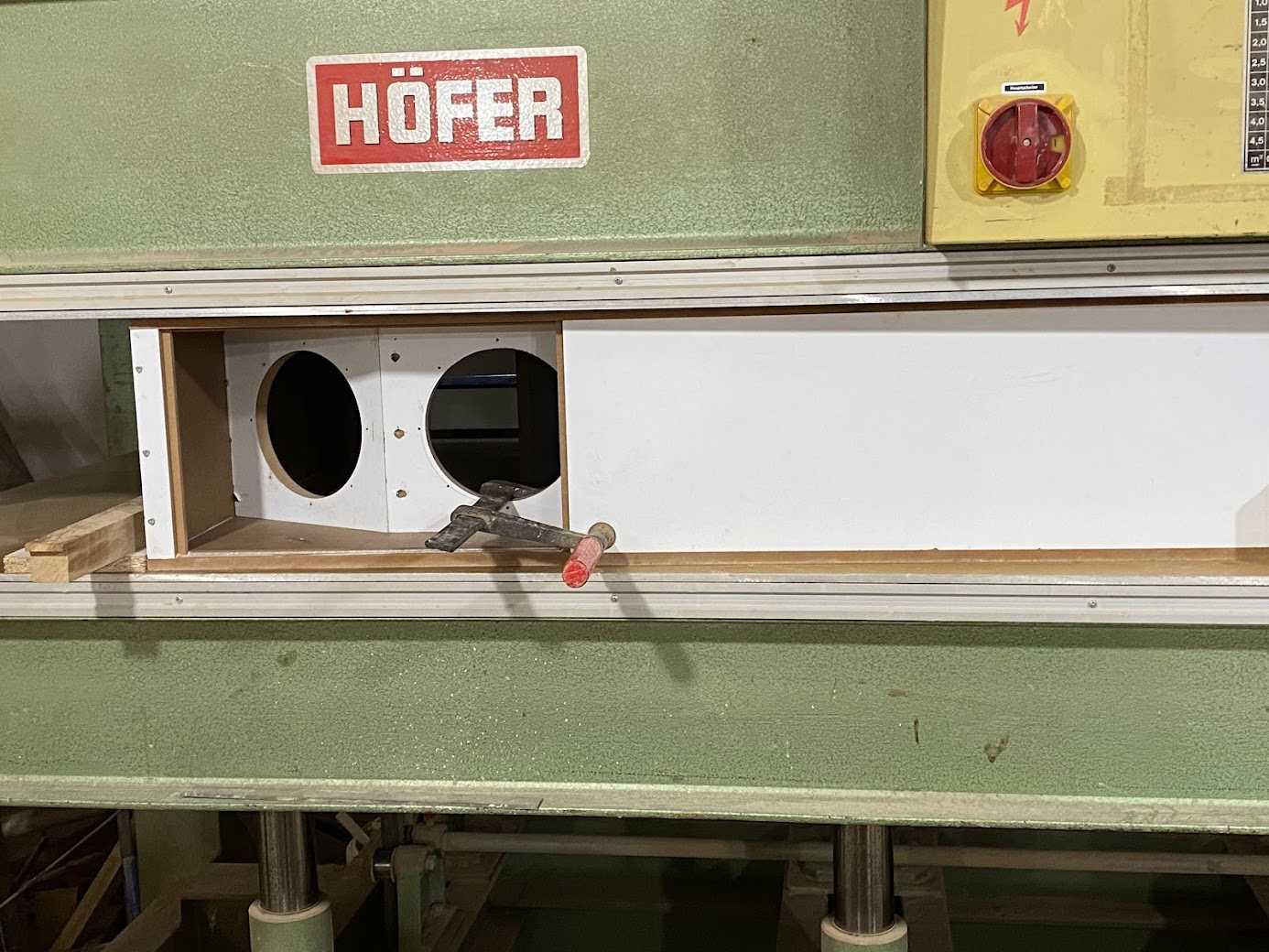

grone Napisano Decembar 29, 2023 Autor #4 Napisano Decembar 29, 2023 Radio sam malo posle podne i zavrsio, ostavio sam u pressu sutra ce biti gotov. Aleks, LightMatic, крокодил and 6 ostalih je reagovao/la na ovo 2 7
zerowaf Napisano Decembar 30, 2023 #5 Napisano Decembar 30, 2023 Dobra ti presa! To nije iz Lidla, zar ne?

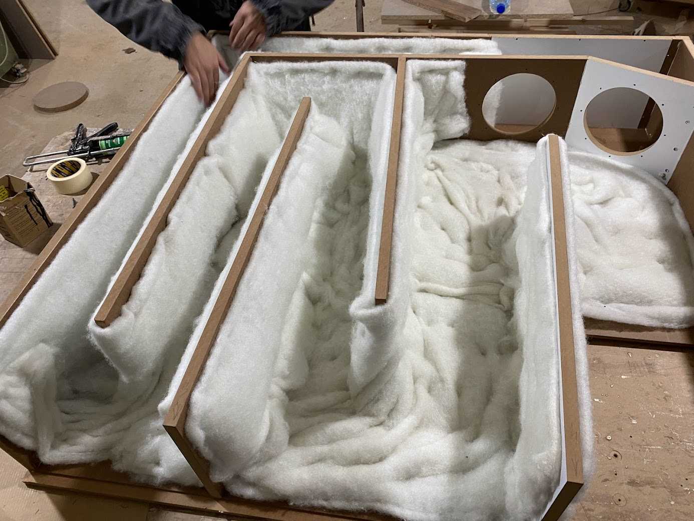

grone Napisano Januar 5, 2024 Autor #6 Napisano Januar 5, 2024 Jos malo pa gotovo: Vix, NIXIE and zerowaf je reagovao/la na ovo 2 1
